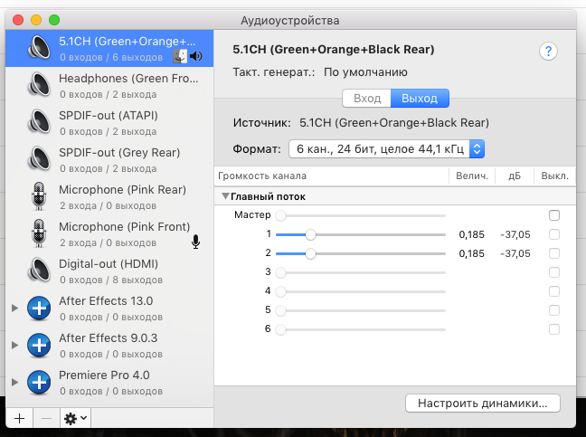

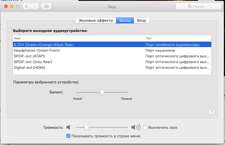

Slice Posted April 17, 2017 Author Share Posted April 17, 2017 Hi Zenith432! My test is bad I catch the sound from left speaker by iPhone. Hear! 20170417 205724.m4a.zip 1 Link to comment https://www.insanelymac.com/forum/topic/314406-voodoohda-312/page/8/#findComment-2406078 Share on other sites More sharing options...

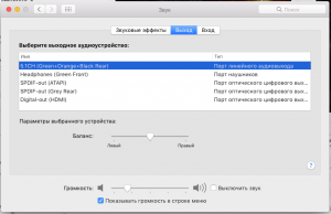

Zenith432 Posted April 17, 2017 Share Posted April 17, 2017 (edited) Click on the configure speakers at the bottom right and make sure it's configured for 5.1 surround. Please upload getdump for codec. Choppy sound seems like a bug, but maybe it depends on codec. I don't get choppy sound (ALC 887). Can you load a sample of the original multichannel audio you're playing? I'll try play it see if I get choppy sound. Hi Zenith432! My test is bad Снимок экрана 2017-04-17 в 20.50.31.png I catch the sound from left speaker by iPhone. Hear! 20170417 205724.m4a.zip Other Update: rev 133 supports HDMI multichannel. I cannot test it because A/V receiver is too far from HDMI port to connect. HDMI stereo still works so no regression. @Slice: I think the problem may be with IOAudioEngine::setMixClipOverhead. In 6-channel input, it has convert 3 times as many floats ->ints, so maybe on slower systems the default is not enough and mix buffer is underrun. Another thing to look at is setSampleOffset or setSampleLatency. Not sure what those do. Choppy sound is from buffer overrun or underrun. Edited April 17, 2017 by Zenith432 Link to comment https://www.insanelymac.com/forum/topic/314406-voodoohda-312/page/8/#findComment-2406092 Share on other sites More sharing options...
Slice Posted April 17, 2017 Author Share Posted April 17, 2017 This is original sound track 02 Departed.m4a.zip I tested all setting in Audio-MIDI with different speed of chopping. But sound always bad. The dump is here ALC1150-2.8.10d5.txt.zip up to rev 132, but not 133 yet. PS. Sound in Headphone, pure stereo, is very good. 1 Link to comment https://www.insanelymac.com/forum/topic/314406-voodoohda-312/page/8/#findComment-2406101 Share on other sites More sharing options...
Zenith432 Posted April 17, 2017 Share Posted April 17, 2017 (edited) Departed.m4a is stereo source. Plays ok on my system. Tried various formats - 16-bit, 24-bit, 44.1 KHz, 48KHz, in 7.1CH analog and HDMI (8CH). All work ok. I looked at codec dump - looks ok. I think I know what's going on. The problem is clipOutputSamples() is called too late, and causes buffer underrun in conversion from float->int samples. Why is this? On Headphone (pure stereo) output - it's a 2-channel device. So convert float->int for 2 channels. On 5.1CH device, input is 6 channels. Channels 0-1 are from source, channels 2-5 are zero-filled by CoreAudio. All 6 channels are converted float->int by clipOutputSamples. So need more time to process. On older system there's not enough time - leads to underrun. On my Kabylake it's fast enough, so no problem doing float->int conversion for 8 channels instead of 2. Tomorrow I'll look at IOAudioFamily to see how to increase the amount of time available for clipOutputSamples to find a fix. Edit: try reducing sample bit-width to 16-bit, conversion float->16 slightly faster than float->24, so maybe it'll work by coincidence This is original sound track 02 Departed.m4a.zip I tested all setting in Audio-MIDI with different speed of chopping. But sound always bad. The dump is here ALC1150-2.8.10d5.txt.zip up to rev 132, but not 133 yet. PS. Sound in Headphone, pure stereo, is very good. Edited April 17, 2017 by Zenith432 Link to comment https://www.insanelymac.com/forum/topic/314406-voodoohda-312/page/8/#findComment-2406105 Share on other sites More sharing options...
Slice Posted April 17, 2017 Author Share Posted April 17, 2017 My system is Skylake 3.3GHz, not so slow! And yes, I tested 16-24bit and 44-48-96kHz. I got different speed of choping but never good sound. I noticed that 2.8.10d1 requires more CPU load then 2.8.9. Why? I think I hear all 6 channels but mixed in stereo like 0,2,4 into left, 1,3,5 into right but consequently. Sound_1, then Sound_3 (silence), then sound_5 (silence), and then period. Link to comment https://www.insanelymac.com/forum/topic/314406-voodoohda-312/page/8/#findComment-2406138 Share on other sites More sharing options...
