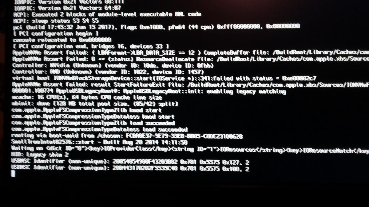

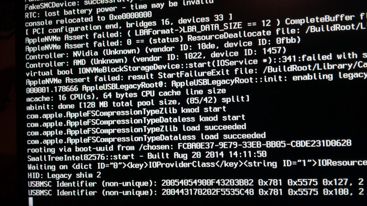

patricia2626 Posted September 6, 2017 Share Posted September 6, 2017 did i do something wrong my usb installer can read m.2 and erease format them and do anything with it but when i remove the usb it freezes and circle with line and i see one of the applenvme asser failed result startfaiulreexit file: buildroot/library/caches Link to comment https://www.insanelymac.com/forum/topic/312803-patch-for-using-nvme-under-macos-sierra-is-ready/page/50/#findComment-2490497 Share on other sites More sharing options...
RehabMan Posted September 6, 2017 Share Posted September 6, 2017 did i do something wrong my usb installer can read m.2 and erease format them and do anything with it but when i remove the usb it freezes and circle with line and i see one of the applenvme asser failed result startfaiulreexit file: buildroot/library/caches It means your EFI/Clover on the SSD is not setup correctly for NVMe. Or, you installed FakeSMC.kext, have config.plist/SystemParameters/InjectKexts=Detect, are using the class-code spoof for NVMe, but neglected to install HackrNVMeFamily to /L/E or /S/L/E (or installed one that was not generated with --spoof). Or, some combination of both. Link to comment https://www.insanelymac.com/forum/topic/312803-patch-for-using-nvme-under-macos-sierra-is-ready/page/50/#findComment-2490515 Share on other sites More sharing options...

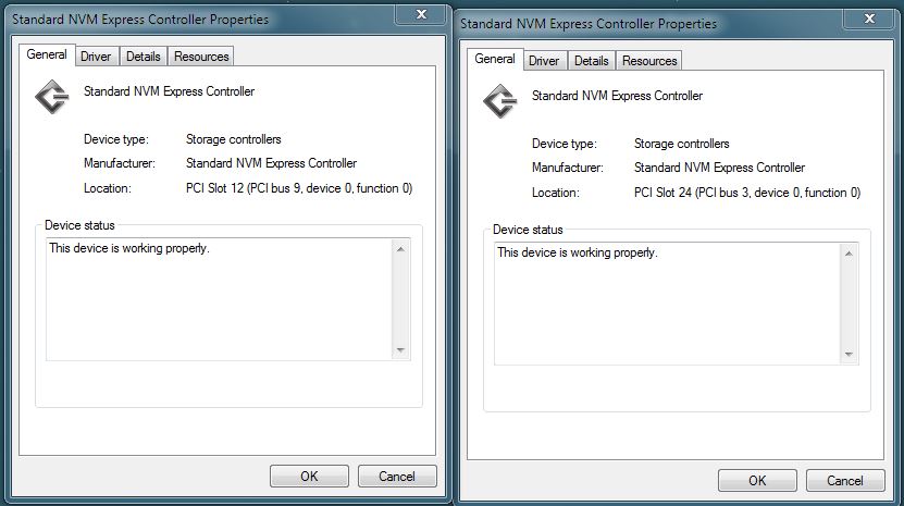

ccozmo Posted September 15, 2017 Share Posted September 15, 2017 I booted into Windows 7 & can see the 2 NVMe controllers under device manager. When I select the properties, there is no BIOS device name under details. Is there another way to confirm the APCI paths for them both ? Attached is the general tab showing some location information. Is this enough to work out the APCI path ? Or is there any other property I could use ? Link to comment https://www.insanelymac.com/forum/topic/312803-patch-for-using-nvme-under-macos-sierra-is-ready/page/50/#findComment-2494760 Share on other sites More sharing options...
RehabMan Posted September 15, 2017 Share Posted September 15, 2017 I booted into Windows 7 & can see the 2 NVMe controllers under device manager. When I select the properties, there is no BIOS device name under details. Is there another way to confirm the APCI paths for them both ? Attached is the general tab showing some location information. Is this enough to work out the APCI path ? Or is there any other property I could use ? Win7 does not show BIOS name. Must use Win10 for that. Plus you need to look at the "Details" tab. Link to comment https://www.insanelymac.com/forum/topic/312803-patch-for-using-nvme-under-macos-sierra-is-ready/page/50/#findComment-2494781 Share on other sites More sharing options...
ccozmo Posted September 15, 2017 Share Posted September 15, 2017 So is there anyway it can be done on Win 7 ? Or will I have to install Win 10 ? What about on MAC, can I use IOregisteryExplorer ?I tried but only see one entry when I search for nvme Link to comment https://www.insanelymac.com/forum/topic/312803-patch-for-using-nvme-under-macos-sierra-is-ready/page/50/#findComment-2494838 Share on other sites More sharing options...
RehabMan Posted September 15, 2017 Share Posted September 15, 2017 So is there anyway it can be done on Win 7 ? Or will I have to install Win 10 ? What about on MAC, can I use IOregisteryExplorer ?I tried but only see one entry when I search for nvme Attach your ioreg. (please use IORegistryExplorer v2.1) Link to comment https://www.insanelymac.com/forum/topic/312803-patch-for-using-nvme-under-macos-sierra-is-ready/page/50/#findComment-2494859 Share on other sites More sharing options...
ccozmo Posted September 15, 2017 Share Posted September 15, 2017 Thanks Rehabman. Attached is my ioreg using v2.1 ccozmo’s iMac.zip Link to comment https://www.insanelymac.com/forum/topic/312803-patch-for-using-nvme-under-macos-sierra-is-ready/page/50/#findComment-2494874 Share on other sites More sharing options...
RehabMan Posted September 15, 2017 Share Posted September 15, 2017 Thanks Rehabman. Attached is my ioreg using v2.1 According to this ioreg, your second NVMe device is at _SB.PC00.RP21.PXSX. (the first one you've already done the class-code spoof at _SB.PC00.RP09.PXSX) Link to comment https://www.insanelymac.com/forum/topic/312803-patch-for-using-nvme-under-macos-sierra-is-ready/page/50/#findComment-2494910 Share on other sites More sharing options...
