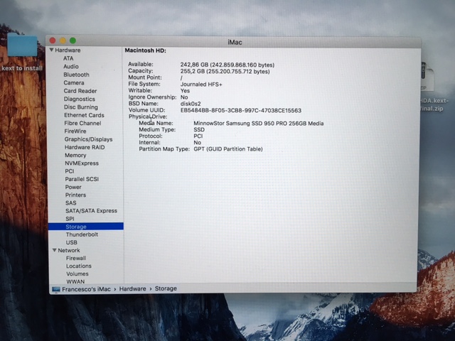

DriveTheOne Posted May 8, 2016 Share Posted May 8, 2016 Hi people, My name is Frank, I'm a italian. I've recently purchased a laptop from Dell: an Alienware 15r2 with 6700HQ processor and Nvidia 980M with 8Gb of Vram, NVMe 265GB of SAMSUNG PRO 950 On my system, I've a Windows 10 Home edition but I've a mac mini for helping me about installation, EFI, etc.. Now I've used cloverboot with El Capitan (latest version: 10.11.4), followed this guide: Making a 10.10/10.11 USB Installer /w Clover (UEFI and Legacy) the correct way! (adding only this kext: fakesmc.kext) I've changed in config.plist to this: <?xml version="1.0" encoding="UTF-8"?> <!DOCTYPE plist PUBLIC "-//Apple//DTD PLIST 1.0//EN" "http://www.apple.com/DTDs/PropertyList-1.0.dtd"> <plist version="1.0"> <dict> <key>#DisableDrivers</key> <array> <string>CsmVideoDxe</string> <string>VBoxExt4</string> </array> <key>ACPI</key> <dict> <key>#DropMCFG</key> <false/> <key>#PatchAPIC</key> <false/> <key>#ResetAddress</key> <string>0x64</string> <key>#ResetValue</key> <string>0xFE</string> <key>#SortedOrder</key> <array> <string>SSDT-3.aml</string> <string>SSDT-1.aml</string> <string>SSDT-2.aml</string> </array> <key>#smartUPS</key> <false/> <key>DSDT</key> <dict> <key>#DropOEM_DSM</key> <dict> <key>ATI</key> <true/> <key>Firewire</key> <true/> <key>HDA</key> <true/> <key>HDMI</key> <true/> <key>IDE</key> <true/> <key>IntelGFX</key> <true/> <key>LAN</key> <true/> <key>LPC</key> <false/> <key>NVidia</key> <true/> <key>SATA</key> <true/> <key>SmBUS</key> <false/> <key>USB</key> <true/> <key>WIFI</key> <true/> </dict> <key>#Patches</key> <array> <dict> <key>Comment</key> <string>Remove battery device from desktop</string> <key>Find</key> <data> W4IeQkFUMQhfSElEDEHQDAoIX1VJRAEUCF9T VEEApAA= </data> <key>Replace</key> <data> </data> </dict> <dict> <key>Comment</key> <string>Add _SUN property for GIGE</string> <key>Find</key> <data> UFhTWAhfQURSAAhfUFJXEgYC </data> <key>Replace</key> <data> UFhTWAhfQURSAAhfU1VOCgQIX1BSVxIGAg== </data> </dict> <dict> <key>Comment</key> <string>Rename GFX0 to IGPU</string> <key>Find</key> <data> R0ZYMA== </data> <key>Replace</key> <data> SUdQVQ== </data> </dict> <dict> <key>Comment</key> <string>Rename HDEF to AZAL</string> <key>Find</key> <data> SERFRg== </data> <key>Replace</key> <data> QVpBTA== </data> </dict> </array> <key>#Rtc8Allowed</key> <false/> <key>#SuspendOverride</key> <false/> <key>Debug</key> <false/> <key>Fixes</key> <dict> <key>AddDTGP_0001</key> <true/> <key>AddHDMI_8000000</key> <true/> <key>AddIMEI_80000</key> <false/> <key>AddMCHC_0008</key> <false/> <key>AddPNLF_1000000</key> <true/> <key>DeleteUnused_400000</key> <true/> <key>FIX_ACST_4000000</key> <true/> <key>FIX_ADP1_800000</key> <true/> <key>FIX_INTELGFX_100000</key> <false/> <key>FIX_RTC_20000</key> <true/> <key>FIX_S3D_2000000</key> <true/> <key>FIX_TMR_40000</key> <true/> <key>FIX_WAK_200000</key> <true/> <key>FakeLPC_0020</key> <false/> <key>FixAirport_4000</key> <true/> <key>FixDarwin_0002</key> <true/> <key>FixDisplay_0100</key> <true/> <key>FixFirewire_0800</key> <true/> <key>FixHDA_8000</key> <true/> <key>FixHPET_0010</key> <true/> <key>FixIDE_0200</key> <false/> <key>FixIPIC_0040</key> <true/> <key>FixLAN_2000</key> <true/> <key>FixRegions_10000000</key> <true/> <key>FixSATA_0400</key> <false/> <key>FixSBUS_0080</key> <true/> <key>FixShutdown_0004</key> <true/> <key>FixUSB_1000</key> <true/> <key>NewWay_80000000</key> <true/> </dict> <key>Name</key> <string>DSDT.aml</string> <key>ReuseFFFF</key> <false/> </dict> <key>DropTables</key> <array> <dict> <key>Signature</key> <string>DMAR</string> </dict> <dict> <key>Signature</key> <string>SSDT</string> <key>TableId</key> <string>CpuPm</string> </dict> <dict> <key>#Length</key> <integer>720</integer> <key>Signature</key> <string>SSDT</string> <key>TableId</key> <string>Cpu0Ist</string> </dict> </array> <key>HaltEnabler</key> <true/> <key>SSDT</key> <dict> <key>#C3Latency</key> <string>0x03E7</string> <key>#DoubleFirstState</key> <true/> <key>#DropOem</key> <true/> <key>#EnableC2</key> <false/> <key>#EnableC4</key> <false/> <key>#EnableC6</key> <true/> <key>#EnableC7</key> <false/> <key>#MaxMultiplier</key> <integer>12</integer> <key>#MinMultiplier</key> <integer>8</integer> <key>#PLimitDict</key> <integer>1</integer> <key>#PluginType</key> <integer>0</integer> <key>#UnderVoltStep</key> <integer>1</integer> <key>#UseSystemIO</key> <false/> <key>Generate</key> <dict> <key>CStates</key> <true/> <key>PStates</key> <true/> </dict> </dict> </dict> <key>Boot</key> <dict> <key>#Arguments</key> <string>-v arch=i386 slide=0 darkwake=0</string> <key>#LegacyBiosDefaultEntry</key> <integer>0</integer> <key>#XMPDetection</key> <string>-1</string> <key>Arguments</key> <string>kext-dev-mode=1 rootless=0</string> <key>Debug</key> <false/> <key>DefaultLoader</key> <string>boot.efi</string> <key>DefaultVolume</key> <string>LastBootedVolume</string> <key>Fast</key> <false/> <key>Legacy</key> <string>PBR</string> <key>NeverHibernate</key> <false/> <key>Timeout</key> <integer>5</integer> </dict> <key>CPU</key> <dict> <key>#BusSpeedkHz</key> <integer>133330</integer> <key>#FrequencyMHz</key> <integer>3140</integer> <key>#QPI</key> <integer>4800</integer> <key>#SavingMode</key> <integer>7</integer> <key>#TurboDisable</key> <true/> <key>#Type</key> <string>0x0201</string> <key>#UseARTFrequency</key> <true/> </dict> <key>Devices</key> <dict> <key>#AddProperties</key> <array> <dict> <key>Device</key> <string>NVidia</string> <key>Key</key> <string>AAPL,HasPanel</string> <key>Value</key> <data> AQAAAA== </data> </dict> <dict> <key>Device</key> <string>NVidia</string> <key>Key</key> <string>AAPL,Haslid</string> <key>Value</key> <data> AQAAAA== </data> </dict> </array> <key>#ForceHPET</key> <false/> <key>#InjectString</key> <false/> <key>#Properties</key> <string>7a00000001000000010000006e0000000200000002010c00d041030a0000000001010600001b7fff040028000000500069006e0043006f006e00660069006700750072006100740069006f006e00730000000800000001080100180000006c00610079006f00750074002d00690064000000080000000c000000</string> <key>#SetIntelBacklight</key> <false/> <key>Audio</key> <dict> <key>#Inject</key> <string>0x0887</string> <key>ResetHDA</key> <true/> </dict> <key>FakeID</key> <dict> <key>#ATI</key> <string>0x67501002</string> <key>#IMEI</key> <string>0x1e208086</string> <key>#IntelGFX</key> <string>0x01268086</string> <key>#LAN</key> <string>0x100E8086</string> <key>#NVidia</key> <string>0x11de10de</string> <key>#SATA</key> <string>0x25628086</string> <key>#WIFI</key> <string>0x431214e4</string> <key>#XHCI</key> <string>0x0</string> </dict> <key>NoDefaultProperties</key> <false/> <key>USB</key> <dict> <key>AddClockID</key> <true/> <key>FixOwnership</key> <true/> <key>HighCurrent</key> <false/> <key>Inject</key> <true/> </dict> <key>UseIntelHDMI</key> <false/> </dict> <key>GUI</key> <dict> <key>#ConsoleMode</key> <string>0</string> <key>#Custom</key> <dict> <key>Entries</key> <array> <dict> <key>AddArguments</key> <string>-v</string> <key>Arguments</key> <string>Kernel=mach_kernel</string> <key>Disabled</key> <true/> <key>Hidden</key> <false/> <key>Hotkey</key> <string>M</string> <key>InjectKexts</key> <false/> <key>NoCaches</key> <false/> <key>Path</key> <string>\EFI\BOOT\BOOTX64.efi</string> <key>Title</key> <string>MyCustomEntry</string> <key>Type</key> <string>OSXRecovery</string> <key>Volume</key> <string>D68F1885-571C-4441-8DD5-F14803EFEF54</string> </dict> <dict> <key>Hidden</key> <false/> <key>InjectKexts</key> <false/> <key>NoCaches</key> <false/> <key>SubEntries</key> <array> <dict> <key>AddArguments</key> <string>-v</string> <key>Title</key> <string>Boot OS X 10.8.5 (12F36) Mountain Lion in Verbose Mode</string> </dict> </array> <key>Title</key> <string>OS X 10.8.5 (12F36) Mountain Lion</string> <key>Type</key> <string>OSX</string> <key>Volume</key> <string>454794AC-760D-46E8-8F77-D6EB23D2FD32</string> </dict> </array> <key>Legacy</key> <array> <dict> <key>Disabled</key> <true/> <key>Hidden</key> <false/> <key>Hotkey</key> <string>L</string> <key>Title</key> <string>MyLegacyEntry</string> <key>Type</key> <string>Windows</string> <key>Volume</key> <string>89433CD3-21F2-4D3C-95FC-722C48066D3A</string> </dict> </array> <key>Tool</key> <array> <dict> <key>Arguments</key> <string>-b</string> <key>Disabled</key> <false/> <key>Hidden</key> <false/> <key>Hotkey</key> <string>S</string> <key>Path</key> <string>\EFI\CLOVER\TOOLS\Shell64-v1.efi</string> <key>Title</key> <string>MyCustomShell</string> <key>Volume</key> <string>D68F1885-571C-4441-8DD5-F14803EFEF54</string> </dict> </array> </dict> <key>#CustomIcons</key> <false/> <key>#Hide</key> <array> <string>Windows</string> <string>BOOTX64.EFI</string> </array> <key>#Language</key> <string>ru:0</string> <key>#Mouse</key> <dict> <key>Enabled</key> <true/> <key>Mirror</key> <false/> <key>Speed</key> <integer>2</integer> </dict> <key>#Scan</key> <dict> <key>Entries</key> <true/> <key>Legacy</key> <false/> <key>Tool</key> <true/> </dict> <key>#TextOnly</key> <false/> <key>ScreenResolution</key> <string>1280x1024</string> <key>Theme</key> <string>bluemac</string> </dict> <key>Graphics</key> <dict> <key>#Connectors</key> <array/> <key>#CustomEDID</key> <data> AP///////wAyDADfAAAAAAASAQOAIRV4CunVmVlTjigmUFQAAAABAQEBAQEB AQEBAQEBAQEB3iGgcFCEHzAgIFYAS88QAAAY3iGgcFCEHzAgIFYAS88QAAAA AAAA/gBXNjU3RwAxNTRXUDEKAAAA/gAjMz1IZYSq/wIBCiAgAJo= </data> <key>#DualLink</key> <integer>0</integer> <key>#FBName</key> <string>Makakakakala</string> <key>#Inject</key> <dict> <key>ATI</key> <true/> <key>Intel</key> <false/> <key>NVidia</key> <false/> </dict> <key>#InjectEDID</key> <true/> <key>#LoadVBios</key> <false/> <key>#NVCAP</key> <string>04000000000003000C0000000000000A00000000</string> <key>#NvidiaGeneric</key> <true/> <key>#NvidiaSingle</key> <false/> <key>#PatchVBios</key> <false/> <key>#PatchVBiosBytes</key> <array> <dict> <key>Find</key> <data> gAeoAqAF </data> <key>Replace</key> <data> gAeoAjgE </data> </dict> </array> <key>#VRAM</key> <integer>1024</integer> <key>#VideoPorts</key> <integer>2</integer> <key>#display-cfg</key> <string>03010300FFFF0001</string> <key>#ig-platform-id</key> <string>0x19120000</string> </dict> <key>KernelAndKextPatches</key> <dict> <key>#ATIConnectorsController</key> <string>6000</string> <key>#ATIConnectorsData</key> <string>000400000403000000010000210302040400000014020000000100000000040310000000100000000001000000000001</string> <key>#ATIConnectorsPatch</key> <string>040000001402000000010000000004040004000004030000000100001102010500000000000000000000000000000000</string> <key>#FakeCPUID</key> <string>0x010676</string> <key>#KextsToPatch</key> <array> <dict> <key>Comment</key> <string>change 15 port limit to 30 in AppleUSBXHCIPCI</string> <key>Find</key> <data> g72M/v//EA== </data> <key>Name</key> <string>AppleUSBXHCIPCI</string> <key>Replace</key> <data> g72M/v//Hw== </data> </dict> <dict> <key>Find</key> <data> SGVhZHBob25lcwA= </data> <key>Name</key> <string>VoodooHDA</string> <key>Replace</key> <data> VGVsZXBob25lcwA= </data> </dict> <dict> <key>Comment</key> <string>Patch_to_not_load_this_driver</string> <key>Find</key> <string>0x04020000</string> <key>InfoPlistPatch</key> <true/> <key>Name</key> <string>AppleHDAController</string> <key>Replace</key> <string>0x44220000</string> </dict> <dict> <key>Comment</key> <string>Make all drives to be internal</string> <key>Find</key> <data> RXh0ZXJuYWw= </data> <key>Name</key> <string>AppleAHCIPort</string> <key>Replace</key> <data> SW50ZXJuYWw= </data> </dict> <dict> <key>Comment</key> <string>TRIM function for non-Apple SSDs</string> <key>Find</key> <data> QVBQTEUgU1NEAA== </data> <key>Name</key> <string>IOAHCIBlockStorage</string> <key>Replace</key> <data> AAAAAAAAAAAAAA== </data> </dict> <dict> <key>Comment</key> <string>Second Stage patch 1</string> <key>Find</key> <data> hcB0XUg= </data> <key>Name</key> <string>IOGraphicsFamily</string> <key>Replace</key> <data> McB0W0g= </data> </dict> <dict> <key>Comment</key> <string>Second Stage patch 2</string> <key>Find</key> <data> QYjE6wM= </data> <key>Name</key> <string>IOGraphicsFamily</string> <key>Replace</key> <data> QYjE6yM= </data> </dict> </array> <key>AppleRTC</key> <true/> <key>AsusAICPUPM</key> <false/> <key>Debug</key> <false/> <key>KernelCpu</key> <false/> <key>KernelHaswellE</key> <false/> <key>KernelLapic</key> <false/> <key>KernelPm</key> <true/> </dict> <key>RtVariables</key> <dict> <key>BooterConfig</key> <string>0x28</string> <key>CsrActiveConfig</key> <string>0x67</string> <key>MLB</key> <string>C02032109R5DC771H</string> <key>ROM</key> <string>UseMacAddr0</string> </dict> <key>SMBIOS</key> <dict> <key>#BiosReleaseDate</key> <string>09/22/2015</string> <key>#BiosVendor</key> <string>Apple Inc.</string> <key>#BiosVersion</key> <string>IM171.88Z.0105.B00.1509221819</string> <key>#Board-ID</key> <string>Mac-F4208CC8</string> <key>#BoardManufacturer</key> <string>Apple Inc.</string> <key>#BoardSerialNumber</key> <string>C02032101R5DC771H</string> <key>#BoardType</key> <integer>10</integer> <key>#BoardVersion</key> <string>iMac17,1</string> <key>#ChassisAssetTag</key> <string></string> <key>#ChassisManufacturer</key> <string>Apple Inc.</string> <key>#ChassisType</key> <integer>13</integer> <key>#Family</key> <string>iMac</string> <key>#LocationInChassis</key> <string>Part Component</string> <key>#Memory</key> <dict> <key>Channels</key> <integer>2</integer> <key>Modules</key> <array> <dict> <key>Frequency</key> <integer>2133</integer> <key>Part</key> <string>16ATF1G64HZ-2G1AZ</string> <key>Serial</key> <string>11DA9F9A</string> <key>Size</key> <integer>8192</integer> <key>Slot</key> <integer>0</integer> <key>Type</key> <string>DDR4</string> <key>Vendor</key> <string>Micron Technology</string> </dict> <dict> <key>Frequency</key> <integer>2133</integer> <key>Part</key> <string>16ATF1G64HZ-2G1AZ</string> <key>Serial</key> <string>11DA9F9A</string> <key>Size</key> <integer>8192</integer> <key>Slot</key> <integer>2</integer> <key>Type</key> <string>DDR4</string> <key>Vendor</key> <string>Micron Technology</string> </dict> </array> <key>SlotCount</key> <integer>4</integer> </dict> <key>#Mobile</key> <true/> <key>#PlatformFeature</key> <integer>3</integer> <key>#ProductName</key> <string>iMac17,1</string> <key>#SerialNumber</key> <string>C02Q0000GG7L</string> <key>#Slots</key> <array> <dict> <key>Device</key> <string>ATI</string> <key>ID</key> <integer>1</integer> <key>Name</key> <string>PCIe Slot 0</string> <key>Type</key> <integer>16</integer> </dict> <dict> <key>Device</key> <string>WIFI</string> <key>ID</key> <integer>0</integer> <key>Name</key> <string>Airport</string> <key>Type</key> <integer>1</integer> </dict> </array> <key>#SmUUID</key> <string>00000000-0000-1000-8000-010203040506</string> <key>#Trust</key> <false/> <key>#Version</key> <string>1.0</string> <key>Manufacturer</key> <string>Apple Inc.</string> </dict> <key>SystemParameters</key> <dict> <key>#BacklightLevel</key> <string>0x0501</string> <key>#CustomUUID</key> <string>511CE201-1000-4000-9999-010203040506</string> <key>#DefaultBackgroundColor</key> <string>0xF0F0F0</string> <key>InjectKexts</key> <string>Detect</string> <key>InjectSystemID</key> <true/> </dict> </dict> </plist> Changed this menu on bios: Virtualization: enable VT for direct I/O: disabled Sata operation: AHCI and boot: Boot option: UEFI Secure boot: disabled legacy: enabled Now I'm here: Working: Sounblaster R3Di -> Work with voodooHDA 2.8.8 version Restart it work shutdown it work Not Working: Reading wrong memory: 8Gb ram instead 16gb of ram Reading wrong integrated video: HD530 (I've heard that to resolve it, I need 10.11.4 version of El Capitan, isn't true?) Realtek RTS5227 card reader of course: Intel WIFI & Bluetooth 8260AC nvidia 980M (not tried) QHD+ screen resolution retina (maybe I've to install before Intel HD530...) Doubt: about cpu power saving? How can I know if it work or not? the boot is VEEEERY SLOOOOOWW!!! Link to comment https://www.insanelymac.com/forum/topic/312131-installing-a-el-capitan-on-dell-alienware-15r2-skylake-system/ Share on other sites More sharing options...

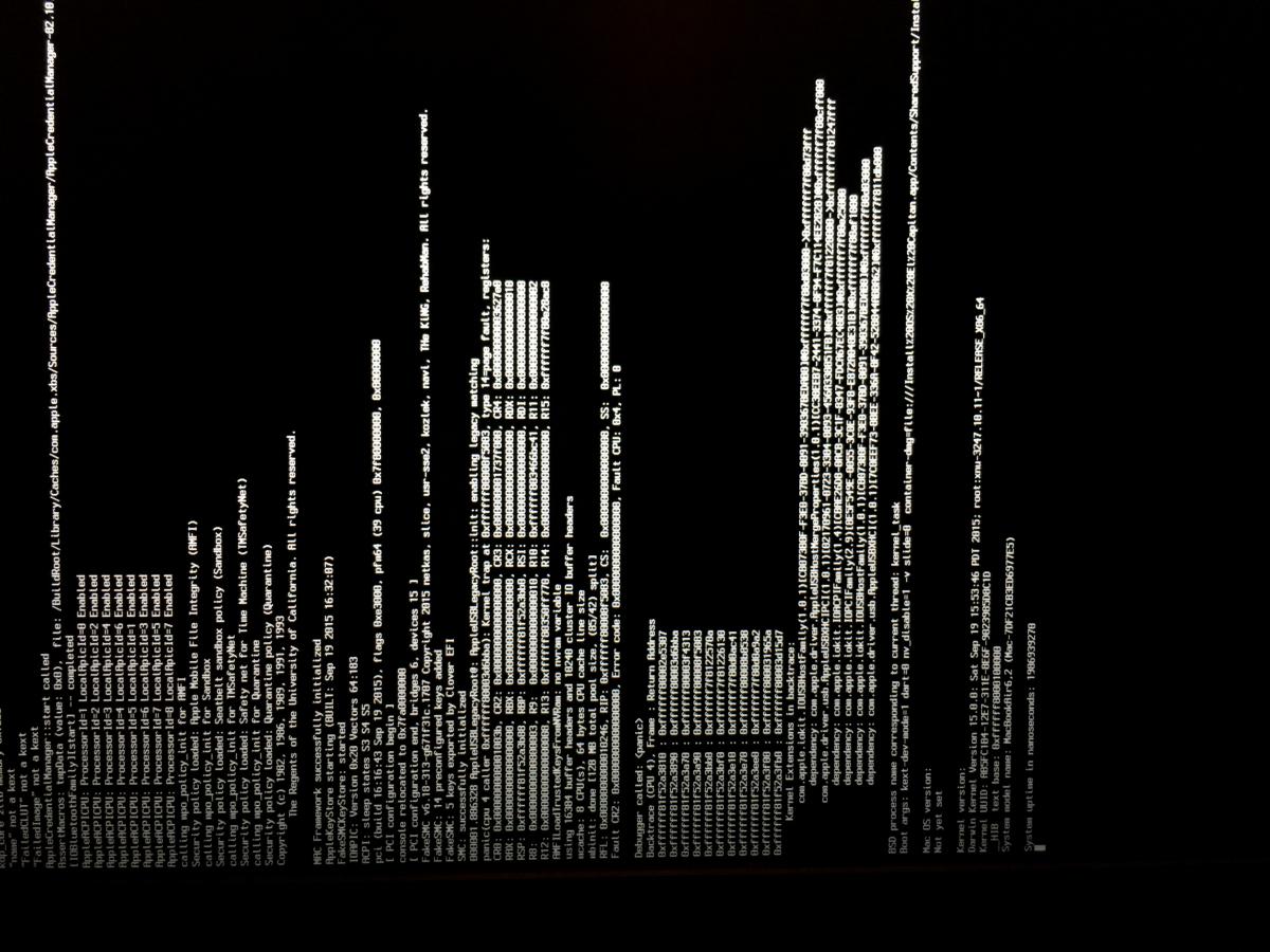

DriveTheOne Posted May 9, 2016 Author Share Posted May 9, 2016 Now, I've used this guide: I used RehabMan's "Booting the OS X installer on LAPTOPS with Clover" Guide Added: Rehab's InjectUSBAll , VoodooPS2Controller and FakeSMC. this is the new config: <?xml version="1.0" encoding="UTF-8"?> <!DOCTYPE plist PUBLIC "-//Apple//DTD PLIST 1.0//EN" "http://www.apple.com/DTDs/PropertyList-1.0.dtd"> <plist version="1.0"> <dict> <key>ACPI</key> <dict> <key>#DropTables</key> <array> <dict> <key>Signature</key> <string>DMAR</string> </dict> <dict> <key>Signature</key> <string>SSDT</string> <key>TableId</key> <string>CpuPm</string> </dict> <dict> <key>Signature</key> <string>SSDT</string> <key>TableId</key> <string>Cpu0Cst</string> </dict> <dict> <key>Signature</key> <string>SSDT</string> <key>TableId</key> <string>Cpu0Ist</string> </dict> <dict> <key>Signature</key> <string>SSDT</string> <key>TableId</key> <string>ApCst</string> </dict> <dict> <key>Signature</key> <string>SSDT</string> <key>TableId</key> <string>ApIst</string> </dict> </array> <key>DSDT</key> <dict> <key>Fixes</key> <dict> <key>FixRegions_10000000</key> <false/> <key>NewWay_80000000</key> <true/> </dict> <key>Patches</key> <array> <dict> <key>Comment</key> <string>change _OSI to XOSI</string> <key>Disabled</key> <true/> <key>Find</key> <data> X09TSQ== </data> <key>Replace</key> <data> WE9TSQ== </data> </dict> <dict> <key>Comment</key> <string>change EHC1 to EH01</string> <key>Find</key> <data> RUhDMQ== </data> <key>Replace</key> <data> RUgwMQ== </data> </dict> <dict> <key>Comment</key> <string>change EHC2 to EH02</string> <key>Find</key> <data> RUhDMg== </data> <key>Replace</key> <data> RUgwMg== </data> </dict> <dict> <key>Comment</key> <string>change HDAS to HDEF</string> <key>Find</key> <data> SERBUw== </data> <key>Replace</key> <data> SERFRg== </data> </dict> <dict> <key>Comment</key> <string>change HECI to IMEI</string> <key>Find</key> <data> SEVDSQ== </data> <key>Replace</key> <data> SU1FSQ== </data> </dict> <dict> <key>Comment</key> <string>change MEI to IMEI</string> <key>Find</key> <data> TUVJXw== </data> <key>Replace</key> <data> SU1FSQ== </data> </dict> </array> </dict> <key>DropTables</key> <array> <dict> <key>Signature</key> <string>DMAR</string> </dict> </array> <key>SSDT</key> <dict> <key>DropOem</key> <false/> <key>Generate</key> <dict> <key>CStates</key> <false/> <key>PStates</key> <false/> </dict> <key>PluginType</key> <integer>1</integer> </dict> <key>SortedOrder</key> <array> <string>SSDT.aml</string> <string>SSDT-0.aml</string> <string>SSDT-1.aml</string> <string>SSDT-2.aml</string> <string>SSDT-3.aml</string> <string>SSDT-4.aml</string> <string>SSDT-5.aml</string> <string>SSDT-6.aml</string> <string>SSDT-7.aml</string> <string>SSDT-8.aml</string> <string>SSDT-9.aml</string> <string>SSDT-10.aml</string> <string>SSDT-11.aml</string> <string>SSDT-12.aml</string> <string>SSDT-13.aml</string> <string>SSDT-14.aml</string> <string>SSDT-15.aml</string> <string>SSDT-16.aml</string> <string>SSDT-17.aml</string> <string>SSDT-18.aml</string> <string>SSDT-19.aml</string> </array> <key>SortedOrder-Comment</key> <string>This is the original order supported by Clover prior to build v3062. You can trim it as necessary.</string> </dict> <key>Boot</key> <dict> <key>Arguments</key> <string>kext-dev-mode=1 dart=0 nv_disable=1</string> <key>Legacy</key> <string>LegacyBiosDefault</string> <key>Log</key> <false/> <key>NeverHibernate</key> <true/> <key>Secure</key> <false/> <key>Timeout</key> <integer>5</integer> <key>XMPDetection</key> <string>Yes</string> </dict> <key>Devices</key> <dict> <key>Audio</key> <dict> <key>Inject</key> <integer>0</integer> </dict> <key>USB</key> <dict> <key>AddClockID</key> <true/> <key>FixOwnership</key> <true/> <key>Inject</key> <true/> </dict> </dict> <key>DisableDrivers</key> <array> <string>VBoxHfs</string> </array> <key>GUI</key> <dict> <key>#ScreenResolution</key> <string>1920x1080</string> <key>Custom</key> <dict> <key>Entries</key> <array> <dict> <key>FullTitle</key> <string>UEFI internal</string> <key>Hidden</key> <string>Always</string> <key>Type</key> <string>Other</string> </dict> </array> </dict> <key>Mouse</key> <dict> <key>Enabled</key> <false/> </dict> <key>Scan</key> <dict> <key>Entries</key> <true/> <key>Legacy</key> <true/> <key>Tool</key> <true/> </dict> <key>Theme</key> <string>Bluemac</string> </dict> <key>Graphics</key> <dict> <key>Inject</key> <dict> <key>ATI</key> <false/> <key>Intel</key> <true/> <key>NVidia</key> <false/> </dict> <key>InjectEDID</key> <false/> <key>ig-platform-id</key> <string>0x19160000</string> </dict> <key>KernelAndKextPatches</key> <dict> <key>AppleRTC</key> <true/> <key>AsusAICPUPM</key> <true/> <key>ForceKextsToLoad</key> <array> <string>\System\Library\Extensions\IONetworkingFamily.kext</string> </array> <key>KernelLapic</key> <true/> <key>KernelPm</key> <true/> <key>KextsToPatch</key> <array> <dict> <key>Comment</key> <string>Disable minStolenSize less or equal fStolenMemorySize assertion, 10.11.4 ( (based on Austere.J patch)</string> <key>Disabled</key> <true/> <key>Find</key> <data> QTnEdio= </data> <key>Name</key> <string>AppleIntelSKLGraphicsFramebuffer</string> <key>Replace</key> <data> QTnE6yo= </data> </dict> <dict> <key>Comment</key> <string>Enable TRIM for SSD</string> <key>Disabled</key> <true/> <key>Find</key> <data> AEFQUExFIFNTRAA= </data> <key>Name</key> <string>IOAHCIBlockStorage</string> <key>Replace</key> <data> AAAAAAAAAAAAAAA= </data> </dict> <dict> <key>Comment</key> <string>Boot graphics glitch, 10.10.x/10.11.x (credit lisai9093, cecekpawon)</string> <key>Disabled</key> <true/> <key>Find</key> <data> AQAAdRc= </data> <key>Name</key> <string>IOGraphicsFamily</string> <key>Replace</key> <data> AQAA6xc= </data> </dict> </array> </dict> <key>RtVariables</key> <dict> <key>BooterConfig</key> <string>0x28</string> <key>CsrActiveConfig</key> <string>0x67</string> </dict> <key>SMBIOS</key> <dict> <key>ProductName</key> <string>MacBookAir6,2</string> <key>ProductName-Comment</key> <string>Using Haswell MacBookAir6,2 until Clover has support for Skylake identifiers</string> <key>Trust</key> <true/> </dict> <key>SystemParameters</key> <dict> <key>InjectKexts</key> <string>Detect</string> </dict> </dict> </plist> and the result is (see my attach file: photo!) thanks UPDATE: I've added a nvme support kexts (thank to Quadie) Link to comment https://www.insanelymac.com/forum/topic/312131-installing-a-el-capitan-on-dell-alienware-15r2-skylake-system/#findComment-2236855 Share on other sites More sharing options...
calibre™ Posted May 9, 2016 Share Posted May 9, 2016 DSDT>Fixes> Fix_TMR Fix_IPIC and Fix_RTC fixed mine Link to comment https://www.insanelymac.com/forum/topic/312131-installing-a-el-capitan-on-dell-alienware-15r2-skylake-system/#findComment-2236858 Share on other sites More sharing options...

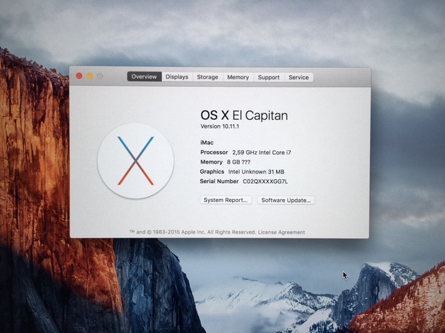

Kestrel.Bright Posted May 18, 2016 Share Posted May 18, 2016 i had installed successful Link to comment https://www.insanelymac.com/forum/topic/312131-installing-a-el-capitan-on-dell-alienware-15r2-skylake-system/#findComment-2238828 Share on other sites More sharing options...
DriveTheOne Posted May 18, 2016 Author Share Posted May 18, 2016 i had installed successful How to you do that? Link to comment https://www.insanelymac.com/forum/topic/312131-installing-a-el-capitan-on-dell-alienware-15r2-skylake-system/#findComment-2238847 Share on other sites More sharing options...

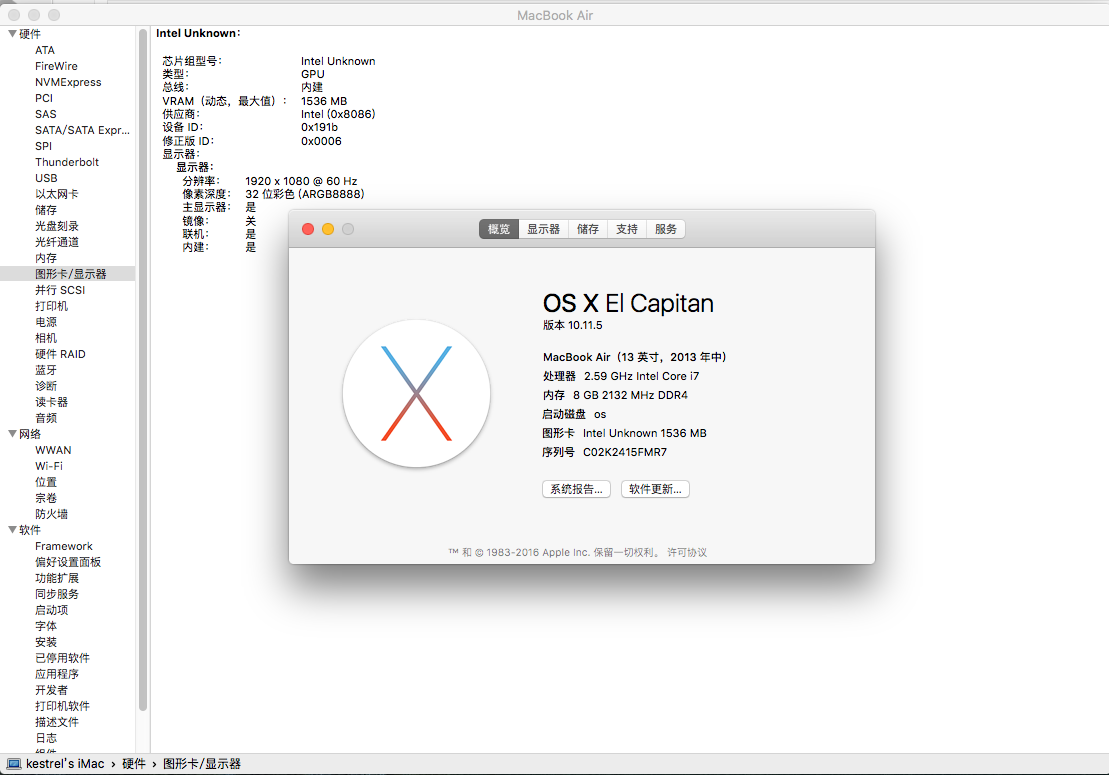

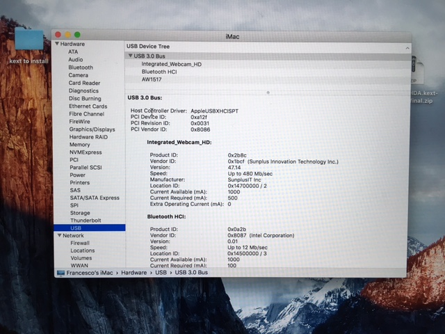

Kestrel.Bright Posted May 18, 2016 Share Posted May 18, 2016 How to you do that? try to fix your usb problem, make your usb injector or change DSDT. use the USBInjectorALL not work for ALW15 r2 or ALW 17r3. maybe i can provide my efi files later. Link to comment https://www.insanelymac.com/forum/topic/312131-installing-a-el-capitan-on-dell-alienware-15r2-skylake-system/#findComment-2238895 Share on other sites More sharing options...

Kestrel.Bright Posted May 19, 2016 Share Posted May 19, 2016 I have the similar set up, can you please post your files here please. But I don't have the SSD the HDD also can be installed ALW15 R2 last EFI.zip Link to comment https://www.insanelymac.com/forum/topic/312131-installing-a-el-capitan-on-dell-alienware-15r2-skylake-system/#findComment-2239042 Share on other sites More sharing options...

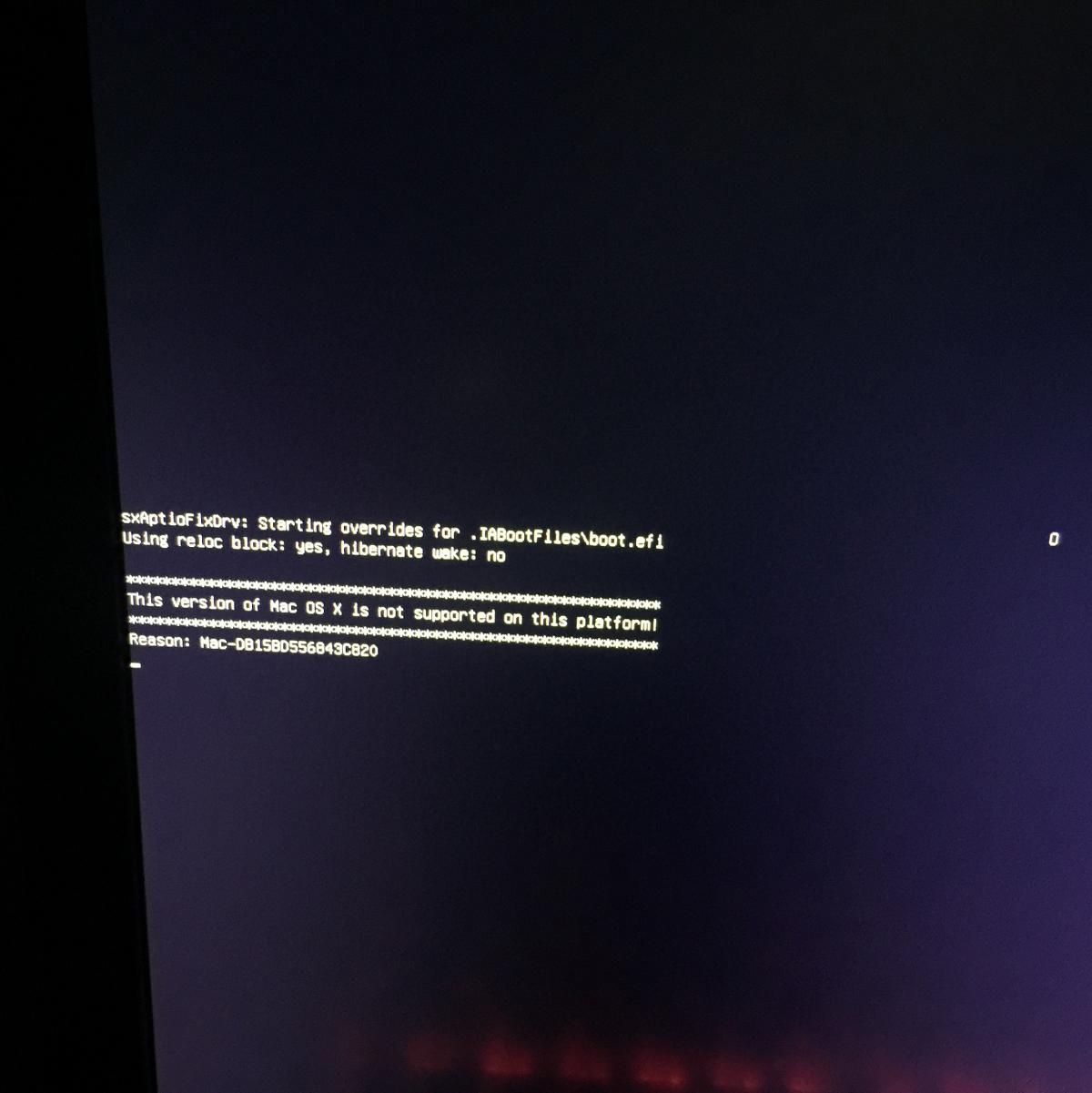

Nick7502 Posted May 19, 2016 Share Posted May 19, 2016 Perfect, I will try this out so I am guessing you used clover ufei and installmedia to make the bootable usb? Which port did you use the right one or the left side ? Tried your efi files, all it says this platform doesn't support osx. Any idea? When I change the smbois it loads then errors out. Link to comment https://www.insanelymac.com/forum/topic/312131-installing-a-el-capitan-on-dell-alienware-15r2-skylake-system/#findComment-2239043 Share on other sites More sharing options...
Kestrel.Bright Posted May 19, 2016 Share Posted May 19, 2016 Perfect, I will try this out so I am guessing you used clover ufei and installmedia to make the bootable usb? Which port did you use the right one or the left side ? Tried your efi files, all it says this platform doesn't support osx. Any idea? When I change the smbois it loads then errors out. Which port did you use the right one or the left side ? i think it's no difference. Tried your efi files, all it says this platform doesn't support osx. Any idea? When I change the smbois it loads then errors out. put the error out. Link to comment https://www.insanelymac.com/forum/topic/312131-installing-a-el-capitan-on-dell-alienware-15r2-skylake-system/#findComment-2239048 Share on other sites More sharing options...
Nick7502 Posted May 19, 2016 Share Posted May 19, 2016 So before I change the smbios I get this error Then when I change smbios it loads then reboots without giving me info. Do you have support cpu enabled ? Link to comment https://www.insanelymac.com/forum/topic/312131-installing-a-el-capitan-on-dell-alienware-15r2-skylake-system/#findComment-2239063 Share on other sites More sharing options...
Kestrel.Bright Posted May 19, 2016 Share Posted May 19, 2016 So before I change the smbios I get this error Then when I change smbios it loads then reboots without giving me info. Do you have support cpu enabled ? HD 530?BIOS setting? clover setting? what do you mean? Link to comment https://www.insanelymac.com/forum/topic/312131-installing-a-el-capitan-on-dell-alienware-15r2-skylake-system/#findComment-2239066 Share on other sites More sharing options...

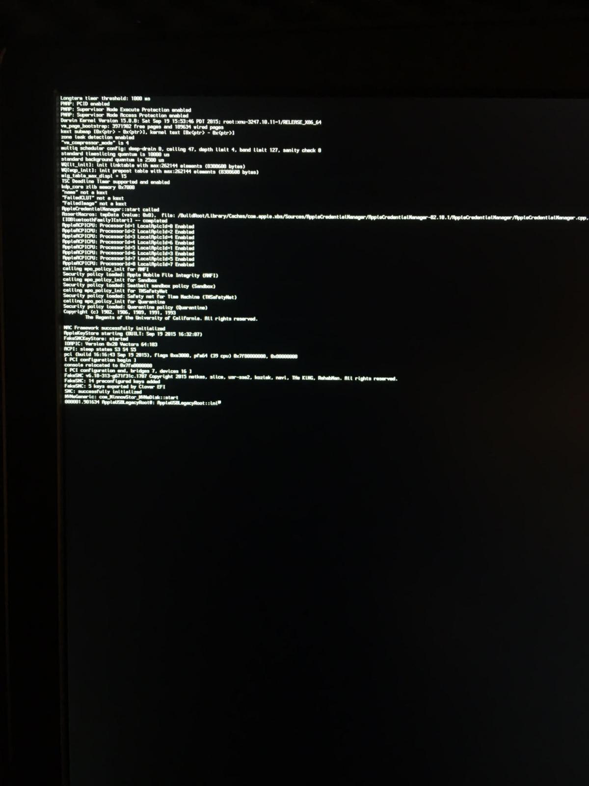

Nick7502 Posted May 19, 2016 Share Posted May 19, 2016 Now I am here.. And that with me enabling Support CPU and nulpower.kext Link to comment https://www.insanelymac.com/forum/topic/312131-installing-a-el-capitan-on-dell-alienware-15r2-skylake-system/#findComment-2239067 Share on other sites More sharing options...

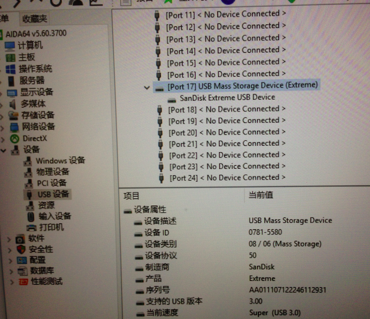

Kestrel.Bright Posted May 19, 2016 Share Posted May 19, 2016 Now I am here.. And that with me enabling Support CPU and nulpower.kext still the usb problem... we have same laptop? can you give your usb port info? Link to comment https://www.insanelymac.com/forum/topic/312131-installing-a-el-capitan-on-dell-alienware-15r2-skylake-system/#findComment-2239074 Share on other sites More sharing options...
Nick7502 Posted May 19, 2016 Share Posted May 19, 2016 still the usb problem... we have same laptop? can you give your usb port info? I have the r3 17. How do I give you my port info? Do I give you the dsdt.aml file? Or do I use aid64? Link to comment https://www.insanelymac.com/forum/topic/312131-installing-a-el-capitan-on-dell-alienware-15r2-skylake-system/#findComment-2239076 Share on other sites More sharing options...
Kestrel.Bright Posted May 19, 2016 Share Posted May 19, 2016 I have the r3 17. How do I give you my port info? AIDA64. test each port with usb2.0 and usb 3.0 drivers. find out which ports are active. like me: usb 2.0 : port1 port2 port9; special : port4 port5 port7; usb 3.0 : port17 port19 port20; ps:maybe you can watch the Rehabman's thread directly.(sorry for my bad english) Link to comment https://www.insanelymac.com/forum/topic/312131-installing-a-el-capitan-on-dell-alienware-15r2-skylake-system/#findComment-2239081 Share on other sites More sharing options...

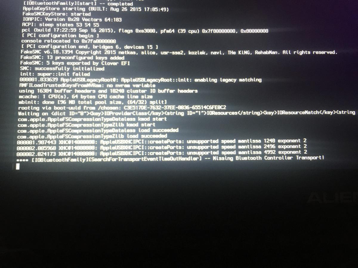

DriveTheOne Posted May 19, 2016 Author Share Posted May 19, 2016 At boot I've this problem: Restart during post boot in verbose mode. Bios: V I/O: disabled. Boot UEFI - no secure boot, legacy disabled. verbose mode: http://imageshack.com/a/img922/6365/TR9iZB.jpg Link to comment https://www.insanelymac.com/forum/topic/312131-installing-a-el-capitan-on-dell-alienware-15r2-skylake-system/#findComment-2239094 Share on other sites More sharing options...

DriveTheOne Posted May 19, 2016 Author Share Posted May 19, 2016 Now I've "still waiting for root devices" after this booting: http://imageshack.com/a/img924/6457/ZDSoz4.jpg why? ps: I've installed the nvmekext 'cause I've Samsung Pro 950 Link to comment https://www.insanelymac.com/forum/topic/312131-installing-a-el-capitan-on-dell-alienware-15r2-skylake-system/#findComment-2239102 Share on other sites More sharing options...
DriveTheOne Posted May 19, 2016 Author Share Posted May 19, 2016 AIDA64. test each port with usb2.0 and usb 3.0 drivers. find out which ports are active. QQ20160120-2.png like me: usb 2.0 : port1 port2 port9; special : port4 port5 port7; usb 3.0 : port17 port19 port20; ps:maybe you can watch the Rehabman's thread directly.(sorry for my bad english) I've a question for you: I've alienware 15R2, with plus: - 16Gb RAM 2x slot - Intel WIFI e BLUETOOTH AC8260 - NVMe Samsung 951 Pro 256Gb Do you have some different configuration in your laptop? Link to comment https://www.insanelymac.com/forum/topic/312131-installing-a-el-capitan-on-dell-alienware-15r2-skylake-system/#findComment-2239119 Share on other sites More sharing options...
Nick7502 Posted May 19, 2016 Share Posted May 19, 2016 AIDA64. test each port with usb2.0 and usb 3.0 drivers. find out which ports are active. QQ20160120-2.png like me: usb 2.0 : port1 port2 port9; special : port4 port5 port7; usb 3.0 : port17 port19 port20; ps:maybe you can watch the Rehabman's thread directly.(sorry for my bad english) All my ports are usb 3.0 When I plug my usb into each port it's Port 1 Port 2 Port 9 I tried rehabmans method. I pretty sure I am doing something wrong. I have the same SATA AHCI controller as you. usb.txt Link to comment https://www.insanelymac.com/forum/topic/312131-installing-a-el-capitan-on-dell-alienware-15r2-skylake-system/#findComment-2239189 Share on other sites More sharing options...

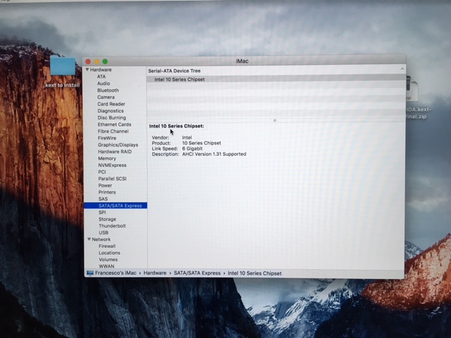

DriveTheOne Posted May 19, 2016 Author Share Posted May 19, 2016 All my ports are usb 3.0 When I plug my usb into each port it's Port 1 Port 2 Port 9 I tried rehabmans method. I pretty sure I am doing something wrong. I have the same SATA AHCI controller as you. You should expand your limits usb ports, for now. write it under KextToPatch with plist editor, in config.plist: <dict> <key>Comment</key> <string>change 15 port limit to 30 in AppleUSBXHCIPCI</string> <key>Find</key> <data> g72M/v//EA== </data> <key>Name</key> <string>AppleUSBXHCIPCI</string> <key>Replace</key> <data> g72M/v//Hw== </data> </dict> and insert the usb injext all. and....... I've successful installed El Capitan, I was stuck with USB port, so I've expanded the limits of number's usb ports. Now, I'm in this point. Working: Sounblaster R3Di -> Work with voodooHDA 2.8.8 version Not Working: Reading wrong memory: 8Gb ram instead 16gb of ram Reading wrong integrated video: HD530 (I've heard that to resolve it, I need 10.11.4 version of El Capitan, isn't true?) Realtek RTS5227 card reader of course: Intel WIFI & Bluetooth 8260AC nvidia 980M (not tried) QHD+ screen resolution retina (maybe I've to install before Intel HD530...) Doubt: about cpu power saving? How can I know if it work or not? the boot is VEEEERY SLOOOOOWW!!! Some photos: Link to comment https://www.insanelymac.com/forum/topic/312131-installing-a-el-capitan-on-dell-alienware-15r2-skylake-system/#findComment-2239193 Share on other sites More sharing options...
Nick7502 Posted May 19, 2016 Share Posted May 19, 2016 You should expand your limits usb ports, for now. write it under KextToPatch with plist editor, in config.plist: <dict> <key>Comment</key> <string>change 15 port limit to 30 in AppleUSBXHCIPCI</string> <key>Find</key> <data> g72M/v//EA== </data> <key>Name</key> <string>AppleUSBXHCIPCI</string> <key>Replace</key> <data> g72M/v//Hw== </data> </dict> and insert the usb injext all. and....... I've successful installed El Capitan, I was stuck with USB port, so I've expanded the limits of number's usb ports. Now, I'm in this point. Working: Sounblaster R3Di -> Work with voodooHDA 2.8.8 version Not Working: Reading wrong memory: 8Gb ram instead 16gb of ram Reading wrong integrated video: HD530 (I've heard that to resolve it, I need 10.11.4 version of El Capitan, isn't true?) Realtek RTS5227 card reader of course: Intel WIFI & Bluetooth 8260AC nvidia 980M (not tried) QHD+ screen resolution retina (maybe I've to install before Intel HD530...) Doubt: about cpu power saving? How can I know if it work or not? the boot is VEEEERY SLOOOOOWW!!! Some photos: I did expand my usb ports and have the injectall kext. Do you mind sharing your efi folder? I am trying to install 10.11.4 Link to comment https://www.insanelymac.com/forum/topic/312131-installing-a-el-capitan-on-dell-alienware-15r2-skylake-system/#findComment-2239200 Share on other sites More sharing options...
