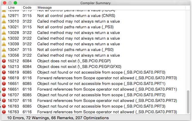

isk k Posted March 12, 2016 Share Posted March 12, 2016 Hello, when I tried to pach my native DSDT.aml the compiler shows some errors.I used pjalm patches.Thank you. MB: Z87М-D3H Video:MSI GTX 960 Gaming 2GB Link to comment https://www.insanelymac.com/forum/topic/311356-dsdt-error-with-pjalm-patches/ Share on other sites More sharing options...

al6042 Posted March 12, 2016 Share Posted March 12, 2016 Hi Ioan, try the attached DSDT. One of the errors came from the change of SAT0 to SATA, which was not consistent through the whole patch. The other one from the change from PEGP to PEG0. I changed both entries manually. Have fun. DSDT.aml.zip 1 Link to comment https://www.insanelymac.com/forum/topic/311356-dsdt-error-with-pjalm-patches/#findComment-2223084 Share on other sites More sharing options...

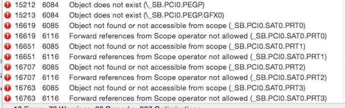

al6042 Posted March 13, 2016 Share Posted March 13, 2016 Sure... In your screenshot the errors were: "Object does not exist" means, that the object isn't available anymore, after the usage of the patches. In that case you must be aware which object was changed by those patches. Since PEGP was changed to PEG0 you just have to rename the lines 15212 and 15213 to point to (\_SB.PCI0.PEG0) and (\_SB.PCI0.PEG0.GFX0) Since SAT0 was changed to SATA you just have to rename the lines 16619, 16651, 16707 and 16763 to point to (\_SB.PCI0.SAT0.xxxx) and (\_SB.PCI0.SATA.xxxx) 2 Link to comment https://www.insanelymac.com/forum/topic/311356-dsdt-error-with-pjalm-patches/#findComment-2223350 Share on other sites More sharing options...
