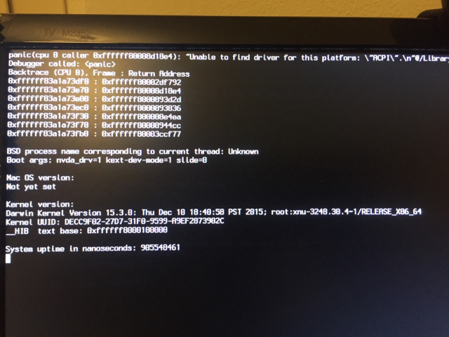

nicozan Posted March 9, 2016 Author Share Posted March 9, 2016 Beh la verità l avremo togliendo la scheda Wi-Fi domani! Intanto mi sto preparando una nuova usbEh sì penso proprio che il problema del boot dipenda dalla schedina broadcom Wi-Fi Bluetooth. Tolta quella da spento , ha subito fatto il boot! Provato 3 volte togliendo corrente, boot Quindi come si può risolvere sta cosa? Non è che posso stare senza la scheda!!! Si sì proprio lei rimessa la scheda si è bloccato! Link to comment https://www.insanelymac.com/forum/topic/311150-problema-di-boot-di-el-capitan/page/7/#findComment-2222131 Share on other sites More sharing options...

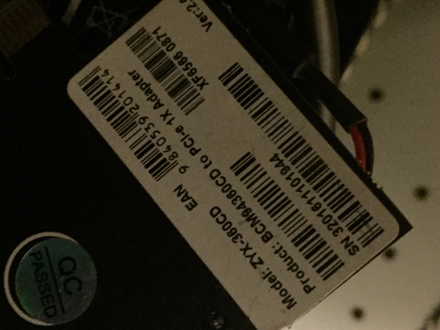

Jolly Posted March 9, 2016 Share Posted March 9, 2016 Senza che vado alla ricerca, mi metti esattamente la sigla della scheda Link to comment https://www.insanelymac.com/forum/topic/311150-problema-di-boot-di-el-capitan/page/7/#findComment-2222159 Share on other sites More sharing options...
nicozan Posted March 9, 2016 Author Share Posted March 9, 2016 Link to comment https://www.insanelymac.com/forum/topic/311150-problema-di-boot-di-el-capitan/page/7/#findComment-2222172 Share on other sites More sharing options...
Jolly Posted March 9, 2016 Share Posted March 9, 2016 Prova flaggare FixAirport nella sezione ACPI del config Link to comment https://www.insanelymac.com/forum/topic/311150-problema-di-boot-di-el-capitan/page/7/#findComment-2222178 Share on other sites More sharing options...
nicozan Posted March 9, 2016 Author Share Posted March 9, 2016 Ti allego intanto un panic report. Può essere utile.Il fix AirPort mi ha dato così ReportPanic.rtf Link to comment https://www.insanelymac.com/forum/topic/311150-problema-di-boot-di-el-capitan/page/7/#findComment-2222185 Share on other sites More sharing options...
Jolly Posted March 9, 2016 Share Posted March 9, 2016 Comincio a essere a corto di idee Link to comment https://www.insanelymac.com/forum/topic/311150-problema-di-boot-di-el-capitan/page/7/#findComment-2222199 Share on other sites More sharing options...

Jolly Posted March 9, 2016 Share Posted March 9, 2016 A guardare meglio la immagine che hai postato è dell'adattatore, sulla scheda wifi non c'è niente? Link to comment https://www.insanelymac.com/forum/topic/311150-problema-di-boot-di-el-capitan/page/7/#findComment-2222213 Share on other sites More sharing options...
nicozan Posted March 9, 2016 Author Share Posted March 9, 2016 A guardare meglio la immagine che hai postato è dell'adattatore, sulla scheda wifi non c'è niente? ecco: http://www.insanelymac.com/forum/topic/310260-chiamate-audio-da-iphone-non-notificate-da-elcapitan/?p=2218077 Link to comment https://www.insanelymac.com/forum/topic/311150-problema-di-boot-di-el-capitan/page/7/#findComment-2222223 Share on other sites More sharing options...

nicozan Posted March 9, 2016 Author Share Posted March 9, 2016 Sinceramente mi sgomento... Pensare di aver preso una scheda nativa e che da questi problemi!!! In giro non ho trovato nessun riferimento all adattatore ! Link to comment https://www.insanelymac.com/forum/topic/311150-problema-di-boot-di-el-capitan/page/7/#findComment-2222243 Share on other sites More sharing options...

nicozan Posted March 10, 2016 Author Share Posted March 10, 2016 Se provassi con il suo adattatore originale che mi è arrivato col modulo? Forse Toleda sa qualcosa.... Come si può contattare??? Link to comment https://www.insanelymac.com/forum/topic/311150-problema-di-boot-di-el-capitan/page/7/#findComment-2222364 Share on other sites More sharing options...
nicozan Posted March 11, 2016 Author Share Posted March 11, 2016 Niente Toleda non sa. Secondo voi questo problema di boot può dipendere dal modulo broadcom o dall adattatore? Per me dovrebbe essere solo L adattatore pci-ex... Link to comment https://www.insanelymac.com/forum/topic/311150-problema-di-boot-di-el-capitan/page/7/#findComment-2222662 Share on other sites More sharing options...

nicozan Posted March 14, 2016 Author Share Posted March 14, 2016 Osxwifi sostiene la tesi del fake cinese! Link to comment https://www.insanelymac.com/forum/topic/311150-problema-di-boot-di-el-capitan/page/7/#findComment-2223669 Share on other sites More sharing options...
Jolly Posted March 14, 2016 Share Posted March 14, 2016 Se ricordo bene l'hai pagata veramente poco, per cui potrebbe essere plausibile. D'altra parte però chi cavolo si mette a clonare per così pochi soldi? E poi è un fake l'adattatore o la scheda WiFi? Quando funzionano come vengono visti WiFi e Bluetooth in informazioni di sistema? Posta immagini Link to comment https://www.insanelymac.com/forum/topic/311150-problema-di-boot-di-el-capitan/page/7/#findComment-2223673 Share on other sites More sharing options...
