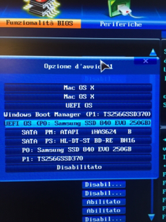

nicozan Posted March 1, 2016 Author Share Posted March 1, 2016 controlla e dimmi cosa hai impostato sul bios primario per il boot Link to comment https://www.insanelymac.com/forum/topic/311150-problema-di-boot-di-el-capitan/page/2/#findComment-2219843 Share on other sites More sharing options...
Jolly Posted March 1, 2016 Share Posted March 1, 2016 Non ci capisco molto di UEFI, ma non sono un po' troppe quelle diciture? Link to comment https://www.insanelymac.com/forum/topic/311150-problema-di-boot-di-el-capitan/page/2/#findComment-2219844 Share on other sites More sharing options...
nicozan Posted March 1, 2016 Author Share Posted March 1, 2016 Eh ma mica le ho messe. Son saltate fuori da sole Link to comment https://www.insanelymac.com/forum/topic/311150-problema-di-boot-di-el-capitan/page/2/#findComment-2219845 Share on other sites More sharing options...
gengik84 Posted March 1, 2016 Share Posted March 1, 2016 Eh ma mica le ho messe. Son saltate fuori da sole per quello ti avevo consigliato il reset del bios.... Link to comment https://www.insanelymac.com/forum/topic/311150-problema-di-boot-di-el-capitan/page/2/#findComment-2219849 Share on other sites More sharing options...
nicozan Posted March 1, 2016 Author Share Posted March 1, 2016 El Capitan è sul ssd Samsung.se mettessi semplicemente quello come prima periferica di boot al posto di Mac OS? Quella dicitura è comparsa da sola! Link to comment https://www.insanelymac.com/forum/topic/311150-problema-di-boot-di-el-capitan/page/2/#findComment-2219852 Share on other sites More sharing options...
Jolly Posted March 1, 2016 Share Posted March 1, 2016 E provare prima con remove all boot option da Clover ? Link to comment https://www.insanelymac.com/forum/topic/311150-problema-di-boot-di-el-capitan/page/2/#findComment-2219853 Share on other sites More sharing options...
nicozan Posted March 1, 2016 Author Share Posted March 1, 2016 Dimmi i passaggi! Link to comment https://www.insanelymac.com/forum/topic/311150-problema-di-boot-di-el-capitan/page/2/#findComment-2219854 Share on other sites More sharing options...
gengik84 Posted March 1, 2016 Share Posted March 1, 2016 El Capitan è sul ssd Samsung.se mettessi semplicemente quello come prima periferica di boot al posto di Mac OS? Quella dicitura è comparsa da sola! "è comparsa da sola" per via dell'installazione, nvram ecc... Dovresti mettere primario il disco, dovrebbe avere dicitura uefi.. Se è come penso...non visualizzerai come dovrebbe essere... E provare prima con remove all boot option da Clover ? può farlo, ma per il discorso nvram, l'unica opzione è il reset 1 Link to comment https://www.insanelymac.com/forum/topic/311150-problema-di-boot-di-el-capitan/page/2/#findComment-2219858 Share on other sites More sharing options...

carbo178 Posted March 1, 2016 Share Posted March 1, 2016 "è comparsa da sola" per via dell'installazione, nvram ecc... Dovresti mettere primario il disco, dovrebbe avere dicitura uefi.. Se è come penso...non visualizzerai come dovrebbe essere... può farlo, ma per il discorso nvram, l'unica opzione è il reset Oppure lanciare la EFI Shell e rimuovere le periferiche fantasma via comando. Ma è più veloce un bel reset del bios Link to comment https://www.insanelymac.com/forum/topic/311150-problema-di-boot-di-el-capitan/page/2/#findComment-2219876 Share on other sites More sharing options...

gengik84 Posted March 1, 2016 Share Posted March 1, 2016 Mi astengo, meglio che segui gengik, na sa certo più di me non è vero...siamo tutti qui per aiutare... Io posso sapere una cosa, tu un altra...ecc ecc...questo è il bello del Forum... Oppure lanciare la EFI Shell e rimuovere le periferiche fantasma via comando. Ma è più veloce un bel reset del bios Faccio sempre un reset, e in alcuni casi se non stacco fisicamente i dischi... anche facendo il reset... tutto torna come prima... Link to comment https://www.insanelymac.com/forum/topic/311150-problema-di-boot-di-el-capitan/page/2/#findComment-2219879 Share on other sites More sharing options...
nicozan Posted March 1, 2016 Author Share Posted March 1, 2016 Prova a fare un reset del bios Stacca l'alimentazione, stacca fisicamente i dischi, rimuovi la pila del bios, tiene premuto il tasto accensione per 15 secondi circa.. Ricollega il tutto e reimposta il bios a modo...compreso il boot primario per il relativo ssd Me la descrivi più in dettaglio la procedura? Link to comment https://www.insanelymac.com/forum/topic/311150-problema-di-boot-di-el-capitan/page/2/#findComment-2219885 Share on other sites More sharing options...
gengik84 Posted March 1, 2016 Share Posted March 1, 2016 Me la descrivi più in dettaglio la procedura? #18 Ricordati le impostazioni del bios le quali dovrai reimpostare dopo il reset Link to comment https://www.insanelymac.com/forum/topic/311150-problema-di-boot-di-el-capitan/page/2/#findComment-2219887 Share on other sites More sharing options...

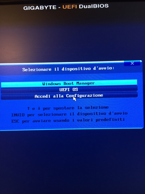

nicozan Posted March 1, 2016 Author Share Posted March 1, 2016 Risultato reset: Ho disabilitato da Bios le entry dalla 3 in poi. Risultato menù F12: Cosa ne dite? Per il momento va. Ci aggiorniamo a domani. Link to comment https://www.insanelymac.com/forum/topic/311150-problema-di-boot-di-el-capitan/page/2/#findComment-2219961 Share on other sites More sharing options...
