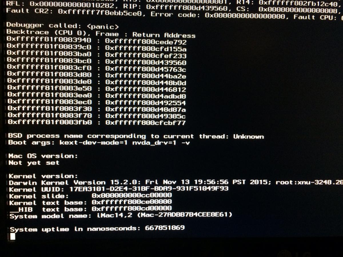

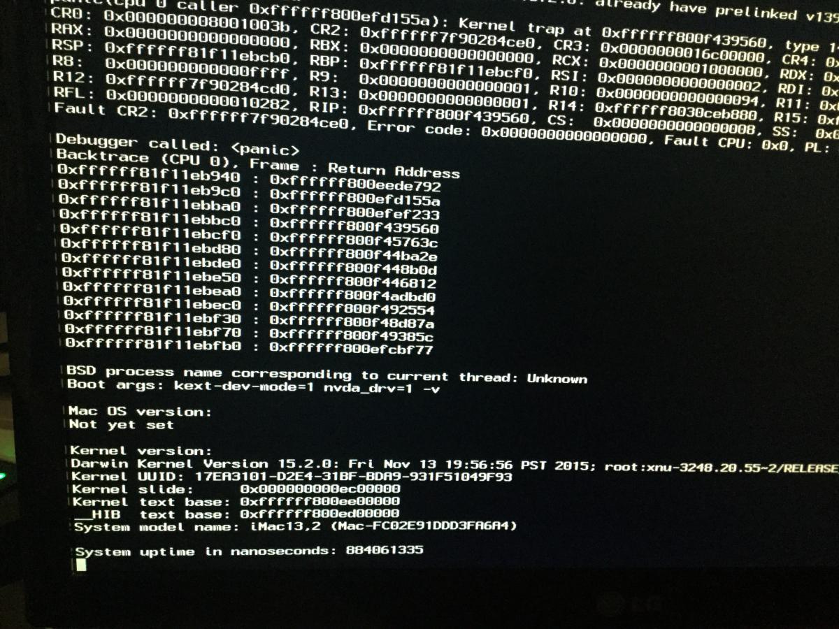

Andreweb83 Posted February 17, 2016 Author Share Posted February 17, 2016 Torno a scrivere dopo un pò, ho installato i kext usb 3.0 che non andavano, tutto ok, dopo di che ha smesso di avviarsi, ecco lo screen, non capisco da che dipenda Link to comment https://www.insanelymac.com/forum/topic/310244-risolto-el-capitan-su-ga-z68x-ud3h-b3/page/3/#findComment-2216286 Share on other sites More sharing options...
gengik84 Posted February 17, 2016 Share Posted February 17, 2016 quali kext? Link to comment https://www.insanelymac.com/forum/topic/310244-risolto-el-capitan-su-ga-z68x-ud3h-b3/page/3/#findComment-2216288 Share on other sites More sharing options...
Andreweb83 Posted February 17, 2016 Author Share Posted February 17, 2016 questi in allegato GenericUSBXHCI.kext.zip Link to comment https://www.insanelymac.com/forum/topic/310244-risolto-el-capitan-su-ga-z68x-ud3h-b3/page/3/#findComment-2216299 Share on other sites More sharing options...
gengik84 Posted February 17, 2016 Share Posted February 17, 2016 hai messo una versione che non va bene per Capitan. Riesci ad avviare in safe mode (-x) ? Link to comment https://www.insanelymac.com/forum/topic/310244-risolto-el-capitan-su-ga-z68x-ud3h-b3/page/3/#findComment-2216300 Share on other sites More sharing options...
Andreweb83 Posted February 17, 2016 Author Share Posted February 17, 2016 niente, in nessun modo, l'unica cosa che posso fare è far partire yosemite che ho su un'altro hd questo è il config, magari ho fatto qualche casino qui! config3.plist.zip Link to comment https://www.insanelymac.com/forum/topic/310244-risolto-el-capitan-su-ga-z68x-ud3h-b3/page/3/#findComment-2216306 Share on other sites More sharing options...
gengik84 Posted February 17, 2016 Share Posted February 17, 2016 Allla Gui di clover, recati nelle opzioni, poi DSDT Fix Mask deseleziona tutti i fix sia old che new way Poi premi esc per tornare alla gui, prova ad avviare Link to comment https://www.insanelymac.com/forum/topic/310244-risolto-el-capitan-su-ga-z68x-ud3h-b3/page/3/#findComment-2216307 Share on other sites More sharing options...
Andreweb83 Posted February 17, 2016 Author Share Posted February 17, 2016 Fatto ma niente, posso operare da yosemite però se vuoi. Link to comment https://www.insanelymac.com/forum/topic/310244-risolto-el-capitan-su-ga-z68x-ud3h-b3/page/3/#findComment-2216310 Share on other sites More sharing options...
gengik84 Posted February 17, 2016 Share Posted February 17, 2016 Se il problema si è presentato dopo aver installato quel kext... Il problema è li Quella versione non va bene per El Capitan Altrimenti devi dire esattamente cosa hai fatto. Puoi provare da Yosemite ad eliminare quel kext, poi ricostruisci le cache di quel disco ovviamente Link to comment https://www.insanelymac.com/forum/topic/310244-risolto-el-capitan-su-ga-z68x-ud3h-b3/page/3/#findComment-2216311 Share on other sites More sharing options...

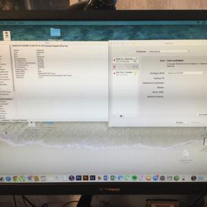

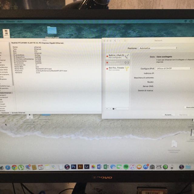

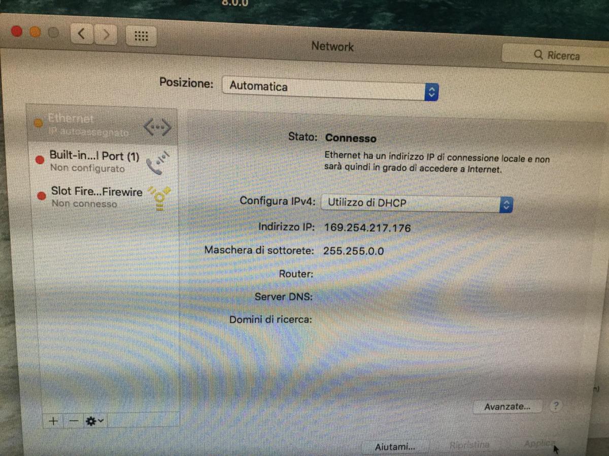

Andreweb83 Posted February 18, 2016 Author Share Posted February 18, 2016 Allora, mi ero dimenticato una cosa very important, quel kext funziona ma a 2.0 da quel che vedo dal resoconto di sistema, ma non era lui che dava problemi di avvio ma qualcosa della scheda di rete, mi è tornato in mente che il problema è cominciato cercando di risolvere il problema della lan che di punto in bianco ha deciso di smettere di funzionare correttamente, mi dà un indirizzo ip sballato e non me lo varia neanche riassegnandolo, in allegato lo screen, adesso sono riuscito a far ripartire correttamente El Capitan ma devo ancora risolvere il problema della lan e dell'usb 3.0 Ecco la foto Link to comment https://www.insanelymac.com/forum/topic/310244-risolto-el-capitan-su-ga-z68x-ud3h-b3/page/3/#findComment-2216431 Share on other sites More sharing options...
Jolly Posted February 18, 2016 Share Posted February 18, 2016 La lan viene rilevata correttamente in Informazioni di sistema/Ethernet? Se si, prova questo: Andare in "Preferenze di sistema/Network" e cancellare tutte le reti con il tasto - ,poi andare in "Home"/Libreria/Preferences/Systemconfiguration,(se non si ha abilitato di vedere i file nascosti, aprire il finder andare su "Vai" e premere il tasto alt, così apparirà la cartella "Libreria") e cancellare "NetworkInterfaces.plist" e "preferences.plist" e infine riavviare. (Controllare che la Ethernet sia en0) Se però il problema fosse la ethernet facile che possa dipendere dal kext che stai usando ( quale è a proposito?) Link to comment https://www.insanelymac.com/forum/topic/310244-risolto-el-capitan-su-ga-z68x-ud3h-b3/page/3/#findComment-2216445 Share on other sites More sharing options...
Andreweb83 Posted February 18, 2016 Author Share Posted February 18, 2016 La scheda è giusta, ma adesso mi da questo dopo aver fatto quello che mi hai detto, kext ne ho provati diversi trovati online, ma anche quello che funzionava, che è incluso nel paci per mia scheda madre che ho postato ad inizio topic non va più 1 Link to comment https://www.insanelymac.com/forum/topic/310244-risolto-el-capitan-su-ga-z68x-ud3h-b3/page/3/#findComment-2216467 Share on other sites More sharing options...
