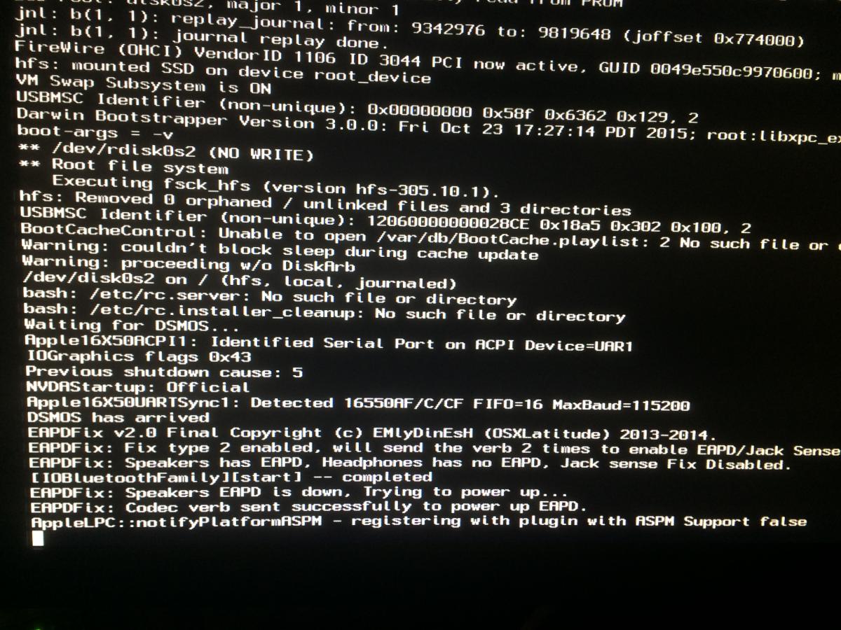

Andreweb83 Posted January 7, 2016 Author Share Posted January 7, 2016 continua a riavviarsi Arriva qui e si riavvia togliendo quella spunta Link to comment https://www.insanelymac.com/forum/topic/310244-risolto-el-capitan-su-ga-z68x-ud3h-b3/page/2/#findComment-2203948 Share on other sites More sharing options...
gengik84 Posted January 7, 2016 Share Posted January 7, 2016 Da usb riesci ad accedere? Link to comment https://www.insanelymac.com/forum/topic/310244-risolto-el-capitan-su-ga-z68x-ud3h-b3/page/2/#findComment-2203964 Share on other sites More sharing options...

gengik84 Posted January 7, 2016 Share Posted January 7, 2016 Importa il config.plist con clover configurator Sezione device/audio/inject metti 1 salva e riavvia. Monta la partizione EFI del HD, poi lancia lo script allegato. Rispondi alle domande e se non si presentano errori, riavvia. Recati in preferenze/audio/ uscita e seleziona quella che stai usando attualmente. audio_cloverALC-110_v1.0n10.command.zip Link to comment https://www.insanelymac.com/forum/topic/310244-risolto-el-capitan-su-ga-z68x-ud3h-b3/page/2/#findComment-2204051 Share on other sites More sharing options...
