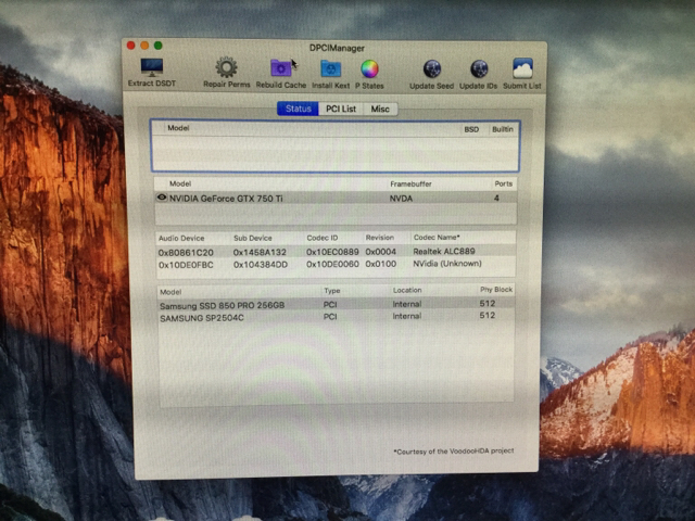

Jolly Posted February 23, 2016 Share Posted February 23, 2016 Dal manuale vedo che ha una utility " SMART LAN (LAN Cable Diagnostic Function) " Prova a lanciarla e vedi cosa riporta Prova anche a disabilitarla, salvare rientrare nel bios ed abilitarla. Fai anche la procedura con dpcimanager Link to comment https://www.insanelymac.com/forum/topic/310244-risolto-el-capitan-su-ga-z68x-ud3h-b3/page/8/#findComment-2217770 Share on other sites More sharing options...
Andreweb83 Posted February 23, 2016 Author Share Posted February 23, 2016 mi sa che è nel bios f12 io ho U1L Link to comment https://www.insanelymac.com/forum/topic/310244-risolto-el-capitan-su-ga-z68x-ud3h-b3/page/8/#findComment-2217773 Share on other sites More sharing options...
Jolly Posted February 23, 2016 Share Posted February 23, 2016 Fai tutto quello che ho detto poco fa Link to comment https://www.insanelymac.com/forum/topic/310244-risolto-el-capitan-su-ga-z68x-ud3h-b3/page/8/#findComment-2217775 Share on other sites More sharing options...

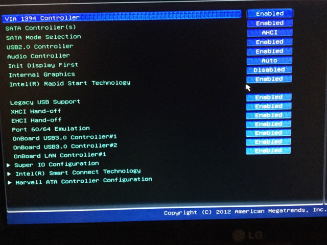

Andreweb83 Posted February 23, 2016 Author Share Posted February 23, 2016 dal mio bios non ci sono quelle opzioni, mi sa che erano nella versione base del bios, la F12, cosa altro dici di controllare? Link to comment https://www.insanelymac.com/forum/topic/310244-risolto-el-capitan-su-ga-z68x-ud3h-b3/page/8/#findComment-2217776 Share on other sites More sharing options...

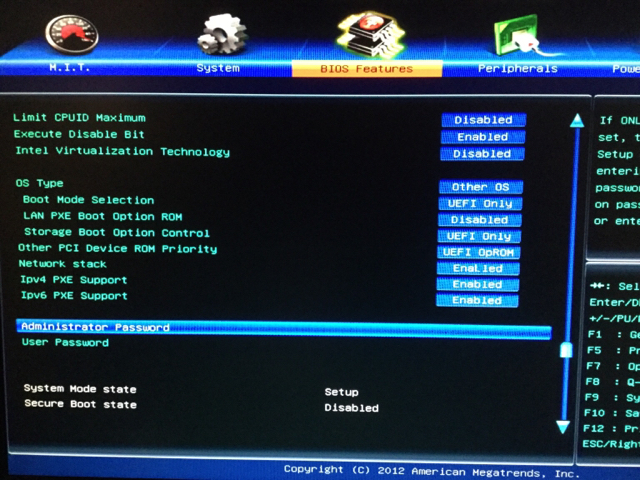

Jolly Posted February 23, 2016 Share Posted February 23, 2016 cerca nel bios una voce PCI ROM Priority e dimmi come è settata Link to comment https://www.insanelymac.com/forum/topic/310244-risolto-el-capitan-su-ga-z68x-ud3h-b3/page/8/#findComment-2217777 Share on other sites More sharing options...
Andreweb83 Posted February 23, 2016 Author Share Posted February 23, 2016 se guardi la seconda foto del bios che ho messo prima si vede Link to comment https://www.insanelymac.com/forum/topic/310244-risolto-el-capitan-su-ga-z68x-ud3h-b3/page/8/#findComment-2217778 Share on other sites More sharing options...
Jolly Posted February 23, 2016 Share Posted February 23, 2016 cerc abche network stack Mettilo su disabled Link to comment https://www.insanelymac.com/forum/topic/310244-risolto-el-capitan-su-ga-z68x-ud3h-b3/page/8/#findComment-2217779 Share on other sites More sharing options...
Andreweb83 Posted February 23, 2016 Author Share Posted February 23, 2016 il resto lo lascio com'è? fatto, nulla è cambiato Link to comment https://www.insanelymac.com/forum/topic/310244-risolto-el-capitan-su-ga-z68x-ud3h-b3/page/8/#findComment-2217781 Share on other sites More sharing options...

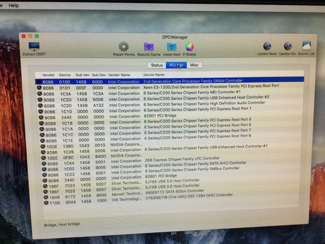

Jolly Posted February 23, 2016 Share Posted February 23, 2016 fai dpcimanager Quando hai messo il Bios Ul1? Link to comment https://www.insanelymac.com/forum/topic/310244-risolto-el-capitan-su-ga-z68x-ud3h-b3/page/8/#findComment-2217784 Share on other sites More sharing options...
Andreweb83 Posted February 23, 2016 Author Share Posted February 23, 2016 da 2 anni circa Link to comment https://www.insanelymac.com/forum/topic/310244-risolto-el-capitan-su-ga-z68x-ud3h-b3/page/8/#findComment-2217793 Share on other sites More sharing options...
Jolly Posted February 23, 2016 Share Posted February 23, 2016 Il bios quando lo hai aggiornato alla Ul1? Non c'è traccia di lan nel report Link to comment https://www.insanelymac.com/forum/topic/310244-risolto-el-capitan-su-ga-z68x-ud3h-b3/page/8/#findComment-2217797 Share on other sites More sharing options...

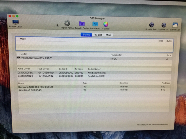

Jolly Posted February 23, 2016 Share Posted February 23, 2016 non hai molto da fare oltre lanciare lo script di toleda per l'audio. Ricordati di montare la EFI prima di lanciarlo. Rispondi y a tutte le domande che ti fá. Link to comment https://www.insanelymac.com/forum/topic/310244-risolto-el-capitan-su-ga-z68x-ud3h-b3/page/8/#findComment-2217832 Share on other sites More sharing options...

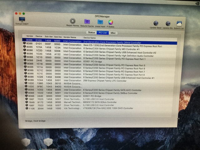

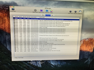

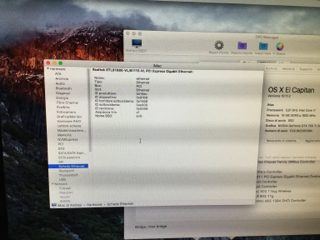

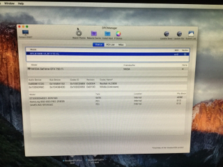

Andreweb83 Posted February 23, 2016 Author Share Posted February 23, 2016 dunque ho provato a montare 2 schede wifi che ho trovato in casa per vedere che chipset montano e magicamente è tornata a vivere anche la lan ma non funziona... però la vedo! Link to comment https://www.insanelymac.com/forum/topic/310244-risolto-el-capitan-su-ga-z68x-ud3h-b3/page/8/#findComment-2217837 Share on other sites More sharing options...
Jolly Posted February 23, 2016 Share Posted February 23, 2016 Non so che dirti. Il compoortamento non é normale. Prova a riflashare il bios. Che kext hai installato al momento? Con yosemite ti funziona? Link to comment https://www.insanelymac.com/forum/topic/310244-risolto-el-capitan-su-ga-z68x-ud3h-b3/page/8/#findComment-2217842 Share on other sites More sharing options...

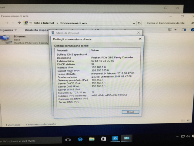

Andreweb83 Posted February 23, 2016 Author Share Posted February 23, 2016 sto provando proprio adesso ad avviare yosemite... ti dico tra poco comunque penso che per togliermi ogni dubbio farò un'istallazione windows al volo per vedere se li funziona Link to comment https://www.insanelymac.com/forum/topic/310244-risolto-el-capitan-su-ga-z68x-ud3h-b3/page/8/#findComment-2217843 Share on other sites More sharing options...
Andreweb83 Posted February 24, 2016 Author Share Posted February 24, 2016 dunque dunque, da yosemite non va nemmeno, adesso ho installato al volo un windows 10 per provare l'ethernet e funziona perfettamente quindi possiamo escludere il problema hardware a questo punto c'è qualcosa che posso provare a variare direttamente in fase di installazione visto che devo reinstallare el capitan? Link to comment https://www.insanelymac.com/forum/topic/310244-risolto-el-capitan-su-ga-z68x-ud3h-b3/page/8/#findComment-2217896 Share on other sites More sharing options...
Andreweb83 Posted February 24, 2016 Author Share Posted February 24, 2016 sto quasi gridando al miracolo... ho reinstallato e messo subito il kext della lan prima di installare clover e magicamente la scheda funziona a questo punto ho quasi paura ad andare avanti... attendo vostri consigli Link to comment https://www.insanelymac.com/forum/topic/310244-risolto-el-capitan-su-ga-z68x-ud3h-b3/page/8/#findComment-2217900 Share on other sites More sharing options...
