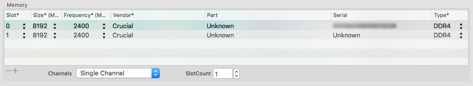

Sparrow1029 Posted May 16, 2016 Share Posted May 16, 2016 memtest recognizes my RAM as far as I can tell, and a few frustrating boots ago, I got the System to read my Crucial 2x8GB 2133 DDR4 DIMMs using the Clover Configurator fix above (I inserted the generated <key>Memory</key> entry into my config.plist via textedit). After a few more hiccups during my install, I have a stable boot of 10.11.4, and now no matter which of those values I change, (memory or test) the system profiler still sees 2 DIMMs at 4GB each (8GB total) and 3200Mhz. Like I said memtest sees all the RAM, and it checks out okay, but Photoshop has this weird issue when I try to change performance settings, and I think it's because my system doesn't have the proper RAM profile. I don't know, I'm at a loss. I guess this may be more of a Photoshop/CUDA/NVidia issue, but I can't seem to find a solution anywhere. The joys of hackintosh What would adding manual entries into the <key>Slots</key> part of SMBIOS do? I'm not really clear on how to use that. Link to comment https://www.insanelymac.com/forum/topic/309226-os-x-is-only-recognizing-half-of-my-ram/page/2/#findComment-2238284 Share on other sites More sharing options...
onx Posted July 8, 2016 Share Posted July 8, 2016 I have Crucial 16 GB and my system (Gigabyte MB) showed only a half (system information and memtest). I add two records with 8 GB items in Clover's SMBIOS section and after that system information and memtest shows 16 GB. Good luck! Link to comment https://www.insanelymac.com/forum/topic/309226-os-x-is-only-recognizing-half-of-my-ram/page/2/#findComment-2249503 Share on other sites More sharing options...
Sparrow1029 Posted July 11, 2016 Share Posted July 11, 2016 Thanks onx! I forgot to post that I solved my issue...after combing through all the boards, I realized I had added the records in the SMBIOS section of the Clover config.plist with ONE little extra </dict> where it shouldn't have been. Remove that, reboot, vóila! Totally worked. Coincidentally, that also solved a really weird bug with Photoshop: Couldn't get graphics acceleration to work with the program because it depended on the System Profiler for information about memory allocation, anytime I selected the "Performance" Tab under Preferences>General, an error message would come up with a negative reading of the number of pages of memory available to the system. As my friend in IT says, "It's always something stupid." *sigh* Syntax Link to comment https://www.insanelymac.com/forum/topic/309226-os-x-is-only-recognizing-half-of-my-ram/page/2/#findComment-2250807 Share on other sites More sharing options...

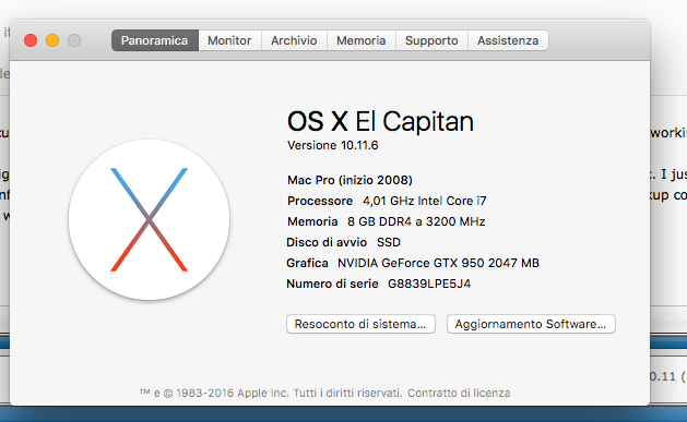

simomessi92 Posted July 20, 2016 Share Posted July 20, 2016 Guys yesterday I've done my first mackintosh, so far I've high rpm fan speed and thid ram problem discussed on this post. I've tried to manually add the ram modules in clover configurator, I've saved the config file into the EFI partition and after rebooted the clover boot GUI had changed and it wouldn't allow me to boot. It appears the Apple but without the loading bar under it. I've tried to control even the command in the clover option at the boot nvda_drv=1 ecc.. no way to log in ... Only with the rescue key make with [url="http://www.insanelymac.com/forum/topic/279450-why-insanelymac-does-not-support-tonymacx86/"]#####[/url] I was able to boot into the system, and it doesn't have any Nvidia web drivers load in. In a few world after doing this procedure I wouldn't been able to boot straight from the SSD in which the system was, and I had to reinstall everything from the beginning... Should someone text point by point what to do to solve this problem ? Actually I'm running a 16gb 2x8 ddr4 corsair ram into a gigabyte z170n gaming 5 it moba. Thabk for the help. PS on system info about this Mac it says I've 4 modules with 2x4 GB ram modules Instead as I said I've got 2 modules of 8gb which are mounted on an itx moba Link to comment https://www.insanelymac.com/forum/topic/309226-os-x-is-only-recognizing-half-of-my-ram/page/2/#findComment-2255131 Share on other sites More sharing options...
Sparrow1029 Posted July 20, 2016 Share Posted July 20, 2016 Guys yesterday I've done my first mackintosh, so far I've high rpm fan speed and thid ram problem discussed on this post. I've tried to manually add the ram modules in clover configurator, I've saved the config file into the EFI partition and after rebooted the clover boot GUI had changed and it wouldn't allow me to boot. It appears the Apple but without the loading bar under it. I've tried to control even the command in the clover option at the boot nvda_drv=1 ecc.. no way to log in ... Only with the rescue key make with ##### I was able to boot into the system, and it doesn't have any Nvidia web drivers load in. In a few world after doing this procedure I wouldn't been able to boot straight from the SSD in which the system was, and I had to reinstall everything from the beginning... Should someone text point by point what to do to solve this problem ? Actually I'm running a 16gb 2x8 ddr4 corsair ram into a gigabyte z170n gaming 5 it moba. Thabk for the help. PS on system info about this Mac it says I've 4 modules with 2x4 GB ram modules Instead as I said I've got 2 modules of 8gb which are mounted on an itx moba So can you boot into your system currently? And is your problem with the RAM being recognized, or NVidia graphics acceleration not working? Personally, I didn't use Clover Configurator for my .plist, because unless you fill it out COMPLETELY it doesn't fill in Kexts to patch, etc. I just added the entries for things I needed manually to the config.plist in the EFI>EFI>CLOVER directory (also, once you get a working .plist file, I'd save a backup copy right next to it called backup.plist, just in case you mess with it and can't boot, you can point Clover at the backup file to boot from) Link to comment https://www.insanelymac.com/forum/topic/309226-os-x-is-only-recognizing-half-of-my-ram/page/2/#findComment-2255268 Share on other sites More sharing options...

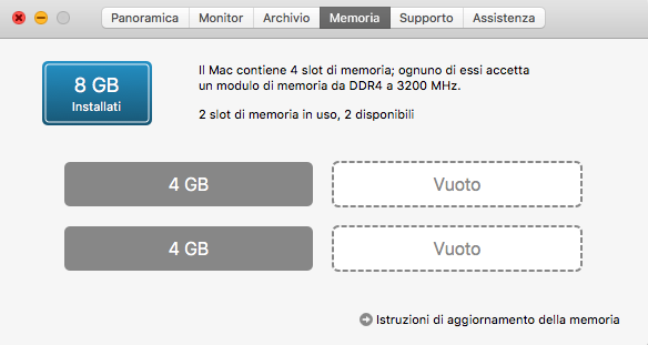

simomessi92 Posted July 21, 2016 Share Posted July 21, 2016 So can you boot into your system currently? And is your problem with the RAM being recognized, or NVidia graphics acceleration not working? Personally, I didn't use Clover Configurator for my .plist, because unless you fill it out COMPLETELY it doesn't fill in Kexts to patch, etc. I just added the entries for things I needed manually to the config.plist in the EFI>EFI>CLOVER directory (also, once you get a working .plist file, I'd save a backup copy right next to it called backup.plist, just in case you mess with it and can't boot, you can point Clover at the backup file to boot from) In the bios I see 16 gb of ram on the OS X I see 8 gb the weird thing is that OS X seems to see 2 of 4 banks of 4 gb dimm slots, instead I had actually 2x8gb ddr4 ram for a total amount of 16 gb , actually I'm managing with the gigabyte z170n gaming 5 so it's an itx board, which of course had only 2 slots, not 4 as OS X show me... I'll attach some screenshots. I can boot normally, no problem with any other peripherals, only this ram problem. Link to comment https://www.insanelymac.com/forum/topic/309226-os-x-is-only-recognizing-half-of-my-ram/page/2/#findComment-2255692 Share on other sites More sharing options...
Sparrow1029 Posted July 21, 2016 Share Posted July 21, 2016 Yep, that's the same thing that kept happening to me Open a terminal and mount your EFI partition using diskutil list to see the names of the Volumes on your system—disk0s0, disk0s1, etc. and then diskutil mount ... replacing the '...' with the name of your EFI partition. Go into EFI>EFI>CLOVER and open your config.plist in TextEdit Scroll down (or ⌘F, search) to <key>SMBIOS</key> and follow the format found here to manually insert your Memory module info under that section. You can specify the number of slots, and you don't have to enter in a part number or serial number as long as you put <string>Unknown</string>. Save your .plist, exit and reboot—Let me know if that solves your problem. Link to comment https://www.insanelymac.com/forum/topic/309226-os-x-is-only-recognizing-half-of-my-ram/page/2/#findComment-2255785 Share on other sites More sharing options...
simomessi92 Posted July 21, 2016 Share Posted July 21, 2016 Yep, that's the same thing that kept happening to me Open a terminal and mount your EFI partition using diskutil list to see the names of the Volumes on your system—disk0s0, disk0s1, etc.and then diskutil mount ... replacing the '...' with the name of your EFI partition. Go into EFI>EFI>CLOVER and open your config.plist in TextEditScroll down (or ⌘F, search) to <key>SMBIOS</key> and follow the format found here to manually insert your Memory module info under that section. You can specify the number of slots, and you don't have to enter in a part number or serial number as long as you put <string>Unknown</string>. Save your .plist, exit and reboot—Let me know if that solves your problem. at the end I got it via clover configurator , I don't know what happened the two times I've tried before, but it worked as I've chosen dual channel and setted 8gb each slot and it had worked ! Thank you for your support ! Now I've got a fully and rocking hackintosh Link to comment https://www.insanelymac.com/forum/topic/309226-os-x-is-only-recognizing-half-of-my-ram/page/2/#findComment-2255890 Share on other sites More sharing options...
