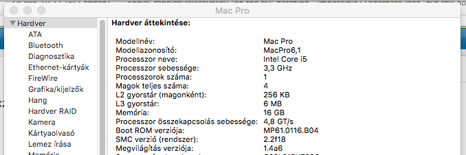

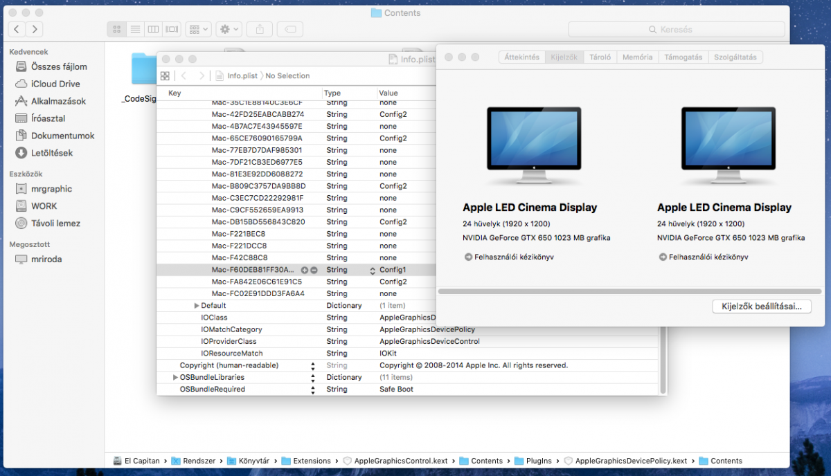

Mr.Graphic Posted November 26, 2015 Share Posted November 26, 2015 @cacekpawon Great Idea! Work with OS X 10.11.2 El Capitan I renamed the DSDT.aml in PEGP ➝ GFX1, GFX0 ➝ GFX2. Original AppleGraphicsControl.kext S / L / E. GTX650 working multiple displays. Thank you! 1 Link to comment https://www.insanelymac.com/forum/topic/308790-applegraphicsdevicepolicy-on-the-fly-patching-impossible-alternate-idea-but-still-does-not-seem-to-work/page/2/#findComment-2191953 Share on other sites More sharing options...
