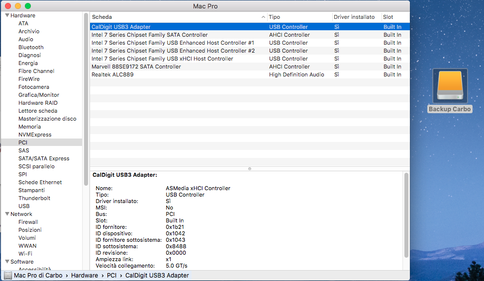

With the system in my signature finally got ASMedia 1042 working with dsdt edit and old caldigit kexts, but don't show the external device nor controller in System Profiler - USB

second to carbo178. usb3 port not detected in system information-USB, maybe because messy DSDT, but old caldigit i used in ML and Yosemite could be loaded, and USB 2 flashdisk is detected. cant test its speed since dont have usb3 device.
The property for listing USB devices in El Capitan has been renamed so that's why ports and devices won't show up in System Profiler when using "old" kexts. Still, it's nice to have working ports again ;)
AsMedia is correctly injected in DSDT, otherwise don't show peripheral into System Profiler

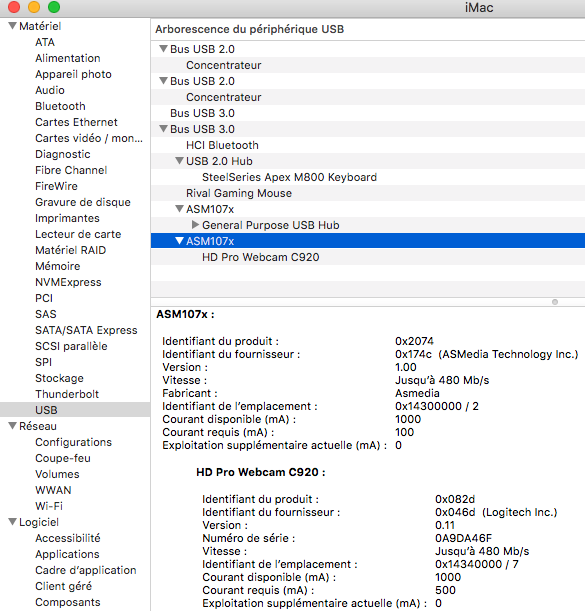

I know that my ports can't reach 5gb/s they are locked to 480mb/s
And here a screen of my "usb 3.0" informations, i am not sure but you speak about ASMedia 1042 but thing that i have 107x ?
Please help me :)
