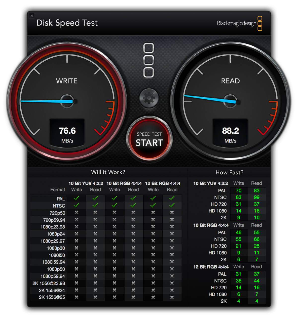

qwaak Posted December 11, 2015 Share Posted December 11, 2015 As with the latest OS X 10.11.2 El Capitan release, my ASMedia USB 3.0 ports (ASUS X99-A board) are working full speed. Life's good. Link to comment https://www.insanelymac.com/forum/topic/307756-how-to-fix-asmedia-usb-30-on-el-capitan/#findComment-2196027 Share on other sites More sharing options...

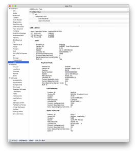

qwaak Posted December 12, 2015 Share Posted December 12, 2015 Update regarding ASMedia USB 3.0 on OS X 10.11.2: while external USB 3.0 disks are working natively, external USB sound cards aren't. Also, my system report is not listing a USB 3.0 bus at all, even while external disks are mounted. Any hints for a fix? ASM1074 is a hub, AFAIK that board has 1x ASM1042 (xHCI controller) + 2x ASM1074 (hubs). An IOReg would be useful. IOReg attached. osx101102.ioreg.zip Link to comment https://www.insanelymac.com/forum/topic/307756-how-to-fix-asmedia-usb-30-on-el-capitan/#findComment-2196214 Share on other sites More sharing options...
lassard Posted December 12, 2015 Share Posted December 12, 2015 ASM1074 is a hub, AFAIK that board has 1x ASM1042 (xHCI controller) + 2x ASM1074 (hubs). I don't know a lot about this stuff, anyway specialized hardware websites seem to mention 1042 and 1074 as equivalent in terms of functionality, e.g. "ten USB 3.0 ports, six soldered on the motherboard rear panel (five of them controlled by one ASMedia ASM1074 chip and one ASMedia ASM1042 chip)" looking at the IOReg, it mentions the usage of GenericUSBXHCI kext (interesting, so far I had only read people claiming about KPs with that kext on El Cap) and there's no mention to ASM1042, although there is to 107x. qwaak, based on the website I linked above, I would suggest to test all of the rear panel USB ports, I believe one of them should not work... Link to comment https://www.insanelymac.com/forum/topic/307756-how-to-fix-asmedia-usb-30-on-el-capitan/#findComment-2196275 Share on other sites More sharing options...
qwaak Posted December 12, 2015 Share Posted December 12, 2015 USB 3.0 disks are working natively, external USB sound cards aren't. Update: external USB audio card is working. It takes about 15 seconds until it is activated. I believe one of the ports should not work I checked all the ports, you're right. Not all ports are working. More details in the attached text file. AsusX99A-USB3.txt Link to comment https://www.insanelymac.com/forum/topic/307756-how-to-fix-asmedia-usb-30-on-el-capitan/#findComment-2196395 Share on other sites More sharing options...
qwaak Posted December 12, 2015 Share Posted December 12, 2015 Update: with another disk, both front USB 3.0 ports are working. Maybe related to controller or cable. Link to comment https://www.insanelymac.com/forum/topic/307756-how-to-fix-asmedia-usb-30-on-el-capitan/#findComment-2196420 Share on other sites More sharing options...

Andres ZeroCross Posted December 12, 2015 Share Posted December 12, 2015 Update regarding ASMedia USB 3.0 on OS X 10.11.2: while external USB 3.0 disks are working natively, external USB sound cards aren't. Also, my system report is not listing a USB 3.0 bus at all, even while external disks are mounted. Any hints for a fix? IOReg attached. Vendor ID 0x8087,, it's Intel not Asmedia. Am i right?? Link to comment https://www.insanelymac.com/forum/topic/307756-how-to-fix-asmedia-usb-30-on-el-capitan/#findComment-2196486 Share on other sites More sharing options...
TheRacerMaster Posted December 12, 2015 Share Posted December 12, 2015 Vendor ID 0x8087,, it's Intel not Asmedia. Am i right?? Yes, but those are the Intel EHCI (USB 2.0) controllers. His board has an Intel XHCI (USB 3.0) & ASMedia XHCI (USB 3.0), both of which are using GenericUSBXHCI. Currently GenericUSBXHCI won't show up under System Information. So it looks like third-party driver support has been fixed to some degree with 10.11.2. Yep, also can confirm that GenericUSBXHCI is working in 10.11.2. 1 Link to comment https://www.insanelymac.com/forum/topic/307756-how-to-fix-asmedia-usb-30-on-el-capitan/#findComment-2196527 Share on other sites More sharing options...
