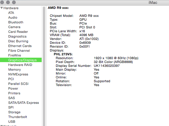

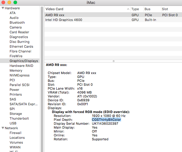

Hey, I would like to know what do you see in System Information - Graphics/Displays, under your monitors "pixel depth" row?
Because in my case it says some nonsense lol "CGSThirtyBitColor" while on Yosemite it says "32-bit Color (ARGB8888)"
Obviously I'm using EDID override, but it's the same nonsense without override, so maybe we're up to something... lol
How to force "32-bit Color (ARGB888)" under El Capitan?

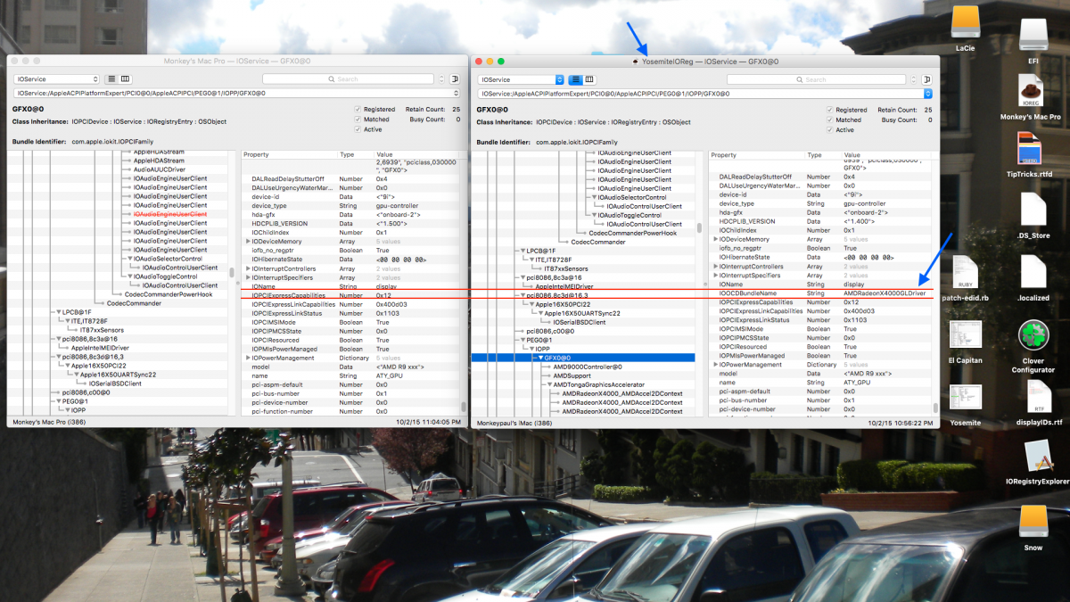

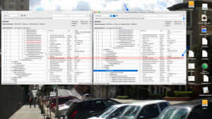

OK, we're moving a little bit further, remember my retarded post about rolling back kexts from Yosemite and then noticing that there's something with AMDRadeonX4000GLDriver.bundlehttp://www.insanelymac.com/forum/topic/307248-r9-380-cant-boot-directly-have-to-do-it-via-intel-4600-ghost-monitor/?p=2171101
So now I'm on a clean El capitan system, no kexts are tempered with, because yesterday or day before yesterday I've update El Capitan to a new version 15B22c. Plus I always carefully put things back to their places after testing.
So today I booted as usually with a monitor connected to ATI card and IGPU set in BIOS as a Primary, to both Yosemite and El Capitan, Saved their IORegs and noticed one thing that on El Capitan under "GFX0@0" there's no reference to AMDRadeonX4000GLDriver. I've looked at my older IORegs of El Capitan and there was never a reference to it under El Capitan, while under Yosemite there is.
Any Ideas? this might be the thing?
I'm attaching both IOregs.
El_CapitanIOReg.zip
YosemiteIOReg.zip
Yes, I was thinking the same, maybe some SSDT injection, this is probably the final wall for me, I've no clue how and what to do next, and this looks like the closest thing I've gotten to identifying a possible problem or maybe it's just a meaningless string, anyway, see you in hell, this is it for me, my empirical tinkering ends here.

OK guys, the solution must be in that "CGSThirtyBitColor".
Because when booting via IGPU with a monitor connected to PCI, it f***ing injects that retarded "CGSThirtyBitColor" space under R9 380,
if booting via IGPU with a monitor connected to IGPU it injects normal "32-bit Color (ARGB888)" under IGPU, when reconnecting a monitor to PCI and reloading System information window, it says "32-bit Color (ARGB888)" under R9 380
So it means that when booting via PCI, R9 380 gets injected with CGSThirtyBitColor heroin, and after verbose screen, most likely that "loading apple" transitional screen can't handle CGSThirtyBitColor heroin, so it doesn't find what it's looking for and card gets unloaded or whatever, system stops, dark void, no life.
When booting via IGPU, but monitor connected to PCI, IGPU handles that transitional screen, hence it gets injected with a pure 32-bit Color (ARGB888) cocaine, having its needs satisfied, it allows to pass transitional screen by and load OS, when OS is about to load a screen, it realizes that where's no monitor connected to IGPU so it shows main screen on PCI.
That's all theory, I've no clue, but CGSThirtyBitColor is out of place here, because as I mentioned in post #92, there's no CGSThirtyBitColor on Yosemite.

El_Capitan_Via_IGPU_connected_to_IGPU.zip
After reboot I'll attach IORegs, one from system loaded via IGPU, monitor connected to PCI, and one loaded via IGPU, monitor connected to IGPU.
CGThirtBitColor is just a coloring profile which is used from the EDID, you should try the same method that people with a 280 uses which is in the forums, 380 is just a rebranded 280.
