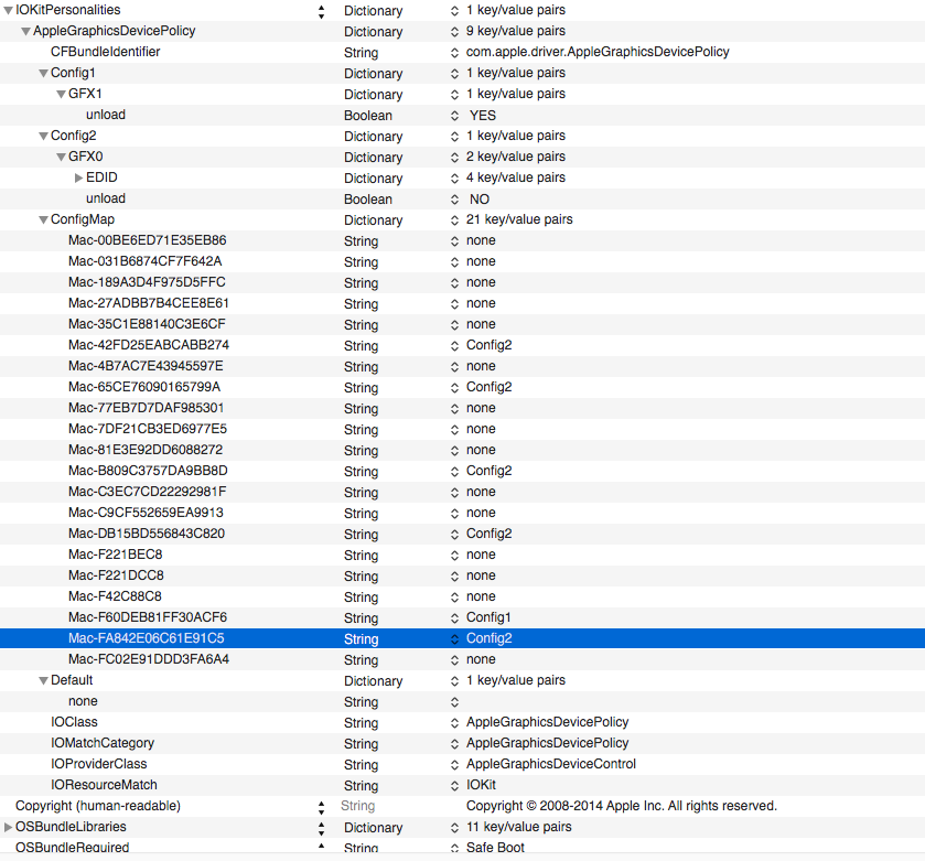

pcpaul Posted October 5, 2015 Author Share Posted October 5, 2015 Something maybe relevant, more relevant than color profiles for sure. Some guys had the same problem as me on real Mac Pro's (Late 2013), they claimed that it worked on Dev Beta 1, but not on 2,3 and 4, so I've figured out d300 ID, didn't looked into other cards, and checked out the main kexts, for it, it's AMDRadeonX4000.kext and AMD7000Controller.kext. 4000 were identical apart from versions difference. 7000 didn't have "properties" sections under <key>ATY,Tako</key> at all, while beta 4 had <key>aty_properties</key> <dict> <key>PP_EnableLoadPostProductionFirmware</key> <integer>1</integer> </dict> Also checked graphics policy kext, the main difference was that Beta 1 had more EDID keys under gfx2, Beta4 had only one EDID key. So I've checked 9000.kext of Yosemite against el Capitan and this time I've noticed that there's a difference under Controller - aty_properties key, under Yosemite there's a key under it called <key>PP_EnableLoadPostProductionFirmware</key> under El Capitan it's called <key>PP_EnableLoadFalconSmcFirmware</key> so just giving a quick look it's easy to miss it. I've tried changing it to PP_EnableLoadPostProductionFirmware, and after verbose system entered the same "void", but this time it did it with IGPU too, also tried with deleted all properties, it boots into "void" but with IGPU it boots fully. Tried changing it to zero zero, the same void, igpu boots fully. <?xml version="1.0" encoding="UTF-8"?> <!DOCTYPE plist PUBLIC "-//Apple//DTD PLIST 1.0//EN" "http://www.apple.com/DTDs/PropertyList-1.0.dtd"> <plist version="1.0"> <dict> <key>BuildMachineOSBuild</key> <string>15B17c</string> <key>CFBundleDevelopmentRegion</key> <string>English</string> <key>CFBundleExecutable</key> <string>AMD9000Controller</string> <key>CFBundleGetInfoString</key> <string>AMD9000Controller 1.38.3 15905</string> <key>CFBundleIdentifier</key> <string>com.apple.kext.AMD9000Controller</string> <key>CFBundleInfoDictionaryVersion</key> <string>6.0</string> <key>CFBundleName</key> <string>Radeon HD 9000 Controller</string> <key>CFBundlePackageType</key> <string>KEXT</string> <key>CFBundleShortVersionString</key> <string>1.38.3</string> <key>CFBundleSignature</key> <string>????</string> <key>CFBundleSupportedPlatforms</key> <array> <string>MacOSX</string> </array> <key>CFBundleVersion</key> <string>1.3.8</string> <key>DTCompiler</key> <string>com.apple.compilers.llvm.clang.1_0</string> <key>DTPlatformBuild</key> <string>7A176g</string> <key>DTPlatformVersion</key> <string>GM</string> <key>DTSDKBuild</key> <string>15B17c</string> <key>DTSDKName</key> <string>macosx10.11internal</string> <key>DTXcode</key> <string>0700</string> <key>DTXcodeBuild</key> <string>7A176g</string> <key>IOKitPersonalities</key> <dict> <key>Controller</key> <dict> <key>ATY,Basset</key> <dict> <key>aty_config</key> <dict> <key>CFG_DEF_DITH</key> <integer>0</integer> <key>CFG_NVV</key> <integer>2</integer> <key>CFG_PTPL2_TBL</key> <data> bgAAAGwAAABpAAAAZwAAAGUAAABjAAAAYAAA AF4AAABcAAAAWQAAAFcAAABVAAAAUwAAAFAA AABOAAAAMgAAAA== </data> <key>CFG_USE_AGDC</key> <true/> </dict> </dict> <key>ATY,Labrador</key> <dict> <key>aty_config</key> <dict> <key>CFG_DEF_DITH</key> <integer>0</integer> <key>CFG_FB_LIMIT</key> <integer>6</integer> <key>CFG_NVV</key> <integer>2</integer> <key>CFG_PTPL2_TBL</key> <data> eAAAAG4AAABoAAAAZAAAAGIAAABgAAAAXgAA AFwAAABaAAAAWAAAAFYAAABUAAAAUgAAAFAA AABOAAAAMgAAAA== </data> <key>CFG_USE_AGDC</key> <true/> </dict> </dict> <key>CFBundleIdentifier</key> <string>com.apple.kext.AMD9000Controller</string> <key>IOClass</key> <string>AMD9000Controller</string> <key>IOMatchCategory</key> <string>IOFramebuffer</string> <key>IOName</key> <string>AMD9000Controller</string> <key>IOPCIMatch</key> <string>0x69201002 0x69211002 0x69301002 0x69381002 0x69391002 0X73001002</string> <key>IOProbeScore</key> <integer>65050</integer> <key>IOProviderClass</key> <string>IOPCIDevice</string> <key>aty_config</key> <dict> <key>CFG_APER_MODE</key> <integer>1</integer> <key>CFG_CAA</key> <integer>0</integer> <key>CFG_FB_LIMIT</key> <integer>0</integer> <key>CFG_FORCE_MAX_DPS</key> <false/> <key>CFG_GEN_FLAGS</key> <integer>0</integer> <key>CFG_INT_SSPC</key> <integer>25</integer> <key>CFG_NODM</key> <true/> <key>CFG_NO_HDCP</key> <false/> <key>CFG_NO_MSI</key> <false/> <key>CFG_NO_MST</key> <false/> <key>CFG_NO_PP</key> <false/> <key>CFG_NO_SLS</key> <false/> <key>CFG_PTPL2_MAX</key> <integer>150</integer> <key>CFG_PTPL2_MIN</key> <integer>30</integer> <key>CFG_PTPL2_TBL</key> <data> lgAAAI4AAACGAAAAfgAAAHYAAABuAAAAZgAAAF4AAABW AAAATgAAAEYAAAA+AAAANgAAAC4AAAAmAAAAHgAAAA== </data> <key>CFG_USE_AGDC</key> <false/> <key>CFG_USE_FBC</key> <false/> <key>CFG_USE_FEDS</key> <true/> <key>CFG_USE_SRRB</key> <false/> <key>CFG_USE_STUTTER</key> <false/> <key>DALReadDelayStutterOff</key> <integer>4</integer> <key>DALUseUrgencyWaterMarkOffset</key> <integer>0</integer> </dict> <key>aty_properties</key> <dict> <key>PP_DisableCAC</key> <integer>0</integer> <key>PP_DisableDIDT</key> <integer>1</integer> <key>PP_DisablePPLib</key> <integer>0</integer> <key>PP_DisablePowerContainment</key> <integer>0</integer> <key>PP_DisableULV</key> <integer>0</integer> <key>PP_DisableVoltageIsland</key> <integer>1</integer> <key>PP_EnableBAPM</key> <integer>0</integer> <key>PP_EnableLoadFalconSmcFirmware</key> <integer>1</integer> <key>PP_Falcon_QuickTransition_Enable</key> <integer>1</integer> <key>PP_MclkActivityTarget</key> <integer>5</integer> <key>PP_PhmUseDummyBackEnd</key> <integer>0</integer> <key>PP_PowerGatingDisable</key> <integer>1</integer> </dict> </dict> </dict> <key>OSBundleLibraries</key> <dict> <key>com.apple.iokit.IOACPIFamily</key> <string>1.2</string> <key>com.apple.iokit.IOGraphicsFamily</key> <string>1.3</string> <key>com.apple.iokit.IOPCIFamily</key> <string>1.2</string> <key>com.apple.kext.AMDSupport</key> <string>1.3.8</string> <key>com.apple.kpi.bsd</key> <string>8.0.0</string> <key>com.apple.kpi.iokit</key> <string>8.0.0</string> <key>com.apple.kpi.libkern</key> <string>8.0.0</string> <key>com.apple.kpi.mach</key> <string>8.0.0</string> </dict> <key>OSBundleRequired</key> <string>Safe Boot</string> </dict> </plist> Link to comment https://www.insanelymac.com/forum/topic/307248-r9-380-cant-boot-directly-have-to-do-it-via-intel-4600-ghost-monitor/page/5/#findComment-2173529 Share on other sites More sharing options...
TheRacerMaster Posted October 5, 2015 Share Posted October 5, 2015 Very interesting. It could very well be one of those properties, I recall that Cape Verde GPUs needed changes to cail_properties after 10.10.3 to fix a black/distorted screen on boot. Although I'm confused why FirePro D300 has this issue, it's Pitcairn (not Tonga), so it should work fine. Link to comment https://www.insanelymac.com/forum/topic/307248-r9-380-cant-boot-directly-have-to-do-it-via-intel-4600-ghost-monitor/page/5/#findComment-2173803 Share on other sites More sharing options...
pcpaul Posted October 5, 2015 Author Share Posted October 5, 2015 I'm confused why FirePro D300 has this issue, it's Pitcairn (not Tonga), so it should work fine. It had it in beta 2,3 and 4, later it was fixed. Probably when all graphics kexts were messed with while integrating Metal support, some minor mistakes were made and some specific tweaks for some cards, mainly ATI models, were botched or missed on some card models, since d300 or d500/d700 are their official cards, users reported having problems and apple fixed it, most likely some minor thing in the code, I guess, but I'm obviously no coder. Nevertheless I took a peek into 9000.kext code and the whole "_Tonga_UploadSMUFirmwareImageDefault:" procedure is way bigger than Yosemite's 9000 code, even tried to bypass some of it and surprisingly was still able to boot still using old method(IGPU to PCI). I've landed on that procedure, because EnableLoadPostProductionFirmware was showing up there, but I've absolutely no clue wtf I was doing, main aspect of it was that it does some kind of "whether or" comparison between _falcon_kicker_tonga_smcFirmware and falcon_tonga_smcFirmware, while in Yosemite's 9000 code it's between _PhwSIslands_LoadFalconSMCFirmware and _PECI_IsLoadKickerSmcFirmwareEnabled, but given my prior history in being wrong, it could completely not related, obviously the names could be just a cosmetic difference, but nevertheless code itself at that section does way more than on Yosemite. Link to comment https://www.insanelymac.com/forum/topic/307248-r9-380-cant-boot-directly-have-to-do-it-via-intel-4600-ghost-monitor/page/5/#findComment-2173831 Share on other sites More sharing options...

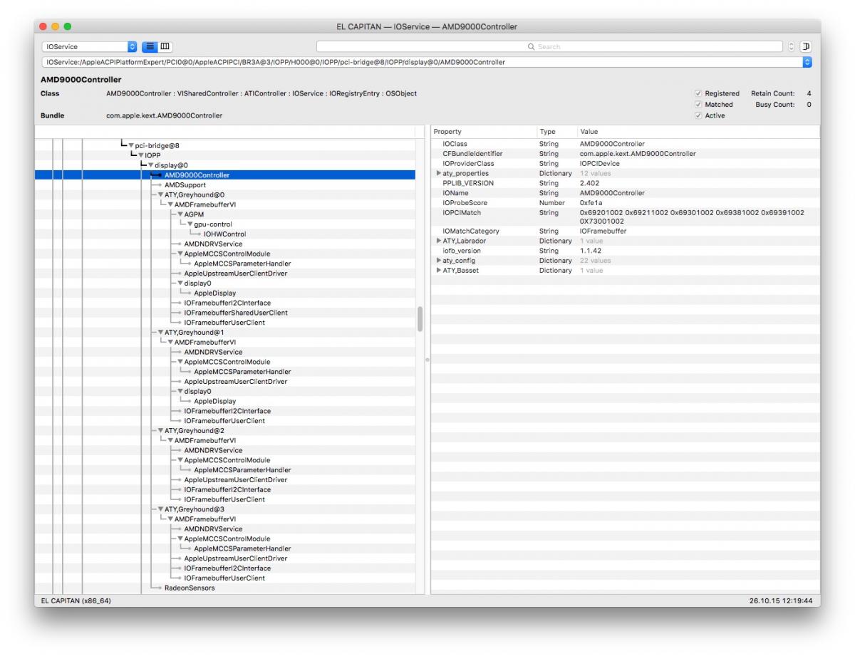

ganxiao Posted October 24, 2015 Share Posted October 24, 2015 I think if someone provide darwindump result from 27inch 5k retina imac with m295x/m395/m395x graphics would be helpful to this question, so we can check what properties graphic efi has injected to system. Be ware that 27inch retina imac use a special version of dp (edp 1.3 maybe) to connect its 5k pannel. I wonder if apple decides to skip some detection codes but to force init boot display to an edp connector caused this problem. Link to comment https://www.insanelymac.com/forum/topic/307248-r9-380-cant-boot-directly-have-to-do-it-via-intel-4600-ghost-monitor/page/5/#findComment-2181488 Share on other sites More sharing options...
ganxiao Posted October 25, 2015 Share Posted October 25, 2015 Thanks to Pike, we have iMac17,1's device-properties now, https://pikeralpha.wordpress.com/2015/10/24/device-properties-used-in-the-new-imac171/ I modified this to a more readable plist file, check attachment. iMac17,1-device-properties.plist.zip Link to comment https://www.insanelymac.com/forum/topic/307248-r9-380-cant-boot-directly-have-to-do-it-via-intel-4600-ghost-monitor/page/5/#findComment-2181891 Share on other sites More sharing options...

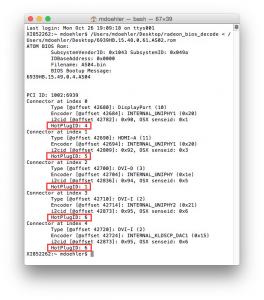

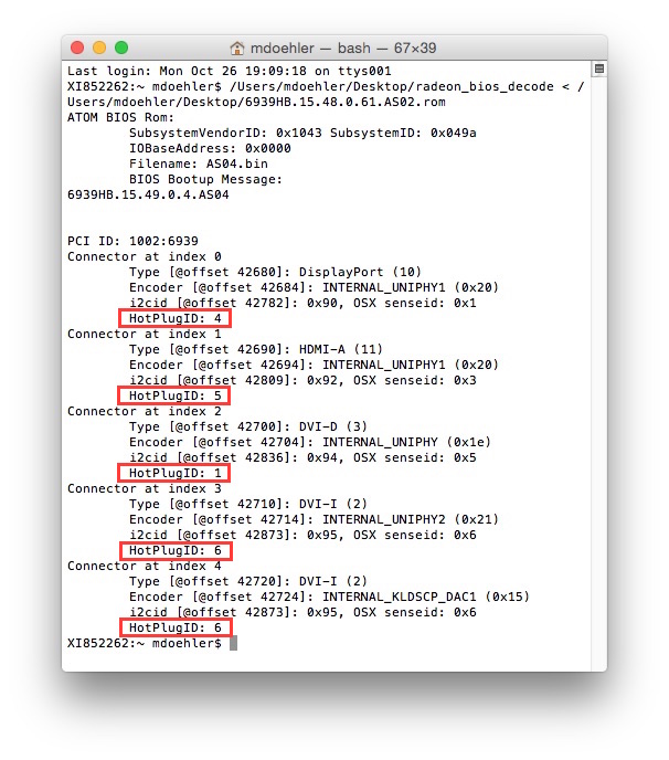

Mork vom Ork Posted October 27, 2015 Share Posted October 27, 2015 Just arrived @ home and edited my framebuffer patches for GREYHOUND, LABRADOR, OPM and BASSET to the following Settings: 00040000040300000001000711020401 <-- DP00080000040200000001000021030503 <-- HDMI00020000140200000001000010000105 <-- DVI-D04000000140000000001000012040606 <-- DVI-I (* just the first 4 connectors for BASSET, since it is just a 4 connectors framebuffer)00040000040300000001000010000202 <-- not used (cause Radeon R9 380 STRIX only has 4 physical ports)00020000140200000001000010000304 <-- not used (cause Radeon R9 380 STRIX only has 4 physical ports) Working all great with YOSEMITE. All patches will be accepted and every monitor will show correct desktop afte complete bootsequence. BALADI and EXMOOR still changed to "ATY,RadeonFramebuffer" May work also with EL CAPITAN - but still having the "monitor did not respond" after bootsequence (while machine still responds to filesharing requests, but not to screensharing requests from my MacBook). Have to explain, that all patches work also on EL CAPITAN, if i remove the AMDRadeonX4000.kext from /System/Library/Extensions folder, <-- all connected monitors responds with the correct desktop, but w/o accelleration. With AMDRadeonX4000.kext active it seems, that EL CAPITAN still boots into any "virtual desktop" with the effect, that all connected monitors reporting "No Signal" and went to stand-by mode. Same effect with my old ASUS Z97 DeLuxe board when disabled the onboard Haswell INTEL GFX or setting PCIe-GFX to primary GFX. EL CAPITAN boots succesfully, when INTEL GFX is enabled and set to primary gfx. Have no more idea on how to get it work. For me it seems, we need a "AMDRadeonX4000.kext"-patch. Also want to mention, that i tried every possible CLOVER v3305 configuration: Inject EDID on/off, Load VBIOS on/off, patch VBIOS on/off, Dual Link set to off/0/1 <--- all w/o any noticable effect. But i don't give up: next test plugging in my old Sapphire Radeon R7 260X as second GFX-Card with using the R9 380 as primary card as usual, then lets see, what happens. So stay tuned and don't miss the next episode of this show... regards, Mork vom Ork Link to comment https://www.insanelymac.com/forum/topic/307248-r9-380-cant-boot-directly-have-to-do-it-via-intel-4600-ghost-monitor/page/5/#findComment-2182640 Share on other sites More sharing options...
