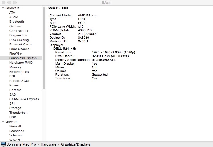

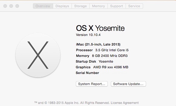

medussa Posted August 12, 2015 Share Posted August 12, 2015 I installed this card without problem and can confirm this card is OOB. In past I never had OOB graphics card. Latest chimera without any injection. Now we need support in ATI sensor for GPU temp This card is pretty good in windows too, but a little hot in idle (ambient 35C -- idle 45C -- gaming 68C). I don,t mind with that, but want too see graph temp, just for case. Link to comment https://www.insanelymac.com/forum/topic/307248-r9-380-cant-boot-directly-have-to-do-it-via-intel-4600-ghost-monitor/page/2/#findComment-2159764 Share on other sites More sharing options...
