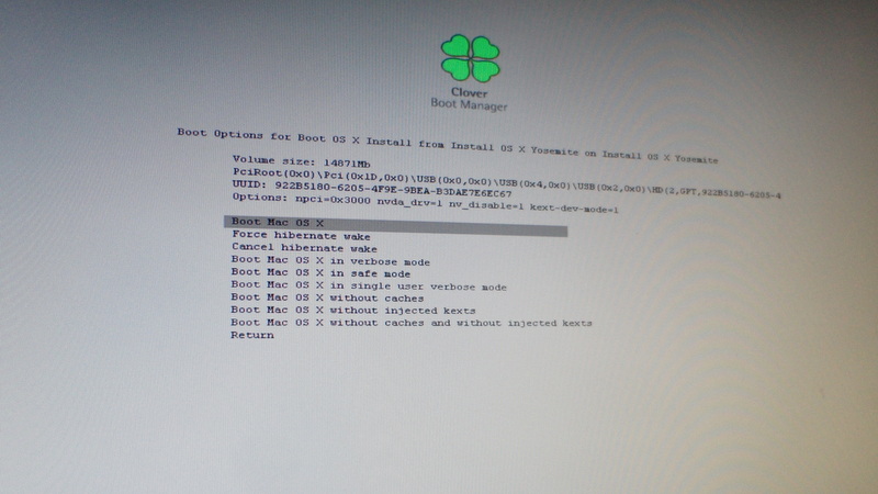

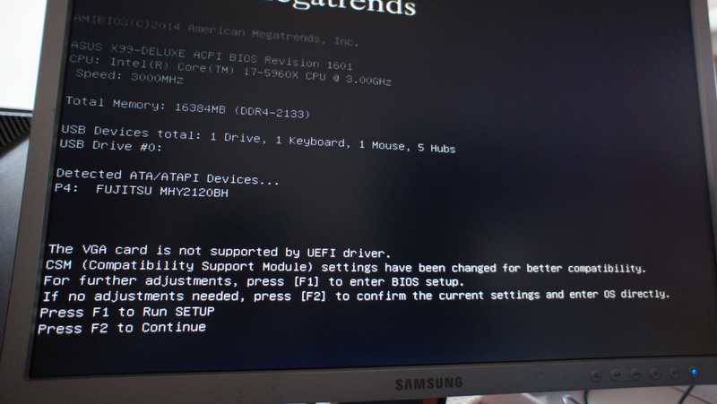

SoundForSoul Posted April 4, 2015 Share Posted April 4, 2015 I have finally purchased my components for my new audio production rig: Mobo: Asus x99 Deluxe - I have just updated the bios to latest version - 1601 CPU: 5960x Ram: Corsair Vengeance 16 Gb 4x4Gb 2666 Mhz PSU: Corsair Ax1200i Case: Corsair Obsidian 750D CPU cooler: Fractal Design S36 SSD Samsung 850 EVO 250 Gb Graphics: either an old Nvidia 9600 Gt or an even older 8600 Gt - they work perfectly on my x58a build in Mountain Lion and Yosemite. Installed windows on the ssd drive just to make sure that everything works fine. I had an older clean Hdd with a beasted Yosemite install on it - inserted it, used all the flags that I have found around with no succes - stuck on the PCI ROOT error. Created several Yosemite USB stick installers, using Rampage Dev Method. In bios, when I disable CSM, I got a warning and when I try to boot I get this error, with both Nvidia 8600 GTS and 9600 GT in slot pci 1 (even though they both work on my x58a build): "The Vga card is not supported by UEFI driver" CSM have been changed for better compatibility. - it re-enables itself at the next reboot. The "Other Os" remains selected, though. - see Pic 1 If i continue with booting from the usb stick, I got the graphics from pic2 & pic3. Pressing enter or spacebar on any of the verbose or boot without cache variants give me the "Error loading kernel cache error. Boot Failed sleeping for 10 seconds before exiting" error, as seen in pic 4. Trying to boot from the ##### Yosemite installation done on my x58a rig just hangs at the apple logo. Please help, I can't figure out what should I do next. Thank you so much for your time! Link to comment https://www.insanelymac.com/forum/topic/305448-asus-x99-deluxe-5960x-stuck-please-help/ Share on other sites More sharing options...

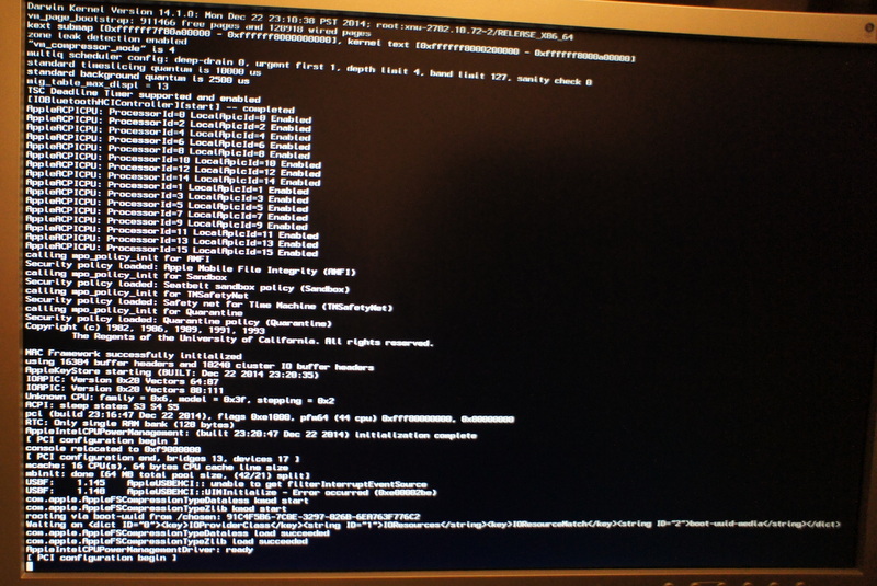

jackfoley Posted April 4, 2015 Share Posted April 4, 2015 (edited) I haven't tried starting with the Rampage Dev method, but in a nutshell, here's what I did (not sure if this will help with the video card problem at all) - create USB Installer w/##### - Read our Forum Rules about Tonymac tools. - Patch the Kernel on USB/System/Library/Kernels/ or download a patched kernel (make sure you're using the 5960X patch) - deleted the stock AppleACPIPlatform & IOPCFamily from USB/System/Library/Extensions/ - removed all of the kexts from USB/Extra/Extensions/ - copied the 4 Stinga11 Kexts to USB/System/Library/Extensions/ (including the proper VoodooTSCSync) - booted using "-v -x -f npci=0x2000 kext-dev-mode=1 nv_disable=1" (nv disable was because I was using dual GTX980s) - Install Yosemite - copy patched kernel to NEWBOOT/System/Library/Kernels/ - copy Stinga11 kexts across to NEWBOOT/System/Library/Extensions/ - Install Clover for hard drive boot - Copy across the kexts you need (this was challenging, getting the right combination of kexts for all of the components) - I also added HFSPlus.efi to the EFI after deleting VBoxHFS-64.efi from the EFI partition You'll probably need to do a bit of searching to find all of the pieces you need, but I was able to find everything between Insanelymac and the other guy's site. Good luck! Edited June 18, 2015 by Allan Don't direct other users to use the Tonymac tools. 2 Link to comment https://www.insanelymac.com/forum/topic/305448-asus-x99-deluxe-5960x-stuck-please-help/#findComment-2125311 Share on other sites More sharing options...

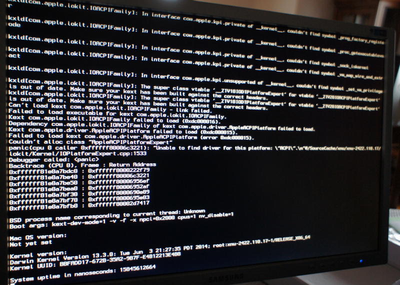

SoundForSoul Posted April 5, 2015 Author Share Posted April 5, 2015 I haven't tried starting with the Rampage Dev method, but in a nutshell, here's what I did (not sure if this will help with the video card problem at all) - create USB Installer w/##### - Patch the Kernel on USB/System/Library/Kernels/ or download a patched kernel (make sure you're using the 5960X patch) - deleted the stock AppleACPIPlatform & IOPCFamily from USB/System/Library/Extensions/ - removed all of the kexts from USB/Extra/Extensions/ - copied the 4 Stinga11 Kexts to USB/System/Library/Extensions/ (including the proper VoodooTSCSync) - booted using "-v -x -f npci=0x2000 kext-dev-mode=1 nv_disable=1" (nv disable was because I was using dual GTX980s) - Install Yosemite - copy patched kernel to NEWBOOT/System/Library/Kernels/ - copy Stinga11 kexts across to NEWBOOT/System/Library/Extensions/ - Install Clover for hard drive boot - Copy across the kexts you need (this was challenging, getting the right combination of kexts for all of the components) - I also added HFSPlus.efi to the EFI after deleting VBoxHFS-64.efi from the EFI partition You'll probably need to do a bit of searching to find all of the pieces you need, but I was able to find everything between Insanelymac and the other guy's site. Good luck! RE-re-re-rechecked the ##### installer (it seems that the mach_kernel was not there ) , also this is the first time that I put the USB stick into a USB 2 instead of USB3 - ... I have moved on to another stuck: " The system uptime in nanoseconds" " I start to think that is related to 1601 bios update that I just did... I am following the exact steps as other people describes, and I can't get to the installation process at all.. this is just weird. Thank you so much, Jackfoley, I am sure I am very close... I'll just try again and again. Link to comment https://www.insanelymac.com/forum/topic/305448-asus-x99-deluxe-5960x-stuck-please-help/#findComment-2125434 Share on other sites More sharing options...
jackfoley Posted April 5, 2015 Share Posted April 5, 2015 Hmm looking at this screenshot, I would make sure that the replacement kexts included a new AppleACPIPlatform.kext. Doesn't seem to be finding it. And totally forgot to mention the USB2 thing (you need to use USB2), but glad you figured it out! 1 Link to comment https://www.insanelymac.com/forum/topic/305448-asus-x99-deluxe-5960x-stuck-please-help/#findComment-2125500 Share on other sites More sharing options...
SoundForSoul Posted April 5, 2015 Author Share Posted April 5, 2015 Hmm looking at this screenshot, I would make sure that the replacement kexts included a new AppleACPIPlatform.kext. Doesn't seem to be finding it. And totally forgot to mention the USB2 thing (you need to use USB2), but glad you figured it out! I have looked for other AppleACPIPlatform.kext, found the original one that was on the ##### stick, should I use that instead? Update: Update: 1. only left 1 ram 4gb - when using the copied mach_kernel ##### usb stick - the "System uptime in nanoseconds" is no more present - at some point, after loading system.kexts, the screen goes black 2. when using the terminal patched using flags on another ##### usb stick: still pci configuration error as in attach I have repaired permissions with kextwizard. flags used: -v ncpi=0x2000 cpus=1 nv_disable=1 - sometimes i use debug=0x14e and -f ok, let's try the clover method, then.... Link to comment https://www.insanelymac.com/forum/topic/305448-asus-x99-deluxe-5960x-stuck-please-help/#findComment-2125527 Share on other sites More sharing options...

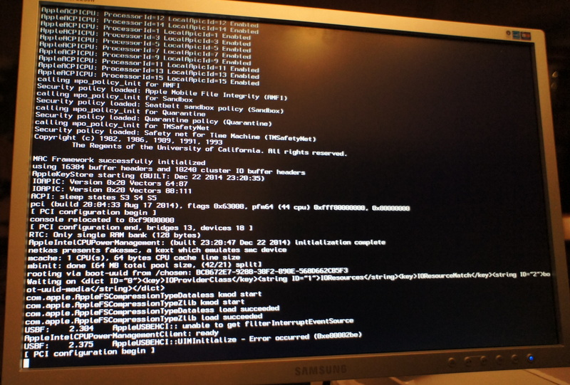

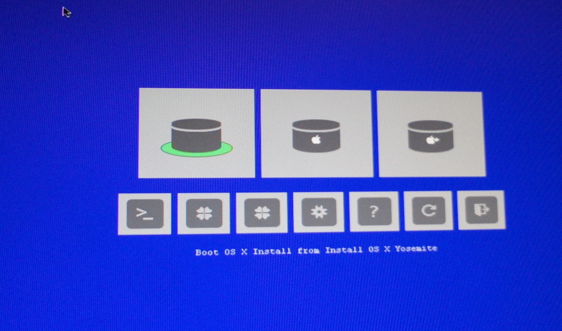

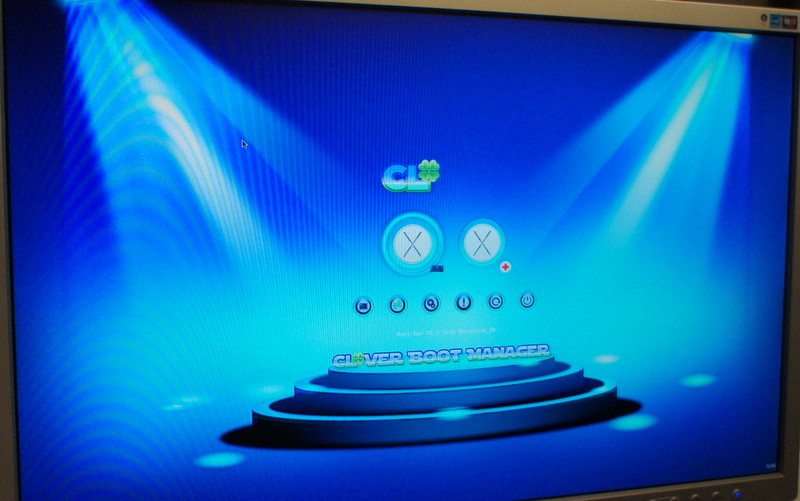

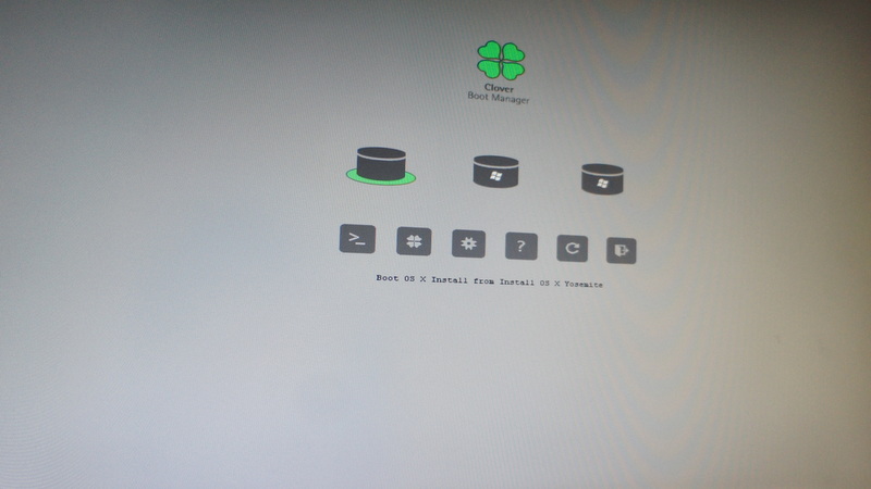

SoundForSoul Posted April 6, 2015 Author Share Posted April 6, 2015 Using this : NEW WAY TO INSTALL OS X YOSEMITE V2 - OSx86 10.10 (Yosemite) with post install updated, I have managed to get to pic from attachement, but using whatever flags it still stops at PCI config begin... Untill now, all the Clover methods have led me to crippled graphics, this cool shiny graphic is the most advanced so far... What's to do next ? ARGHHHH!!! Link to comment https://www.insanelymac.com/forum/topic/305448-asus-x99-deluxe-5960x-stuck-please-help/#findComment-2125619 Share on other sites More sharing options...
hooli Posted April 6, 2015 Share Posted April 6, 2015 There are some other posts about stopping at PCI message. What logging output are you getting? 10.10.2 causes a kernel panic and reboot WITHOUT a stack trace / reason which is annoying. You can also add a debug boot arg which might give you more information: debug=0x14E What do you think if the new guys install method you used - I've not tried it. I've place my patched 10.10.1 kernel and my current clover config on dropbox. config: https://dl.dropboxusercontent.com/u/359560/config.plist kernel: https://dl.dropboxusercontent.com/u/359560/kernel Not sure if the 10.10.1 kernel will be ok booting on a 10.10.2 install. Also, it is handy having a working Yosemite install, since if you mount the new HD and touch /S/L/Extensions, it picks up the new kernel and builds the compressed prelinkkernel and copies it to cache. The link above is not a prelinked one. I used it on my USB install 1 Link to comment https://www.insanelymac.com/forum/topic/305448-asus-x99-deluxe-5960x-stuck-please-help/#findComment-2125658 Share on other sites More sharing options...
SoundForSoul Posted April 7, 2015 Author Share Posted April 7, 2015 There are some other posts about stopping at PCI message. What logging output are you getting? 10.10.2 causes a kernel panic and reboot WITHOUT a stack trace / reason which is annoying. You can also add a debug boot arg which might give you more information: debug=0x14E What do you think if the new guys install method you used - I've not tried it. I've place my patched 10.10.1 kernel and my current clover config on dropbox. config: https://dl.dropboxusercontent.com/u/359560/config.plist kernel: https://dl.dropboxusercontent.com/u/359560/kernel Not sure if the 10.10.1 kernel will be ok booting on a 10.10.2 install. Also, it is handy having a working Yosemite install, since if you mount the new HD and touch /S/L/Extensions, it picks up the new kernel and builds the compressed prelinkkernel and copies it to cache. The link above is not a prelinked one. I used it on my USB install "You can also add a debug boot arg which might give you more information: debug=0x14E " I did, it simply stucks at PCI Config error... "What logging output are you getting? " - What are you saying is that should I take a picture of the screen or is it a log txt file somewhere ? "Not sure if the 10.10.1 kernel will be ok booting on a 10.10.2 install. Also, it is handy having a working Yosemite install, since if you mount the new HD and touch /S/L/Extensions, it picks up the new kernel and builds the compressed prelinkkernel and copies it to cache. The link above is not a prelinked one. I used it on my USB install" - I have a working Yosemite installation on my other hackie (x58a ud3r) . I seem not to understand wether it is good or not to touch the s/l/e with the new build hdd put into my old x58a build with yosemite installation. Could you please be more specific on this particular info ? I don't know how prelinkkernel and cache work... " What do you think if the new guys install method you used - I've not tried it." The new installation method is the most simple I have found.... and Here is a post installer for x79 and x99 (it is in french): http://www.hackintosh-montreal.com/t4173-post-installateur-pour-x79-et-x99 Thanks for the dropbox links .. Will try using the patched 10.10.1 kernel and also your clover config.plist in 3-4 hours and I'll let you know. UPDATE: I guess I have found the problem.... I got the PCI Config error because in my bios I can't have the CMS set to "Disable", since 9600 GT has no UEFI drivers, so everytime I set CMS to disable, I got this error in Bios, at restart: "Your VGA card is not supported by UEFI driver", so it reboots and re-sets the CMS to "Enable". I will try today with a GTX 760, to see how it goes... Link to comment https://www.insanelymac.com/forum/topic/305448-asus-x99-deluxe-5960x-stuck-please-help/#findComment-2125830 Share on other sites More sharing options...
