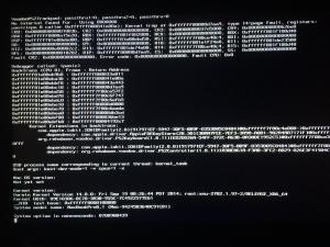

buttcrap Posted January 22, 2015 Share Posted January 22, 2015 Let me start off by saying that I am willing to pay for some extra help if necessary. I love Yosemite and I've been struggling with this for a couple weekends, so if someone does a great job of helping out I can definitely recognize that via PayPal. I have an HP DV6t-6100 with Insyde f1.b BIOS, i7 2820QM, Intel HD 3000 graphics and a Radeon HD 6770m 2gb on 16gb RAM and a hybrid 1tb drive partitioned 872gb Windows 7 / 128gb OS X Yosemite (hopefully). I also have a 1920x1080 resolution screen that I don't care about getting working correctly, I just want to at least install. I currently am attempting a ##### boot (so if I understand correctly, Chimera/Chameleon).Previously, I've gotten as far as to run the installer in Yosemite Zone and even had a bootable Yosemite with -x and CPUs=1. I would go back to Yosemite Zone(at least I knew it could work) but for the life of me I cannot get the installer to run again. I can't get the bootloader to boot past the forward slash symbol in the upper left corner, and I don't know which version I had that was running. I've tried 3 out that I've found to each have different file sizes from various torrent networks and google searched - none of them work.I get the bootloader to run - I select the USB drive of my four options to boot into, and using the boot flags -v, and CPUs=1 I get this screen here: Notice that I have a lapic_kernel panic, on an HP laptop, which is typical. But look at my boot flags!! I have CPUs=1 set. I normally use -x as well, but I forgot here and it creates the same message regardless. I have a quad core It's common knowledge that HP Laptops have local APIC issues, well documented, and there is already a KernelPatcher.dylib fix for the issue(shouts out to donovan6000? I think). Supposedly you can use CPUs=1 as a short term fix for the issue. Obviously this isn't the case for me. Regardless of the fact that CPUs=1 didn't resolve the issue in my case, I tried to use KernelPatcher.dylib, installed it in the Extra/modules folder using TransMac, and after I did that I got even less far in the bootloader process. I don't care about working audio, working high resolution graphics, or anything else. If I can get to barely crawl through the boot and install process and get to a functioning Finder window I will be 100% happy. I can do the rest of the playing around with kext files stuff later, right now I just want it to boot. Aside from the KernelPatcher.dylib I threw into Extra/modules (and then took out) I am using a completely virgin copy of ##### on a 64gb SanDisk USB drive. My ##### options: Yosemite 10.10.1 downloaded from Mac App Store on a real copy of Yosemite Laptop Support On Legacy USB On (didn't think I would need this one but without it I can't seem to load Chimera) I don't have a DSDT file, and I'm not sure if I need one. I've looked at tonymacs DSDT section and they have HP ProBook but that's the closest thing I could find - didn't seem like quite a good fit. Was I wrong? My motherboard, as typical of Insyde f1.b, is locked. It is using BIOS. The options I have from memory are.. Virtualization(enabled) action keys(enabled) changes Fx keys to require holding fn+Fx key, don't think this matters switchable graphics fixed/dynamic(set to fixed.) this controls how the dual graphics switch, all the guides I've read have said to stick with Fixed so I haven't experimented too much out side of this setting. fan always on(disabled) I think this lets the fan turn off if the CPU is cool enough. Don't think this matters, but my fan doesn't turn off during bootloader anyways lol My hard drive is a fusion 20gb flash 980gb HDD. I don't know how this correlates to the bootloader - I've tried dropssdt=yes a couple times but it doesn't seem to do anything different. But like I said I did get Yosemite Zone running ONCE but I cannot(and believe me I have tried) get it to run again. I am definitely doing something wrong. I'd like to stick with ##### if possible, but I'm open to whatever, I'm even going to buy a second USB stick in a couple days here to test out two easily. SO right now KernelPatcher.dylib is not installed, but it can be in a second. LET ME KNOW if there is ANY more information I can provide, I will be happy too. I tried to put everything I could think of in here. I've seen videos and posts of people with my same model of laptop, DV6t-6100, running Yosemite(more commonly mavericks) showing off that they have like 99% of the laptop working, so I know it's possible, I just don't know how they got there. I would be ecstatic if I could get this working tonight. Any help is so, so appreciated. Link to comment https://www.insanelymac.com/forum/topic/304054-lapic_native-kernel-panic-on-hp-laptop-even-with-cpus1/ Share on other sites More sharing options...
RehabMan Posted January 22, 2015 Share Posted January 22, 2015 You're spelling it wrong... It is cpus=1, not CPUs=1. Boot flags and kernel flags are case sensitive. Link to comment https://www.insanelymac.com/forum/topic/304054-lapic_native-kernel-panic-on-hp-laptop-even-with-cpus1/#findComment-2104625 Share on other sites More sharing options...

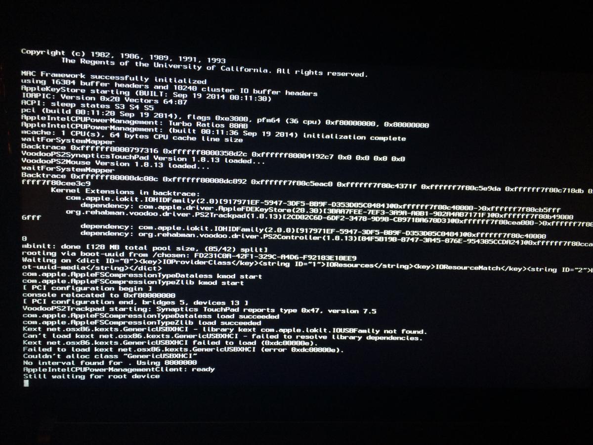

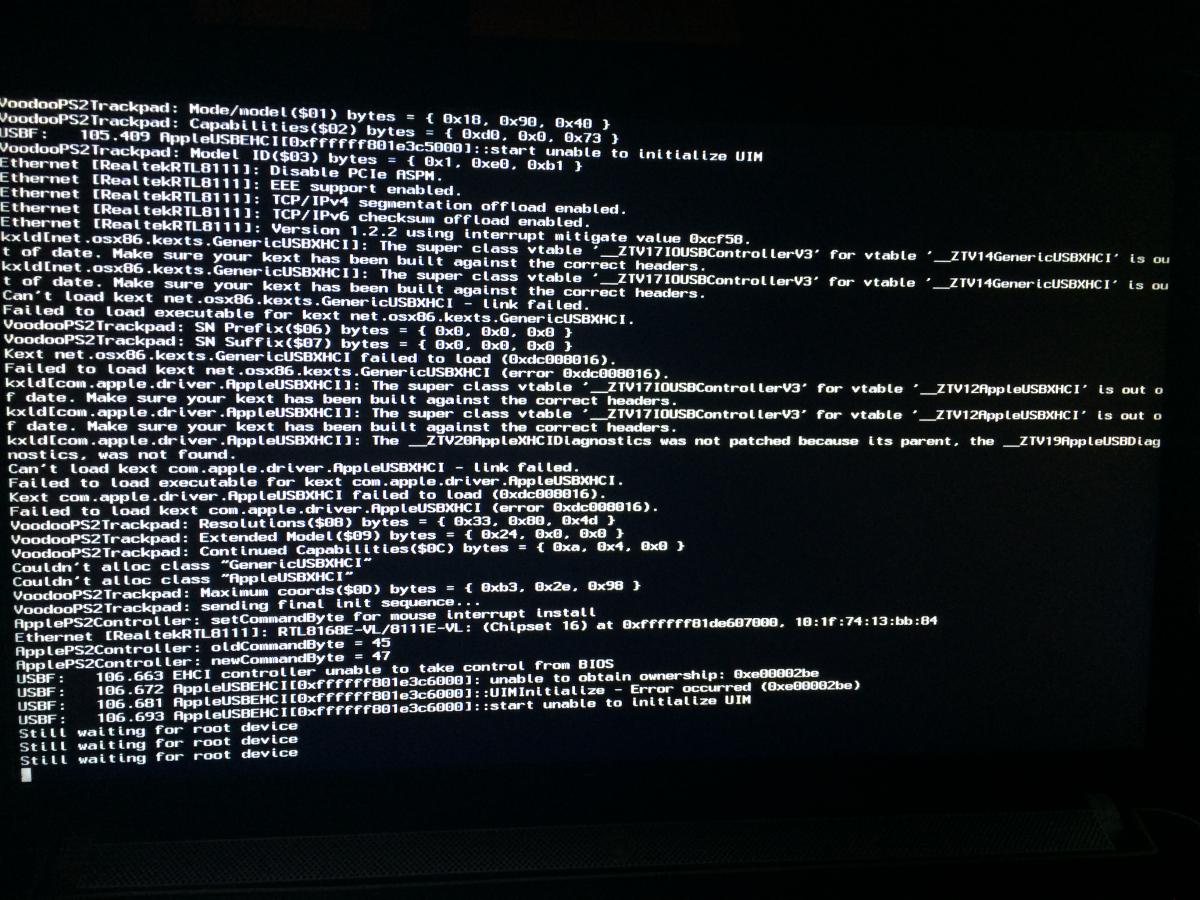

buttcrap Posted January 22, 2015 Author Share Posted January 22, 2015 You're spelling it wrong... It is cpus=1, not CPUs=1. Boot flags and kernel flags are case sensitive. Hey this got me past the local APIC panic!!! Thank you SO much. Now I get a 'Still waiting for root device' message. I've attached a screenshot if it helps. I know from scouring these forums that it typically means that it doesn't have the drivers to read my USB boot. To fix this, I tried to put GenericUSBXHCI (i found the file by googling 'GenericUSBXHCI and it was the first result) and after putting that into Extra/Extensions using TransMac. After I did that and booted cpus=1 -v I just got a bunch of messages about GenericUSBXHCI not being found. So I tried cpus=1 -v and USBBusFix=Yes. It didn't seem to do anything different but I didn't take a screenshot.. I also tried it with lower case 'usbbusfix=yes'. Are boot flags always lower case? Either way it didn't seem to make any difference. I tried to throw -x in there and each time I did it booted to a black screen. Any clue why this would happen? Link to comment https://www.insanelymac.com/forum/topic/304054-lapic_native-kernel-panic-on-hp-laptop-even-with-cpus1/#findComment-2104657 Share on other sites More sharing options...
RehabMan Posted January 22, 2015 Share Posted January 22, 2015 Hey this got me past the local APIC panic!!! Thank you SO much. Now I get a 'Still waiting for root device' message. I've attached a screenshot if it helps. I know from scouring these forums that it typically means that it doesn't have the drivers to read my USB boot. To fix this, I tried to put GenericUSBXHCI (i found the file by googling 'GenericUSBXHCI and it was the first result) and after putting that into Extra/Extensions using TransMac. After I did that and booted cpus=1 -v I just got a bunch of messages about GenericUSBXHCI not being found. So I tried cpus=1 -v and USBBusFix=Yes. It didn't seem to do anything different but I didn't take a screenshot.. I also tried it with lower case 'usbbusfix=yes'. Are boot flags always lower case? Either way it didn't seem to make any difference. I tried to throw -x in there and each time I did it booted to a black screen. Any clue why this would happen? It is USBBusFix=Yes... Typically bootloader flags are CamelCased (eg. GraphicsEnabler, EthernetBuiltIn, SkipNvidiaGfx, etc), and kernel flags are lower case (kext-dev-mode, dart, darkwake, -v, -x, etc). I'm not certain that always holds true, but it seems like a general pattern. Some bootloader flags must be quoted because (crazy) they have spaces (eg. "Graphics Mode"=1920x1080x32). You should try with a build of GenericUSBXHCI.kext appropriate for Yosemite, even though your problem appears to be a USB2 problem. My build of GenericUSBXHCI is built for Yosemite and older: https://github.com/RehabMan/OS-X-Generic-USB3. You should also try different ports/sticks, and experiment with USB options in BIOS. Link to comment https://www.insanelymac.com/forum/topic/304054-lapic_native-kernel-panic-on-hp-laptop-even-with-cpus1/#findComment-2104664 Share on other sites More sharing options...
buttcrap Posted January 22, 2015 Author Share Posted January 22, 2015 Thanks for all the help...I don't know if I'm using that link you've provided correctly. I clicked 'download ZIP' on the right but I don't understand how to use the files inside... Are these ones not compiled? I did however click the bitbucket link under 'Downloads' and Kext Wizard and I can now see the kext 'GenericUSBXHCI.kext' in System/Library/Extensions. It is not, however, under Extra/Extensions. Hope I'm doing that right.With the above setup, and using bootflags -v cpus=1 I get this: In addition, when I booted with -v cpus=1 -x I got this: Lastly, when I used -v -x cpus=1 USBBusFix=1 get to a black screen. It seems that USBBusFix=Yes and -x conflict... It does appear to get just as far, but the text moves so fast I can't tell which area it gets caught up on.It may be worth nothing that sometimes it seems to hang at [PCI Configuring] thing for around 3 minutes. I see there are some 'fixes' for it, but it appears to get past it. Trying to give you as much information as I don't have the same understanding of this stuff as you guys. My laptop has both USB 3.0 ports and USB 2.0. I've been sticking with the USB 2.0 as I've seen some posts that say that you always should, but I've been playing around on each and it doesn't seem to make a difference. Maybe the USB 3.0 are only being used to the potential of 2.0 because of -x. Working on getting another USB drive in the coming days. My BIOS has no settings for USB aside from boot order But like I said Yosemite Zone did reach post installation one time, and this was using the same drive! So there's gotta be a way. I reformatted the drive and started over after a bad text install broke the boot process. This was before I knew about -f of course... Still kicking myself for that one. Link to comment https://www.insanelymac.com/forum/topic/304054-lapic_native-kernel-panic-on-hp-laptop-even-with-cpus1/#findComment-2104686 Share on other sites More sharing options...

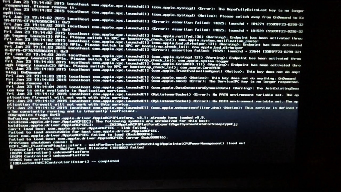

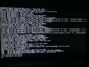

RehabMan Posted January 22, 2015 Share Posted January 22, 2015 ... IMG_0267.JPG Looks like you have a rollback IOUSBFamily.kext installed. Remove it. In addition, when I booted with -v cpus=1 -x I got this: IMG_0268.JPG And an old VoodooPS2Controller.kext (current is 1.8.13). Update it. Link to comment https://www.insanelymac.com/forum/topic/304054-lapic_native-kernel-panic-on-hp-laptop-even-with-cpus1/#findComment-2104798 Share on other sites More sharing options...

RehabMan Posted January 24, 2015 Share Posted January 24, 2015 Without IOUSBFamily nothing with USB is going to work... Note: Best to stick with the IOUSBFamily.kext that Apple provided... Link to comment https://www.insanelymac.com/forum/topic/304054-lapic_native-kernel-panic-on-hp-laptop-even-with-cpus1/#findComment-2105220 Share on other sites More sharing options...

buttcrap Posted January 24, 2015 Author Share Posted January 24, 2015 Killer! Thanks guys, I think that issues taken care of. Maverick I've seen your thread before! I was thinking of trying to contact you so I'm glad youre in this thread, your DV6 is perfect. Did you run into a issue with AppleIntelCPUPowerManagement ? here's a screenshot.. That's when I use just cpus=1. if I do this in safe mode(-x cpus=1) I think the boot process gets farther but it's honestly tough to tell because the screen flashes and goes black instead of showing a panic or anything. I took a video and then screenshotted the video, so the quality isn't the best but here's the absolute last text to display before it goes dark Any suggestions? something I should have added: I do have NullCPUPowerManagement.kext Link to comment https://www.insanelymac.com/forum/topic/304054-lapic_native-kernel-panic-on-hp-laptop-even-with-cpus1/#findComment-2105250 Share on other sites More sharing options...
buttcrap Posted January 24, 2015 Author Share Posted January 24, 2015 I tried your NullCPUPowerManagement.kext but I get the same result Maverick Link to comment https://www.insanelymac.com/forum/topic/304054-lapic_native-kernel-panic-on-hp-laptop-even-with-cpus1/#findComment-2105255 Share on other sites More sharing options...
Dec_Bra1n Posted January 24, 2015 Share Posted January 24, 2015 I tried your NullCPUPowerManagement.kext but I get the same result Maverick If you boot with Nullpower then add C-state and P-State on Org.Chameleon.Boot.Plist On Original BIOS Nullpower+C-state+P-state is needed and USB 2.0 for installation I would recommend you to flash your BIOS with Donovan6000 to avoid getting Kernel Panic and using that u can use Native power management 1st image where u got stuck AGPM u need to use C-state and P-State on Org.Chameleon.Boot.Plist 2nd image AICPM need Nullpower+FakeSMC I think i have explained here already http://www.insanelymac.com/forum/topic/289883-hp-laptop-dv6-6xxx-dv7-6xxx-os-x-109-mavericks-and-1010-yosemite/ Link to comment https://www.insanelymac.com/forum/topic/304054-lapic_native-kernel-panic-on-hp-laptop-even-with-cpus1/#findComment-2105269 Share on other sites More sharing options...

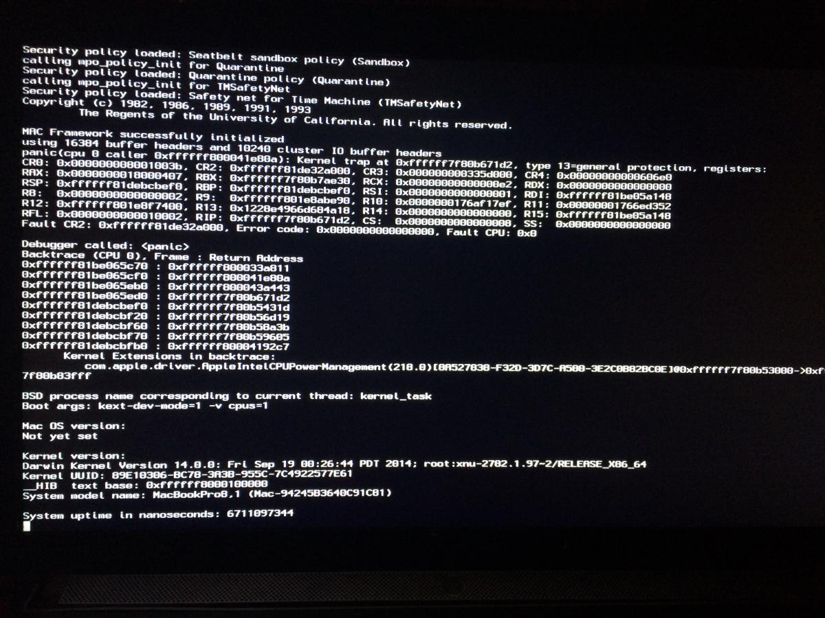

RehabMan Posted January 24, 2015 Share Posted January 24, 2015 ... if I do this in safe mode(-x cpus=1) I think the boot process gets farther but it's honestly tough to tell because the screen flashes and goes black instead of showing a panic or anything. I took a video and then screenshotted the video, so the quality isn't the best but here's the absolute last text to display before it goes dark image.jpg Any suggestions? something I should have added: I do have NullCPUPowerManagement.kext You're getting RCX=0xE2 panic from AppleIntelCPUPowerManagement.kext. You need patched AppleIntelCPUPowerManagement.kext, NullCPUPowerManagement.kext (boot without caches -f), or patched BIOS to avoid locking CPU MSR 0xE2. You should probably find/read a guide on native power management. There are many such guides. Link to comment https://www.insanelymac.com/forum/topic/304054-lapic_native-kernel-panic-on-hp-laptop-even-with-cpus1/#findComment-2105302 Share on other sites More sharing options...

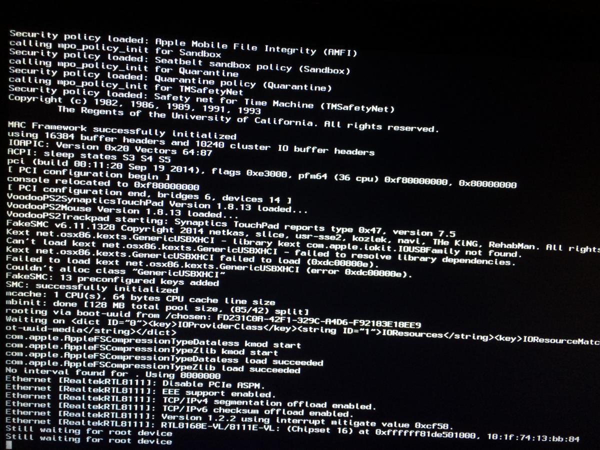

buttcrap Posted January 28, 2015 Author Share Posted January 28, 2015 Ok, when I boot with just cpus=1 I get the same error about GenericUSBHXCI.kext not being loaded and that it failed to find IOUSBFamily. Both of these Kexts are in my Extras/Extension folder. I looked at USB options in my newly unlocked BIOS, but only found the option to turn legacy on/off. the rest seemed to all disable the usb from being powered altogether, booting straight into Windows. Not sure what else to try.. I do have more options open for different boot loaders now that I can turn USB legacy on/off Link to comment https://www.insanelymac.com/forum/topic/304054-lapic_native-kernel-panic-on-hp-laptop-even-with-cpus1/#findComment-2106348 Share on other sites More sharing options...
Dec_Bra1n Posted January 28, 2015 Share Posted January 28, 2015 Ok, when I boot with just cpus=1 I get the same error about GenericUSBHXCI.kext not being loaded and that it failed to find IOUSBFamily. Both of these Kexts are in my Extras/Extension folder. I looked at USB options in my newly unlocked BIOS, but only found the option to turn legacy on/off. the rest seemed to all disable the usb from being powered altogether, booting straight into Windows. Not sure what else to try.. I do have more options open for different boot loaders now that I can turn USB legacy on/off As i told you before USE USB 2.0 Port instead of USB 3.0 Port to avoid trouble make a USB installer using Unibesast and rename the kernel to mach_kernel and boot with "-v cpus=1" and install it once u successfully install change the kernel with lapic fix kernel crazybirdy and i remind again i have already simplified the way of installation http://www.insanelym...-1010-yosemite/ Hey guys! Just used Donovan6000's unlocked sp55068 bios, seems to be working great. What settings should I use for my BIOS? Goto BIOS and Advance Features=>Graphics=>Special Feature=>Disable Link to comment https://www.insanelymac.com/forum/topic/304054-lapic_native-kernel-panic-on-hp-laptop-even-with-cpus1/#findComment-2106349 Share on other sites More sharing options...

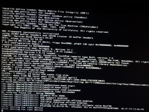

buttcrap Posted January 28, 2015 Author Share Posted January 28, 2015 and when I boot with -x as well the screen eventually flashes and turns black. also maverick I added the c state and p state stuff to my org.chameleon.boot.plist like you recommended. ask I forgot to add that I also disabled MSR in my bios, to get the iousbfamily issue again Link to comment https://www.insanelymac.com/forum/topic/304054-lapic_native-kernel-panic-on-hp-laptop-even-with-cpus1/#findComment-2106351 Share on other sites More sharing options...
Dec_Bra1n Posted January 28, 2015 Share Posted January 28, 2015 and when I boot with -x as well the screen eventually flashes and turns black. also maverick I added the c state and p state stuff to my org.chameleon.boot.plist like you recommended. ask I forgot to add that I also disabled MSR in my bios, to get the iousbfamily issue again NO NEED to BOOT WITH -x and do not turn off MSR i won't recommend you to do that donovan6000 bios is great no need any kind a changes accept turn OFF ATI for battery Performance Just try [url="http://www.insanelymac.com/forum/topic/279450-why-insanelymac-does-not-support-tonymacx86/"]#####[/url] Link to comment https://www.insanelymac.com/forum/topic/304054-lapic_native-kernel-panic-on-hp-laptop-even-with-cpus1/#findComment-2106380 Share on other sites More sharing options...

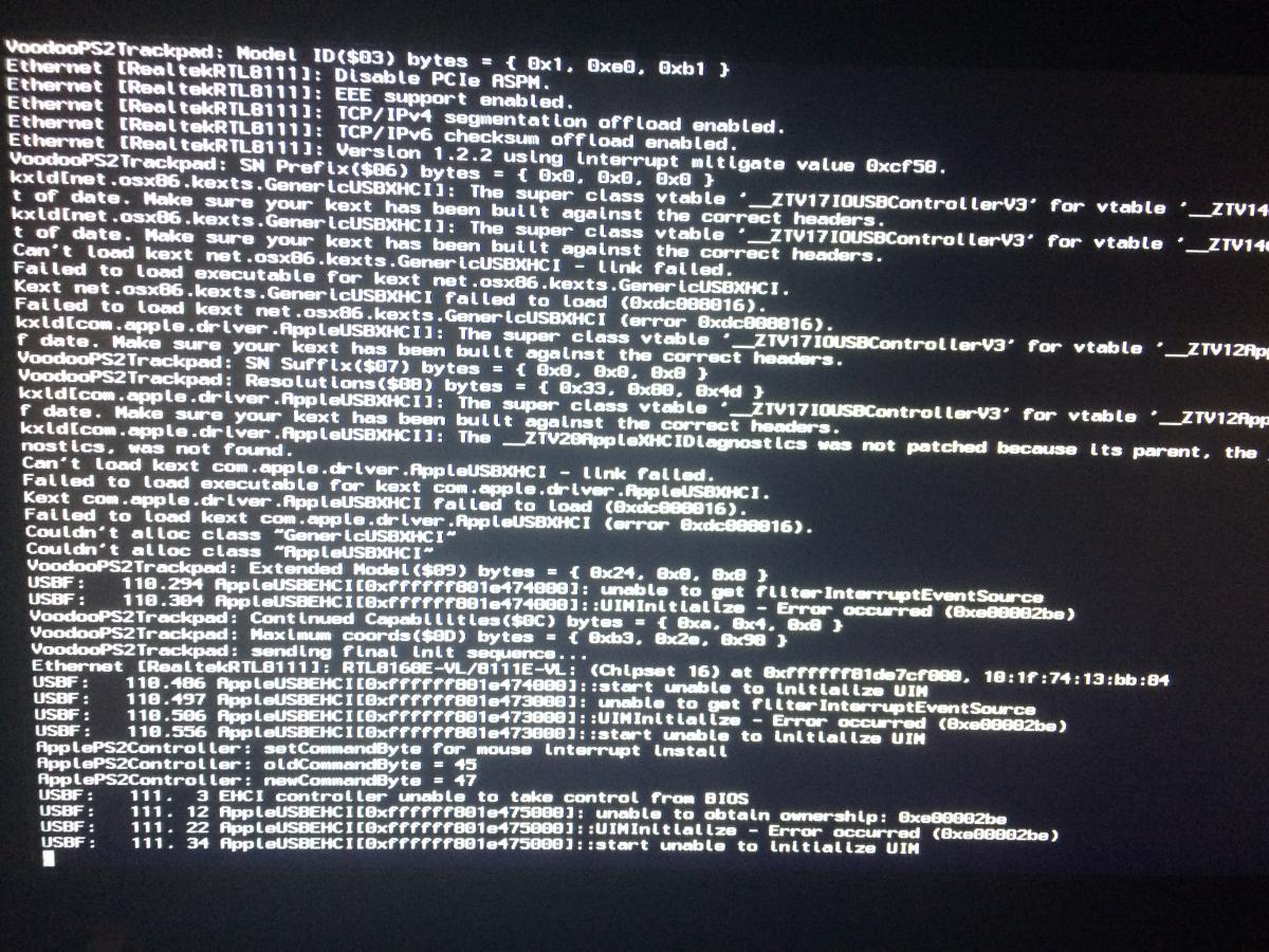

buttcrap Posted February 1, 2015 Author Share Posted February 1, 2015 kernel not found when I tried.. renaming to kernel Hey guys it does boot with -x, I just have to use HDMI. when I boot with just cpus=1 I get this attached pic. I'm curious why would genericusbhxci only cause issues in normal boot, does this indicate another kext interfering? thanks for all your help!!! Link to comment https://www.insanelymac.com/forum/topic/304054-lapic_native-kernel-panic-on-hp-laptop-even-with-cpus1/#findComment-2107582 Share on other sites More sharing options...
