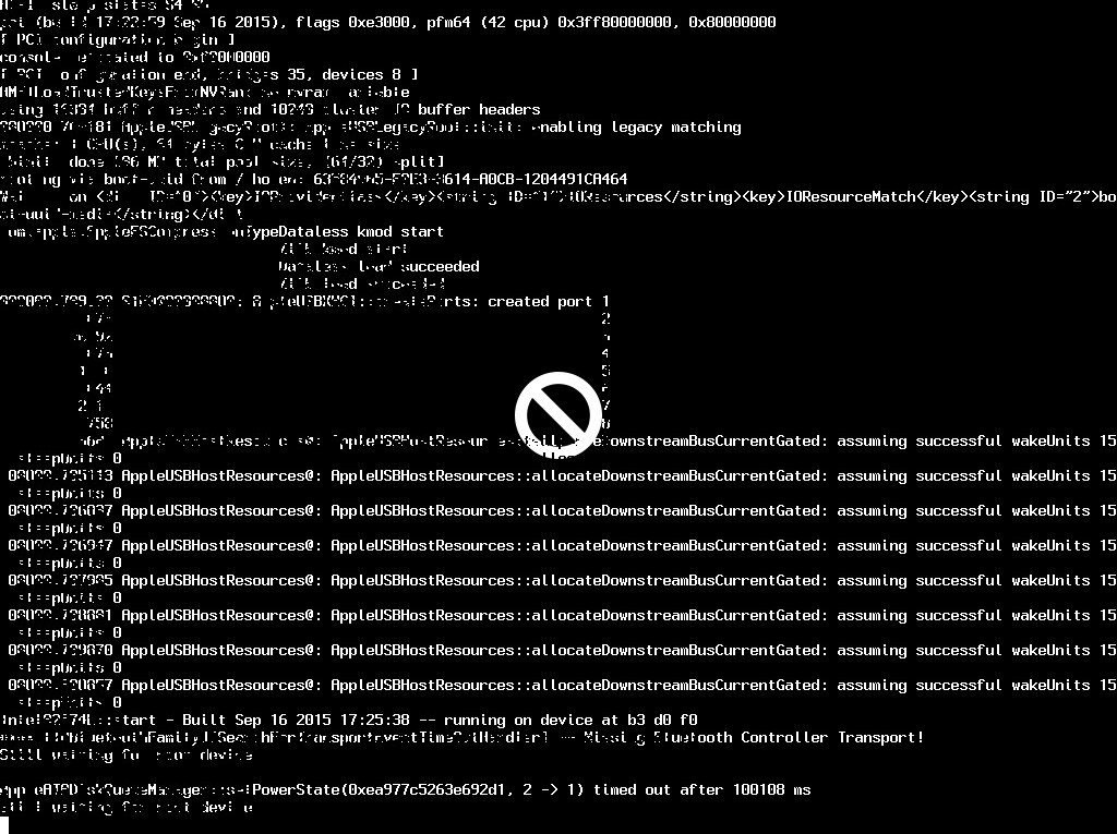

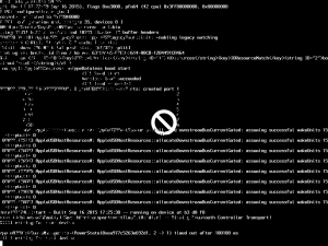

I figured out how to run the local.sh.  There were no errors that i could see.  Here is the vmware.log.
Edit:  Added the screen output of running local.sh also.
Thanks
Edit:  updated vmware log.  it ends at the point when i get the stop screen.  Also attached screenshot of the screen it stops at.
Thanks
How did you create the installer ISO image? It does not look like it is bootable.
I used the createinstaller script to create the Bootable volume, then created the Bootable dmg from that.
Edit: I get through about 75% of the boot progress bar below the apple before i get the stop screen.
Edit again: I know the dmg works because I've restored it to a usb drive and i can boot my mac pro up with it.

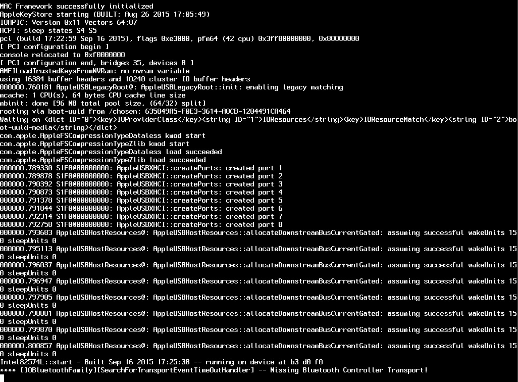

Can you boot to the VMware EFI shell and then run the boot loader with verbose settings?
Something like:
fs0:\usr\standalone\i386\boot.efi -v
Something like:
I was wondering how to do that.  Thanks.  Also, how can i log whats happening?
As you can see, I get to the bluetooth error and i can't see what the next line is b/c the screen gets all jumbled up.

Just an update.  I got to work and tried my usb drive and it wasn't bootable on an actual Mac Pro, got the same 'waiting for root device' error.  I know the dmg is good b/c i restored it to an external ssd drive and the Mac Pro booted on it fine.  Since I had restored the dmg to the usb drive via TransMac on my pc, I tried imaging it via the createinstallmedia script in El Capitan.  Still no go. So, it appears my usb drive is incompatible for some reason.  Gonna take the external SSD drive home and try to boot my vm from it.  Crossing my fingers.
Ok, so i finally got El Capitan installed.  Yay!  I couldn't get any usb thumb drive to work.  Just needed to boot off an external hard drive.  Once i did, it loaded right past the 'still waiting for root device' error and installed with no issues.  Thanks again for all the help guys.
Edit:  I guess just to be more specific, the external drive was an SSD inside a USB 2.0 enclosure I had. (Ultra USB 2.0" Portable Hard Drive Enclosure - 2.5" SATA HDD or SSD)
Final Edit: I figured out what i was doing wrong finally.  When you format a drive GPT in OS X it creates a hidden EFI partition that is required to boot. When i was creating my .dmg backup file for future restores, i was creating it from the El Captian partition b/c it was the only one visible.  When i did a restore, I would restore the usb drive from that .dmg file, and, of course, it was missing the hidden EFI partition.  I have recreated my .dmg backup file from the drive itself instead of the partition, and this includes the hidden EFI partition.  Now I can boot from any of my usb devices, that i have restored my new .dmg file to.
