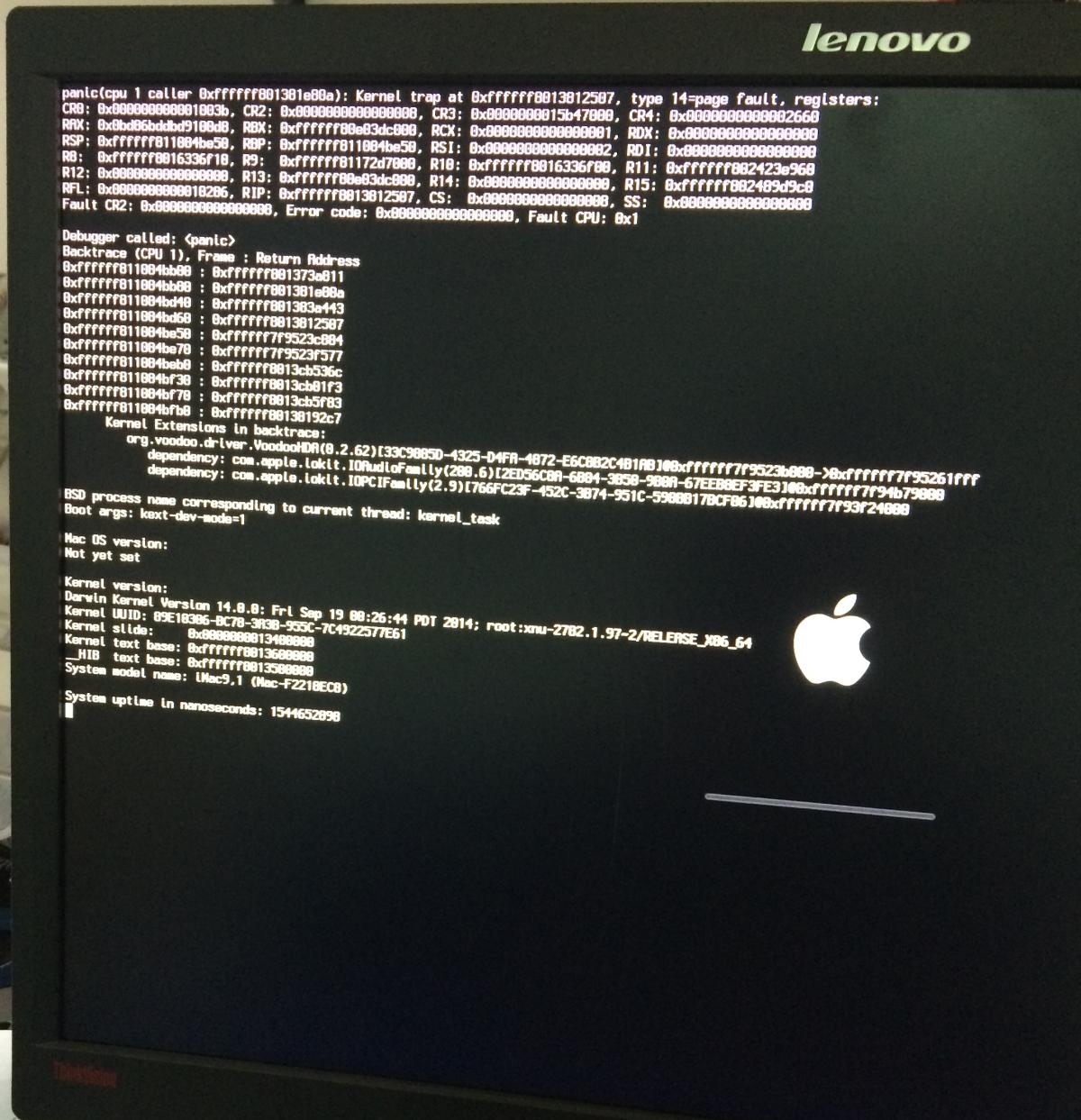

havdic Posted January 8, 2015 Share Posted January 8, 2015 Are you using a DSDT ? If so, remove it. Post a screenshot of your KP also. I deleted DSDT.aml from /EFI/EFI/CLOVER/ACPI/Patched and I can't boot... I will put it back, backup is on the Desktop Here is the picture Link to comment https://www.insanelymac.com/forum/topic/302877-guide-yosemite-1010x-dell-optiplex-780-760/page/4/#findComment-2101689 Share on other sites More sharing options...
polyzargone Posted January 8, 2015 Share Posted January 8, 2015 Well, obviously you have a conflict with VoodooHDA and AppleHDA It's not related to GFX. Remember that when you're using VoodooHDA, you always have to remove AppleHDA.kext from S/L/E or leave it in place AND use AppleHDADisabler.kext to avoid a Kernel Panic. I think using AppleHDADisabler.kext is a better choice because next OS X updates will likely reinstall AppleHDA.kext but they won't overwrite or remove AppleHDADisabler.kext. Link to comment https://www.insanelymac.com/forum/topic/302877-guide-yosemite-1010x-dell-optiplex-780-760/page/4/#findComment-2101693 Share on other sites More sharing options...
havdic Posted January 8, 2015 Share Posted January 8, 2015 There is no problem like this with ati 5450, only with r9 280 Link to comment https://www.insanelymac.com/forum/topic/302877-guide-yosemite-1010x-dell-optiplex-780-760/page/4/#findComment-2101697 Share on other sites More sharing options...
polyzargone Posted January 8, 2015 Share Posted January 8, 2015 After that I reinstalled yossemite… Make sure that AppleHDA is not in S/L/E ! There's 100% chances that it's still there because you've just re-installed Yosemite. Maybe the problem occurs because HDMI audio isn't managed the same way with 5450 and R9 280 and a conflict may appear where there's none with 5450. But according to your KP screenshot, the problem is definitely related to VoodooHDA as you can read by yourself Link to comment https://www.insanelymac.com/forum/topic/302877-guide-yosemite-1010x-dell-optiplex-780-760/page/4/#findComment-2101699 Share on other sites More sharing options...
havdic Posted January 8, 2015 Share Posted January 8, 2015 Aaaaa ok! You are right! It has digital audio on it, 5450 doesn't as far as I know, but that is causing problems for sure Link to comment https://www.insanelymac.com/forum/topic/302877-guide-yosemite-1010x-dell-optiplex-780-760/page/4/#findComment-2101708 Share on other sites More sharing options...
polyzargone Posted January 8, 2015 Share Posted January 8, 2015 Well actually 5450 has HDMI output and hence digital audio. But maybe VoodooHDA hasn't detect or enable it. That said, I still think that mixing VoodooHDA and AppleHDA is the problem Link to comment https://www.insanelymac.com/forum/topic/302877-guide-yosemite-1010x-dell-optiplex-780-760/page/4/#findComment-2101709 Share on other sites More sharing options...
havdic Posted January 8, 2015 Share Posted January 8, 2015 Success! Downloaded new version of voodoohda, no errors, but no sound also I have usb audio adapter, I think it is compattible Link to comment https://www.insanelymac.com/forum/topic/302877-guide-yosemite-1010x-dell-optiplex-780-760/page/4/#findComment-2101756 Share on other sites More sharing options...
polyzargone Posted January 8, 2015 Share Posted January 8, 2015 You can revert your VoodooHDA.kext to the working one as long as you leave AppleHDADisabler.kext in S/L/E. I assume that you installed the VoodooHDA 2.8.8 pkg. This package also install AppleHDADisabler.kext so you'll be fine and you should find the previous VoodooHDA.kext in the Backup Extensions at the root of your HDD. Link to comment https://www.insanelymac.com/forum/topic/302877-guide-yosemite-1010x-dell-optiplex-780-760/page/4/#findComment-2101759 Share on other sites More sharing options...
havdic Posted January 8, 2015 Share Posted January 8, 2015 Nope, 2.8.7 I will try... Thank you!!! Link to comment https://www.insanelymac.com/forum/topic/302877-guide-yosemite-1010x-dell-optiplex-780-760/page/4/#findComment-2101764 Share on other sites More sharing options...
havdic Posted January 9, 2015 Share Posted January 9, 2015 I had success with CMI8738 chip on some cheap pci card Youtube is a little slow, latest flash player, same thing with Chrome... but never mind, everything else works... Next "mission" is iMessage & FaceTime Link to comment https://www.insanelymac.com/forum/topic/302877-guide-yosemite-1010x-dell-optiplex-780-760/page/4/#findComment-2101899 Share on other sites More sharing options...

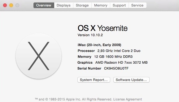

havdic Posted January 28, 2015 Share Posted January 28, 2015 update 10.10.2 solved youtube problems Link to comment https://www.insanelymac.com/forum/topic/302877-guide-yosemite-1010x-dell-optiplex-780-760/page/4/#findComment-2106288 Share on other sites More sharing options...
