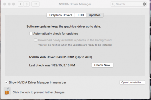

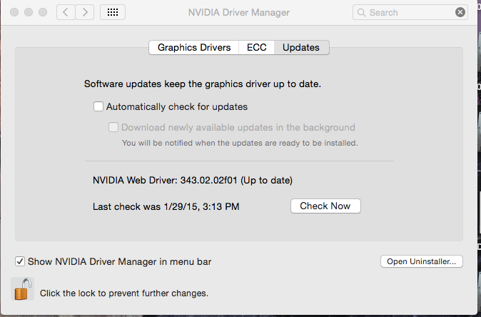

jamiethemorris Posted January 30, 2015 Author Share Posted January 30, 2015 Just tested 10.10.2 with the latest Nvidia driver. I've been using both safari and chrome (both of which would exacerbate the problem) for about 45 mins and haven't received any "graphics problem" messages and crashes back to the login window. Also, All outputs on the card are now working. I haven't tried this because I have no need for it in OS X, but I'm assuming HDMI audio is not working as it has not been for anyone else on the latest drivers. Link to comment https://www.insanelymac.com/forum/topic/302429-yosemite-gtx-9xx750750-ti-compatibility-report/page/4/#findComment-2106895 Share on other sites More sharing options...
jasonsansone Posted January 30, 2015 Share Posted January 30, 2015 Just tested 10.10.2 with the latest Nvidia driver. I've been using both safari and chrome (both of which would exacerbate the problem) for about 45 mins and haven't received any "graphics problem" messages and crashes back to the login window. Also, All outputs on the card are now working. I haven't tried this because I have no need for it in OS X, but I'm assuming HDMI audio is not working as it has not been for anyone else on the latest drivers. Confirmed. HDMI audio is still broken. Link to comment https://www.insanelymac.com/forum/topic/302429-yosemite-gtx-9xx750750-ti-compatibility-report/page/4/#findComment-2106896 Share on other sites More sharing options...

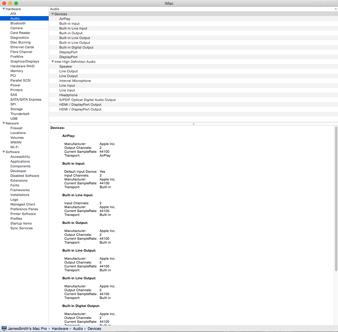

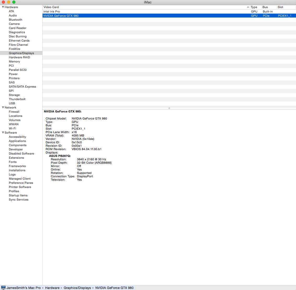

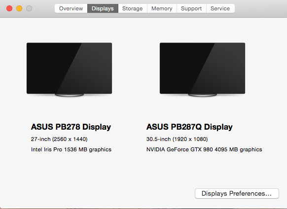

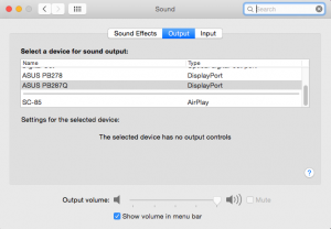

jsl Posted January 30, 2015 Share Posted January 30, 2015 (edited) Confirmed. HDMI audio is still broken. Good news for Nvidia GTX 980 users: Using proper DSDT.aml and GraphicsEnabler=N DP audio from Intel HD4600 & Nvidia 980 GTX are both working now in 10.10.2 (14C109) and latest Web Driver (343.02.02f01). My Nvidia GTX 980 is connected via 1st DP port to Asus 4K monitor (PB287Q). Edited February 8, 2015 by jsl 1 Link to comment https://www.insanelymac.com/forum/topic/302429-yosemite-gtx-9xx750750-ti-compatibility-report/page/4/#findComment-2106910 Share on other sites More sharing options...
jamiethemorris Posted January 30, 2015 Author Share Posted January 30, 2015 Good news for Nvidia GTX 980 users: Using proper DSDT.aml and GraphicsEnabler=N HDMI audio from Intel HD4600 & Nvidia 980 GTX are both working now in 10.10.2 (14C109) and latest Web Driver (343.02.02f01). My Nvidia GTX 980 is connected via 1st DP port to Asus 4K monitor (PB287Q). I'm assuming you just followed toleda's instructions? I know a few people have tried that without any luck, could be operator error though. Link to comment https://www.insanelymac.com/forum/topic/302429-yosemite-gtx-9xx750750-ti-compatibility-report/page/4/#findComment-2106917 Share on other sites More sharing options...
jamiethemorris Posted January 30, 2015 Author Share Posted January 30, 2015 I've been testing the latest drivers a bit more. I left the it on all day and I've been actively using it for several hours browsing the web, which is what would usually cause the graphics errors before. No problems as of yet - I'm going to test a bit more tomorrow, but I think it's pretty much safe to say it's fixed for me. Link to comment https://www.insanelymac.com/forum/topic/302429-yosemite-gtx-9xx750750-ti-compatibility-report/page/4/#findComment-2106925 Share on other sites More sharing options...
toleda Posted February 2, 2015 Share Posted February 2, 2015 My Nvidia GTX 980 is connected via 1st DP port to Asus 4K monitor (PB287Q). 343.02.02.02.f01: DP audio is working, HDMI and DVI2HDMI audio are not working. Link to comment https://www.insanelymac.com/forum/topic/302429-yosemite-gtx-9xx750750-ti-compatibility-report/page/4/#findComment-2108120 Share on other sites More sharing options...
Austere.J Posted February 2, 2015 Share Posted February 2, 2015 Good news for Nvidia GTX 980 users: Using proper DSDT.aml and GraphicsEnabler=N HDMI audio from Intel HD4600 & Nvidia 980 GTX are both working now in 10.10.2 (14C109) and latest Web Driver (343.02.02f01). My Nvidia GTX 980 is connected via 1st DP port to Asus 4K monitor (PB287Q). I saw your screen captures, so currently graphics and DP audio output are both enabled from Intel HD Graphics 4600 and GTX 980? Link to comment https://www.insanelymac.com/forum/topic/302429-yosemite-gtx-9xx750750-ti-compatibility-report/page/4/#findComment-2108179 Share on other sites More sharing options...
