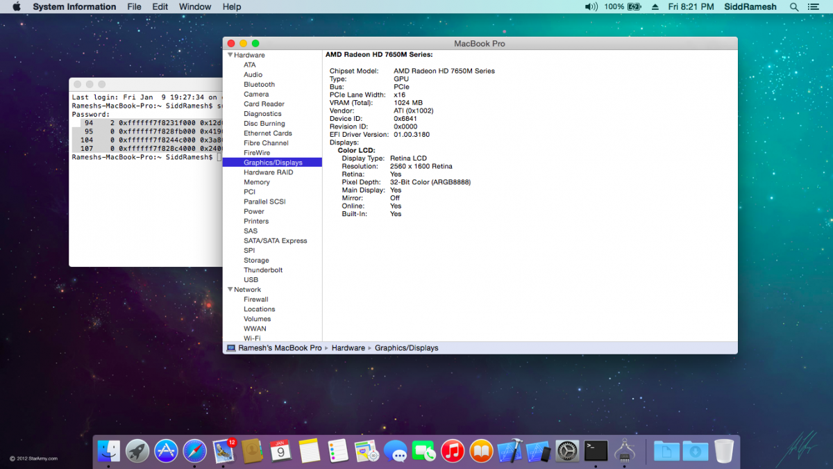

SiddRamesh Posted January 9, 2015 Share Posted January 9, 2015 I've solved gradient but now this ! Link to comment https://www.insanelymac.com/forum/topic/300906-guide-install-mavericksyosemite-on-sony-vaio-s-2012-and-other-uefi-capable-vaios/page/4/#findComment-2101917 Share on other sites More sharing options...
midi-sama Posted January 9, 2015 Author Share Posted January 9, 2015 That's fine since you have no hd4000. That's fine since you have no hd4000. Link to comment https://www.insanelymac.com/forum/topic/300906-guide-install-mavericksyosemite-on-sony-vaio-s-2012-and-other-uefi-capable-vaios/page/4/#findComment-2101933 Share on other sites More sharing options...

vusun123 Posted January 15, 2015 Share Posted January 15, 2015 @Sidd looks like you are diffing your original EDID with another rMBP right ? If you have gradient issue, just change the first value of your basic param to 90, then recalculate the checksum and you are good to go Edit: for Intel HD4000, your laptop doesn't have it aka disabled in the bios, give a picture of Device Manager > Display Adapter to prove that you have Intel HD4000 Link to comment https://www.insanelymac.com/forum/topic/300906-guide-install-mavericksyosemite-on-sony-vaio-s-2012-and-other-uefi-capable-vaios/page/4/#findComment-2103084 Share on other sites More sharing options...
