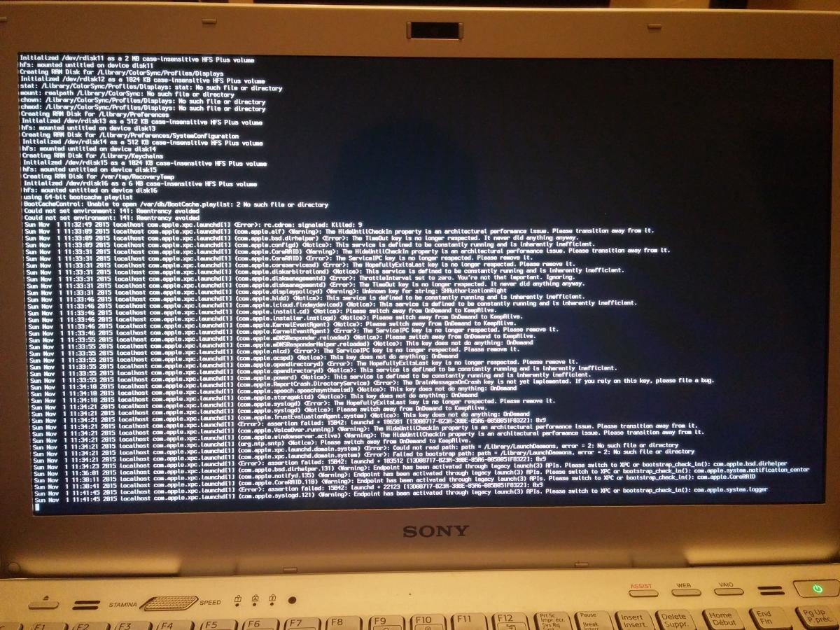

peppershaker Posted November 2, 2015 Share Posted November 2, 2015 Dude! The zip doesnt have any config.plist! Looks like you've been skipping steps, no? Hey man, I added the config.plist as according to the guide. Now I got El Cap installed. However I'm stuck on the DSDT patching step, it's returning compilation errors even before applying any patches. http://imgur.com/yedjMHM Problems so far - Top usb not working - Restart on wake - No sound - Touchpad not registering more than 2 fingers, and back gesture not working in Safari Link to comment https://www.insanelymac.com/forum/topic/300906-guide-install-mavericksyosemite-on-sony-vaio-s-2012-and-other-uefi-capable-vaios/page/13/#findComment-2184646 Share on other sites More sharing options...
midi-sama Posted November 2, 2015 Author Share Posted November 2, 2015 1) Did you apply the patch given for usb series 7/8 (NOT MUTEX) and the EHC renaming as statd before?2) Did you patch the other stuff on DSDT as I stated on my guide?3) Did you install the DummyHDA and added the clover patches on the config as stated on my post and the new added patch in the last few posts?4) the multi-touch work only for scrollinh, three finger swipes need to be configured under Keyboard> Shortcuts > select an action and swipe.The dsdt looks fine, no errors, just ignore the warnings. Link to comment https://www.insanelymac.com/forum/topic/300906-guide-install-mavericksyosemite-on-sony-vaio-s-2012-and-other-uefi-capable-vaios/page/13/#findComment-2184651 Share on other sites More sharing options...
peppershaker Posted November 2, 2015 Share Posted November 2, 2015 1) Did you apply the patch given for usb series 7/8 (NOT MUTEX) and the EHC renaming as statd before? 2) Did you patch the other stuff on DSDT as I stated on my guide? 3) Did you install the DummyHDA and added the clover patches on the config as stated on my post and the new added patch in the last few posts? 4) the multi-touch work only for scrollinh, three finger swipes need to be configured under Keyboard> Shortcuts > select an action and swipe. The dsdt looks fine, no errors, just ignore the warnings. i didn't apply any patch on DSDT yet man, because it won't let me. When I hit compile iALS returns the list of messages and warnings. How do I ignore them and continue to compile? thanks again Link to comment https://www.insanelymac.com/forum/topic/300906-guide-install-mavericksyosemite-on-sony-vaio-s-2012-and-other-uefi-capable-vaios/page/13/#findComment-2184652 Share on other sites More sharing options...
