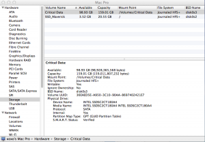

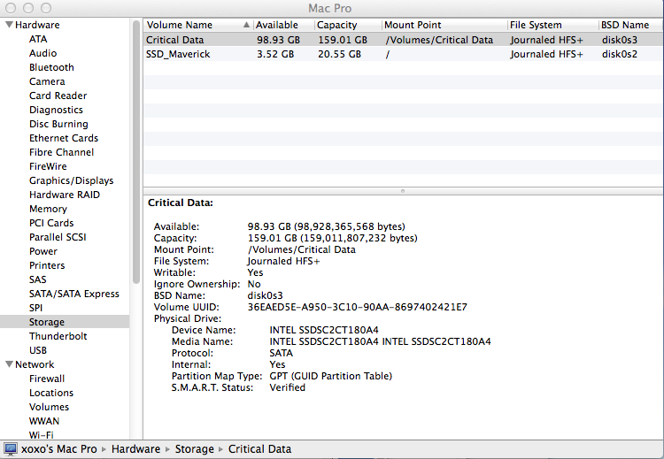

vamose Posted April 23, 2014 Share Posted April 23, 2014 Sleep works perfectly fine on traditional mechanical Hard drive. Upgraded to Intel SSD and now computer goes to sleep, but never wakes up. Have to do a hard reset every time. Any solution. Attached is the SSD details. Tried installing Trim Enabler - No luck. Available: 98.93 GB (98,928,365,568 bytes) Capacity: 159.01 GB (159,011,807,232 bytes) Mount Point: /Volumes/Critical Data File System: Journaled HFS+ Writable: Yes Ignore Ownership: No BSD Name: disk0s3 Volume UUID: 36EAED5E-A950-3C10-90AA-8697402421E7 Physical Drive: Device Name: INTEL SSDSC2CT180A4 Media Name: INTEL SSDSC2CT180A4 INTEL SSDSC2CT180A4 Protocol: SATA Internal: Yes Partition Map Type: GPT (GUID Partition Table) S.M.A.R.T. Status: Verified Link to comment https://www.insanelymac.com/forum/topic/297639-sleep-broken-intel-ssd-maverick/ Share on other sites More sharing options...

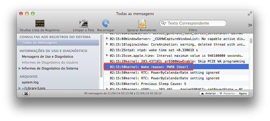

Allan Posted April 23, 2014 Share Posted April 23, 2014 after sleep, go in Console, and verify this line: Link to comment https://www.insanelymac.com/forum/topic/297639-sleep-broken-intel-ssd-maverick/#findComment-2014714 Share on other sites More sharing options...
