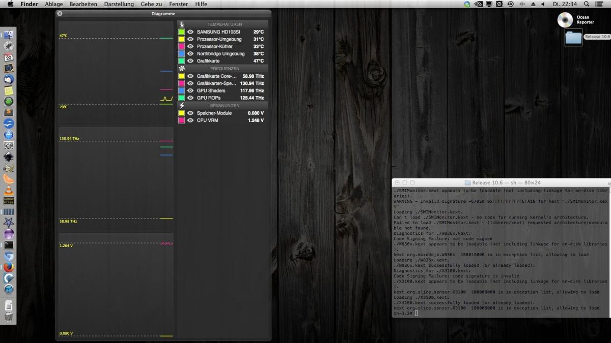

dreadkopp Posted May 20, 2014 Share Posted May 20, 2014 with cabba r2 kernel + mac pro 3,1 smbios and the fakesmc you posted it works (nearly completely). no errors, faster bootup. just load fakesmc.kext right now. when i load all other drivers (kextutil -v ~/"Release 10.6"/*) i still get no system freeze but it reads the frequency of my gtx 460 wrong (even if i liked it if it was in the THz-area ) also, as i thought, the power management of the gpu is not working. but thats a different problem. any way to fix the frequency for the graphics card? NVClock gives me GPU Temp, AMDCPUMonitor Cpu Temp, ITEIT87x Northbridge and Cpuarea Temps and Nuvoton Vcore and incorrect Ram Voltage. With macPro 5,1 or 4,1 smbios i still get OPEMU wsrmr error. greetings! Link to comment https://www.insanelymac.com/forum/topic/296460-amdcpumonitor-and-hwsensors-331/page/3/#findComment-2021048 Share on other sites More sharing options...
Slice Posted May 21, 2014 Author Share Posted May 21, 2014 Kozlek's HWMonitor shows frequency x1000 as should for my plugins. Your picture is inaccessible It will be better if you attach your pictures directly to post as I did. Link to comment https://www.insanelymac.com/forum/topic/296460-amdcpumonitor-and-hwsensors-331/page/3/#findComment-2021119 Share on other sites More sharing options...

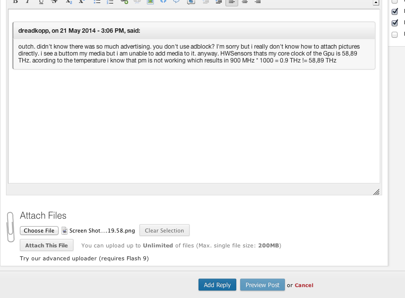

dreadkopp Posted May 21, 2014 Share Posted May 21, 2014 outch. didn't know there was so much advertising. you don't use adblock? I'm sorry but i really don't know how to attach pictures directly. i see a buttom my media but i am unable to add media to it. anyway. HWSensors thats my core clock of the Gpu is 58,89 THz. acording to the temperature i know that pm is not working which results in 900 MHz * 1000 = 0.9 THz != 58,89 THz edit: fixed the picture Link to comment https://www.insanelymac.com/forum/topic/296460-amdcpumonitor-and-hwsensors-331/page/3/#findComment-2021158 Share on other sites More sharing options...
Slice Posted May 21, 2014 Author Share Posted May 21, 2014 outch. didn't know there was so much advertising. you don't use adblock? I'm sorry but i really don't know how to attach pictures directly. i see a buttom my media but i am unable to add media to it. anyway. HWSensors thats my core clock of the Gpu is 58,89 THz. acording to the temperature i know that pm is not working which results in 900 MHz * 1000 = 0.9 THz != 58,89 THz Use More Reply Options -> Choose File -> Attach This File -> Add to Post Link to comment https://www.insanelymac.com/forum/topic/296460-amdcpumonitor-and-hwsensors-331/page/3/#findComment-2021191 Share on other sites More sharing options...

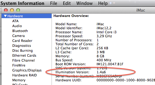

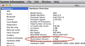

Slice Posted June 15, 2014 Author Share Posted June 15, 2014 I added one new key LsbV and kernel.log now more clear <key>LsNM</key> <array> <string>ui8</string> <data>AQ==</data> </array> <key>LsbV</key> <array> <string>hex_</string> <data>AQQKAAY=</data> </array> And new line appears in System Profiler Link to comment https://www.insanelymac.com/forum/topic/296460-amdcpumonitor-and-hwsensors-331/page/3/#findComment-2030447 Share on other sites More sharing options...
