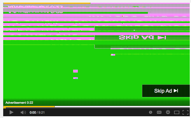

Hackmodford Posted January 18, 2014 Share Posted January 18, 2014 I've managed to get speed stepping working on my machine by generating a ssdt and changing my smbios. However after doing this flash player give me weird graphical glitches. If I revert the smbios.plist back to mac pro. The glitches go away, and the speed stepping stops working. My question is, what should my smbios.plist be? I've tried Macmini6,2 and MacBookPro9,1 Any help would be great Here's an example of the glitches. If I remove my graphics card and use the HD4000 I do not have any problems. Link to comment https://www.insanelymac.com/forum/topic/295408-ivybridge-xcpm-pstate-table-mismatch-error-was-ivybridge-ssdt-graphical-glitches/ Share on other sites More sharing options...

Hackmodford Posted January 19, 2014 Author Share Posted January 19, 2014 LOL I understand. I'm not that dedicated to tonymac, and if I switch the boot loader does that make you guys happy But I'm not clear on what the instructions will actually do? I don't need the HD4000 graphics activated. This problem seems to be related to Safari. At first I thought it was from the recent Flash v12 update, because when I used Google Chrome I didn't have the issue on youtube. I browsed to apples mac pro page in safari and got the same graphical glitching and locked up the computer. Tried the same page in Chrome and there was no issue. Next I thought, maybe Safari is corrupted, so I downloaded the 10.9.1 update and reinstalled it. That did not fix the issue either. So at the moment I'm using the Macmini6,2 smbios and have power states, but weird graphic glitches. Update: Someone told me that the iMac smbios will give you less pstates just like a real iMac. So if I use the iMac smbios I get 16 and 39. If that is how the real iMac would work I'm fine with it. Is this true? With the iMac smbios I do not get graphic glitches. Link to comment https://www.insanelymac.com/forum/topic/295408-ivybridge-xcpm-pstate-table-mismatch-error-was-ivybridge-ssdt-graphical-glitches/#findComment-1986518 Share on other sites More sharing options...
Gringo Vermelho Posted January 19, 2014 Share Posted January 19, 2014 No, I'm pretty sure it's tied to the model identifier you were using, the graphics glitches have something to do with the MacMini not having discrete graphics. It makes sense that everything returns to normal when you use only the HD4000. I have 6 p-states on an i5-3570K (turbo @ 4100MHz) with this iMac13,1 smbios.plist and latest Chameleon. PMPatched Asus Z77 board. MSRDumper PStatesReached: 16 25 29 34 37 41 Even though I'm getting these messages: XCPM: P-state table mismatch (error:0x1a) X86PlatformShim::sendPStates - pmCPUControl (XCPMIO_SETPSTATETABLE) returned 0x1a X86PlatformShim::start - Failed to send PStates X86PlatformShim::start - Failed to send stepper Using -xcpm kernel flag and SSDT.aml generated with ssdtPRGen.sh. Link to comment https://www.insanelymac.com/forum/topic/295408-ivybridge-xcpm-pstate-table-mismatch-error-was-ivybridge-ssdt-graphical-glitches/#findComment-1986546 Share on other sites More sharing options...
