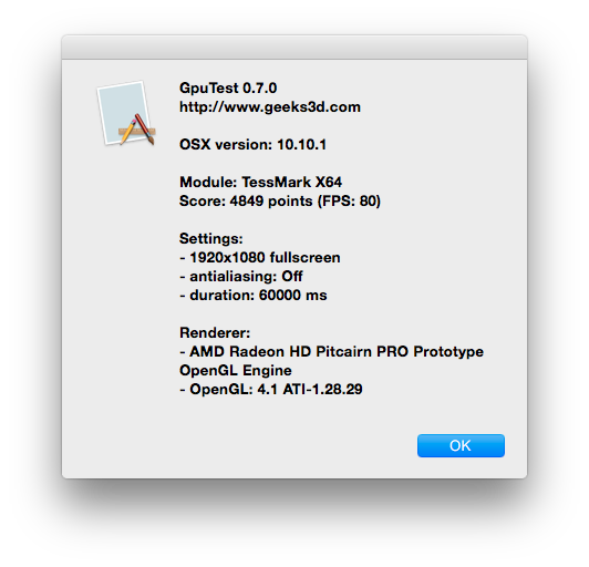

I've got my Sapphire Dual-X 270X running right OOB just like you said. It loads the Radeon FB and scores 82 in Cinebench, but it's far from the 120 it does on Windows, and from your 105. Could you tell me what SMBIOS and patches you're using? Could the CPU be the reason for the difference? Just to compare, could you run Geeks3D's GpuTest?
Im using MP6,1 and no extra patches or injection. Doing the benches you listed with same sizes I get:
4963 82fps
7648 128fps
7448 123fps
I ran cinebench after that and got 98fps. I would guess my cpu is adding the extra fps in cinebench but you are @4.5 and mine is auto to 4.0, and you have 270X which is a little faster than mine. I don't understand why your GpuTest 1024x640 windowed score is so much higher than mine or why my fullscreen 1920x180 is so much higher than yours :P
Thanks joe75, seems like performance is inconsistent in Cinebench and that the CPU affects it quite a bit. For now I'm also using the MacPro6,1 profile but with Vlada's PM patch for Sandy, so I get good PStates and the graphics performance is good too, but I think it should be better. I'll try with the new iMac profile just to see if there's any performance difference and report back.

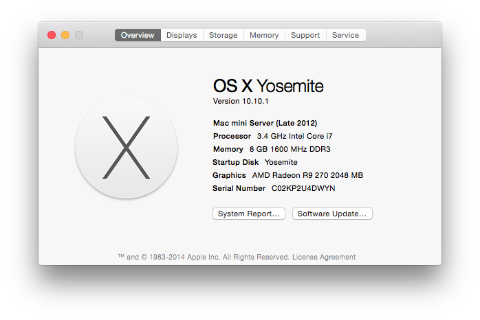

I edited myself my AMDRadeonX4000, AMD7000Controller and added the DSDT patch (under P0P2) but I won't get any video after the verbose boot finishes. If I don't use my DSDT but still use the patched kexts I still get no video. If I don't load the kexts (kext-dev-mode=0) then I get video but with no acceleration (sh**).
This is what I get when not using the kexts, only the DSDT patch:
Any ideas on how to fix this? Thanks!
EDIT:
After only patching AMD7000Controller and rebooting with kext-dev-mode=1, I was able to boot "successfully". I just get a black screen but the system is working, I had to "imagine" the screen and put the computer to sleep (imagining and trying to get the clicks right), then after waking up I got video but without acceleration. If I boot without DSDT, only with AMD7000Controller patched, I get video but without acceleration and the graphic card is identified as 7xxx series.
TimeShift
add complete ID 68111002 in the two kext above
and that's it, you've tried?
Yeah. All I get is a quick flash after finishing the boot process. Just like that flash you get when you are going to get video but here nothing shows up. I guess the opposite was supposed to happen: when I have the ID on those kexts, I should get video and when I don't have the ID inserted, I shouldn't get. But the inverse is happening.
I found out that the problem is when X4000 gets loaded. I get video (even though w/o acceleration) if only 7000Controller is loaded, but I get no video at all if X4000 gets loaded.
My boot loader is chameleon 2.3svn r2468.
EDIT:
Alright, turns out I was adding my device ID on the wrong personality in the X4000 kext. And I also had to remove the DSDT patch (thought I had to use both DSDT and kexts). Now everything is working. Many thanks!!!
