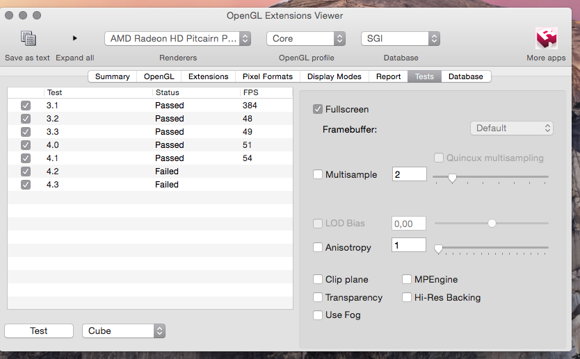

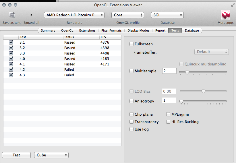

Not a newbie but light years behind you guys.
I've upgraded to 10.10.1 and got everything functioning perfectly with no DSDT and Chimera 4.0/Chameleon. I'd like to keep it that way.
BUT, my Sapphire r9 270x Vapor-x has dropped in performance. (2700 fps in Mavericks to 750 in Yosemite with Nova Bench.)
Is it possible to regain performance without a DSDT or Clover? Like maybe editing a plist or something that I understand?
I was thinking about replacing ATI kexts with those that worked in 10.9.5. Probably naive eh?
Edited: Tried the injector kext for Mavericks...Does not work in Yosemite. It must be quite different. I guess it's time to use a DSDT. I believe there are solutions if you use a DSDT. It's time I learned how to work with that anyway. I could restore to Mavericks but I like Yosemite too much.
Update: After several days with the modified 'Hamachi' framebuffer, I cannot yet say that the UI performance of my Gigabyte R9 270X under Yosemite is adequate. I would say that performance is on the same level as the standard Radeon framebuffer. UI transitions are not fluent at all. Framerates vary from 12 to 60 (disabling vsync does not do much but heightening the fps ceiling).
In any case, I can confirm that the periodical stuttering is gone after modifying the port layout of the framebuffer. What I would also like to investigate is the impact of my dual graphic card - triple screen config on the performance. In this situation, the AMD Renderer has to co-operate with the Intel Renderer. Maybe it is actually the division of graphic labor that is skewed?
For the next days I will try to measure the performance (framerate) of a few other Pitcairn framebuffers (Aji, Futomaki, etc.)
For other volunteer-testers: try running the Quartz Debug application which gives a few measuring options (like a framemeter). You can find it under the name 'Graphics Tools for Xcode' on this page https://developer.apple.com/downloads/index.action
The standard Radeon Framebuffer recognizes all my displays correctly when I use AtiInject=Yes with Clover, but the performance of my AMD R9 270X is sub-par. There is no stuttering as with the Futomaki framebuffer, but there are visual artefacts and general ui unresponsiveness.
So I tried to use Hamachi with corrected hex values for all my ports. The result is that the stuttering is gone, and the perceived performance is restored.
Therefore I find that the standard Radeon framebuffer does impact performance negatively, and that Futomaki is not properly optimized for my card in Yosemite.
Possibly Futomaki could also give proper performance, if I would correct its port values via Clover.
