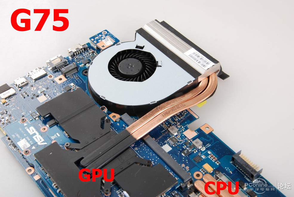

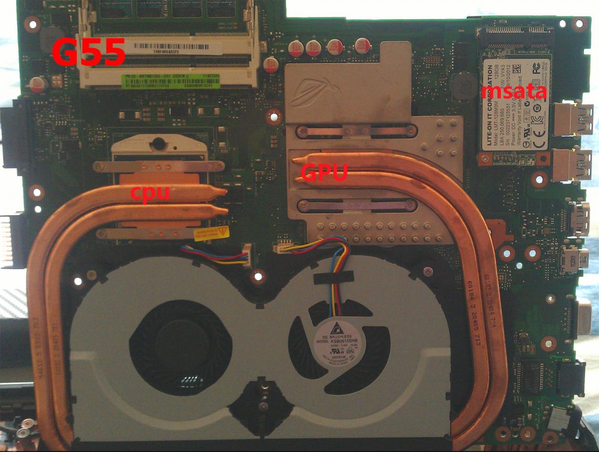

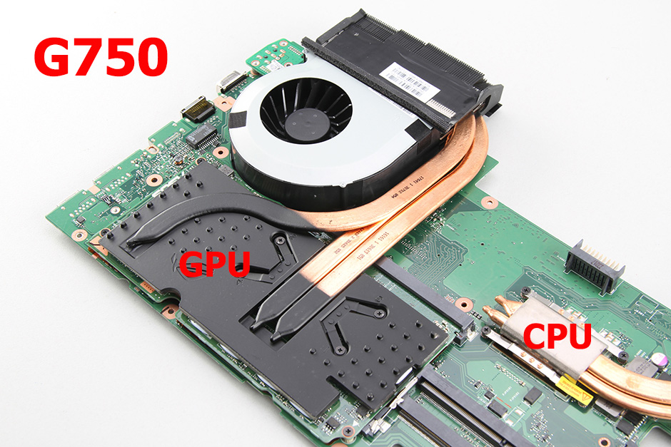

yisl04 Posted January 21, 2014 Share Posted January 21, 2014 I found some disassembling pictures of the laptops on internet. I think the problem of G55 is not the same as G75 and G750, because the GPU of G55 is soldered on the motherboard and the GPU of G75 or G750 is a PCI card pluged in the PCI slot. The type of G75 and G750 is the same as desktop computer and easy to be driven. I think the problem of G55 is the in integrated graphics card HD4000 which is maybe not totally disabled. Link to comment https://www.insanelymac.com/forum/topic/293967-solved-asus-rog-laptops-with-kepler-cards-not-detecting-dp-2-connected-lcd-display/page/5/#findComment-1987102 Share on other sites More sharing options...
gazzacbr Posted January 21, 2014 Author Share Posted January 21, 2014 @yisl04: but the G750 with 2D screen boots straight to OS X and the G750 with 3D screen does not... they both have the same CPU and GPU, only the screen is connected differently 2D=LVDS and 3D=internal/embedded Display Port (i think ) Link to comment https://www.insanelymac.com/forum/topic/293967-solved-asus-rog-laptops-with-kepler-cards-not-detecting-dp-2-connected-lcd-display/page/5/#findComment-1987141 Share on other sites More sharing options...
NiPeGun Posted January 21, 2014 Share Posted January 21, 2014 @yisl04: but the G750 with 2D screen boots straight to OS X and the G750 with 3D screen does not...<br />they both have the same CPU and GPU, only the screen is connected differently 2D=LVDS and 3D=internal/embedded Display Port<br />(i think )<br /><br />Yes, I think the same.<br /><br /><br />Gazza, make this changes to the bios:<br /><br /><br />Set vt-d to disabled<br />Set Thunderbolt port to debug mode<br /><br /> Then try booting with nvdaresman and ge=no: and no vga attached<br /><br />Report back Link to comment https://www.insanelymac.com/forum/topic/293967-solved-asus-rog-laptops-with-kepler-cards-not-detecting-dp-2-connected-lcd-display/page/5/#findComment-1987251 Share on other sites More sharing options...
