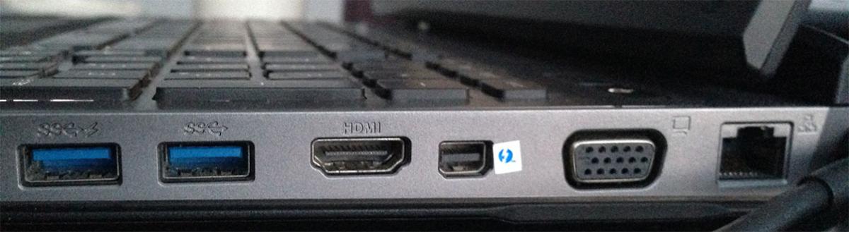

NiPeGun Posted January 10, 2014 Share Posted January 10, 2014 Not all G750 have thunderbolt. I know some ones have only minidisplayport connector. Take a look to your specs or just try to connect a thunderbolt harddrive to see if works. There are other two ways to check it: 1 All Asus notebooks with thunderbolt have the sticker near to the connector like the picture above. 2 In BIOS you can change the way thunberbolt runs. If you doesn't have that option in BIOS you don't have it. Link to comment https://www.insanelymac.com/forum/topic/293967-solved-asus-rog-laptops-with-kepler-cards-not-detecting-dp-2-connected-lcd-display/page/4/#findComment-1983692 Share on other sites More sharing options...
gazzacbr Posted January 10, 2014 Author Share Posted January 10, 2014 Yes, I think my G55VW-DH71 also has the thunderbolt-displayport mixed connector. ports.jpg Hi, yes, thats the same sticker as mine. i dont have thunderbolt anything but will ask around in the office next week. will it prove anything if i can/cannot boot through thunderbolt? Link to comment https://www.insanelymac.com/forum/topic/293967-solved-asus-rog-laptops-with-kepler-cards-not-detecting-dp-2-connected-lcd-display/page/4/#findComment-1983790 Share on other sites More sharing options...
NiPeGun Posted January 11, 2014 Share Posted January 11, 2014 Hi, yes, thats the same sticker as mine. i dont have thunderbolt anything but will ask around in the office next week. will it prove anything if i can/cannot boot through thunderbolt? Well, if we all 3 have different notebooks (g55, g75, and g750) and the 3 of us are having thunderbolt and not booting to desktop, it seems to me a lot of coincidence. We need to find an Apple thunderbolt display and start booting with it connected, to see what happens, and then save IOReg, sure we find some thing interesting Link to comment https://www.insanelymac.com/forum/topic/293967-solved-asus-rog-laptops-with-kepler-cards-not-detecting-dp-2-connected-lcd-display/page/4/#findComment-1983944 Share on other sites More sharing options...

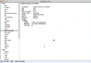

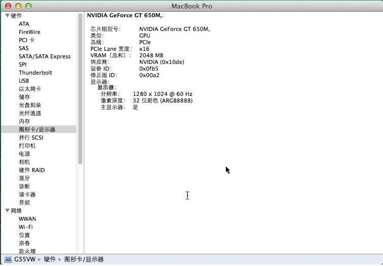

yisl04 Posted January 12, 2014 Share Posted January 12, 2014 I have tried to add fake device-id in the dsdt, such as 0fe0(Mac GTX660M id), 0fb5(Mac GT 650M id), nothing changed. Link to comment https://www.insanelymac.com/forum/topic/293967-solved-asus-rog-laptops-with-kepler-cards-not-detecting-dp-2-connected-lcd-display/page/4/#findComment-1984306 Share on other sites More sharing options...
NiPeGun Posted January 12, 2014 Share Posted January 12, 2014 I have tried to add fake device-id in the dsdt, such as 0fe0(Mac GTX660M id), 0fb5(Mac GT 650M id), nothing changed. bk.png Yeah, it must be something so simple that when we discover it we going to just don't believe we were so dumbs. I think we better check if all people having this issues with asus notebooks have thunderbolt too. That will gives an inportant clue. Graphi cs card is supported by OSX out of the box. Without injecting anything. The thing is to indicate the system about displays @gazzacbr can you boot verbose with the vga on and post here all the text output after NvDAGK100 stuff loaded? Is there any reference to NVdAResMan after that? Link to comment https://www.insanelymac.com/forum/topic/293967-solved-asus-rog-laptops-with-kepler-cards-not-detecting-dp-2-connected-lcd-display/page/4/#findComment-1984308 Share on other sites More sharing options...
yisl04 Posted January 12, 2014 Share Posted January 12, 2014 Yeah, it must be something so simple that when we discover it we going to just don't believe we were so dumbs.I think we better check if all people having this issues with asus notebooks have thunderbolt too. That will gives an inportant clue.Graphi cs card is supported by OSX out of the box. Without injecting anything. The thing is to indicate the system about displays According the fake device-id try, I think OSX treats all NVIDIA 6xxM Kelper cards the same. I think we can get some clues by comparing the ioreg of the Mac machine using the NVIDIA 6xx cards. Link to comment https://www.insanelymac.com/forum/topic/293967-solved-asus-rog-laptops-with-kepler-cards-not-detecting-dp-2-connected-lcd-display/page/4/#findComment-1984389 Share on other sites More sharing options...

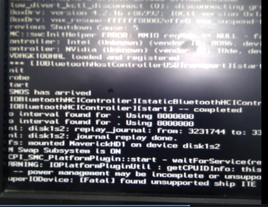

gazzacbr Posted January 14, 2014 Author Share Posted January 14, 2014 @areos: thanks, only starting on internal screen hangs with black screen. i think it is still there running as the harddisk light flickers sometimes. attached is my Chameleon smbios and boot.plist if thats any help. also a (poor phone quality) screenshot just before blackout. the screen is exactly the same with/without vga connected. the clipped text on the left only occurs on the Dell monitor not on the lcd. same when running. i saw some settings different between the lcd and dell in the EDID settings when I was playing with those before. @NiPegun: "Graphics card is supported by OSX out of the box. Without injecting anything." thats an important point. my attempts at injecting EDID made it worse than before. Gary Asus G750 VGA smbios and boot.plist.zip Link to comment https://www.insanelymac.com/forum/topic/293967-solved-asus-rog-laptops-with-kepler-cards-not-detecting-dp-2-connected-lcd-display/page/4/#findComment-1984978 Share on other sites More sharing options...
