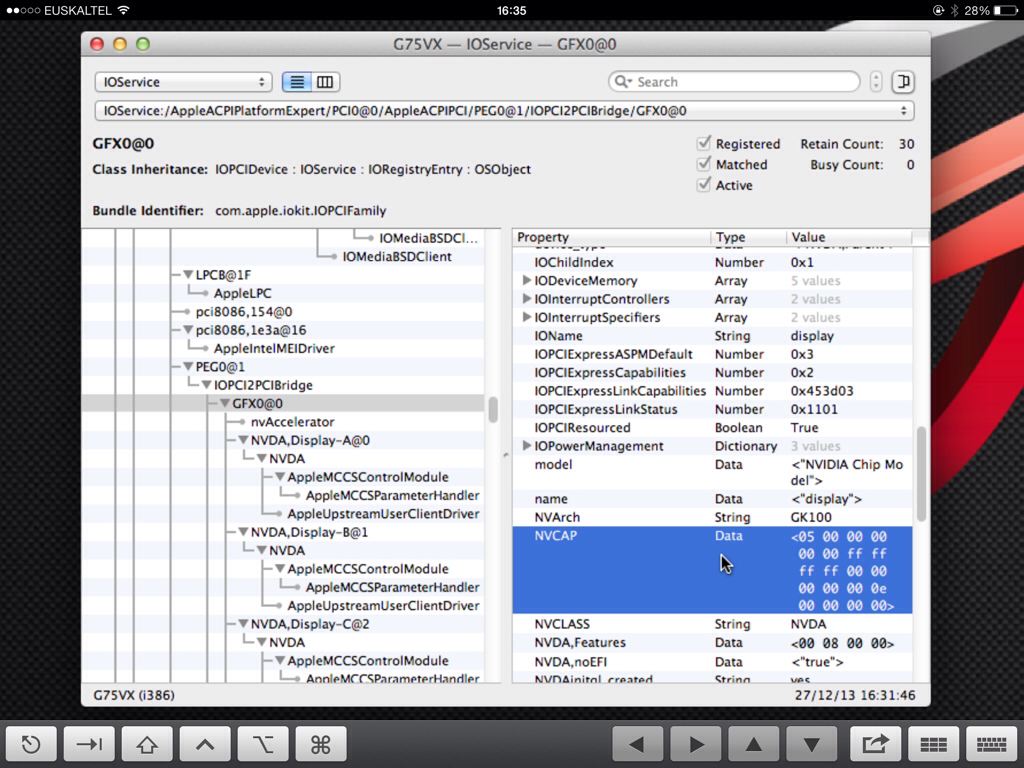

NiPeGun Posted December 20, 2013 Share Posted December 20, 2013 The NVCAP string can separated 20 hexadecimal parts, like 0x04, 0x00,...... The first part 0x04 is 0100 in binary format, means single video card slot. The 7th part 0x01 is the primary card ports and the 9th part 0x02 is the secondary card ports. The 7th part 0x01 is 0001 and the the 9th part is 0010, each bit means one port, 0 is off, 1 is on. According the information offered before, the 1st bit mans TV port, the 2nd bit means HDMI port, the 3rd bit means VGA port, the 4th bit means DP port. So the primary ports 7th part 0x01 means the DP port is on, the secondary ports 9th part 0x02 means the VGA port is on. According the @Styrian's opinion, the NVCAP of mobile kepler card can do nothing on OSX, so NVCAP is useless for solving the problem. Excellent information!! Link to comment https://www.insanelymac.com/forum/topic/293967-solved-asus-rog-laptops-with-kepler-cards-not-detecting-dp-2-connected-lcd-display/page/3/#findComment-1977273 Share on other sites More sharing options...
styrian Posted December 20, 2013 Share Posted December 20, 2013 @vislo4 Thanks for the exellent information. Apple is using for the iMacs 13,1/13,2/14,2 these same values for NVCAP: 0500 0000 0000 0100 0600 0000 0000 000f 0000 0000 The MBP 9,1 and 10,1 have these values for NVCAP: 0501 0000 0000 0100 0600 0000 0000 000f 0000 0000 The MBP 7,1 with only Fermi gfx has these values for NVCAP: 0501 0000 0000 0100 0600 0000 0000 000e 0000 0000 Does anybody know the meaning of the with colors marked digits? In any case it seems to be important to add @0,fboffset data 00000200 in an EFI String for internal laptop display, to get it dedected as internal on port 0 by OSX. A good source for getting dumps of Apple hardware is this one: http://tdev.me/2010/12/apple-hardware-dumps/ An Ioreg.rtf file of an iMac 14,2 I have attached below. I have removed parts of the platformUUID, board-ID and SerialNr., which I don´t give away. On the L702x 3D (fully working display EDID) I have added nearly all properties for AAPL00 and @0,...... from Ioreg of MBP 7,1 with the for it set values. This seems to work fine with the GT555m. Display mirroring is also working with the HDMI port. But I know it by myself, Kepler cards are other things. I believe, that we are with an EFI-String not far way from getting the Kepler cards working. But we have to find some of the properties and values, we have to set, perhaps with a healthy mix of properties and values (Laptop and OSX). Even trying to set the Apple NVCAP (or some of it´s values) seems to make sence on mobile devices. Have fun. iMac 14,2.rtf.zip Link to comment https://www.insanelymac.com/forum/topic/293967-solved-asus-rog-laptops-with-kepler-cards-not-detecting-dp-2-connected-lcd-display/page/3/#findComment-1977396 Share on other sites More sharing options...
NiPeGun Posted December 21, 2013 Share Posted December 21, 2013 @Styrian, I noticed the EFI string you gave me has the NVCAP value of the MBP 9,1 that you wrote in the previous post. Can you make a new EFI string based on the previous one without touching anything but adding the NVCAP from my original VBIOS rom? By the way, you have a PM Link to comment https://www.insanelymac.com/forum/topic/293967-solved-asus-rog-laptops-with-kepler-cards-not-detecting-dp-2-connected-lcd-display/page/3/#findComment-1977587 Share on other sites More sharing options...

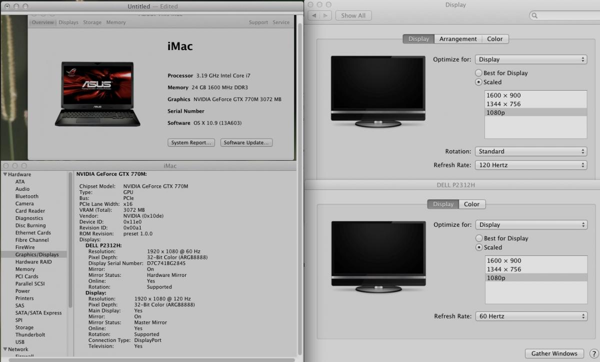

yisl04 Posted December 26, 2013 Share Posted December 26, 2013 Don't get mad searching for data. it doesn't matter which type of screen your notebook uses. Is just that if is a 120hz display, uses displayport wich untill know, we can't manage to fire it first to osx recognizes it.Maybe I'm confused about the conception of screen and display.I have bought a pcs of second-hand G55VW-DH71 from American Amazon, which has a 1920x1080 screen. I will get the laptop few days later. I have checked the max. refresh rate of the screen is 60Hz. I'm not sure the port is LVDS or not. Do you think the graphics card and screen of my laptop can work on OSX? ps. I have bought BCM94325HMB wifi+BT4.0 card to change the AR9485WB-EG card. Do you have the AppleHDA.kext for Via vt1802p? Link to comment https://www.insanelymac.com/forum/topic/293967-solved-asus-rog-laptops-with-kepler-cards-not-detecting-dp-2-connected-lcd-display/page/3/#findComment-1978891 Share on other sites More sharing options...

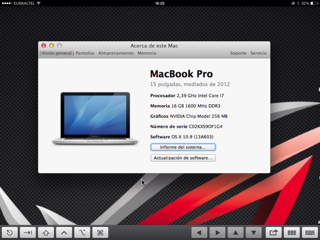

NiPeGun Posted December 27, 2013 Share Posted December 27, 2013 I've made some progress. Well, depends of the point of view indeed. But I've reached the desktop with NVDAResman.kext IN and no extra parameters in org.Chameleon.boot.plist but basics. What happens is that desktop is fully loaded when we think is not. I've just enabled the screen sharing through VNC and once the system seems to be hanged I conneted my ipad to it using the Screens app (vnc connection) and managed to look in IOREGExplorer details. I found then that there are all of the 4 display connectors (being displayA@1, displayB@2, displayC@3 and display D@4) in GFX0. This is very useful because it proofs what I suspected a months ago: that this graphics card has 4 display outputs. The strange thing here is that all of the 4 outputs has display-cfg = ffffffff. I know I can give alternate values for display-cfg 0 and 1 in chameleon, but I wonder if display-cfg 3 and 4 can be indicated too. Maybe chameleon need to add this to its code to adapt itself to new graphics cards. Curious thing is that you just can't find a display in system information. It just shows no display connected to it. Expected I think, but then I tried to connect the TV to my hackintosh through HDMI nor VGA but it keeps detecting no display. Another curious thing is that under system information there's no info about the graphics card but "NVIDIA chip model 256MB" meaning that we need to modify anything else (like the NVDAResman kext itself or any other) cause NVDAResman is loaded but it keeps not detecting the VRAM and the whole graphics card. Or maybe NVDAResman needs to detect a display to start working. I don´t know yet. Now question: is there any other utility for Linux similar to IORegExplorer?? That would be amazing because we can then observe the corrects display-cfg data of the 4 outputs.Below I attached some screenshots starting with my org.chameleon.boot.plist (to let you know that is really clean). Remember that NVDAResman is loaded. . Link to comment https://www.insanelymac.com/forum/topic/293967-solved-asus-rog-laptops-with-kepler-cards-not-detecting-dp-2-connected-lcd-display/page/3/#findComment-1979470 Share on other sites More sharing options...

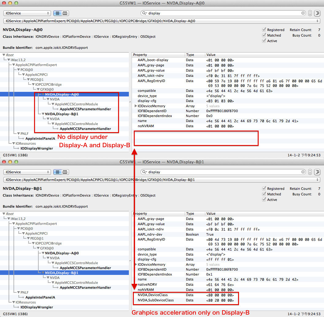

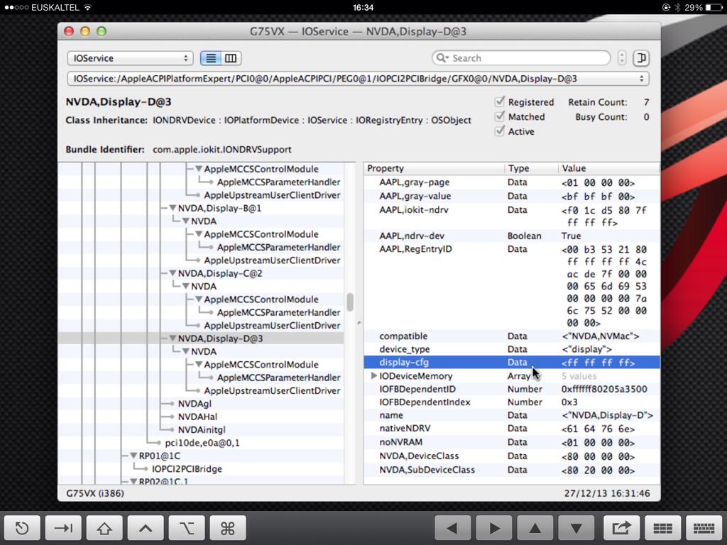

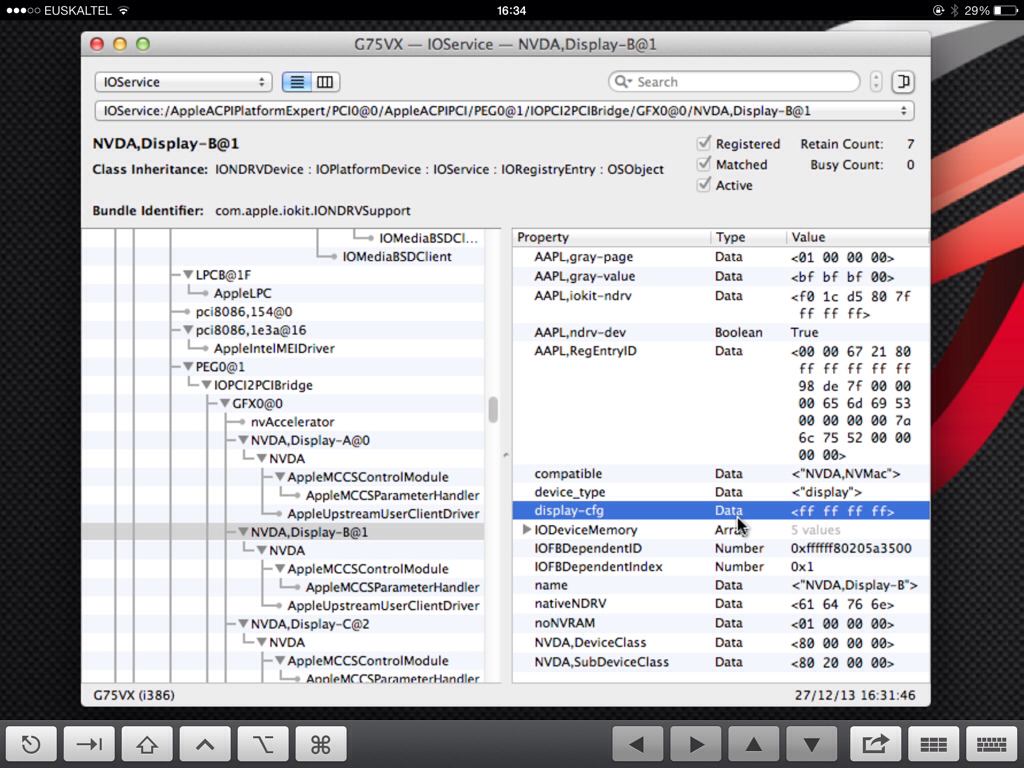

NiPeGun Posted December 27, 2013 Share Posted December 27, 2013 Now, following the tips which I detailed in this thread, I was able to get this information about my display: Screen 0: minimum 8 x 8, current 1920 x 1080, maximum 16384 x 16384 DP-2 connected primary 1920x1080+0+0 (0x283) normal (normal left inverted right x axis y axis) 382mm x 215mm Identifier: 0x282 Timestamp: 16116 Subpixel: unknown Gamma: 1.0:1.0:1.0 Brightness: 1.0 Clones: CRTC: 0 CRTCs: 0 1 2 3 Transform: 1.000000 0.000000 0.000000 0.000000 1.000000 0.000000 0.000000 0.000000 1.000000 filter: Backlight: 100 range: (0, 100) EDID: 00ffffffffffff004ca3445000000000 01140104952615780287f594574f8c27 27505400000001010101010101010101 0101010101015f3980dc703840403020 35007ed71000001b0000000f00000000 00000000003c9610fe00000000fe0053 414d53554e470a2020202020000000fe 004c544e3137334854303250303101ce 02010400f25c80a07038404030203500 7ed71000001b3d6680a0703840403020 35007ed71000001b896f80a070384040 302035007ed71000001b000000000000 00000000000000000000000000000000 00000000000000000000000000000000 00000000000000000000000000000000 00000000000000000000000000000029 BorderDimensions: 4 supported: 4 Border: 0 0 0 0 range: (0, 65535) SignalFormat: DisplayPort supported: DisplayPort ConnectorType: Panel ConnectorNumber: 0 _ConnectorLocation: 0 VGA-0 disconnected (normal left inverted right x axis y axis) Identifier: 0x27e Timestamp: 16116 Subpixel: unknown Clones: CRTCs: 0 1 2 3 Transform: 1.000000 0.000000 0.000000 0.000000 1.000000 0.000000 0.000000 0.000000 1.000000 filter: BorderDimensions: 4 supported: 4 Border: 0 0 0 0 range: (0, 65535) SignalFormat: VGA supported: VGA ConnectorType: VGA ConnectorNumber: 1 _ConnectorLocation: 1 HDMI-0 disconnected (normal left inverted right x axis y axis) Identifier: 0x280 Timestamp: 16116 Subpixel: unknown Clones: CRTCs: 0 1 2 3 Transform: 1.000000 0.000000 0.000000 0.000000 1.000000 0.000000 0.000000 0.000000 1.000000 filter: BorderDimensions: 4 supported: 4 Border: 0 0 0 0 range: (0, 65535) SignalFormat: TMDS supported: TMDS ConnectorType: HDMI ConnectorNumber: 2 _ConnectorLocation: 2 DP-0 disconnected (normal left inverted right x axis y axis) Identifier: 0x27f Timestamp: 16116 Subpixel: unknown Clones: CRTCs: 0 1 2 3 Transform: 1.000000 0.000000 0.000000 0.000000 1.000000 0.000000 0.000000 0.000000 1.000000 filter: BorderDimensions: 4 supported: 4 Border: 0 0 0 0 range: (0, 65535) SignalFormat: TMDS supported: TMDS ConnectorType: DisplayPort ConnectorNumber: 3 _ConnectorLocation: 3 DP-1 disconnected (normal left inverted right x axis y axis) Identifier: 0x281 Timestamp: 16116 Subpixel: unknown Clones: CRTCs: 0 1 2 3 Transform: 1.000000 0.000000 0.000000 0.000000 1.000000 0.000000 0.000000 0.000000 1.000000 filter: BorderDimensions: 4 supported: 4 Border: 0 0 0 0 range: (0, 65535) SignalFormat: DisplayPort supported: DisplayPort ConnectorType: DisplayPort ConnectorNumber: 3 _ConnectorLocation: 3 Meaning that my notebook outputs through 4 connectors as: Connector 0 - (0x282) DisplayPort-2 Connector 1 - (0x27e) VGA-0 Conenctor 2 - (0x280) HDMI-0 Connector 3 - (0x27f, 0x281) DisplayPort-0, DisplayPort-1 I think I almost got it!!! Link to comment https://www.insanelymac.com/forum/topic/293967-solved-asus-rog-laptops-with-kepler-cards-not-detecting-dp-2-connected-lcd-display/page/3/#findComment-1979515 Share on other sites More sharing options...

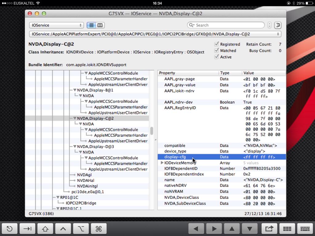

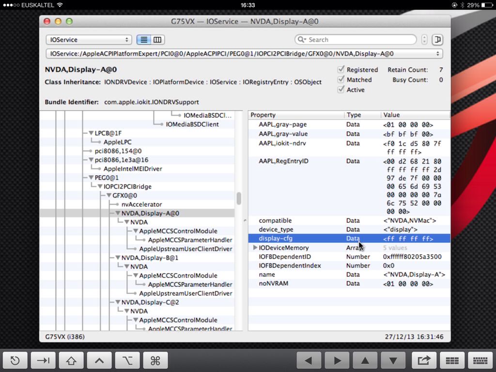

NiPeGun Posted December 28, 2013 Share Posted December 28, 2013 Guys, I have more information. It seems that some Macbooks Air has their displays connected trough displayport but uses a customized configuration to make them start. We need URGENTLY help from someone who have access to one. The steps to follow are:1 - Start the MBA with an Ubuntu live Pendrive (or external USB CD drive) on it. Reach the desktop, start a terminal and run: sudo xrandr --verbose 2 - See if the connection is made through displayport. If you don´t know how to do it, pay attention to the code on the post #59 3 - If it is, run: sudo xrandr --verbose >> info.txt 4 - Take that file (sure is in home folder) and paste it here to analyze it. 5 - Start OSX, fire IOREGExplorer 2.1 and save a dump to a file. Then paste it here to let us start working with it. THING IMPORTANT TO NOTE: all the information in Display0 is extremely important (connector-type, display-cfg) etcCome on, we can do it! Link to comment https://www.insanelymac.com/forum/topic/293967-solved-asus-rog-laptops-with-kepler-cards-not-detecting-dp-2-connected-lcd-display/page/3/#findComment-1979569 Share on other sites More sharing options...

yisl04 Posted January 3, 2014 Share Posted January 3, 2014 At this point, only the help from Krazubu can solve this issue. I myself have no experience enough. At list for now... According your posts before, I installed Ubuntu on a mobile HDD and got some information. It's not the same as yours. Screen 0: minimum 8 x 8, current 1920 x 1080, maximum 16384 x 16384 VGA-0 disconnected (normal left inverted right x axis y axis) Identifier: 0x27d Timestamp: 23226 Subpixel: unknown Clones: CRTCs: 0 1 2 3 Transform: 1.000000 0.000000 0.000000 0.000000 1.000000 0.000000 0.000000 0.000000 1.000000 filter: SignalFormat: VGA supported: VGA ConnectorType: VGA ConnectorNumber: 1 (0x00000001) _ConnectorLocation: 1 (0x00000001) LVDS-0 connected 1920x1080+0+0 (0x27f) normal (normal left inverted right x axis y axis) 344mm x 194mm Identifier: 0x27e Timestamp: 23226 Subpixel: unknown Gamma: 1.0:1.0:1.0 Brightness: 1.0 Clones: CRTC: 0 CRTCs: 0 1 2 3 Transform: 1.000000 0.000000 0.000000 0.000000 1.000000 0.000000 0.000000 0.000000 1.000000 filter: EDID: 00ffffffffffff0030e4d90200000000 00140104902213780a15d59e59509826 0e505400000001010101010101010101 0101010101017e3680b070381f403020 350058c210000018542480b070381f40 3020350058c210000018000000fe004d 43364a4e813135365746310a00000000 000041319e0000000002010a20200030 SignalFormat: LVDS supported: LVDS ConnectorType: Panel ConnectorNumber: 0 (0x00000000) _ConnectorLocation: 0 (0x00000000) 1920x1080 (0x27f) 139.5MHz -HSync -VSync *current +preferred h: width 1920 start 1968 end 2000 total 2096 skew 0 clock 66.6KHz v: height 1080 start 1083 end 1088 total 1111 clock 59.9Hz 1920x1080 (0x280) 93.0MHz -HSync -VSync h: width 1920 start 1968 end 2000 total 2096 skew 0 clock 44.4KHz v: height 1080 start 1083 end 1088 total 1111 clock 39.9Hz DP-0 disconnected (normal left inverted right x axis y axis) Identifier: 0x281 Timestamp: 23226 Subpixel: unknown Clones: CRTCs: 0 1 2 3 Transform: 1.000000 0.000000 0.000000 0.000000 1.000000 0.000000 0.000000 0.000000 1.000000 filter: SignalFormat: TMDS supported: TMDS ConnectorType: DisplayPort ConnectorNumber: 3 (0x00000003) _ConnectorLocation: 3 (0x00000003) HDMI-0 disconnected (normal left inverted right x axis y axis) Identifier: 0x282 Timestamp: 23226 Subpixel: unknown Clones: CRTCs: 0 1 2 3 Transform: 1.000000 0.000000 0.000000 0.000000 1.000000 0.000000 0.000000 0.000000 1.000000 filter: SignalFormat: TMDS supported: TMDS ConnectorType: HDMI ConnectorNumber: 2 (0x00000002) _ConnectorLocation: 2 (0x00000002) DP-1 disconnected (normal left inverted right x axis y axis) Identifier: 0x283 Timestamp: 23226 Subpixel: unknown Clones: CRTCs: 0 1 2 3 Transform: 1.000000 0.000000 0.000000 0.000000 1.000000 0.000000 0.000000 0.000000 1.000000 filter: SignalFormat: DisplayPort supported: DisplayPort ConnectorType: DisplayPort ConnectorNumber: 3 (0x00000003) _ConnectorLocation: 3 (0x00000003) My laptop have 5 ports, one LVDS port for internal display, two DP ports (but I find only one miniDP), one VGA and one HDMI on the right side of my laptop. So I think my laptop is not totally same as yours. But I found OSX doesn't have graphics acceleration on Display-A (LVDS). Link to comment https://www.insanelymac.com/forum/topic/293967-solved-asus-rog-laptops-with-kepler-cards-not-detecting-dp-2-connected-lcd-display/page/3/#findComment-1981501 Share on other sites More sharing options...
