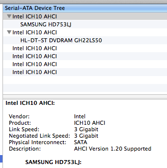

Gringo Vermelho Posted December 19, 2013 Share Posted December 19, 2013 I'm curious, are/were you using the "ESB2" DSDT patch for your ICH10? Link to comment Share on other sites More sharing options...

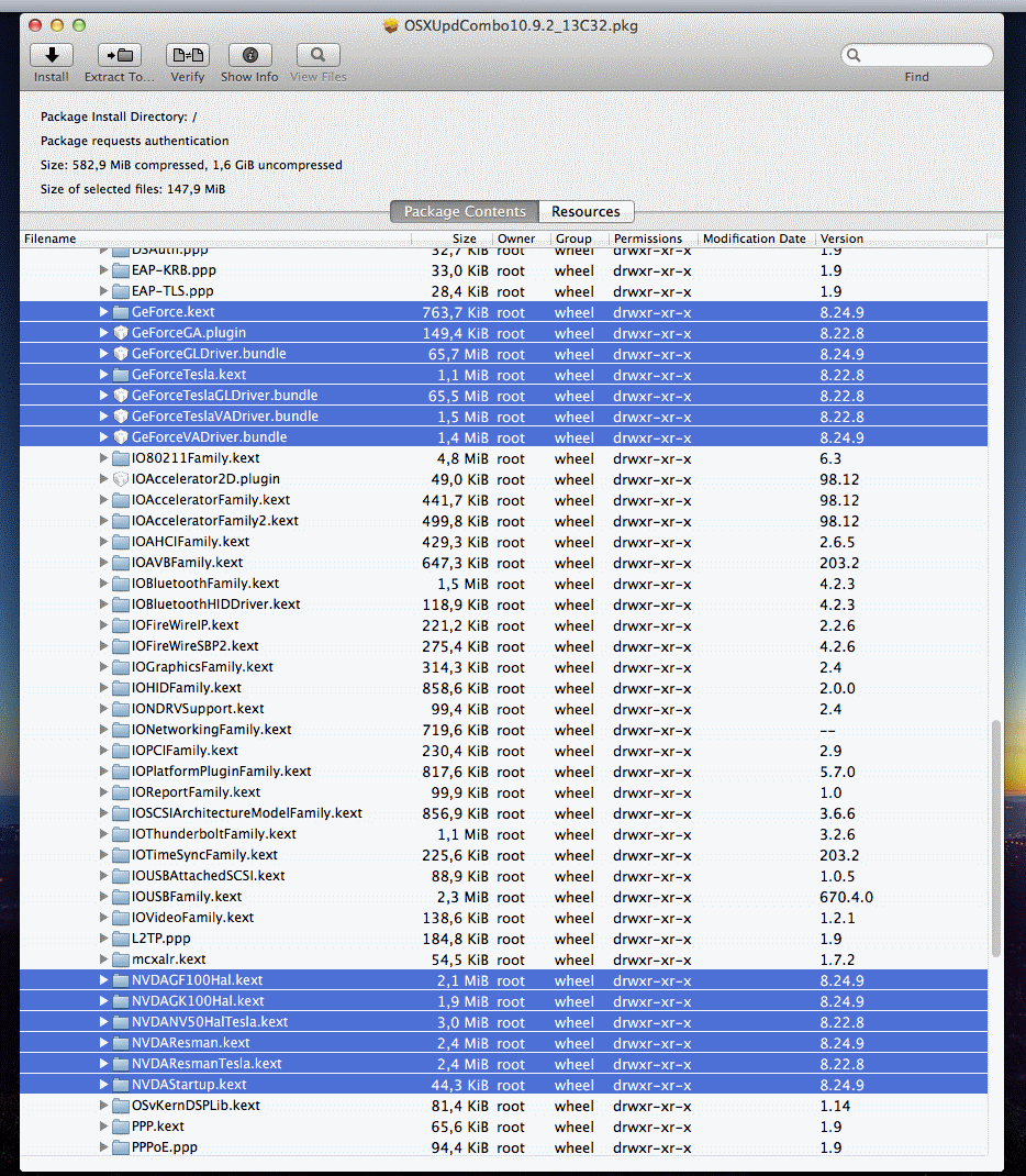

Bandes Posted December 25, 2013 Author Share Posted December 25, 2013 I'm curious, are/were you using the "ESB2" DSDT patch for your ICH10? I have that patch in my DSDT as i know. I will check now. Internal drives are silver icons, only my PATA drives are orange (those are loaded by the Jmicron driver). I had all drives in silver until Mountain Lion, but now with Mavericks only the SATA drives are silver. By the way. I have been testing the newest 10.9.2 beta update with new graphics drivers. Graphics still crashing ? YES I had two big freezes while i was downloading 5 gigs of stuff. I had to wait until there was no network traffic anymore and tried a shutdown through ssh. Restart did not work, but luckily no big damage happened to the hfs partition. Except the usual orphaned files and folders. The other crash happened while testing 10.9.2 beta. I also tested slower RAM settings (800Mhz instead of 1066Mhz). Still crashing. I am pretty sure it's faulty OpenGL drivers. Look at this video here : http://www.midwesternmac.com/blogs/jeff-geerling/glitchy-video-and-freezes I am having exactly the same symptoms. My UI crashes in the same fashion. And that video is about a real Macbook Pro with Nvidia 9400m/9600m gt graphics! Messages in console changed a bit now with the new graphic drivers: 2013-12-25 01:55:28,000 kernel[0]: IOVendorGLContext::ReportGPURestart 2013-12-25 01:55:28,000 kernel[0]: NVDA(OpenGL): Channel exception! exception type = 0xd = Graphics Engine Error (GR Error 5) Link to comment Share on other sites More sharing options...
Gringo Vermelho Posted December 25, 2013 Share Posted December 25, 2013 I have that patch in my DSDT as i know. I will check now. The ESB2 patch has been known to cause data loss and/or corruption on some hardware. It's possible that that's what was happening to you. Link to comment Share on other sites More sharing options...
Bandes Posted December 26, 2013 Author Share Posted December 26, 2013 The ESB2 patch has been known to cause data loss and/or corruption on some hardware. It's possible that that's what was happening to you. The only way i got corruption was when doing power cuts / resets. Other than that it looked ok. But it would be better if there would be no any corruption possible. So then, is it better to leave that out and have orange icons ? Now i will have to find my original DSDT setting somewhere. They said it had only "cosmetic" effects. Is there an alternative safe way to make the SATA drives look as normal (silver) ? I have checked it. I have the ESB2 Patch, since i see that kind of device at SATA: Haven't had the time to change it yet. I will generate a new DSDT and check what's the original setting for the SATA and edit back to my patched one. Link to comment Share on other sites More sharing options...
Bandes Posted December 29, 2013 Author Share Posted December 29, 2013 ESB2 Patch removed. All drives are orange now. Will test other SATA slots soon other than the currently used 1-2. Meanwhile i was testing graphics even more. Removed the Nvidia injection for my card as well from my DSDT. GraphicsEnabler works without that anyway smoothly. But crashing is still present sadly. No improvement. It must be a driver issue. Still had orphaned files with ICH10 SATA controller set up after the crashes, but no serious damage for a while luckily. It definitely doesn't look worse than it was. Link to comment Share on other sites More sharing options...
Gringo Vermelho Posted December 29, 2013 Share Posted December 29, 2013 Drives are orange because they are detected as external. You can use AHCIPortInjector.kext to get "Internal" silver icons. It works great, with the only caveat that you'll lose hotplugging. If you're using Chameleon, you can also try sata.dylib in /Extra/Modules. Don't use more than one fix for the same issue at the same time. Link to comment Share on other sites More sharing options...
