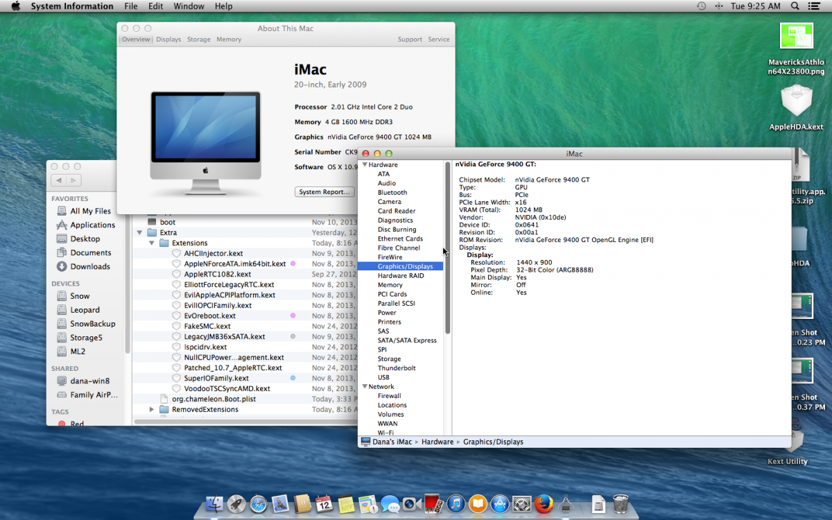

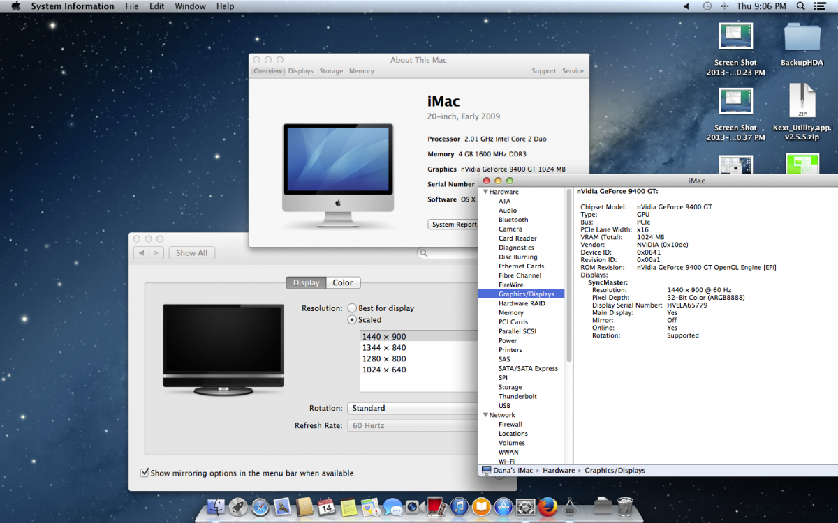

Dans1975 Posted November 15, 2013 Author Share Posted November 15, 2013 GOT IT.... Here's how... grab NVDAN50HAL.kext and open and edit it with your video card ID (see attached)...used kext info from Snow but patched Mavericks kext...(see the attached for NVidia 9400GT and similar) Removed -x , set GE=N Rebooted and voila ! Desktop and acceleration... This is Bronya's most recent BETA kernel. It's still got a few little glitches ... pink icons at times, a bit of instability in Safari (so using Firefox...works FINE) Now just to get sound going on this old Gateway BOX... ALSO TIME is SCREWED UP UNTIL YOU REFRESH...NOT SURE WHY.... NVIDIA.rtf Link to comment https://www.insanelymac.com/forum/topic/293814-boot-issues-mavericks-amd/#findComment-1968055 Share on other sites More sharing options...

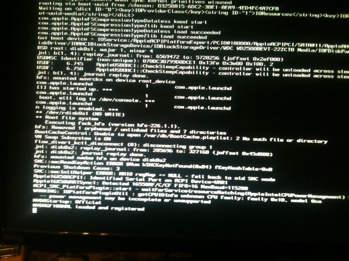

scrubsJA Posted December 7, 2013 Share Posted December 7, 2013 SOS!! I created a USB installer and used the latest kernel and essential kexts and AMD 10.9 boot CD and my installation would reboot after it seems like everything loaded in verbose mode like the other installations above. It is it because my system is too old? ASUS M3A76-CM AMD Athlon 7850 AM2+ Black Edition 2GB Corsair DDR2 NVIDIA GeForce 210 Atheros DW1525 WLAN PCIe Card WD 500 GB SATA Any suggestions would be appreciated. Thanks Link to comment https://www.insanelymac.com/forum/topic/293814-boot-issues-mavericks-amd/#findComment-1974156 Share on other sites More sharing options...
