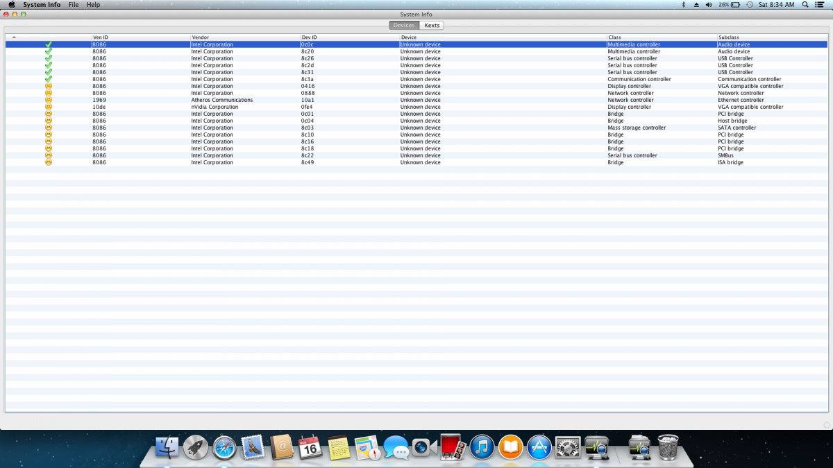

useletters Posted November 16, 2013 Author Share Posted November 16, 2013 Thanks! Anyway, I've managed to edit IOBluetoothFamily but it came no avail. I can click the button to turn off Bluetooth but it doesn't turn off.. I also can't export device/kext using SystemInfo app. Though I have attached a screenshot of it, kext tab is empty. The IOBluetoothFamily I used is also attached, my bluetooth's vendor ID is 0x8087 (32903) and product/device ID is 0x07DA (2010) I have not tried VooDooPS2 yet and not removed NullCpu...kext, I'll try to do it now. I'll report back. How do I check PM(Power Management) with SpeedSteep? EDIT: After installing VoodooPS2Controller.kext v1.8.8, using this How-to (https://github.com/RehabMan/OS-X-Voodoo-PS2-Controller/wiki/How-to-Install) and following what you've said, removed PS2Mouse kext inside of VoodooPS2, my touchpad doesn't work.. EDIT 2: I can boot without NullCpu...kext but I don't know how can I check PM with SpeedStep.. IOBluetoothFamily.kext.zip Link to comment https://www.insanelymac.com/forum/topic/293622-laptop-lenovo-ideapad-y510p-109-mavericks/page/2/#findComment-1968451 Share on other sites More sharing options...

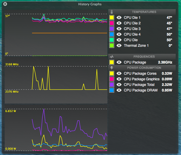

useletters Posted November 18, 2013 Author Share Posted November 18, 2013 How do I check if it's working? I've installed patched AICPM 10.8.5 and ACPI, removed NullCPU.. and I have ssdt_pr.aml (renamed to ssdt.aml) on my Extra folder, generated by ssdtPRGen.command. EDIT: After reboot: DPCIManager returns P States: 24, 25, 26, 27, 28, 29, 30, 31, 32 Bluetooth still not working.. I think it can't be done. As my WiFI is combo with Bluetooth... Link to comment https://www.insanelymac.com/forum/topic/293622-laptop-lenovo-ideapad-y510p-109-mavericks/page/2/#findComment-1969246 Share on other sites More sharing options...
styrian Posted November 18, 2013 Share Posted November 18, 2013 P-States seem to be fine. Get HW-sensors and install it. During doing benchmarks like Cinebench look at HW monitor, if there are more then two steps for cpu, especially, if your cpu can get to the turbo states. During OpenGL test P-states should also change, between low and low turbo during preparation of test. To get the states perfect working last some time. It´s a bit the same as with a brand new car. They must be retracted. Bluetooth: I know, that it should be the usual Lenovo Intel Wifi with Broadcom Bluetooth. This Bluetooth could be made working. You should have a look, if Bluetooth is activated in Bios and set active in Win. You could also try out for your battery, AcpiBatteryManager.kext here from Downloads. It normally works without DSDT. Here you go for it: http://www.insanelymac.com/forum/files/file/92-acpibatterymanager/ Have fun. Link to comment https://www.insanelymac.com/forum/topic/293622-laptop-lenovo-ideapad-y510p-109-mavericks/page/2/#findComment-1969262 Share on other sites More sharing options...
useletters Posted November 18, 2013 Author Share Posted November 18, 2013 I have HWMonitor, I installed using M..Be... see attached. How can I check steps for CPU? I'll try bluetooth and battery later.. THANKS! Link to comment https://www.insanelymac.com/forum/topic/293622-laptop-lenovo-ideapad-y510p-109-mavericks/page/2/#findComment-1969278 Share on other sites More sharing options...
