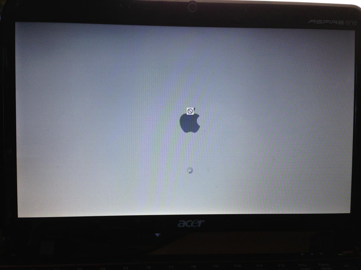

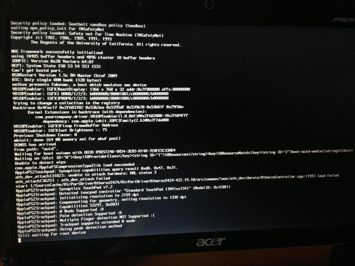

jaseww Posted August 27, 2013 Share Posted August 27, 2013 Hi, I am installing Snow Leopard 10.6.3 onto my Acer One 751h netbook. I have been following this guide. What I have had to do differently though is use the NBI 0.84 RC1 to get into the installer as otherwise by simply using the bootloader that got installed on there already by the netbookinstaller app, it gave me a kernal panic as soon as I tried booting it. The next thing I had to do was get the JMicron36xATA.kext and inject it into the extensions.mkext on the Install DVD (on usb stick), by following this guide. This was so that it could see my IDE internal HDD. It installed no problem, it even came up with that the installation was successful rather than what a lot have often had "installation failed" (although it has installed), but when I start it up (obviously going through the NBI on the USB, when I click enter normally it will come up with the apple logo and the loading wheel, and then a symbol will appear on the logo (image below) So I boot into Verbose mode so I can see where it stops (image below in link) http://imageshack.us/a/img198/4083/mo50.jpg So I searched "still waiting for boot device" and came across this tutorial but I try following it by entering what is quoted below, cp -pr /Volumes/Mac OS X Install DVD/System/Library/Extensions/*ATA* /Volumes/Macintosh HD/System/Library/Extensions/. but I have this (quoted below) appear which obviously is showing that it didn't do anything. usage: cp [-R [-H |-L | -P]] [-apvX] source_file target_file cp [-R [-H |-L | -P]] [-apvX] source_file ... target_directory I am enjoying myself doing this, and thats mainly what I use my netbook for, to mess around with it lol and I am pleased that I have managed to get really far without asking for help, but I do need a bit of help now lol Thanks for the help and if you need to specs of my netbook, they are here.... The only thing that is different is that I have 2GB ram in instead of the 1gb that came with it previously. Quote Link to comment https://www.insanelymac.com/forum/topic/291491-1063-on-an-acer-one-751h-netbook-still-waiting-for-boot-device-ide-hdd/ Share on other sites More sharing options...

jaseww Posted August 28, 2013 Author Share Posted August 28, 2013 Right I figured out why it was not doing it. What I was doing by wrongly was writing "/Mac OS X Install DVD/" and "/Mactintosh HD/" not like this "/Mac\ OS\ X\ Install\ DVD/" and "/Macintosh\ HD/". Putting the "\" before the space makes tells the terminal there is a space there, so if you o not do that, then it will be wrong. So all together I done cp -pr /Volumes/Mac\ OS\ X\ Install\ DVD/System/Library/Extensions/ /Volumes/Macintosh\ HD/System/Library/Extensions/. I removed the *ATA* because I wanted to copy the whole extensions folder. So this tutorial is correct, just make sure you don't make the same error that I made with the spaces. But I have realised now it is the wi-fi card that is the problem http://imageshack.us/a/img19/7342/h8vb.jpg So is there any way to disable it? Quote Link to comment https://www.insanelymac.com/forum/topic/291491-1063-on-an-acer-one-751h-netbook-still-waiting-for-boot-device-ide-hdd/#findComment-1941882 Share on other sites More sharing options...
jaseww Posted August 28, 2013 Author Share Posted August 28, 2013 I've put the latest version of chameleon on another one of my usb sticks and I do -v -f flags and it now gets stuck here instead... http://imageshack.us/a/img405/885/kzkg.jpg I done pciroot=0 as well but it still gets stuck there when I do pciroot=0, it gets stuck in the same place as before at the start [/sourceCache/AirPortDriverAtheros5424/AirPortDriverAtheros5424-422.19/src/common/lmac/ath_dev/darwin/AtherosController .cpp:111591 load failed Quote Link to comment https://www.insanelymac.com/forum/topic/291491-1063-on-an-acer-one-751h-netbook-still-waiting-for-boot-device-ide-hdd/#findComment-1941894 Share on other sites More sharing options...
theconnactic Posted August 30, 2013 Share Posted August 30, 2013 It's your graphics. Try to remove all of the graphics-related kexts from System/Library/Extensions and you'll manage to get to the Desktop. All the best! Quote Link to comment https://www.insanelymac.com/forum/topic/291491-1063-on-an-acer-one-751h-netbook-still-waiting-for-boot-device-ide-hdd/#findComment-1942324 Share on other sites More sharing options...

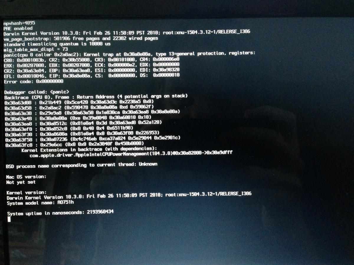

jaseww Posted September 7, 2013 Author Share Posted September 7, 2013 Well I've reinstalled, and I realised now that what I done before in the terminal on the install DVD, that mucked it up, so I've got the extensions folder now like should do. I've got the kernel on so that that works, (took a long time to get the permissions corrected in Linux so could put in the kernel), and I deleted the intelgma950.kext, and I got this come up when I tried booting again Sorry, here's the pic Quote Link to comment https://www.insanelymac.com/forum/topic/291491-1063-on-an-acer-one-751h-netbook-still-waiting-for-boot-device-ide-hdd/#findComment-1943952 Share on other sites More sharing options...
jaseww Posted September 7, 2013 Author Share Posted September 7, 2013 Ok ignore the above image, as that was my error, as I accidentally added ".old" to legacy_kernel instead of mach_kernel, and I forgot to do... <key>Kernel</key> <string> —> legacy_kernel <— </string> <key>Kernel Flags</key> <string> —> arch=i386 <— </string> But now I get this again. Ok I tried again, and this time it's back at the atheroscontrollwe.cpp11591 load failed So I think it's certainly the wi-go that's causing this and I did what the last post on this thread said to do... http://www.insanelymac.com/forum/topic/274966-atheroscontrollercpp962-load-failed-after-combo-upgrade-no-wi-fi-hardware-found/ but no difference Quote Link to comment https://www.insanelymac.com/forum/topic/291491-1063-on-an-acer-one-751h-netbook-still-waiting-for-boot-device-ide-hdd/#findComment-1943968 Share on other sites More sharing options...
