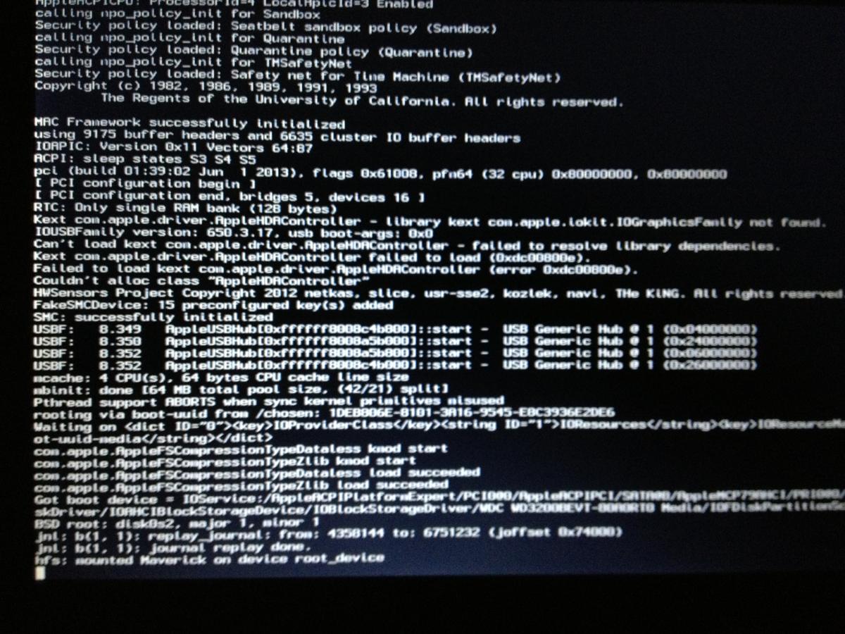

theconnactic Posted June 22, 2013 Author Share Posted June 22, 2013 Still trying, no luck! Stops at the same place no matter what i do. Seems to confirm the kernel patcher needs a refresh for Mavericks, but i'm starting to wonder, given the recent information, it could be also some protection in the kernel, akin to the new code signature rules for Mavericks' kexts. Investigating further... All the best! Link to comment https://www.insanelymac.com/forum/topic/289080-thoughts-about-mavericks-with-atom-yes-atom/#findComment-1926647 Share on other sites More sharing options...

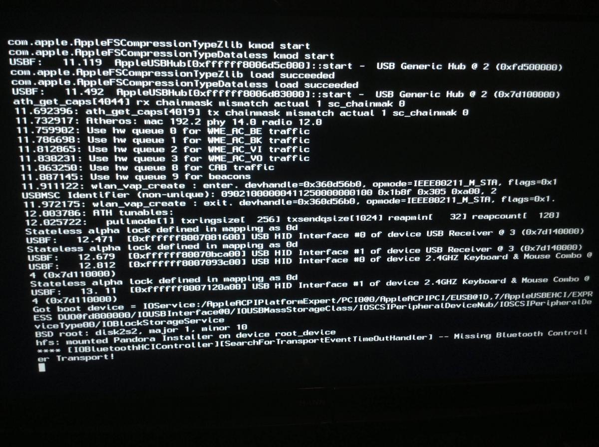

splonk Posted June 26, 2013 Share Posted June 26, 2013 I had a try with the latest Pandora on the Mavericks installer dmg rather than copying an existing installation. Mine is a Zotac with ION2. It got past DSMOS and stopped just after failing to initialise bluetooth, which mine doesn't have (probably because I picked a Mac Mini smbios.plist), so roughly just about where you got to on yours. 1 Link to comment https://www.insanelymac.com/forum/topic/289080-thoughts-about-mavericks-with-atom-yes-atom/#findComment-1928006 Share on other sites More sharing options...
theconnactic Posted June 30, 2013 Author Share Posted June 30, 2013 No, splonk, you got way farther - here it stops right before launchd. Did you use the kernel patcher module of Chameleon? Or installed as is using the vanilla kernel? I'm really curious. If the kernel patcher module got you that far, that means ION 2 systems have some features original ION lacks, making the boot process hang for the latter. Perhaps it's the sse4.2 instructions, which the N330 surely doesn't support? I think you are very very close to get your system up and running: if the boot is hanging at bluetooth, after DSMOS, the issue has nothing really to do with bluetooth, but everything to do with graphics. Try to use GraphicsEnabler=No, then Yes if No doesn't work, and as a last ditch attempt try to boot after deleting all graphics-related kexts. All the best! P.S.: to all: does anyone know if the XNU sources for any DP Mavericks is already out? All the best! Link to comment https://www.insanelymac.com/forum/topic/289080-thoughts-about-mavericks-with-atom-yes-atom/#findComment-1929160 Share on other sites More sharing options...
splonk Posted June 30, 2013 Share Posted June 30, 2013 It runs the patched Atom kernel - patched-2422.1.4.1.8~1/RELEASE_X86/64 Pandora incorporates Chameleon so it examines and patches on the fly as necessary. Need to run with an npci flag or it gets stuck on PCI Configuration. My cpu is a D510. Original plist did not have GE. Once enabled, it detected the ION2 and loaded all relevant kexts without complaint but still hung at the same point. Tried deleting the ATI and NV kexts with GE off, still no go. Unfortunately, no logs are created on the installer so I cannot see exactly what is causing the problem. The only thing I can see is that AppleHDAController does not get loaded, otherwise all ok. HFS mounts the selected root device and then hangs. Before deleting the gpu kexts it would try to initialise bluetooth and then hang. 1 Link to comment https://www.insanelymac.com/forum/topic/289080-thoughts-about-mavericks-with-atom-yes-atom/#findComment-1929236 Share on other sites More sharing options...
theconnactic Posted July 2, 2013 Author Share Posted July 2, 2013 Could you please post a pic of where it hangs? Thank you! Link to comment https://www.insanelymac.com/forum/topic/289080-thoughts-about-mavericks-with-atom-yes-atom/#findComment-1929654 Share on other sites More sharing options...
splonk Posted July 6, 2013 Share Posted July 6, 2013 Screenshot as requested 1 Link to comment https://www.insanelymac.com/forum/topic/289080-thoughts-about-mavericks-with-atom-yes-atom/#findComment-1930606 Share on other sites More sharing options...
Onixs Posted July 6, 2013 Share Posted July 6, 2013 Im thinking it is Kernel or loginwindow issue. 1 Link to comment https://www.insanelymac.com/forum/topic/289080-thoughts-about-mavericks-with-atom-yes-atom/#findComment-1930627 Share on other sites More sharing options...
theconnactic Posted August 15, 2013 Author Share Posted August 15, 2013 Screenshot as requested No, it crashes exactly at the same point as with my netbook: it's either a kernel patcher module failure - it was made for Mountain Lion, so it was kind of expected - or a codesign issue because we tampered with the kernel. Without sources, there's no way to know, but i tried something, as will post later. Im thinking it is Kernel or loginwindow issue. Kernel, yes: loginwindow, hardly. Today i tried to boot again with the kernel patcher module and DP5, but this time i tried a method that enable AMD users to boot Mavericks up to single user access (-s): replaced the DP5 dylibs by the ones from 10.8.4. It indeed went further, but not to the point i had single user access, so we're still at square one. All the best! Link to comment https://www.insanelymac.com/forum/topic/289080-thoughts-about-mavericks-with-atom-yes-atom/#findComment-1938926 Share on other sites More sharing options...
