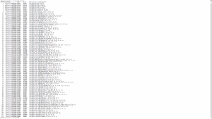

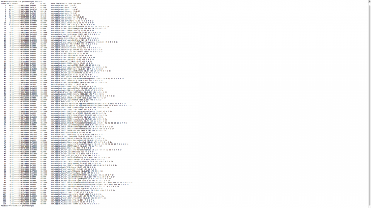

Installed as ML way... All is good but can't make my RT2870Wireless working.
I saw it in devices list...but don;t works. I try to put kext from my current ML system. same thing.
It is a tip to make it runs again?
wifi adapter is connected to a USB port as it is in ML. Trying to connect it in all my USB ports. same stuff.
My system configuration: Gigabyte Z77-DS3H , 12 GB 1600 .....
Thanks in advance.

I made 2 screenshots from ML and Mavericks with the "trouble".
http://imageshack.us/a/img35/3913/maverickswifiinfo.png
http://imageshack.us/a/img545/8367/mlwifi.png
Can't find what is wrong with that "configuration"
Thanks again
