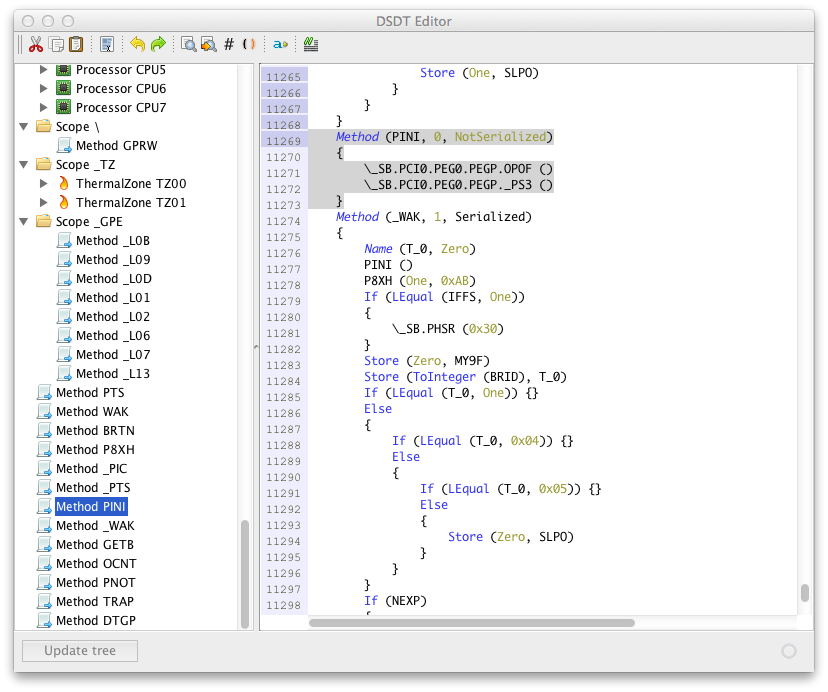

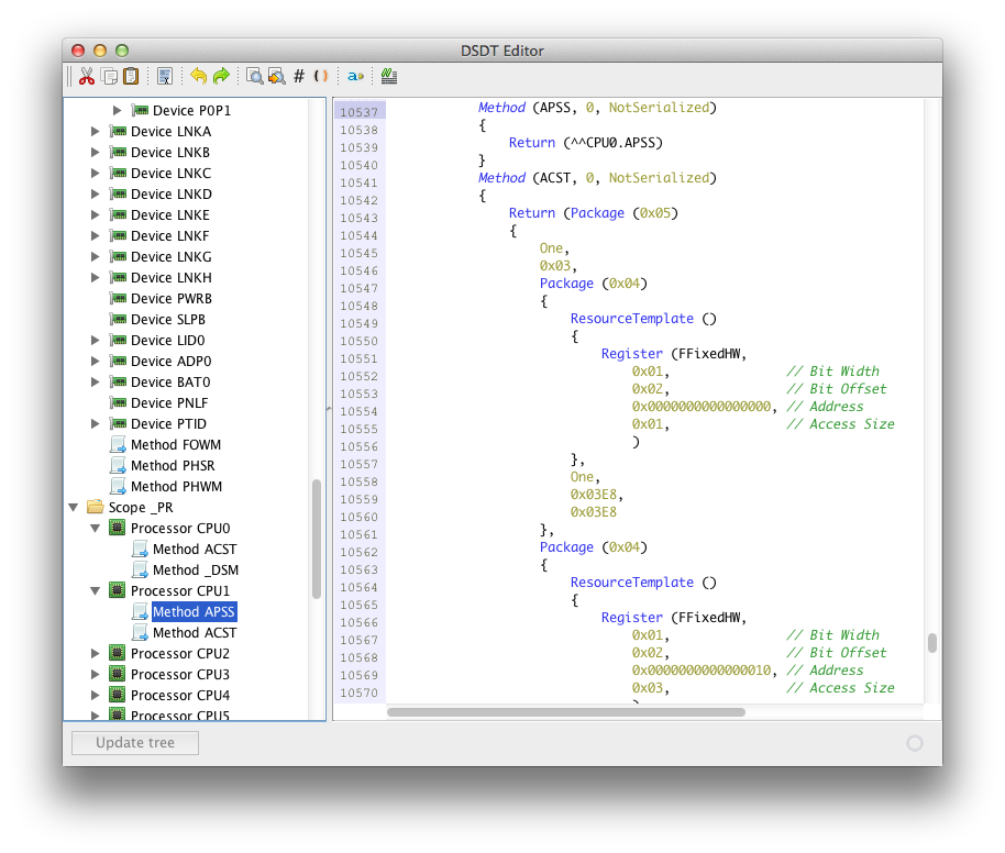

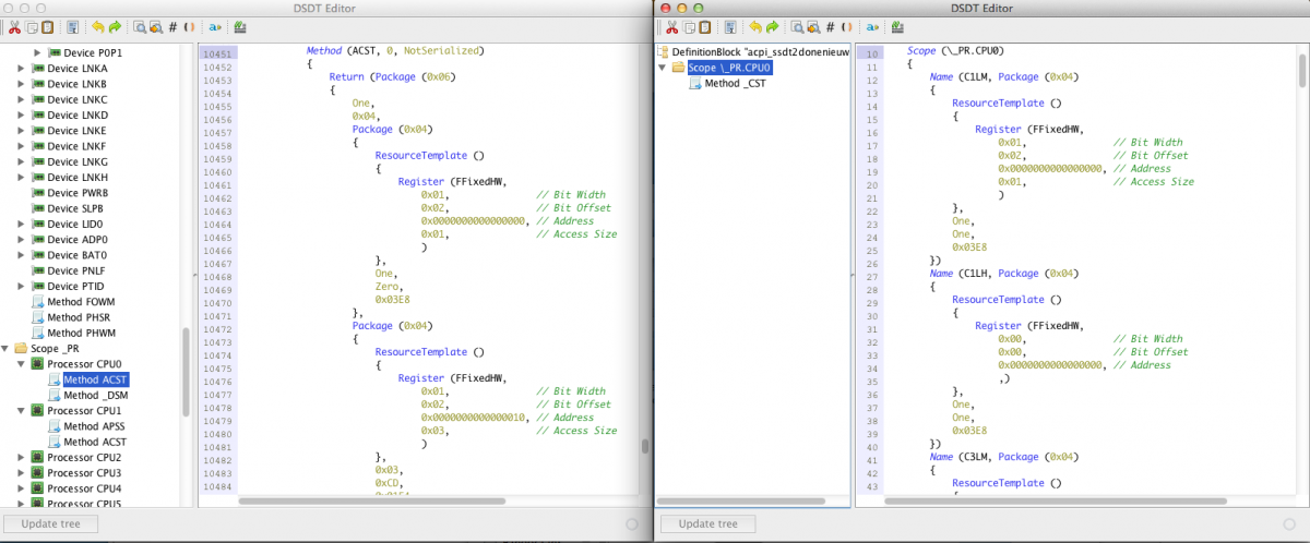

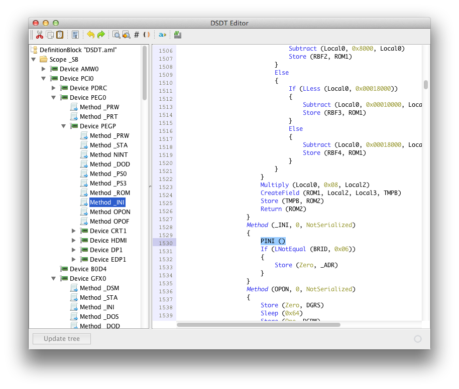

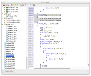

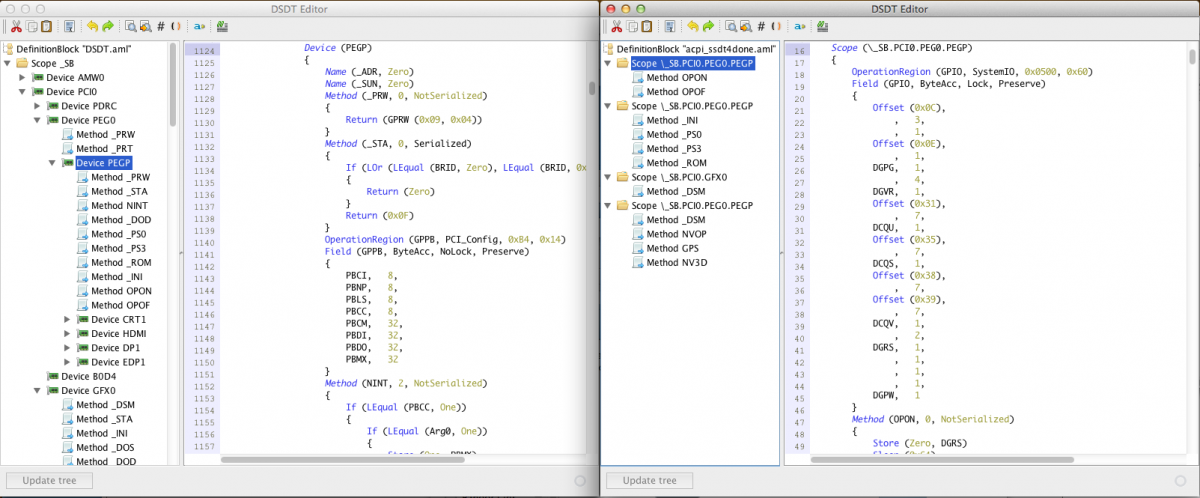

WaldMeister Posted February 28, 2013 Author Share Posted February 28, 2013 Attached a few screenshots, it shows on the right the SSDT with the info, on the left where to add it. Well, just also noticed, i forgot to add PSS to CPU0, have to look in to that again To disable the GPU, you will also need to add the following: Method (PINI, 0, NotSerialized) { \_SB.PCI0.PEG0.PEGP.OPOF () \_SB.PCI0.PEG0.PEGP._PS3 () } Goes above Method _WAK Add the function to Method _INI under Device PEGP, and under Method _WAK as shown on the screen: Method (_INI, 0, NotSerialized) { PINI () If (LNotEqual (BRID, 0x06)) { Store (Zero, _ADR) } } Hope this helps. I'm moving this weekend, so short on time will make a detailed guide after that. Link to comment https://www.insanelymac.com/forum/topic/286552-guidedell-inspirion-17r-se-7720-installation-guide/page/2/#findComment-1892858 Share on other sites More sharing options...

WaldMeister Posted February 28, 2013 Author Share Posted February 28, 2013 I don't know anything about AMD sorry. Yes, the battery life doubles, and the system will run a lot cooler. Link to comment https://www.insanelymac.com/forum/topic/286552-guidedell-inspirion-17r-se-7720-installation-guide/page/2/#findComment-1892876 Share on other sites More sharing options...
