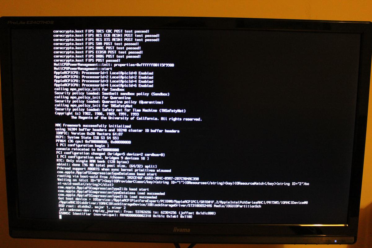

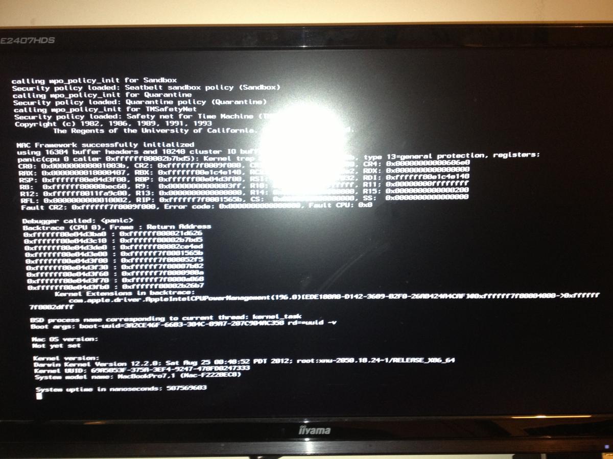

ChrisHRWilliams Posted February 20, 2013 Share Posted February 20, 2013 Hi there, hope you can help me with this one. I followed the instructions which are perfectly written and managed to install OSX ML. So far so good. Great I thought, here we go but when I try to boot into the hard drive I get what I believe is a kernel panic. I used the -v option and then took a screen shot with my iphone which I attach here (sorry about the flash, this was the best of 10 I took with & without flash) My system is ASUS P8H61-M LX2 Motherboard Intel i5 Processor ASUS NVidia Geforce GT630 Graphics 8GB RAM Seagate Barracuda 1TB hard drive Please can you help. I have tried everything I can based on the help files on the forum but nothing seems to work. I wonder if it is to do with my MB Bios? Thanks to anyone out there willing to help out a newbie Chris Quote Link to comment https://www.insanelymac.com/forum/topic/286536-kernel-panic-i-think/ Share on other sites More sharing options...
artur_pt Posted February 20, 2013 Share Posted February 20, 2013 hello are u using a proper dsdt to have native cpu power management ? if not, u must use nullcpupowermanagement.kext good hack Quote Link to comment https://www.insanelymac.com/forum/topic/286536-kernel-panic-i-think/#findComment-1890799 Share on other sites More sharing options...

carbo178 Posted February 21, 2013 Share Posted February 21, 2013 Hi Chris, Put Nullcpupowermanagement.kext and FakeSMC.kext in /Extra/Extensions folder of Installation USB (if /Extensions folder does not exist, create it). Reboot with -v -f Quote Link to comment https://www.insanelymac.com/forum/topic/286536-kernel-panic-i-think/#findComment-1890846 Share on other sites More sharing options...
LatinMcG Posted February 21, 2013 Share Posted February 21, 2013 or get the MSR asus cpu power management patched bios (if available.. try biosrepo.wordpress) also u might need SSDT.aml generated with a script for your cpu. Quote Link to comment https://www.insanelymac.com/forum/topic/286536-kernel-panic-i-think/#findComment-1890857 Share on other sites More sharing options...
juanerson Posted February 21, 2013 Share Posted February 21, 2013 Hi Chris, Put Nullcpupowermanagement.kext and FakeSMC.kext in /Extra/Extensions folder of Installation USB (if /Extensions folder does not exist, create it). Reboot with -v -f Agree. Also add UseKernelCache=No DropSSDT=Yes GeneratePStates=Yes GenerateCStates=YesUntil you can patch the AICPUPM.kext (using AICPMPatch to write operations to MSR 0xE2). or get the MSR asus cpu power management patched bios (if available.. try biosrepo.wordpress) also u might need SSDT.aml generated with a script for your cpu. Absolutely Agree. See this post 481, 482, 485 and 487 for reference about the problem that affect many factory SSDT tables, and the fix by RevoGirl.Good Luck. Quote Link to comment https://www.insanelymac.com/forum/topic/286536-kernel-panic-i-think/#findComment-1890860 Share on other sites More sharing options...
xpamamadeus Posted February 21, 2013 Share Posted February 21, 2013 Hi there, hope you can help me with this one. I followed the instructions which are perfectly written and managed to install OSX ML. So far so good. Great I thought, here we go but when I try to boot into the hard drive I get what I believe is a kernel panic. I used the -v option and then took a screen shot with my iphone which I attach here (sorry about the flash, this was the best of 10 I took with & without flash) My system is ASUS P8H61-M LX2 Motherboard Intel i5 Processor ASUS NVidia Geforce GT630 Graphics 8GB RAM Seagate Barracuda 1TB hard drive Please can you help. I have tried everything I can based on the help files on the forum but nothing seems to work. I wonder if it is to do with my MB Bios? Thanks to anyone out there willing to help out a newbie Chris use this http://www.insanelymac.com/forum/topic/285444-pmpatch-uefi-patching-utility/ 1 Quote Link to comment https://www.insanelymac.com/forum/topic/286536-kernel-panic-i-think/#findComment-1890875 Share on other sites More sharing options...

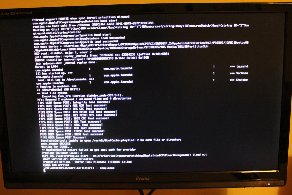

ChrisHRWilliams Posted February 22, 2013 Author Share Posted February 22, 2013 Hi all, Well I tried all of the above suggestions from LatinMcG and Carbo178 but without success. I still boot to a full grey screen (past the one with the Apple logo) and am left with a mouse pointer that then turns to the spinning rainbow. I used -v and post below the screen shots just before it hangs. Can anyone help to diagnose the problem? I am determined not to be defeated!! Thanks Chris Quote Link to comment https://www.insanelymac.com/forum/topic/286536-kernel-panic-i-think/#findComment-1891227 Share on other sites More sharing options...
Naxx Posted February 22, 2013 Share Posted February 22, 2013 I had a line like yours too, "ACPI_SMI_PlatrormPlugin etc. etc. timed out", I searched that in the HD, and just deleted it. Now I have no problems! Try it out! Sorry for my bad English! Quote Link to comment https://www.insanelymac.com/forum/topic/286536-kernel-panic-i-think/#findComment-1891243 Share on other sites More sharing options...
k3nny Posted February 22, 2013 Share Posted February 22, 2013 Are you sure you installed the FakeSMC extension? I don't see any verbose output of it in your photos. This is the base for Hackintoshes. Without it nothing will work. Also make sure you are not using KernelCache as already posted. If not, try the newest version from this branch: https://bitbucket.or...nsors/downloads (just the FakeSCM.kext for now). Quote Link to comment https://www.insanelymac.com/forum/topic/286536-kernel-panic-i-think/#findComment-1891263 Share on other sites More sharing options...
LatinMcG Posted February 23, 2013 Share Posted February 23, 2013 strange it says ACPI STATE [s0,S1,S2,S3,S4,S5] also u might need to roll back IOPlatformPlugin and the videocard is not using a profile .. what smbios u using..MacBookPro7,1 ? try Imac12,1 what does your /Extra folder look like?? u will need SSDT.aml made for that cpu/board. is bios patched MSR for Native power management ? doubt it. http://biosrepo.wordpress.com/asus/h61/ im glad i kept Lion and gave up on mountain. Quote Link to comment https://www.insanelymac.com/forum/topic/286536-kernel-panic-i-think/#findComment-1891426 Share on other sites More sharing options...
