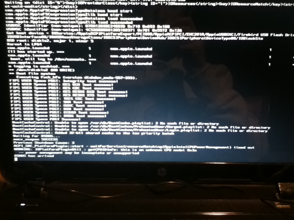

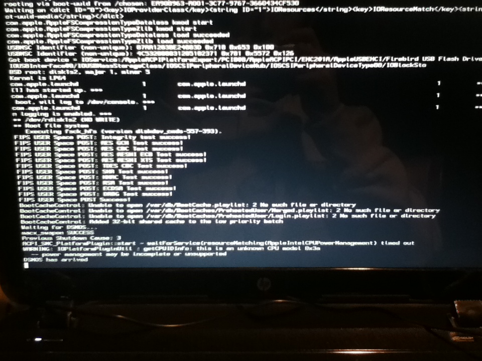

macos4pc Posted February 26, 2013 Author Share Posted February 26, 2013 Thanks Lejenk, i tried your tip and for booting i delete all NVIDIA kexts but i backup they. After DSMOS arrived the boot freeze. Is There someone who can help me?????????? Link to comment Share on other sites More sharing options...

macos4pc Posted February 27, 2013 Author Share Posted February 27, 2013 When i made the screenshots i boot with : -f -v GraphicsEnabler=No npci=0x2000 cpus=1 Link to comment Share on other sites More sharing options...

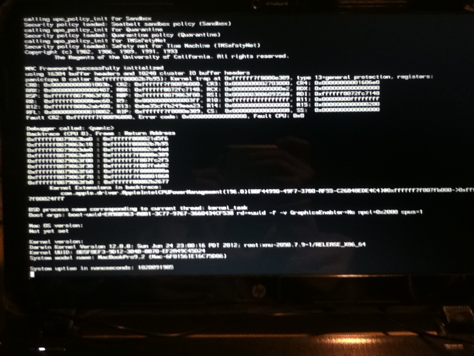

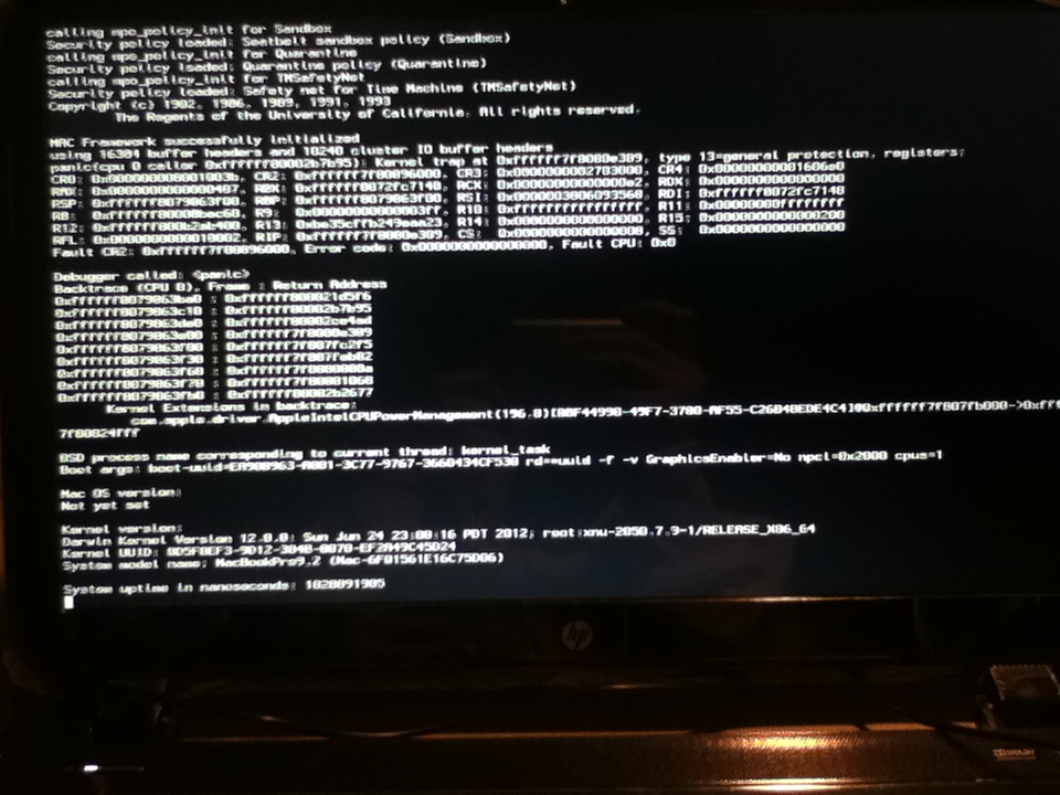

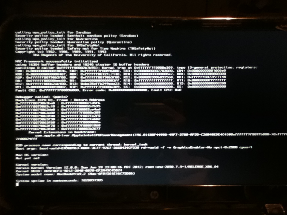

macos4pc Posted February 28, 2013 Author Share Posted February 28, 2013 I try to boot with: -x -v GraphicsEnabler=No npci=0x2000 cpus=1 Always freeze on DSMOS ARRIVE ! I wrote all in the last post. Is There someone can help me ???????????? Thanks Link to comment Share on other sites More sharing options...

macos4pc Posted February 28, 2013 Author Share Posted February 28, 2013 Thanks to jabirbin and Lejenk. I tried to wait 30 minut but nothing has changed. I tried the tip of Lejenk, but at reboot it stopped at DSMOS Arrived. i search for a IntelCPUPowerManagement.kext when i don't use Cpus=1 it gave me the System uptime in nanoseconds error. Thanks a lot to everyone. Link to comment Share on other sites More sharing options...

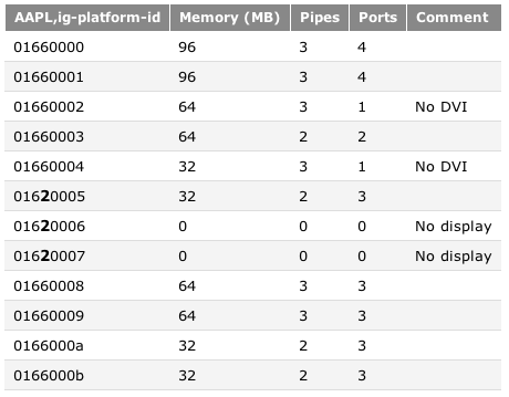

artur_pt Posted February 28, 2013 Share Posted February 28, 2013 hello u problem is intelhd 4000 remove the appleintel*capri and must find the right ig-platform-id for u note... ig-platform-id: 01660000, Stolen RAM for FB: 96MB, Pipes: 3, Ports: 4, FBMem: 3 Code: <key>device-properties</key> <string>7f0000000100000001000000730000000200000002010c00d041030a000000000101060000027fff04002c0000004100410050004c002c00690067002d0070006c006100740066006f0072006d002d006900640000000800000000006601140000006800640061002d0067006600780000000d0000006f6e626f6172642d31</string> ig-platform-id: 01660001, Stolen RAM for FB: 96MB, Pipes: 3, Ports: 4, FBMem: 3 Code: <key>device-properties</key> <string>7f0000000100000001000000730000000200000002010c00d041030a000000000101060000027fff04002c0000004100410050004c002c00690067002d0070006c006100740066006f0072006d002d006900640000000800000001006601140000006800640061002d0067006600780000000d0000006f6e626f6172642d31</string> ig-platform-id: 01660002, Stolen RAM for FB: 64MB, Pipes: 3, Ports: 1, FBMem: 1 Code: <key>device-properties</key> <string>7f0000000100000001000000730000000200000002010c00d041030a000000000101060000027fff04002c0000004100410050004c002c00690067002d0070006c006100740066006f0072006d002d006900640000000800000002006601140000006800640061002d0067006600780000000d0000006f6e626f6172642d31</string> ig-platform-id: 01660003, Stolen RAM for FB: 64MB, Pipes: 2, Ports: 2, FBMem: 2 Code: <key>device-properties</key> <string>7f0000000100000001000000730000000200000002010c00d041030a000000000101060000027fff04002c0000004100410050004c002c00690067002d0070006c006100740066006f0072006d002d006900640000000800000003006601140000006800640061002d0067006600780000000d0000006f6e626f6172642d31</string> ig-platform-id: 01660004, Stolen RAM for FB: 32MB, Pipes: 3, Ports: 1, FBMem: 1 Code: <key>device-properties</key> <string>7f0000000100000001000000730000000200000002010c00d041030a000000000101060000027fff04002c0000004100410050004c002c00690067002d0070006c006100740066006f0072006d002d006900640000000800000004006601140000006800640061002d0067006600780000000d0000006f6e626f6172642d31</string> ig-platform-id: 01660008, Stolen RAM for FB: 64MB, Pipes: 3, Ports: 3, FBMem: 3 Code: <key>device-properties</key> <string>7f0000000100000001000000730000000200000002010c00d041030a000000000101060000027fff04002c0000004100410050004c002c00690067002d0070006c006100740066006f0072006d002d006900640000000800000008006601140000006800640061002d0067006600780000000d0000006f6e626f6172642d31</string> ig-platform-id: 01660009, Stolen RAM for FB: 64MB, Pipes: 3, Ports: 3, FBMem: 3 Code: <key>device-properties</key> <string>7f0000000100000001000000730000000200000002010c00d041030a000000000101060000027fff04002c0000004100410050004c002c00690067002d0070006c006100740066006f0072006d002d006900640000000800000009006601140000006800640061002d0067006600780000000d0000006f6e626f6172642d31</string> ig-platform-id: 0166000A, Stolen RAM for FB: 32MB, Pipes: 2, Ports: 3, FBMem: 2 Code: <key>device-properties</key> <string>7f0000000100000001000000730000000200000002010c00d041030a000000000101060000027fff04002c0000004100410050004c002c00690067002d0070006c006100740066006f0072006d002d00690064000000080000000a006601140000006800640061002d0067006600780000000d0000006f6e626f6172642d31</string> ig-platform-id: 0166000B, Stolen RAM for FB: 32MB, Pipes: 2, Ports: 3, FBMem: 2 Code: <key>device-properties</key> <string>7f0000000100000001000000730000000200000002010c00d041030a000000000101060000027fff04002c0000004100410050004c002c00690067002d0070006c006100740066006f0072006d002d00690064000000080000000b006601140000006800640061002d0067006600780000000d0000006f6e626f6172642d31</string> u can inject that in boot in chameleon or by dsdt.. example into device name_adr 0x00020000 insert begin Method (_DSM, 4, NotSerialized)\n {\n Store (Package (0x02)\n {\n "AAPL,ig-platform-id",\n Buffer (0x04)\n {\n 0x03, 0x00, 0x66, 0x01\n }\n }, Local0)\n DTGP (Arg0, Arg1, Arg2, Arg3, RefOf (Local0))\n Return (Local0)\n } end good hack 2 Link to comment Share on other sites More sharing options...
macos4pc Posted February 28, 2013 Author Share Posted February 28, 2013 Thanks a lot arthur-pt!!! Sorry for my incompetence but i don't understand what have you post. Can you help me again? Jabirbin, i found a guide with a IntelCPUPowerManagement.kext for my i5 3317U. the guide is: http://www.insanelymac.com/forum/topic/283038-zenbook-prime-fixes-mods-tweaks-etc/ Is this the right kext? Link to comment Share on other sites More sharing options...
