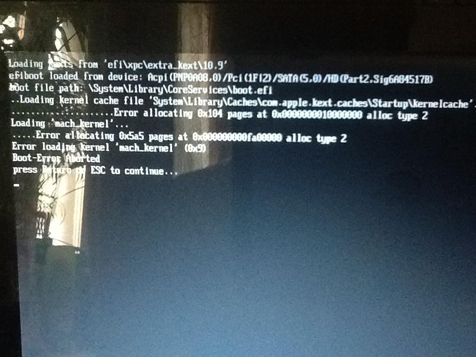

I could load Mavericks with XPC but only with slide=0
Without it I see this mistake

EDIT1
Now XPC booted my system without slide=0. Don't know where  did the error come from.

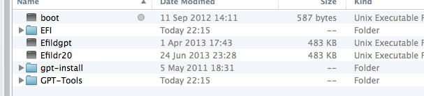

Hi everyone.
I attached boot file which allow to use XPC on MBR partision.
On other words the booting scheme is
boot->EfildR20->Mac OSX.
I checked it on USB Stick. But on Hard disk it should work as well.
We use MBR-sectors as well as Clover or Chameleon has for this case.
Our files should look so
Good hack!
boot.zip
