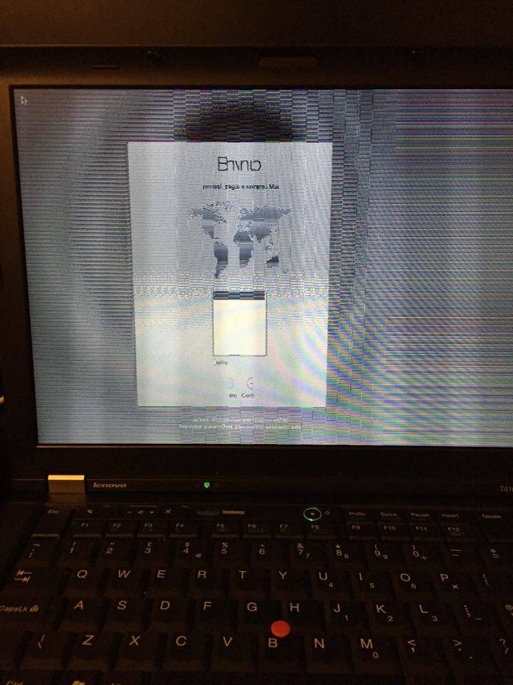

Hi! Thank you for your answers. I've installed the system! Now I'm trying to enable QE/CI. The problem is that the system it's starting up like in the picture with the normal single link lw1 frame buffer (The same kind that works with Mavericks). As bootloader I'm using Clover with Intel flag 0x0000000 and natit installed. With other flags the graphics won't start at all. :(

I would not inject intel in your case. Just enable Patch VBIOS and see if that works. Else try Patch vBIOS and Inject EDID.
