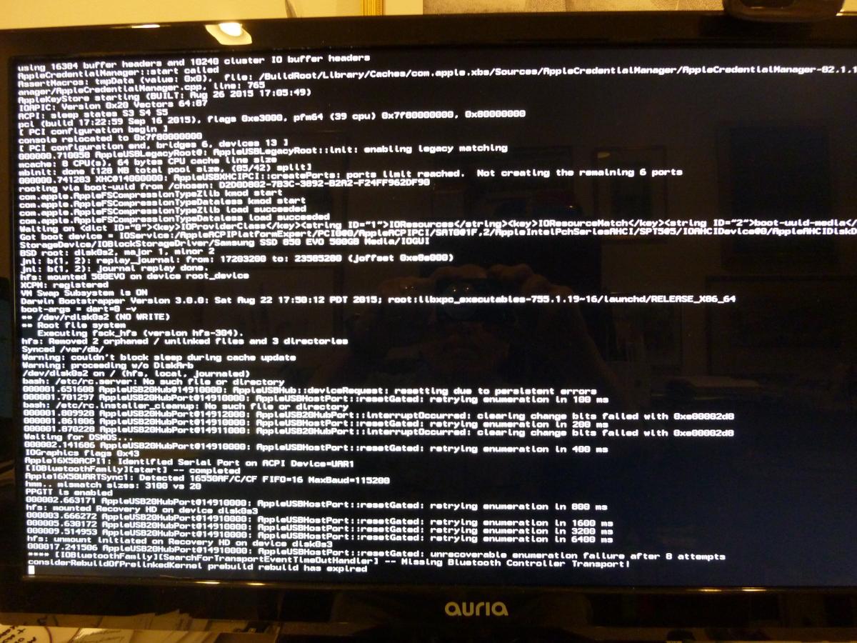

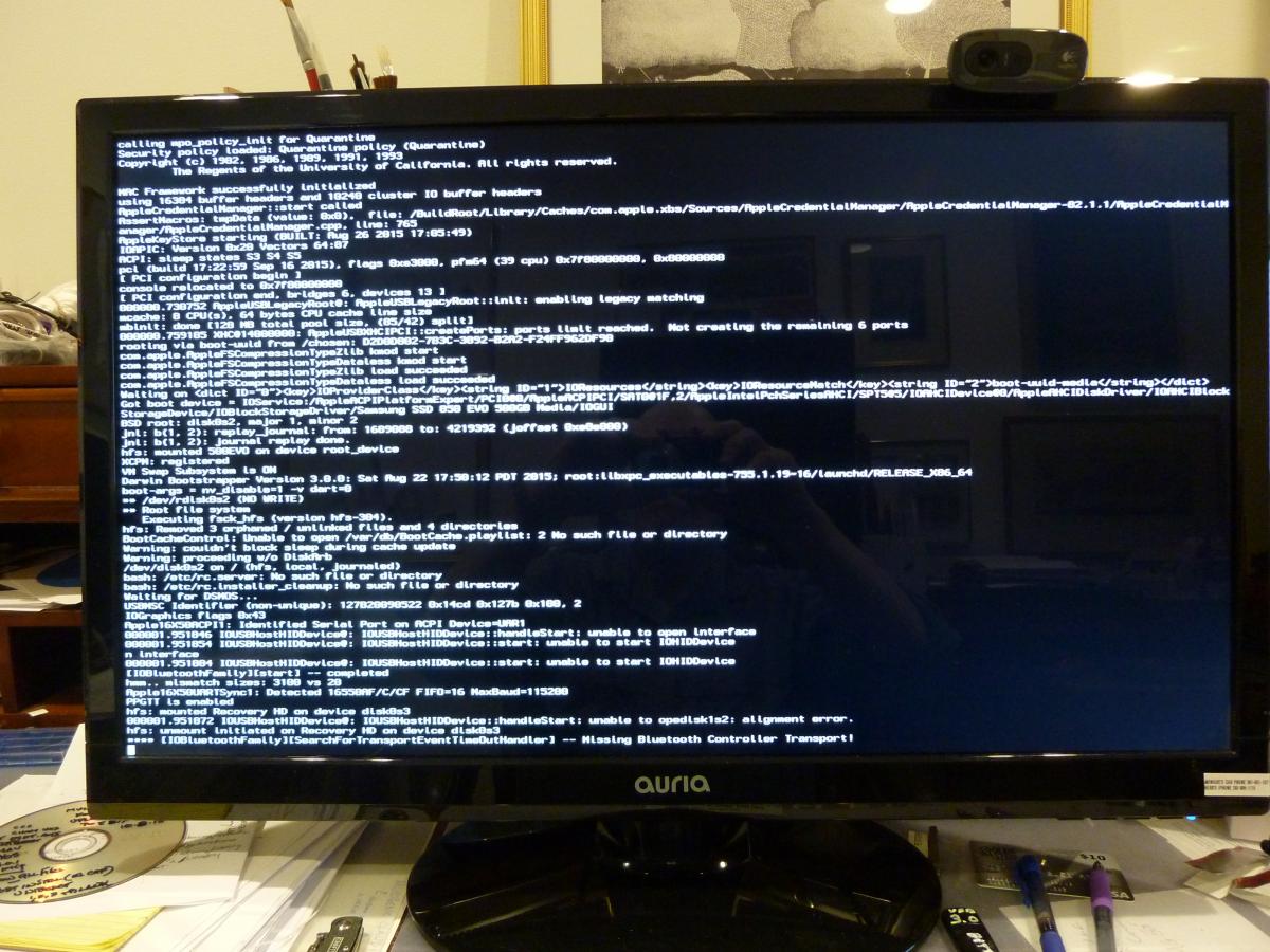

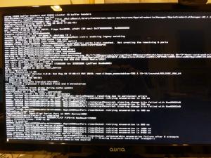

Well. I'm trying to install El Capitan on my laptop:
System: HP DV6-3180ES
CPU: Intel i5 460M
Graphics: ATI Mobility Raedon 5650 + Indel HD (Device ID 0046 and Vendor ID as 8086).
I've built my Bootable usb following the guide (I've removed the AppleIntelHDGraphicsFB.kext file). I'm not even able to star installation, my computer freeze here:
So I think problem is related with Graphics card...
Thanks in advice.
This is shown just before screen goes blurry:8L5f4mN.jpg
I've readed somewhere that this issue is related with Graphic Card. If it's not, any other idea?
Your installation had been prohibited. Has nothing to do with graphics. And you did not research well enough. Basically your USB is no longer detected, hence installation cannot start. Are you installing El Capitan? If so you have to do more work to get it working. Somehow you have to fix your USB ports before starting the installation.

I had the same problem. I solved it. Try to check patch intel in clover and try to use fake id 0x01660003
After booting into the system uncheck patch intel and delete fake id, install graphic drivers
