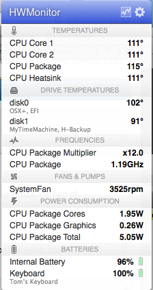

tluck Posted September 27, 2013 Share Posted September 27, 2013 ok. we have another break through of sorts. on top of the shutdown hang mixup, a further rewrite of the DSDT by TimeWalker75a has provided a way to eliminate the ACPIPlatform rollback - so we can have one less custom kext to deal with. Note: Rehabman updated and renamed AppleSmartBatteryManager to ACPIBatteryManager.kext so it does not conflict with the native one. anyway ... Huge thanks to Timewalker75a on helping making the T420 practically a perfect Hack! will repackage and post ASAP with new DSDT so hang on and wait if you have not upgraded to the bundle from yesterday. FakeSMC + Plugins VoodooPS2 ACPIBatteryManager $ kextstat |grep -v apple Index Refs Address Size Wired Name (Version) <Linked Against> 16 2 0xffffff7f8119f000 0x16000 0x16000 org.netkas.driver.FakeSMC (873) <9 7 5 4 3 1> 17 0 0xffffff7f811b5000 0x4000 0x4000 org.hwsensors.driver.CPUSensors (873) <16 7 5 4 3> 30 2 0xffffff7f80811000 0xe000 0xe000 org.rehabman.voodoo.driver.PS2Controller (1.8.8) <9 7 5 4 3 1> 32 0 0xffffff7f811bc000 0x6000 0x6000 org.hwsensors.driver.ACPISensors (873) <16 9 7 5 4 3> 35 0 0xffffff7f81d14000 0x6000 0x6000 org.rehabman.driver.AppleSmartBatteryManager (1.40) <9 4 3> 38 0 0xffffff7f80e72000 0x19000 0x19000 com.insanelymac.driver.AppleIntelE1000e (2.4.14) <37 10 5 4 3 1> 52 0 0xffffff7f80834000 0x5000 0x5000 org.rehabman.voodoo.driver.PS2Keyboard (1.8.8) <30 28 7 6 5 4 3 1> 53 0 0xffffff7f8081f000 0xb000 0xb000 org.rehabman.voodoo.driver.PS2Trackpad (1.8.8) <30 28 7 6 5 4 3 1> 1 Link to comment https://www.insanelymac.com/forum/topic/285678-lenovo-thinkpad-t420-with-uefi-only/page/18/#findComment-1949169 Share on other sites More sharing options...
