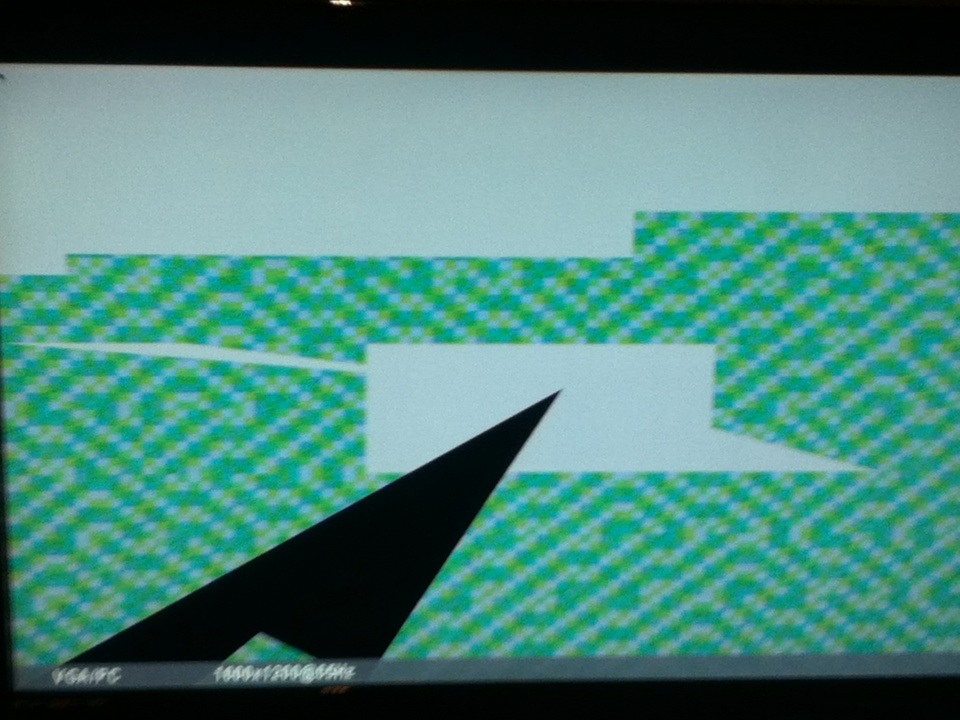

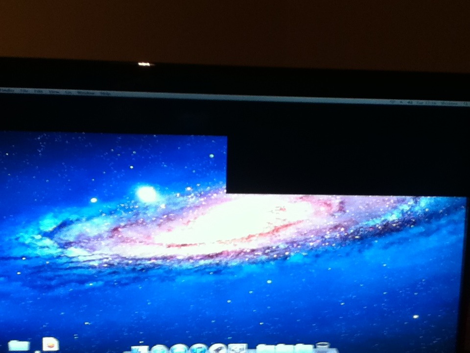

Shaneee Posted January 22, 2013 Share Posted January 22, 2013 I found one interested ! In picture you see "sse4_2" and work! But without ssse3 ! )))) Please try it is mach_kernel_10.7.4 ! If you need 32 bit , then flag "arch=i386" , -noavxbit or -nossse4bit or nossse3bit or without flags ) MACH_KERNEL_1074_amd_32_64 bit. Booting only with -v went straight to the desktop but still with graphics glitches. Booted using arch=i386 -force64 -v and everything works as it should apart from my sound for some reason. Many thanks Bronzovka Link to comment Share on other sites More sharing options...

Bronya Posted January 22, 2013 Share Posted January 22, 2013 Booting only with -v went straight to the desktop but still with graphics glitches. Booted using arch=i386 -force64 -v and everything works as it should apart from my sound for some reason. Many thanks Bronzovka flag -force64 no need ! ))) You can show picture with graphics glitches ? =) Link to comment Share on other sites More sharing options...

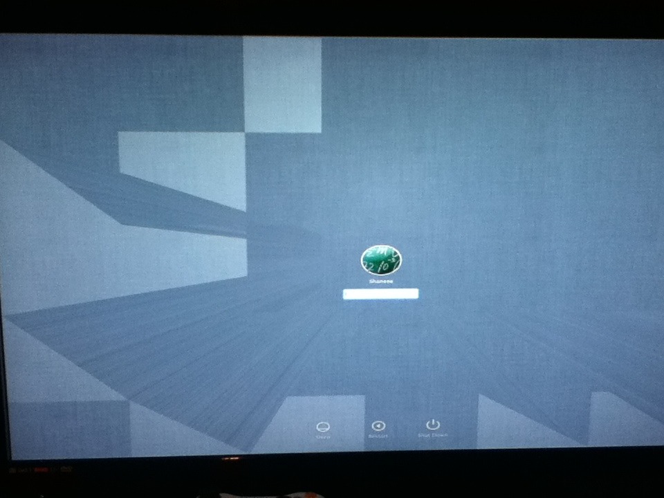

Shaneee Posted January 22, 2013 Share Posted January 22, 2013 flag -force64 no need ! ))) You can show picture with graphics glitches ? =) Here are the problems with the graphics, These are both the login screen and this happens a lot randomly on the desktop, Link to comment Share on other sites More sharing options...

Shaneee Posted January 22, 2013 Share Posted January 22, 2013 IiTz ShAnE, interested ! I understand . Thats it running x86_64 with your kernel. Does the same with the one I compelled swell. ML Just refuses to load the GUI. Link to comment Share on other sites More sharing options...
Bronya Posted January 22, 2013 Share Posted January 22, 2013 Ok . Then No recommended with flag arch=x86_64 ! Only arch=i386 , because in i386 work 32 and 64 bit binary ! I start original dvd 10.7.2 and working fine with my mach_kernel with flag i386 ! =) Link to comment Share on other sites More sharing options...

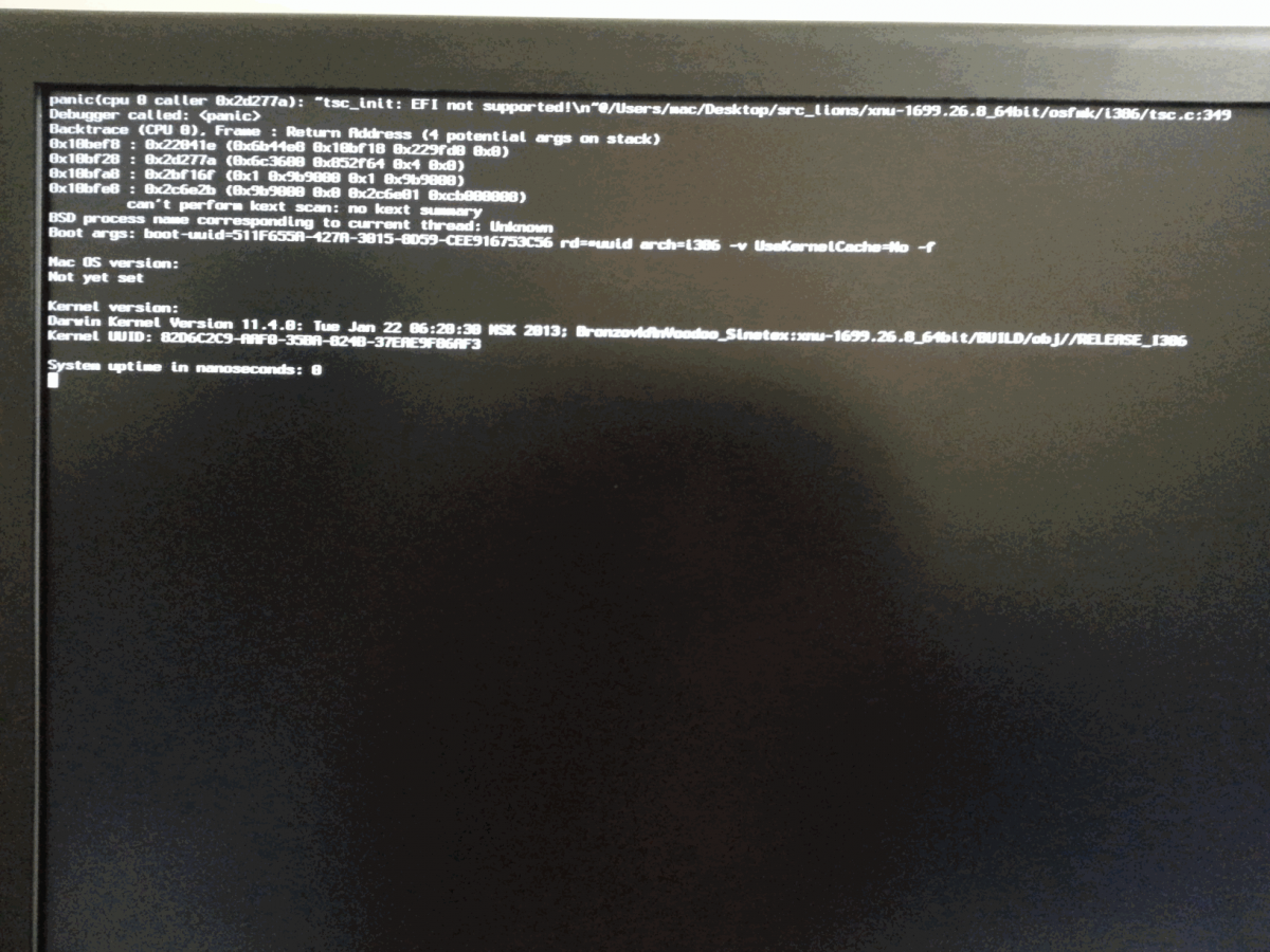

MadMungo Posted January 23, 2013 Share Posted January 23, 2013 I found one interested ! In picture you see "sse4_2" and work! But without ssse3 ! )))) Please try it is mach_kernel_10.7.4 ! If you need 32 bit , then flag "arch=i386" , -noavxbit or -nossse4bit or nossse3bit or without flags ) MACH_KERNEL_1074_amd_32_64 bit. Hi, Just tried your kernel on an FX 8350 CPU system and I get a TSC crash as in the picture. I have tried a combination of the following boot flags arch=i386 busratio=20 fsb=200 cpus=8 maxmem=4096 -force64 npci=0x2000 -v UseKernelCache=No/Yes and still get the same crash. Link to comment Share on other sites More sharing options...

Andy Vandijck Posted January 23, 2013 Share Posted January 23, 2013 Hi, Just tried your kernel on an FX 8350 CPU system and I get a TSC crash as in the picture. I have tried a combination of the following boot flags arch=i386 busratio=20 fsb=200 cpus=8 maxmem=4096 -force64 npci=0x2000 -v UseKernelCache=No/Yes and still get the same crash. Try changing busratio=20 to busratio=200 I believe that any value bigger than 10 is divided by 10 Link to comment Share on other sites More sharing options...
