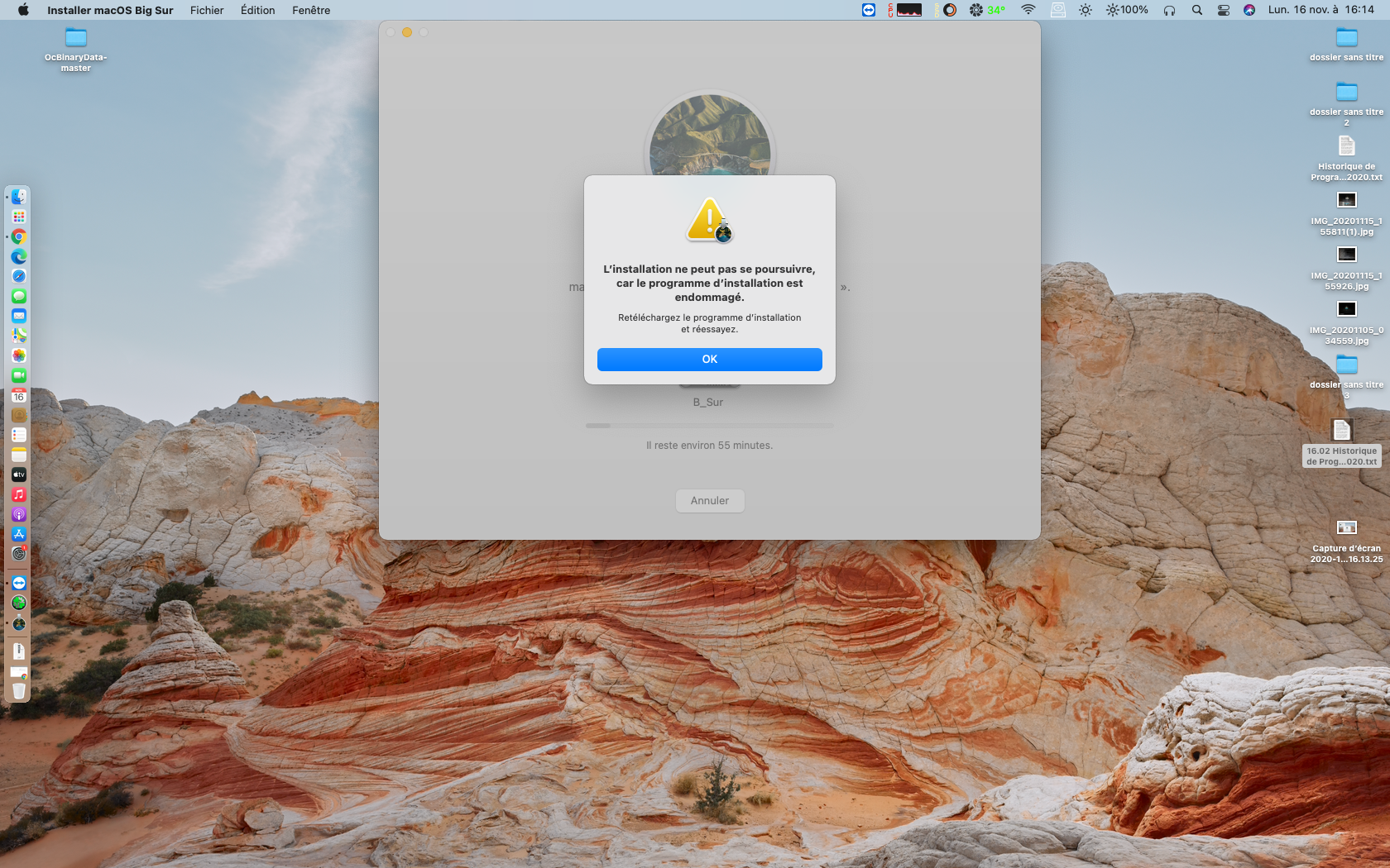

Hello good afternoon
I have a problem with two PCs to install BigSur autonomo by the pendrive on them! (I never had any problems with Catalina)
let's start here by the first
Lenovo Thinkcentre M93p
intel i5-4460s
intel HD4600 + Nvidia GTX760 3go
SSD x2
28Go RAM
Clover r5126
system at the moment
1 SSD 240Go = Windows 10 2004
1 SSD 480Go = MacOS Mojave - Catalina - BigSur 20B29 (installed on the SSD by another pc)
problem
I can enter the 1 installation phase and start BUT when it reaches 13 minutes it makes the print error posted here!
I also leave a report of the error in the install
Thanks
Google translate !
  Hide contents
IMG_20201105_034559.thumb.jpg.af401dd0977b9b97f894c4e3d0fd6a48.jpgIMG_20201115_155926.thumb.jpg.38dfcffd7f2734afd436cb4978e28003.jpgIMG_20201115_155811(1).thumb.jpg.6b9745ff8d7d3e6627837fb3ee3a06ac.jpg

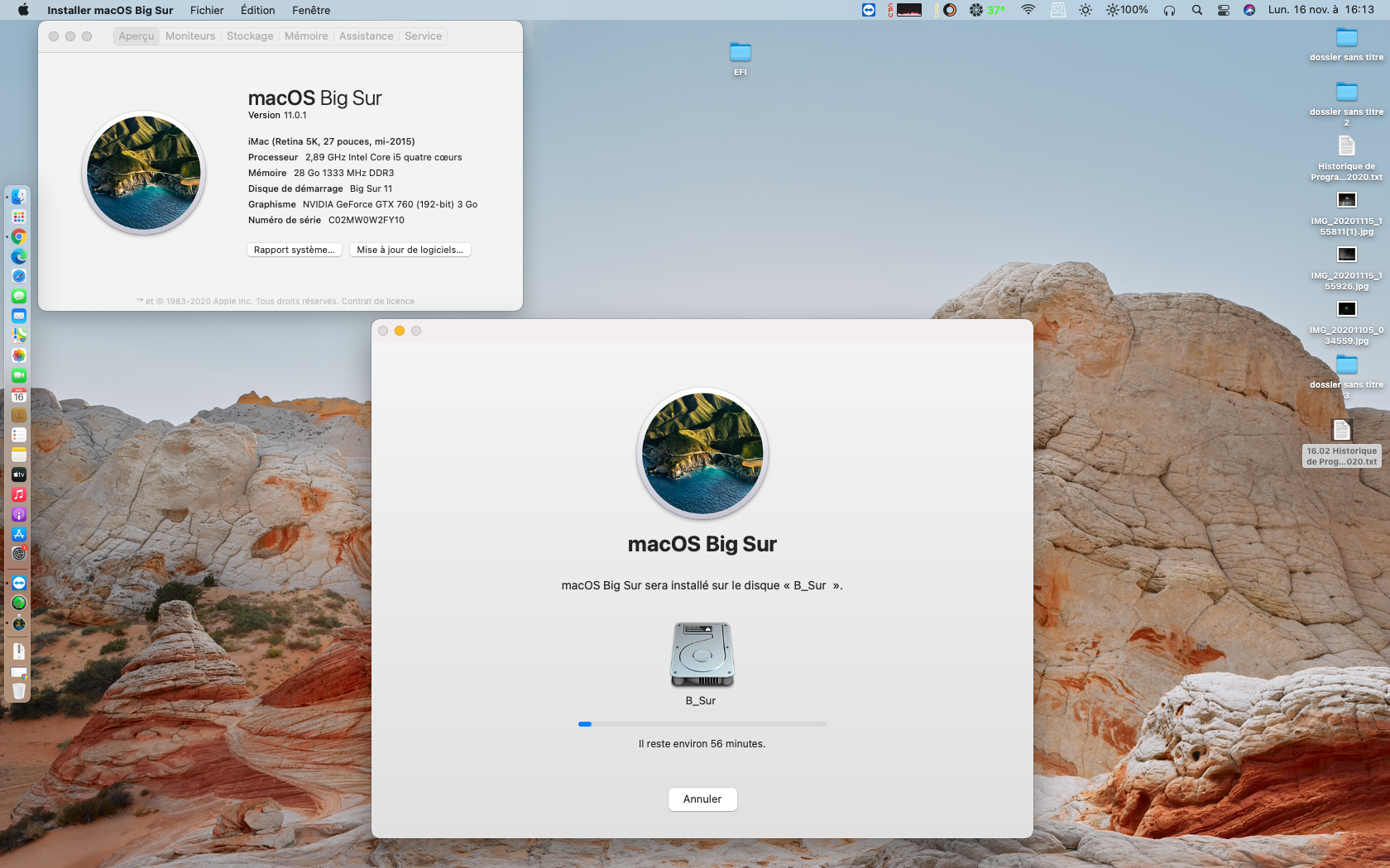

I launched another test but now in direct update from the system
the error returns equal
Spoiler
513554941_Capturedecran2020-11-16a16_13_25.thumb.png.aacdb7410b140fb89d0e9cebbd4cfb73.png478718643_Capturedecran2020-11-16a16_14_31.thumb.png.1bb070efd62656ba22a5591bcf7a94df.png
remember that if you install the system on another machine on the SSD, I can then use it on this machine without any problem
  • Sad 1
37 minutes ago, PG7 said:
Chris
tested the config and the EC
- the config had to pass the iMac15.1 think it was your mistake the iMac5,1
- the EC I already have in the DSDT in LPCB
the error remains the same in the same place!
16.02 Historique de Programme d’installation 16-Nov-2020.txt
Yes sorry iMac 15.1 :rolleyes: error remains the same :huh: another big mystery of Big Sur 11

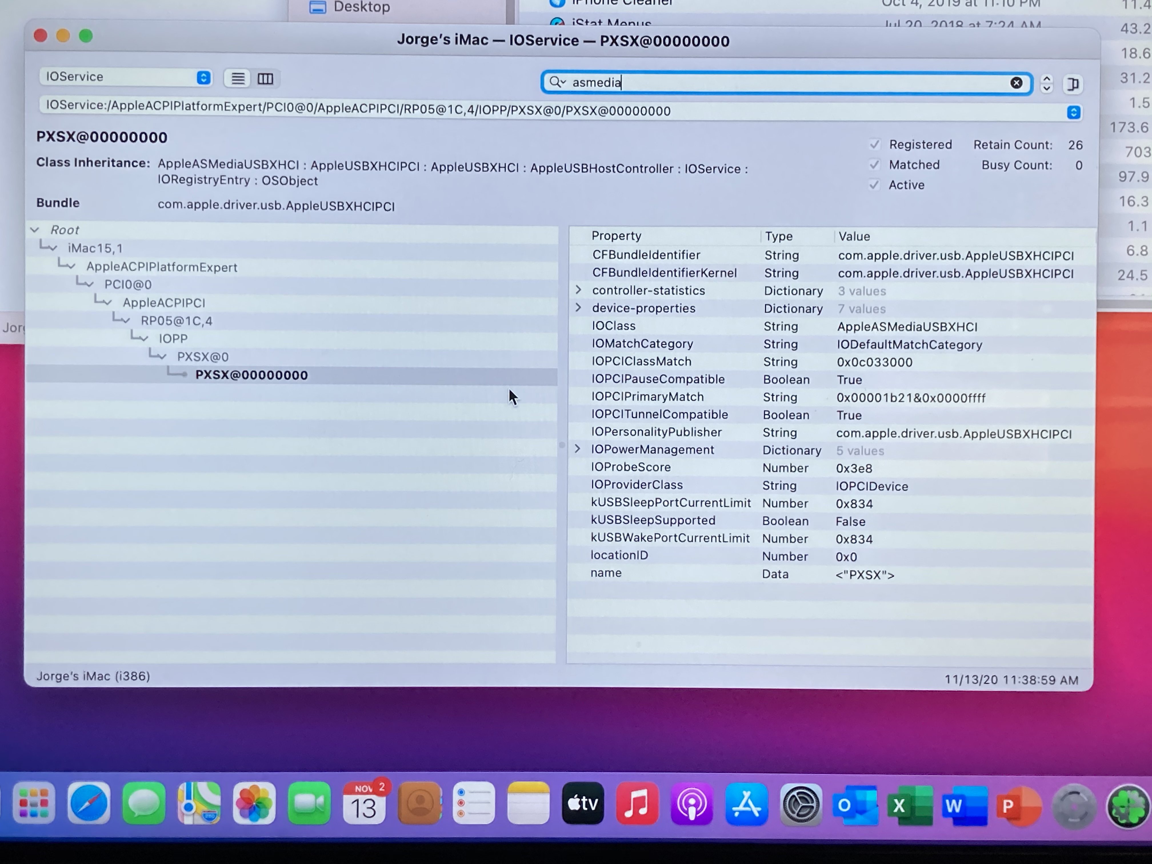

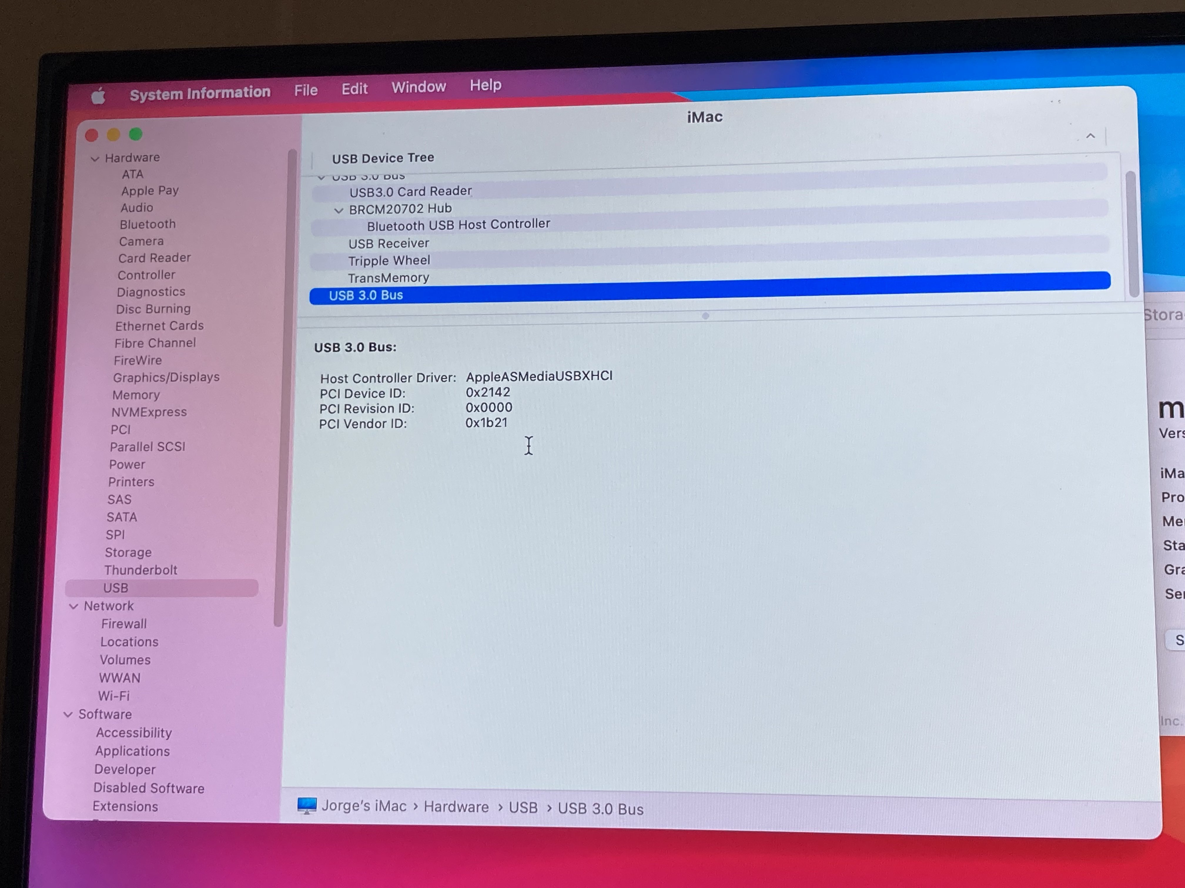

On 11/13/2020 at 11:46 AM, jlrycm said:
Hello @everyone, I installed Big Sur release using a USB pen drive and it went smoothly. The only issue so far is that the USB 3.1 ASmedia controller pcie card is not loaded properly and the USB 3.1 external disk is not recognized as such when connected. Attached are some pictures and my efi folder (excluding themes and doc folders). Any tips will be highly appreciated.
Archive Clover.zip
Jorge’s iMac.zip
Hello @Slice @Jief_Machak: by any chance you had the opportunity to see my previous post about my installation of Big Sur, which was successful except for the USB 3.1 gen 2 PCIe card which is loaded properly in Catalina but not in Big Sur. The card uses ASmedia 2142 usb controller which is supposed to be supported natively. I checked with the vendor and they responded that the card is supposed to be supported natively by Big Sur. However, that’s not the case as you can see in the pictures attached to my previous post in which I also attached the efi folder and the ioreg copy.
PXSX is normal for USB3 asmedia as additional controllers
remove USBinjectall and you'll see that the correct USB power supply starts working again
USBinjectall is an absolutely useful kext during installation, but in post installation it is to be removed from the feet as soon as possible, mapping the USB and refining hack settings.

Hello @iCanaro. Thanks a lot for sharing your thoughts. I’m using USBinjectall combined with a custom SSDT-UIAC which is a solution equally valid as the USBmaps.kext. From I have learned, the card has native support in Catalina and previous macOS versions and the SSDT-UIAC + USBINJECTALL couple was not supposed to have influence over USB controllers natively supported. I really don’t have an idea why this card is not working in Big Sur, unless the kext is not being uploaded properly. When I connect a drive to the USB Type C port, nothing happens, and as shown in the picture, the USB is displayed as 3.0 instead of 3.1 which is how is displayed in Catalina.  Also, in Catalina the USB 3.1 in this card appears to be supported by AppleUSBXHCIPCI which is a plug-in of IOUSBHostfamily kext. I thought about a workaround of loading the Catalina kext directly from OpenCore but not sure it would work. At least it’s a solution that some colleagues applied in Big Sur to enable the wifi cards whose native support was dropped in Big Sur. Any thoughts on that, @Slice, @Jief_Machak, @iCanaro or anyone else?
no negative, the solution you adopt for me is not good, the use of USBinjectall brings power problems to USB ports.
if you want a good alternative, with hackintool generate USBPorts.kext and only use him
no USBinjectall, no SSDT-UIAC and no port limit patches

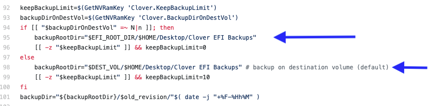

Was the location of CloverBackups decided to be "~/Desktop/Clover EFI Backups"?
It's not bad in an easy-to-see place.
But I think some people care about how it looks on Desktop.
My suggestion is "~/Clover EFI Backups".
Since this is the home folder, so you'll definitely notice it, and I think it's a convenient place to separate it from other folders.
What do you think of it?
If possible,
I am waiting for "Like", "sad" votes.
Thank you.
I think Everybody as suggestion and all is good but imposible to satisfy all people
if you prefer other directory why don't you do it yourself
Its verry simply
CloverBootloader/CloverPackage/package/Scripts.templates/EFIFolder/preinstall
Open with Xcode or any good textediter
Line 95 / 98 change it as you want. Simple as that
Spoiler
For my part, I prefer the Desktop at Home :)
Edited by chris1111
Image in spoiler
  • Thanks 1
