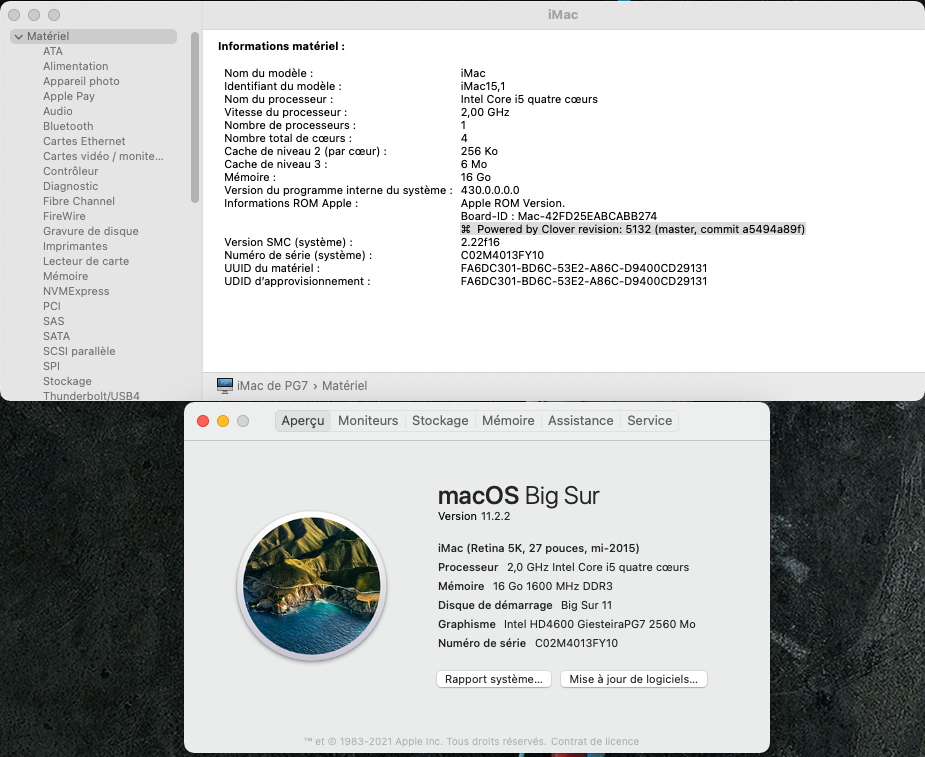

Just now, MifJpn said:

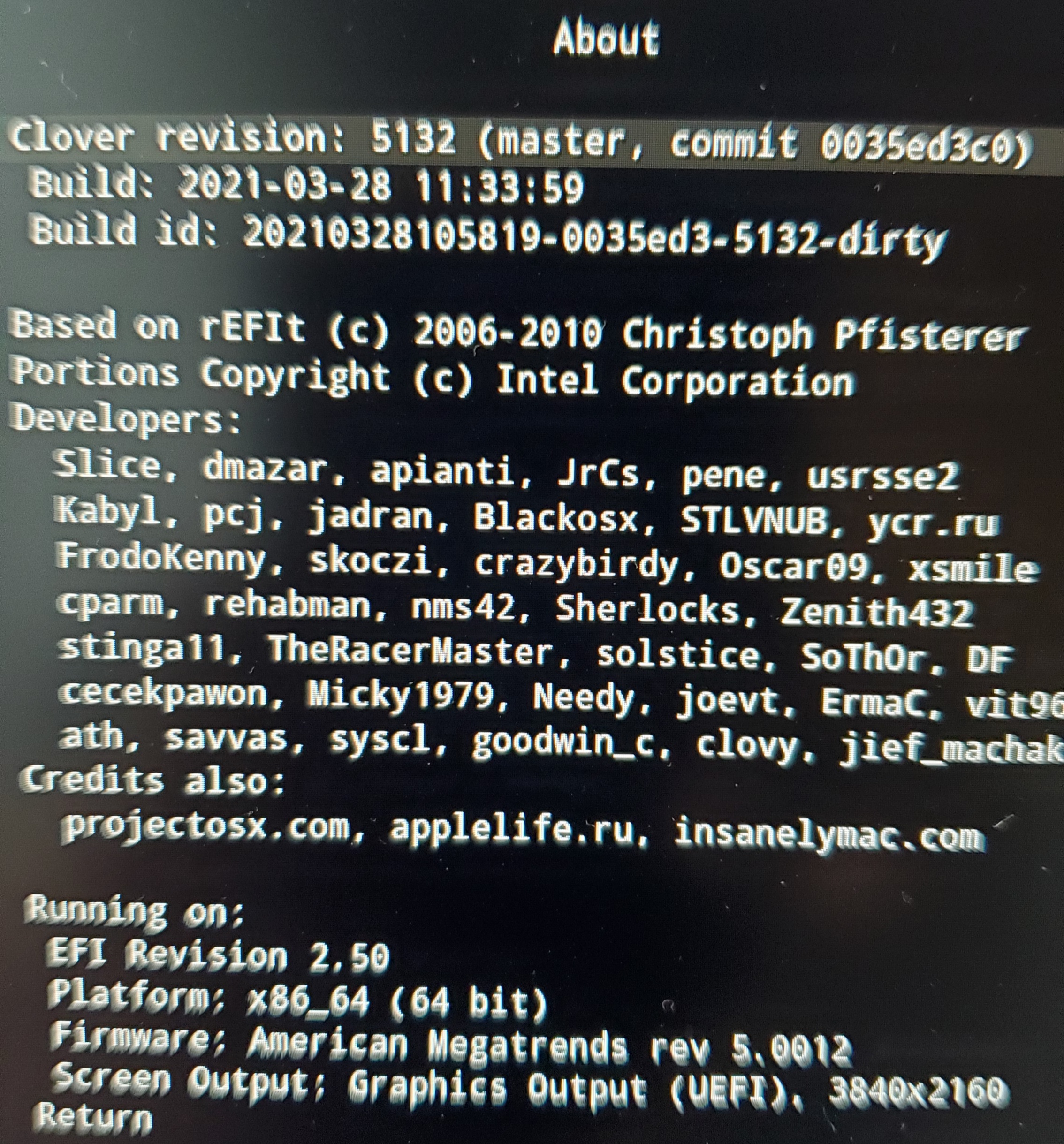

⌘  Powered by Clover revision: 5132 (master, commit a5494a89f)
As a reminder, checking the System Information once booted is NOT enough !
Many of my compilation will have the same commit number.
I guess I will have to improve that !

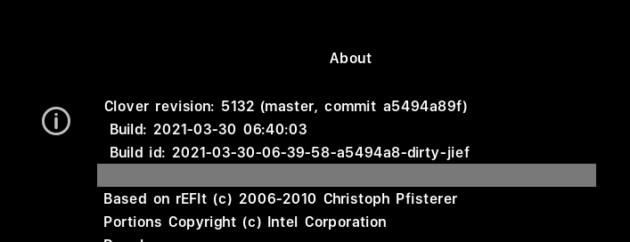

@Jief_Machak You already do that in Clover  "About" section : see @eng_redaesm screenshot

1 minute ago, LIMITANT said:
@Jief_Machak
Why I'm still seeing the old commit !!
If you see the wrong one, it's because you used the wrong one :lol: !
Maybe you copied it the wrong place.
Use BootloaderChooser, you'll never have that problem anymore !
True, but if you forgot to do it, you have to reboot.
And it'll take me 2 minutes (really) to have my build id instead of commit number on my own compilations. (Normal release will stay the same).

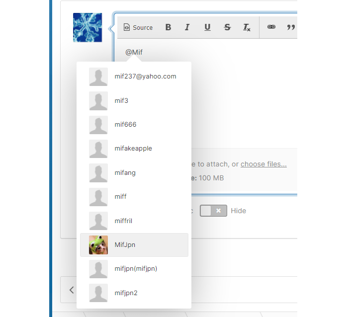

13 minutes ago, Slice said:
@MifJpn
It is automatic substitution. But I am not sure about japanese keyboard
  Reveal hidden contents

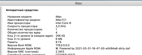

You can now check you used the right file once booted in macOs by looking at the system information :
The name must be the same as the efi file name when I posted it.

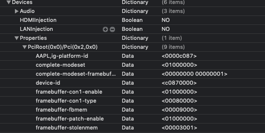

@Jief_Machak I confirm: Boot fine (Z390 Big Sur 11.3 Beta 5). Thanks for your great work.
I take a look to the submenu of Option/PCIdevices. I don't understand what 'Arbitrary Properties' and  'Add Properties' are ! Because I don't find these sections in Config-sample.plist
Properties submenu, I like the checkbox. Is It possible to have also a checkbox for <key>PciRoot(0x0)/Pci(0x1c,0x1)/Pci(0x0,0x0)</key>, for example. So we can enable or disable all sub-keys in one time

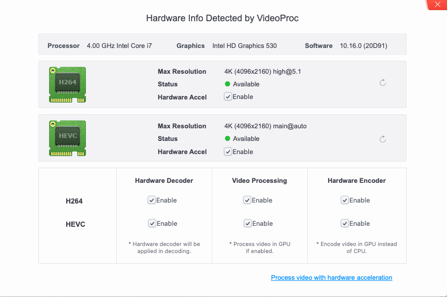

there is something strange i've noticed with this build  HEVEC CODEC is not enabled
but with this build  working good
They exist under Device/Arbitrary and Devices/AppProperties. Maybe you just don't need it.
Probably an injection problem... That's the only thing I've touched.
@eng_redaesm Could you boot CloverX64-2021-03-31-21-48-49-a5494a8-dirty-jief.zip, check that HEVEC is enable and do "ioreg -lw0" > ioreg_ok.txt
Then boot : CloverX64-2021-03-31-21-50-04-a5494a8-dirty-jief.zip. Check that HEVEC in not enabled and do "ioreg -lw0 > ioreg_nok.txt
and send me the 2 files.
I'm afraid that'll be too much work for now, due to the way the Clover menu system works. But I guess one day I'll refactor that too :lol::lol::lol:

with this version at first glance everything seems OK, even H264 and HEVC are OK
43 minutes ago, Slice said:
and all my Properties are injected as it should.
@Slice Glad it works. Do you have any Device Properties ? or Arbitrary ? or AddProperties ?
@iCanaro Which one ? There is 2 efi files in the poste you quoted. One is WITHOUT the refactor and one is WITH it. So it's important to know which one do you test.
This one is the refactored one : CloverX64-2021-03-31-21-50-04-a5494a8-dirty-jief
