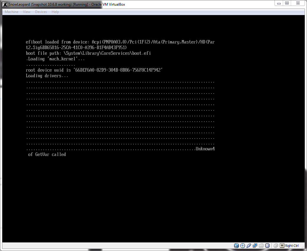

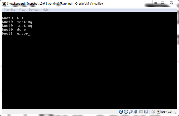

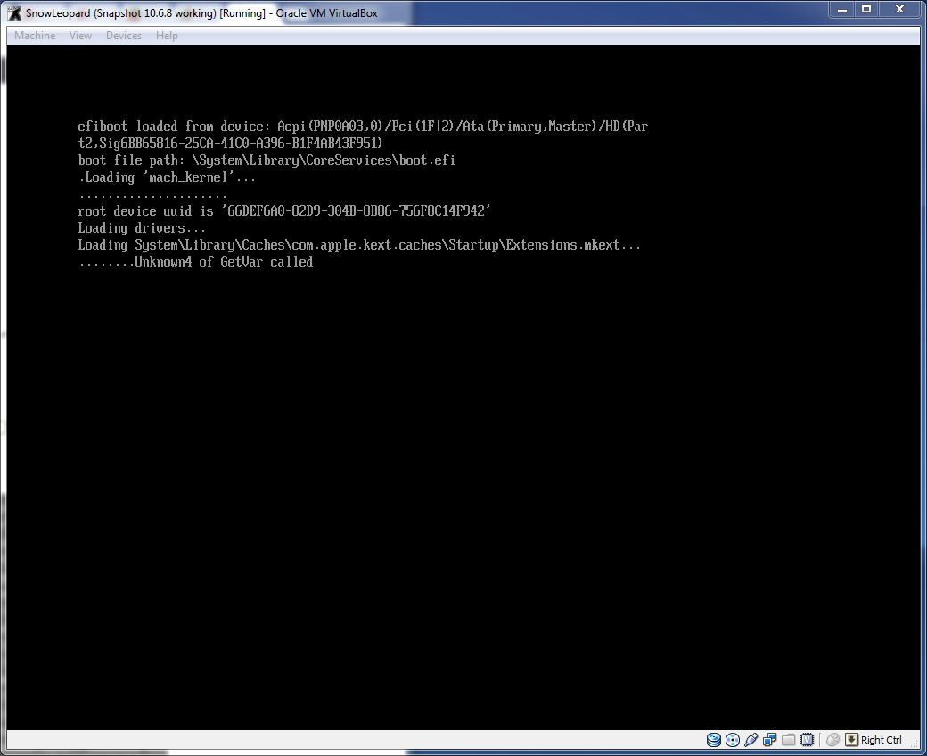

Mr.D. Posted September 30, 2012 Author Share Posted September 30, 2012 just tried it - got that boot1: error that I received before. and yes this is on the snapshot right after 10.6.8 was installed. I'll try to find that version of Chameleon in case it is a zip error... Those are with the redownloaded version in your zip file... I had to RDP to my desktop and run VB just to capture that stupid screen! Link to comment https://www.insanelymac.com/forum/topic/283113-virtual-box-and-snow-leopard-success/page/2/#findComment-1857169 Share on other sites More sharing options...
ZackehSoul Posted October 1, 2012 Share Posted October 1, 2012 Let's try something different; from CMD run the following: VBoxManage modifyvm "<yourvirtualmachinename>" --firmware efi64 VBoxManage setextradata "<yourvirtualmachinename>" VBoxInternal2/SmcDeviceKey "ourhardworkbythesewordsguardedpleasedontsteal©AppleComputerInc" Then retick the EFI box in the settings and try booting again. Link to comment https://www.insanelymac.com/forum/topic/283113-virtual-box-and-snow-leopard-success/page/2/#findComment-1857171 Share on other sites More sharing options...

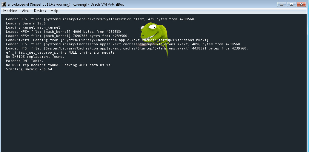

Mr.D. Posted October 1, 2012 Author Share Posted October 1, 2012 brings me to the same place as the screenshots above. the commands executed successfully, then went back in and deselected the efi in the vm. still hangs at starting darwin x86_64 Link to comment https://www.insanelymac.com/forum/topic/283113-virtual-box-and-snow-leopard-success/page/2/#findComment-1857175 Share on other sites More sharing options...
ZackehSoul Posted October 1, 2012 Share Posted October 1, 2012 Wait you deselected it? I thought it already was. Try it renabled Link to comment https://www.insanelymac.com/forum/topic/283113-virtual-box-and-snow-leopard-success/page/2/#findComment-1857176 Share on other sites More sharing options...

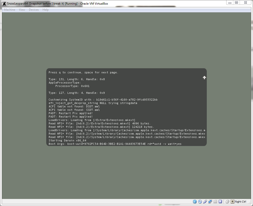

Mr.D. Posted October 1, 2012 Author Share Posted October 1, 2012 it reenabled it with those commands you gave me... it was deselected before. I have reenabled it and the boot is SUPER slow - and doesnt get past the oracle VirtualBox splash screen - just like it hasn't every time I have selected the efi option. It stays at the splash screen for a minute, then to the black screen of suck. well - perhaps I have been impatient before because this just popped up: it took three minutes to get there, but something finally happened. I have to step away for 90min to 2 hours, so I'll let it stew and see if anything else pops up. Link to comment https://www.insanelymac.com/forum/topic/283113-virtual-box-and-snow-leopard-success/page/2/#findComment-1857178 Share on other sites More sharing options...
ZackehSoul Posted October 1, 2012 Share Posted October 1, 2012 If that breaks or freezes, go into it afterwards and rm /System/Library/Caches/com.apple.kext.caches/Startup/Extensions.mkext then reboot and see what happens 1 Link to comment https://www.insanelymac.com/forum/topic/283113-virtual-box-and-snow-leopard-success/page/2/#findComment-1857179 Share on other sites More sharing options...
Mr.D. Posted October 1, 2012 Author Share Posted October 1, 2012 Booted with BL. The rm command failed. Then I tried sudo rm - success, but... ... when I booted the same thing happened, in the same location. *head scratch* So I rebooted with the BL, and went tot the directory and moved the file to the trash. I noticed the mod date for the file was yesterday, so I knew it hadn't be rebuilt from the time that I suposedly rebuilt it till the reboot. I rebooted, switched the VM stuff back... ... and after a really long time I got this: Link to comment https://www.insanelymac.com/forum/topic/283113-virtual-box-and-snow-leopard-success/page/2/#findComment-1857201 Share on other sites More sharing options...

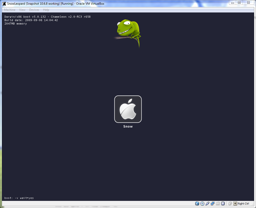

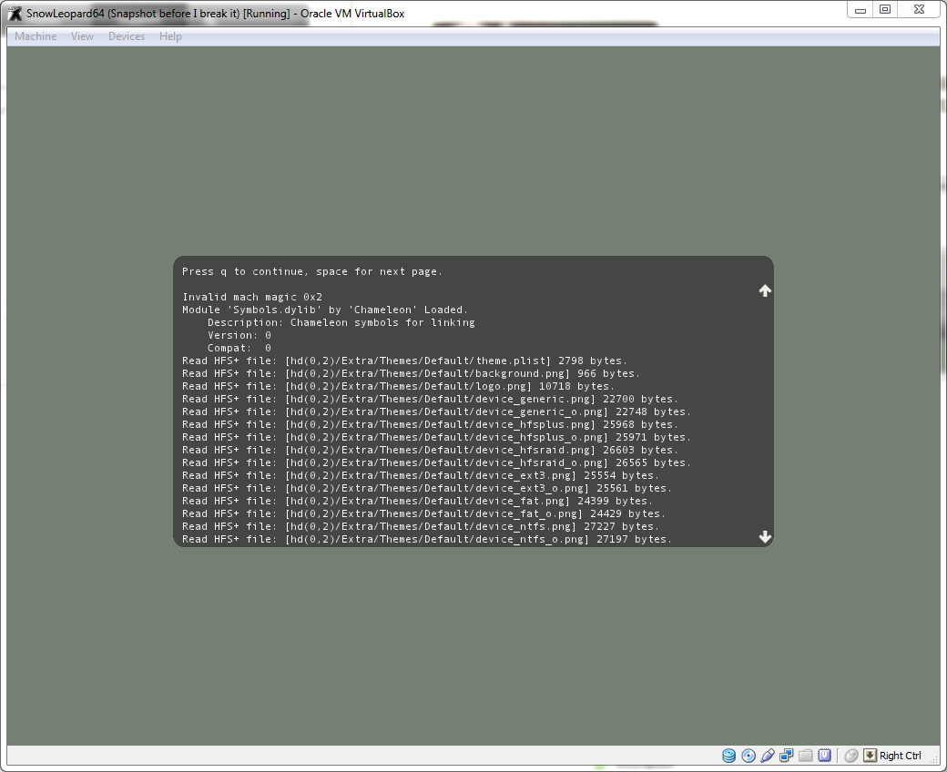

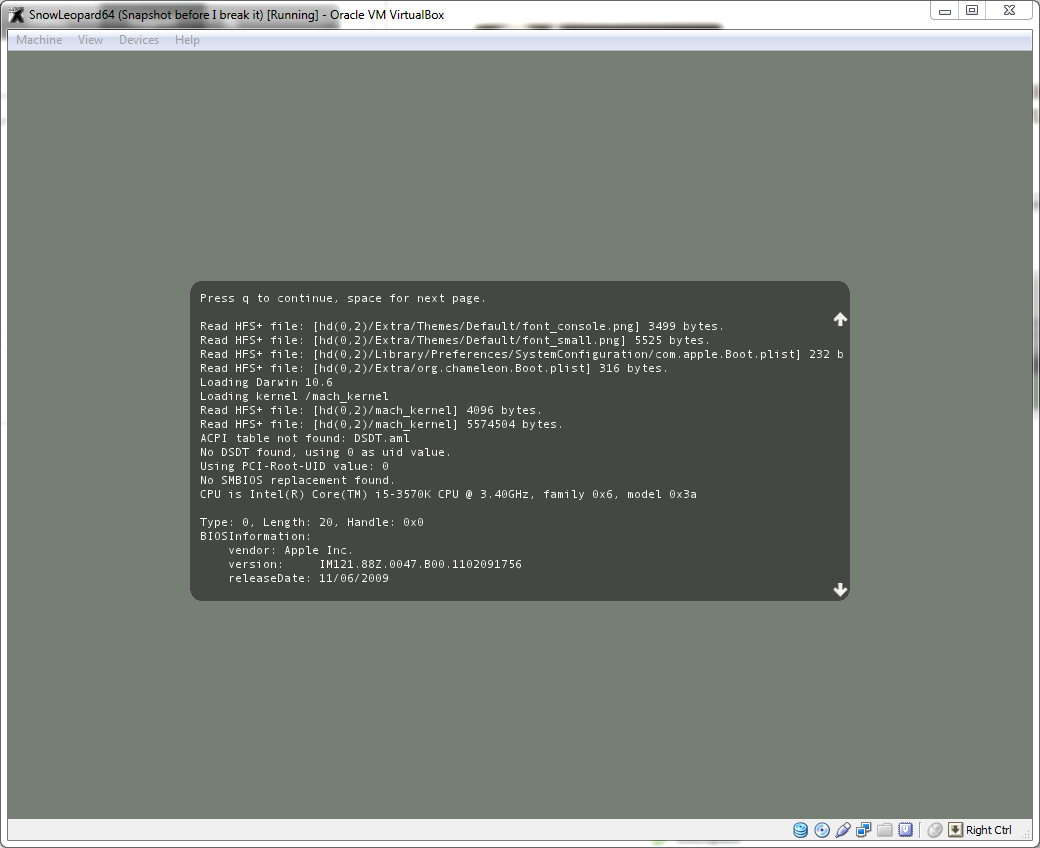

Mr.D. Posted October 2, 2012 Author Share Posted October 2, 2012 after failed chameleon 2 rc3 r658, which looks like its specifically for snow leopard, I tried Chimera 1.11.1 (against my better judgment) and it failed, then tried myHack 3.1.2 and I was able to pull these screen shots - there were more screens, but these seemed important. I can capture every screen if that would help. here is the log file from my most recent version of chameleon to install... and it stops in exactly the same place. I dont think this is a chameleon issue, and I dont think its a VB issue. The only two variables that have NOT changed are me and my hardware. SO now the question is: is it a PEBCAK error, or is it that my machine is too new/awesome to do this? The last option would be bittersweet - because I cant even GET ML w/o being able to upgrade this VM to 10.6.8 and have the app store be able to verify it. Is it me? What did I do wrong? Why do you hate me VirtualBox and SnowLeopard? WHY?? WHY??? Link to comment https://www.insanelymac.com/forum/topic/283113-virtual-box-and-snow-leopard-success/page/2/#findComment-1857485 Share on other sites More sharing options...

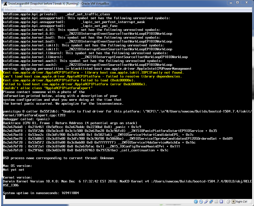

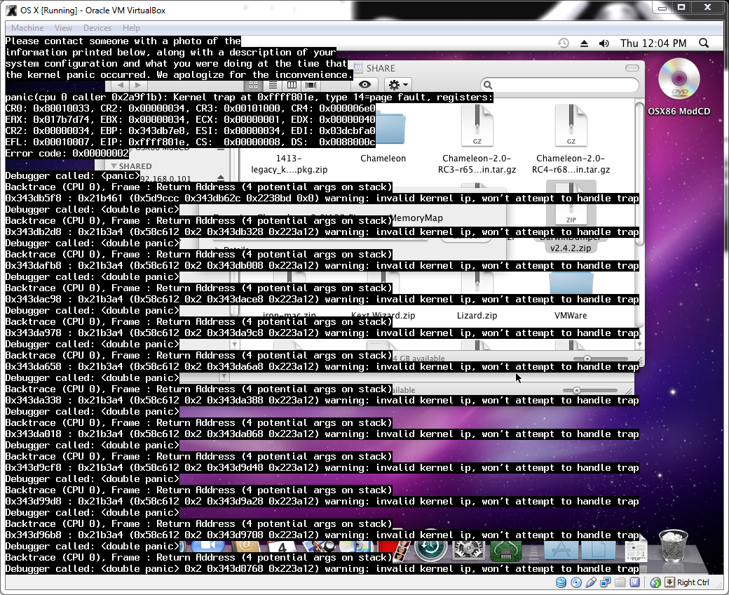

Mr.D. Posted October 3, 2012 Author Share Posted October 3, 2012 I am at a total loss here. I started over and it just seemed to make things even more flaky. I have 2 VMs installed. One is my testing, and the other was generic. I'm using the afore mentioned nawcom ModCD to boot, but sometimes - and only sometimes - it hangs here: Why? it makes no sense that this isn't even a CONSISTENT error... much less so why its hanging at that particular spot. I am nearly ready to say forget it and stop with this project completely. Link to comment https://www.insanelymac.com/forum/topic/283113-virtual-box-and-snow-leopard-success/page/2/#findComment-1857737 Share on other sites More sharing options...

dmazar Posted October 3, 2012 Share Posted October 3, 2012 an Intel Core2 duo processor - I have an i5-3570k IvyBridge. This may be a big issue. Probably. Not something that I understand very well, but I would say that you need patched kernel. And you need to install it to your SL disk to be able to boot it without CD (iso). Patched kernel is probably on CD, but not on your SL disk. How do I use the darwindumper app on my darwin that fails to load? all this will tell me is about the bootloader .iso that IS working, not the one that fails to boot. Unless I am missing something and it will generate a file even w/o successful boot, then I can re-enable the iso chameleon bootloader and view the file?? This app seems more for somebody with config issues, not with outright FAIL issues. If you can boot, then you can run it. It should list all installed bootloaders - it does not matter how you started the system. But, maybe the problem is actually this patched kernel. Link to comment https://www.insanelymac.com/forum/topic/283113-virtual-box-and-snow-leopard-success/page/2/#findComment-1857988 Share on other sites More sharing options...

ZackehSoul Posted October 4, 2012 Share Posted October 4, 2012 Probably. Not something that I understand very well, but I would say that you need patched kernel. And you need to install it to your SL disk to be able to boot it without CD (iso). Patched kernel is probably on CD, but not on your SL disk. No, the i5 should work just fine without a modified kernel. The only issue that could be thrown up would be the kext removal of ACPI_SMC_PlatformPlugin.kext from within /System/Library/Extensions/IOPlatformPluginFamily.kext. I dont even know what to say. I did EVERYTHING the same as I did before. Didn't miss the ACPI stuff or anything? Did you update from 10.6.3 again? Link to comment https://www.insanelymac.com/forum/topic/283113-virtual-box-and-snow-leopard-success/page/2/#findComment-1857999 Share on other sites More sharing options...

dmazar Posted October 4, 2012 Share Posted October 4, 2012 Listing of blacklisted kexts from some earlier screenshot is from modified kernel. How i see it: You have patched kernel on your boot iso that can run 10.6.3, but not 10.6.8. And you did not copied that patched kernel to SL volume and then you can not boot without cd (iso). Search with google shows this: http://www.osx86.net/view/3047-ivy_bridge_kernel_for_snow_leopard_10.6._...html I think you shoul replace your /mach_kernel with the one from the link and try. Chameleon is a bootloader. And again, it does not matter how you started osx - you can always start DarwinDumper and collect it's findings. Link to comment https://www.insanelymac.com/forum/topic/283113-virtual-box-and-snow-leopard-success/page/2/#findComment-1858042 Share on other sites More sharing options...

dmazar Posted October 4, 2012 Share Posted October 4, 2012 Well, it looks like you'll have to try. This is a chance to dig deeper and learn few things more. I have Sandy Bridge and I can not run 10.6.3 without patched kernel because 10.6.3 does not have support for Sandy. And then no support for your Ivy also. When I was installing 10.6.3, I had to use patched kernel. 10.6.8 have support for Sandy, and obviously not for Ivy. Meaning - you can run it only with modified kernel. You may be lucky since stinga11 offered one on the posted link. Lion also does not support your Ivy until 10.7.5, but you will probably not need Lion since you (maybe) will be able to upgrade to Mountain Lion from 10.6.8. About boot loaders ... Chameleon is a bootloader. What you call bootloader is your boot CD. Your ModCD contains Chameleon bootloader + patched (legacy) kernel for 10.6 + many kexts that would make many boards working when booted like this. You can open your ModCD.iso (double click on it) and you can then examine what's in there. /usr/standalone/i386/cdboot - this is your Chameleon boot file, for booting from CD /Extra/Preboot.dmg - will be loaded as RAMdisk when Chameleon starts (this allows ejecting CD and inserting another one in while keeping all Chameleon's stuff in memory) - all stuff is in there /Extra/Preboot.dmg/Extra: - com.apple.Boot.plist - Chameleon's config - legacy_kernel - modified kernel to run on unsupported CPU - Extensions.mkext - archive of kexts that will be loaded (you can use KextWizard to unpack it and see what's in there) All in all, booting from CD can do many things that are not so obvious. In your case - boots your SL with patched kernel (legacy_kernel), plus loads tons of extra kexts (which you probably do not need). If you want to boot from a disk, then you need to replace original /mach_kernel with patched one. Although, since your main goal is to upgrade to ML, you probably do not need this - you can continue booting from CD. You can always install Chameleon to the disk once you install ML (you will not need patched kernel then). There is a guy "who's-name-should-not-be-mentioned-because-he-steals-other-people's-work-but-who-prepares-good-tools-and-guides-to-make-install-easy-as-possible" - following his methods and tools would be much easier. But that's probably not your option. 1 Link to comment https://www.insanelymac.com/forum/topic/283113-virtual-box-and-snow-leopard-success/page/2/#findComment-1858082 Share on other sites More sharing options...

ZackehSoul Posted October 4, 2012 Share Posted October 4, 2012 Oh wow, I completely missed the fact you stated it was an IvyBridge. Yeah, you need the modified kernel for it to boot properly. (which is weird as you didn't do that the first time). 1 Link to comment https://www.insanelymac.com/forum/topic/283113-virtual-box-and-snow-leopard-success/page/2/#findComment-1858158 Share on other sites More sharing options...
