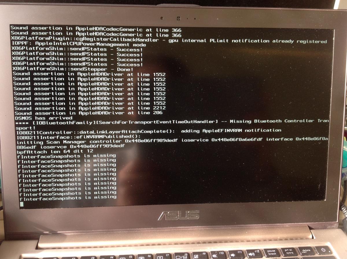

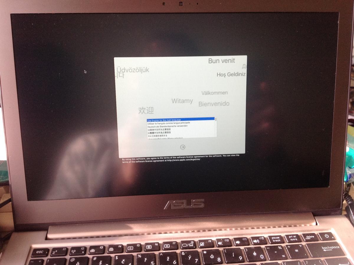

pavn Posted November 5, 2015 Share Posted November 5, 2015 I got stuck here in trying to run El Captain installer. I currently try to install El Capitan on my UX32VD Asus Zenbook UX32VD r4002v (BIOS 214) Intel Core i7 3517U (Ivy Bridge - IntelHD4000) nVidia Geforce GT 620M Display 1920x1080 10GB RAM, 256GB SSD I use Clover v2.3k r3270 UEFI bootflags: -v dart=0 nv_disable=1 kext-dev-mode=1 rootless=0 I got following to work with help of: - kext utility (bootflags kext-dev-mode=1 and rootless=0) - 68x' DSDT.aml (UX32VD) in 'EFI/CLOVER/ACPI/patched' - SeppDepp' ssdt.aml (UX32VD-Pack) 'EFI/CLOVER/ACPI/patched' (Clover kext injection doesn't work for me) Display - with full resolution 1920x1080 (nv_disable=1 bootflag) Touchpad and Keyboard - with ApplePS2SmartTouchPad.kext in 'Library/Extensions' (Elan SmartTouchpad_v4.4.5_64bit) USB to Ethernet Adapter - with patched IONetworkingFamily.kext in 'System/Library/Extensions' Audio - with patched AppleHDA.kext in 'System/Library/Extensions' and custom DSDT.aml Battery Symbol - with patched AppleSmartBatteryManager.kext in 'System/Library/Extensions' and custom DSDT.aml Some FN-Keys (buggy) - with AsusNBFnKeys.kext in 'System/Library/Extensions' (AsusNBFnKeys_v2.5.5) Bluetooth - works I guess with 2.0 only Not working yet or not sure about - Stand-by and Wake-up (DSDT?) - TRIM-Support for SSD? - FAN-Support (DSDT-Patch?) - CPUSpeedStep (ssdt working?) - correct Keyboard-Map - USB3.0 (read about problems with stand-by and wake-up) - nVidia 620M (read about IntelHD or nVidia possibility only) - HDMI/mini-VGA (not tested yet nVidia-Chip necessary?) - WiFi (Atheros card ordered) - SD-Card (won't work at all?!) I still have some kext and DSDTs from other sources to test and im not sure about all functions of DSDT and SSDT yet. I managed to fetch my ACPI-Files with Clover (F4), and try my luck tomorrow regarding DSDT comparison and patching. I am thankful for every help or advise! Link to comment https://www.insanelymac.com/forum/topic/283038-asus-zenbook-prime-ux31a-db51-ultrabook-fixes-mods-tweaks-etc/page/41/#findComment-2185567 Share on other sites More sharing options...
MasterDesaster Posted November 5, 2015 Share Posted November 5, 2015 I got stuck here in trying to run El Captain installer. image.jpeg There are some changes concerning AppleHDA.kext in ElCap. You tried to boot in safe mode -x? See the EFI folder attached. It is Work in Progress! But installation works with it. (But maybe I did some additional boot flags/options.... I do not remember.) EFI-UX32VD-USB-Installer-WIP.zip Link to comment https://www.insanelymac.com/forum/topic/283038-asus-zenbook-prime-ux31a-db51-ultrabook-fixes-mods-tweaks-etc/page/41/#findComment-2185573 Share on other sites More sharing options...

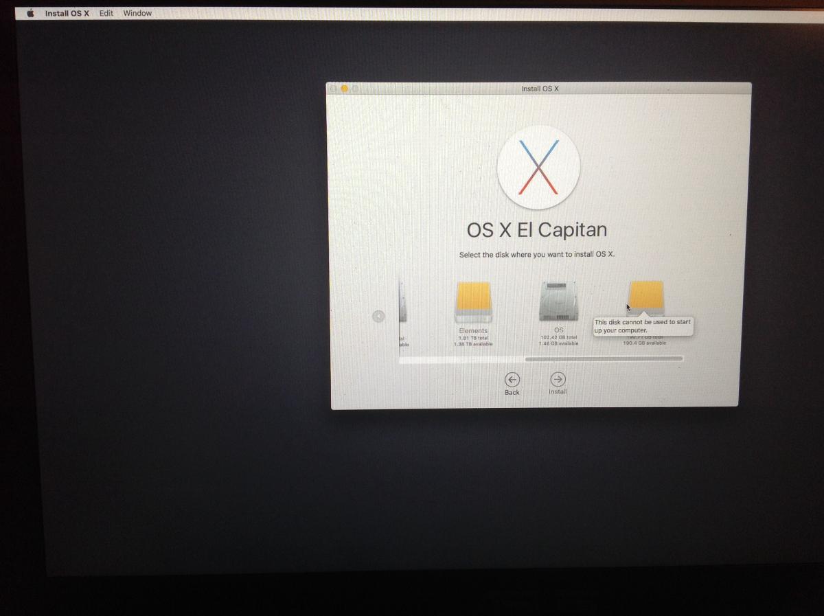

pavn Posted November 5, 2015 Share Posted November 5, 2015 Thanks! This time El Captaine installer loaded. I even did not need to use -x parameter!I am going to test installation now! Will report back soon. What are requirements for partition to be able to install it, please? Can I install it to HFS+ partition created from resizing of original Mavericks HFS+ partition of the free space? Or to external HD by resizing original whole disk one NTFS partition and to create there a new HFS+ partition? There are some changes concerning AppleHDA.kext in ElCap.You tried to boot in safe mode -x?See the EFI folder attached. It is Work in Progress! But installation works with it. (But maybe I did some additional boot flags/options.... I do not remember.) Link to comment https://www.insanelymac.com/forum/topic/283038-asus-zenbook-prime-ux31a-db51-ultrabook-fixes-mods-tweaks-etc/page/41/#findComment-2185581 Share on other sites More sharing options...

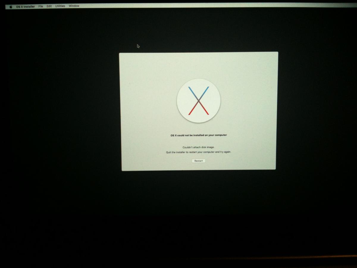

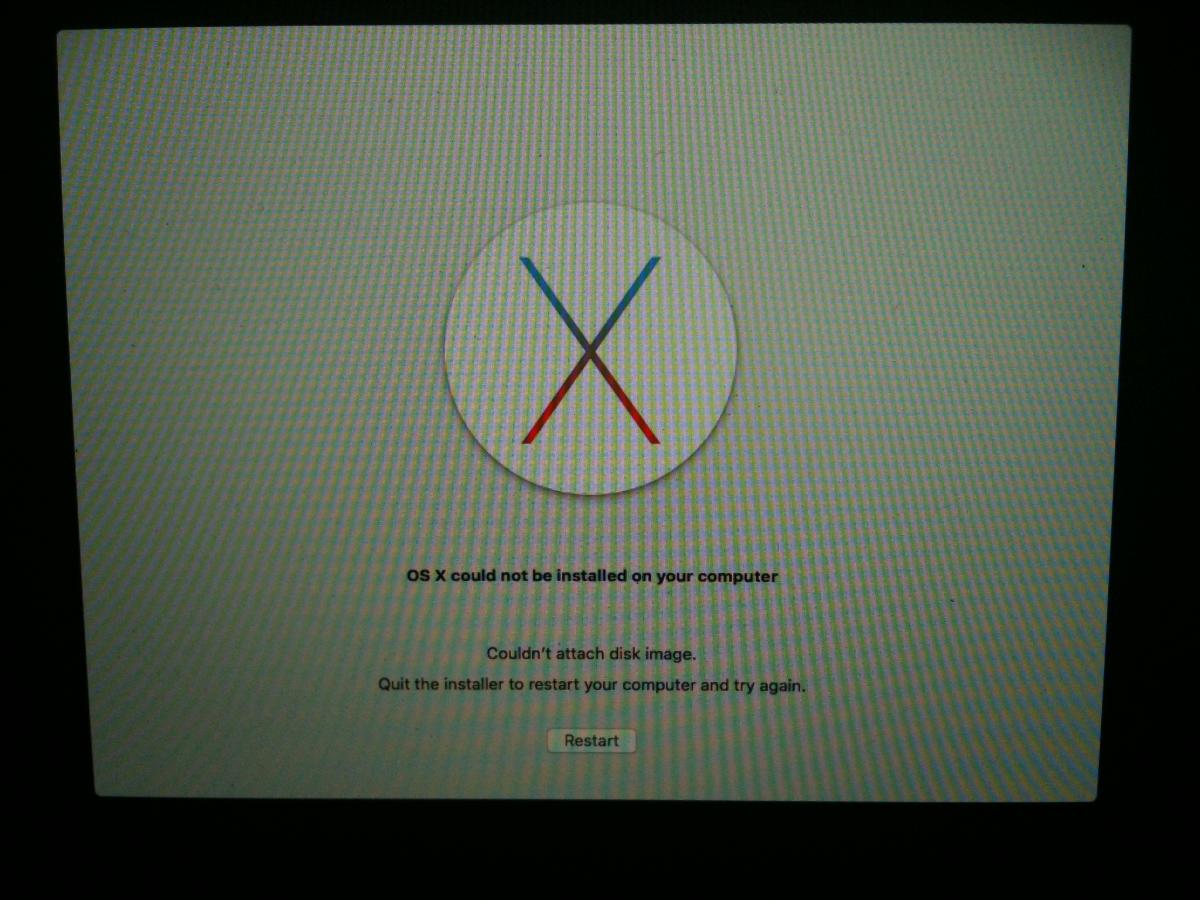

pavn Posted November 15, 2015 Share Posted November 15, 2015 I created El Captain USB installer with this tool: http://www.insanelymac.com/forum/topic/307003-clover-os-x-el-capitan-usb/page-1. And trying to install El Captain on Asus Zenbook UX32VD notebook. Unfortunately I am getting this message before the installation starts to progress with percents. OS X COULD NOT BE INSTALLED ON YOUR COMPUTER COULDN'T ATTACH DISK IMAGE. QUIT THE INSTALLER TO RESTART YOUR COMPUTER AND TRY AGAIN. Any tip, please? Link to comment https://www.insanelymac.com/forum/topic/283038-asus-zenbook-prime-ux31a-db51-ultrabook-fixes-mods-tweaks-etc/page/41/#findComment-2188770 Share on other sites More sharing options...
MasterDesaster Posted November 16, 2015 Share Posted November 16, 2015 Thanks! This time El Captaine installer loaded. I even did not need to use -x parameter! What's with the other installer you created last week? It is created with the same tool. But has some modified kexts, config, DSDT,... Link to comment https://www.insanelymac.com/forum/topic/283038-asus-zenbook-prime-ux31a-db51-ultrabook-fixes-mods-tweaks-etc/page/41/#findComment-2188883 Share on other sites More sharing options...
pavn Posted November 16, 2015 Share Posted November 16, 2015 It is the same USB installer as it was previous week. But I did not finish the installation since I did not have prepared free partition last week. So I prepared new partition for installation and tried to finish the installation. But it looks like the tool http://www.insanelym...itan-usb/page-1 requires 16 GB flash disk for creation of El Captain flash disk installer correctly. I do not know exactly why. But that tool to 8GB flash disk creates broken installation. The file BaseSystem.dmg is not correct size. That it is why it looks like the installation can not proceed because of this corrupted file there. It looks like the file was corrupted because there was not enough space on 8 GB flash disk. It also look to me very strange because with GPARTED Linux tool I see there 128 MB unallocated space. And also EFI partition uses about 38 MB space of 200 MB of the free space of the EFI partition for files. That it is why from my point of view is strange that the installer creation tool does not create smaller EFI partition eg. 50 MB and why not uses not allocated 128 MB space to get additional 278 MB for HFS+ El Captain installer partition? The problem with the created 8GB USB installer flash disk is that I can not change the partition sizes to fix the corrupted installer somehow neither with Gparted neither with disk utility nor diskutil resizeVolume terminal command. It would only require more space and copy full sized BaseSystem.dmg file. What's with the other installer you created last week? It is created with the same tool. But has some modified kexts, config, DSDT,... Link to comment https://www.insanelymac.com/forum/topic/283038-asus-zenbook-prime-ux31a-db51-ultrabook-fixes-mods-tweaks-etc/page/41/#findComment-2188884 Share on other sites More sharing options...
pavn Posted November 16, 2015 Share Posted November 16, 2015 What is the best way and steps to create El Captain installer for Zenbook, please? I would need to probably create it from scratch again. (Without using that tool.) What's with the other installer you created last week? It is created with the same tool. But has some modified kexts, config, DSDT,... Link to comment https://www.insanelymac.com/forum/topic/283038-asus-zenbook-prime-ux31a-db51-ultrabook-fixes-mods-tweaks-etc/page/41/#findComment-2188907 Share on other sites More sharing options...
MasterDesaster Posted November 16, 2015 Share Posted November 16, 2015 Easiest way: Create it with the tool. And change the EFI folder contents with the one I shared. BTW: EFI partition is always 200MB. Link to comment https://www.insanelymac.com/forum/topic/283038-asus-zenbook-prime-ux31a-db51-ultrabook-fixes-mods-tweaks-etc/page/41/#findComment-2188909 Share on other sites More sharing options...

pavn Posted November 16, 2015 Share Posted November 16, 2015 I was able to install OS X El Capitan to external HD partition. The missing thing was to create 200MB EFI fat32 partition to be able to install it there.Now I am going to try to boot it. Link to comment https://www.insanelymac.com/forum/topic/283038-asus-zenbook-prime-ux31a-db51-ultrabook-fixes-mods-tweaks-etc/page/41/#findComment-2189082 Share on other sites More sharing options...

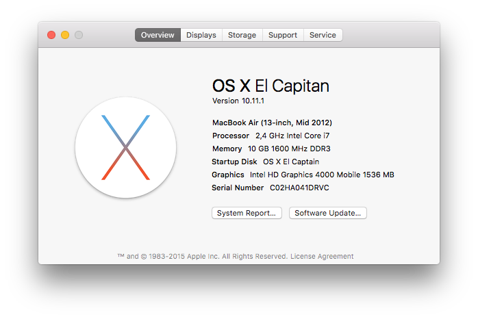

pavn Posted November 17, 2015 Share Posted November 17, 2015 Ok. I run installer again from the flash drive and it showed 24 minutes remaining progress bar and continued the installation. It took significantly more time. But it finished installation. I then booted from Clover from USB flash disk to Mac OS X El Captain. What kind of post installation steps do you recommend, please? Audio does not work. Bluetooth does not work ... no information found. Webcam seems to work. Card reader is not recognised. Intel HD Graphics 4000 Mobile seems to work. Displays VRAM 1536MB. Memory 10GB DDR3 detected without problem. Link to comment https://www.insanelymac.com/forum/topic/283038-asus-zenbook-prime-ux31a-db51-ultrabook-fixes-mods-tweaks-etc/page/41/#findComment-2189131 Share on other sites More sharing options...
MasterDesaster Posted November 17, 2015 Share Posted November 17, 2015 What kind of post installation steps do you recommend, please? Now you are on yourself. I don't use ElCapitan in my production environment. A good starting point is to copy the (work in progress) EFI folder I provided. There need to be some optimization inside of the EFI folder in the kext directory (Upgrades, fixes, add missing kexts,...). Everything else is like in the old OS X versions: So (almost) every information about post installation is in this thread. (So.. please read!) Link to comment https://www.insanelymac.com/forum/topic/283038-asus-zenbook-prime-ux31a-db51-ultrabook-fixes-mods-tweaks-etc/page/41/#findComment-2189134 Share on other sites More sharing options...
pavn Posted November 17, 2015 Share Posted November 17, 2015 Not sure if power safe mode works, but this is displayed. System Power Settings: AC Power: System Sleep Timer (Minutes): 10 Disk Sleep Timer (Minutes): 10 Display Sleep Timer (Minutes): 10 Sleep on Power Button: Yes Wake on AC Change: No Wake on LAN: Yes AutoPowerOff Delay: 14400 AutoPowerOff Enabled: 1 Current Power Source: Yes DarkWakeBackgroundTasks: 0 Display Sleep Uses Dim: Yes Hibernate Mode: 3 PrioritizeNetworkReachabilityOverSleep: 0 Standby Delay: 4200 Standby Enabled: 0 Hardware Configuration: UPS Installed: No Not sure if USB3 works. But USB2 is detected. Link to comment https://www.insanelymac.com/forum/topic/283038-asus-zenbook-prime-ux31a-db51-ultrabook-fixes-mods-tweaks-etc/page/41/#findComment-2189135 Share on other sites More sharing options...
pavn Posted November 17, 2015 Share Posted November 17, 2015 Ok. I copied EFI folder and it boots perfectly. What kind of kext would you recommend to add to EFI folder into the kext directory, please? AsusNBFnKeys.kext? ApplePS2SmartTouchPad.kext? It seems that touch pad works in some way. Other kexts? Is your EFI folder contains all DSDT patches? I am not very much expert in this and that. That it is why I am asking. Having more or less nicely working Mavericks installed long time ago. Now you are on yourself. I don't use ElCapitan in my production environment. A good starting point is to copy the (work in progress) EFI folder I provided. There need to be some optimization inside of the EFI folder in the kext directory (Upgrades, fixes, add missing kexts,...). Everything else is like in the old OS X versions: So (almost) every information about post installation is in this thread. (So.. please read!) How to get audio to work, please? There are some changes concerning AppleHDA.kext in ElCap. You tried to boot in safe mode -x? See the EFI folder attached. It is Work in Progress! But installation works with it. (But maybe I did some additional boot flags/options.... I do not remember.) Link to comment https://www.insanelymac.com/forum/topic/283038-asus-zenbook-prime-ux31a-db51-ultrabook-fixes-mods-tweaks-etc/page/41/#findComment-2189157 Share on other sites More sharing options...

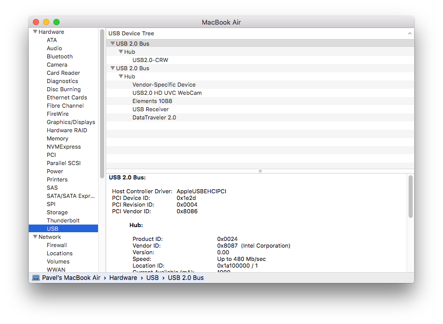

pavn Posted November 20, 2015 Share Posted November 20, 2015 I am trying to get USB 3.0 to work under El Capitan based on following guide. http://www.insanelymac.com/forum/topic/306777-guide-usb-fix-el-capitan-1011/ But I am not very familiar with patching of DSDT. Could anybody help me, please? VodooHDA should be okay (But I remeber there was some advantage by using (patched) AppleHDA.) Better using EFI/Clover/kexts/10.11/ because it is update save. (Clover injects kexts automatically.) There are changes in El Capitan about USB in general. The old kext for USB3 (XHCI) for Yosemite does not work anymore. This is new... so other forums may have information on it. Link to comment https://www.insanelymac.com/forum/topic/283038-asus-zenbook-prime-ux31a-db51-ultrabook-fixes-mods-tweaks-etc/page/41/#findComment-2190040 Share on other sites More sharing options...
