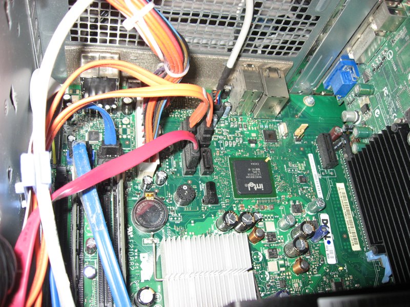

timeshifter Posted December 6, 2007 Share Posted December 6, 2007 I tried a SATA DVD drive first. Then a USB-IDE converter hooked up to an IDE drive. Could boot all the way to the installer but then it wouldn't see my hard drive. ToH RC2. Which two SATA ports don't show up? A picture would be great, but if you know the numbers that would be fine too. Link to comment https://www.insanelymac.com/forum/topic/28138-dell-xps-410-resource-extravaganza/page/9/#findComment-529657 Share on other sites More sharing options...
peart75 Posted December 6, 2007 Share Posted December 6, 2007 see attached image. I believe the bottom 2 are the ones that do not show up. The orange cables go to my DVD drives, one doesn't show up in OS X. The red goes to the HD that I boot from. Hope this helps, Drew Link to comment https://www.insanelymac.com/forum/topic/28138-dell-xps-410-resource-extravaganza/page/9/#findComment-529702 Share on other sites More sharing options...
Xenn0X Posted December 6, 2007 Share Posted December 6, 2007 peart75. using port 4 and 5 results here in my system that i cannot use them in osx. i have 2 hd's on blue like you. then on port 2 and 3 have my both optical drives. on 4 i have my windows disc. so apple cannot use it and windows boots fine 5 is empty. so do not use port 4 and 5 in osx cause they wil not work without edditing some stuff in apple ahci. Link to comment https://www.insanelymac.com/forum/topic/28138-dell-xps-410-resource-extravaganza/page/9/#findComment-529745 Share on other sites More sharing options...
